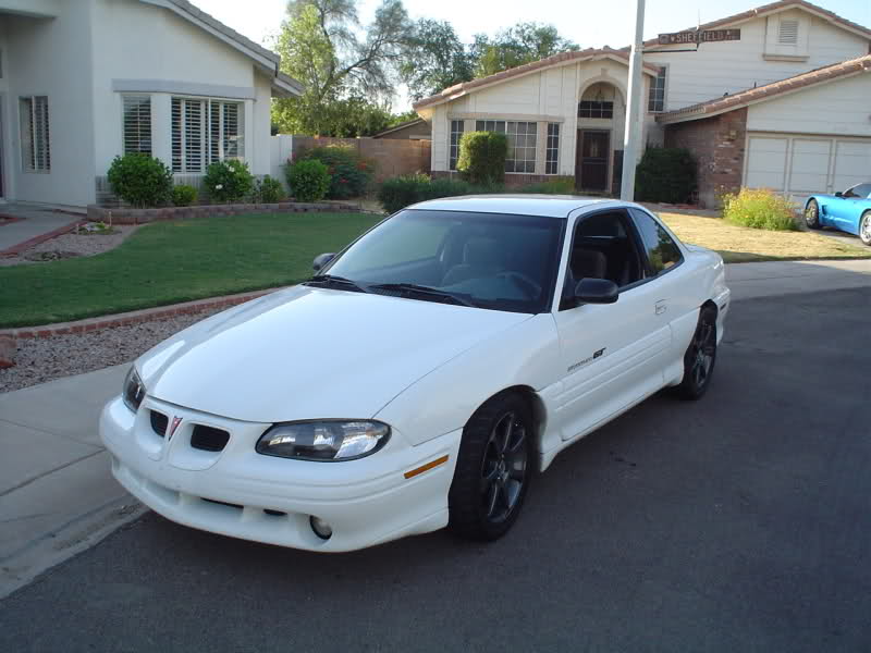

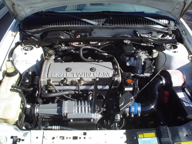

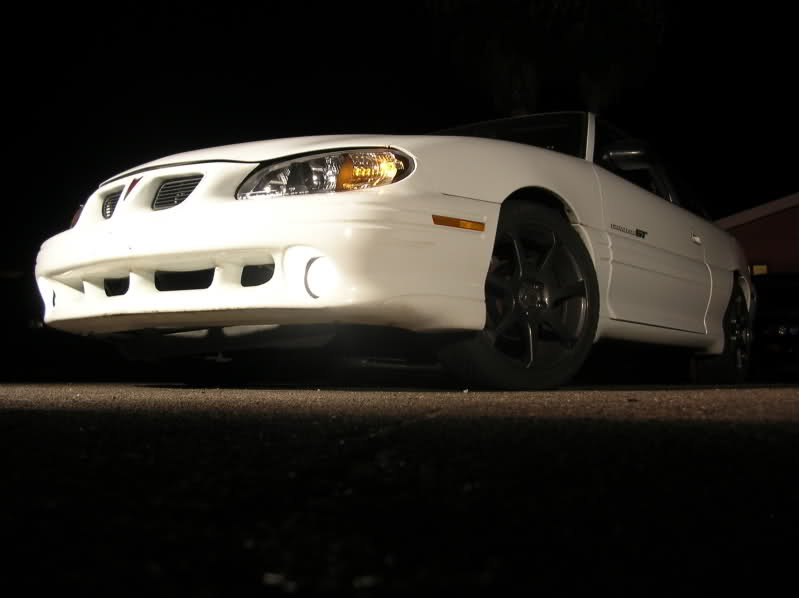

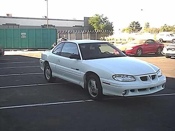

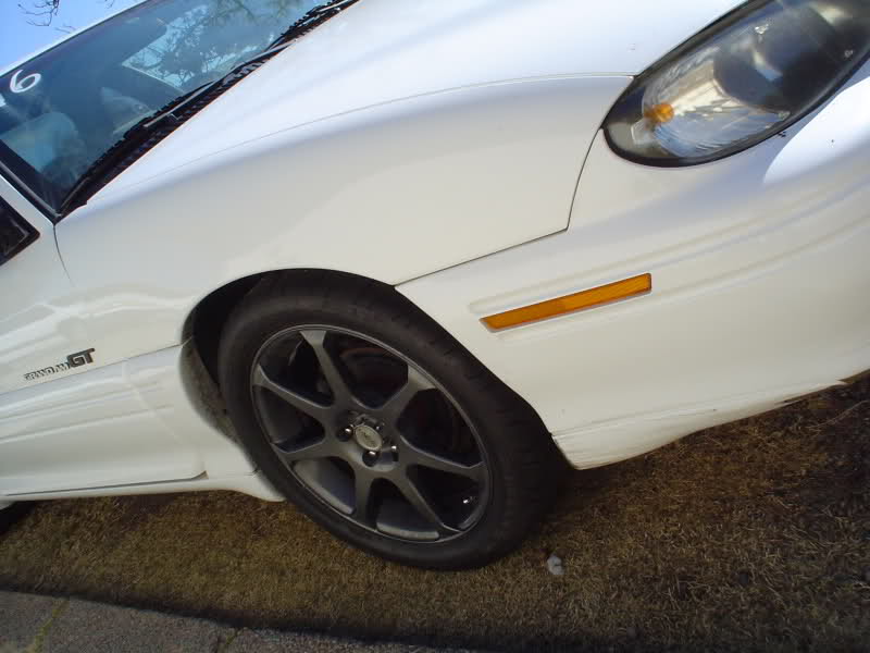

Most of you know me. Its just been a really long time. Took the car apart, decided to put it back together. I searched for this specific car in 2005 on autotrader. Found 1 in a 300 mile search. Like 286 miles away, California. I drove out there and got it. Just cant let her go. Put way too much money into this thing. But oh well. Here she is when I first got her.
Now...

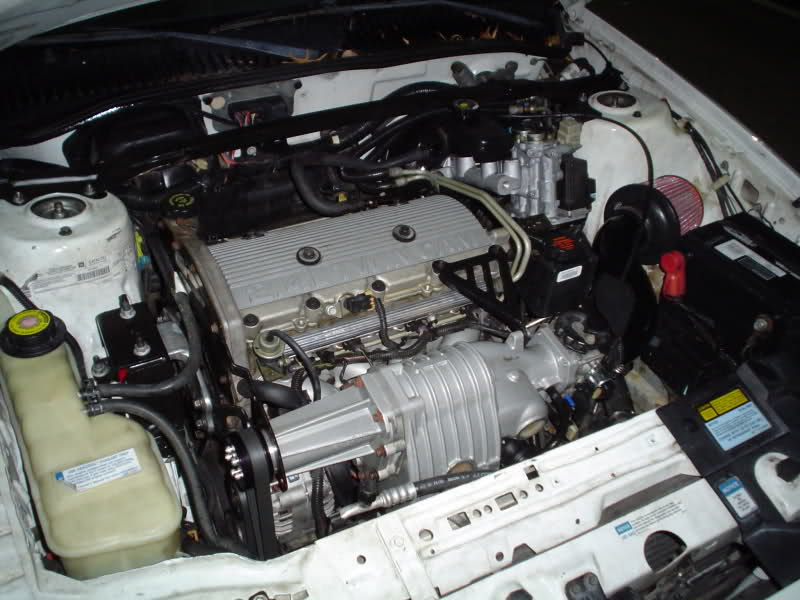

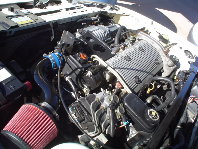

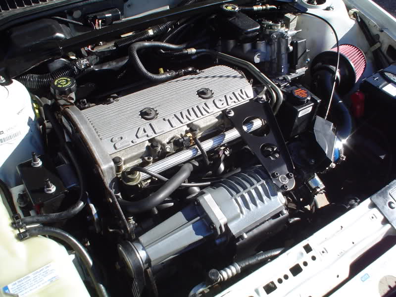

M45 Supercharger
HPTuned

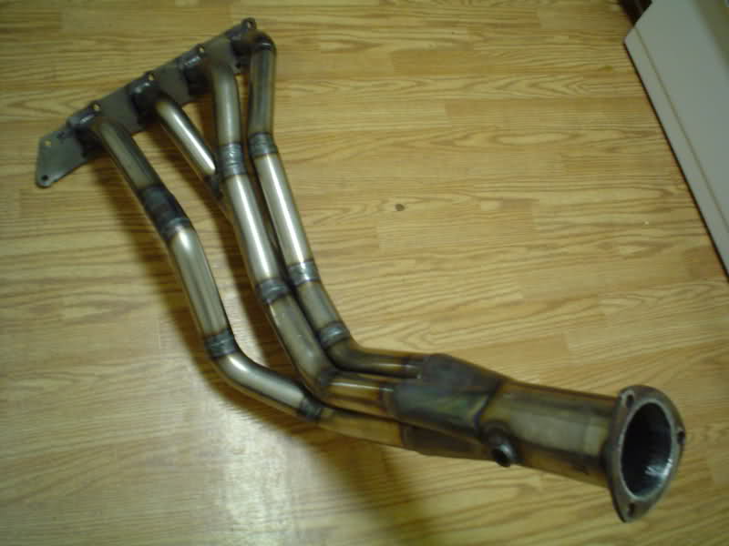

Long Tube Header w/ 3" collector
High Flow Catalytic Converter
Full 2.5" exhaust
GM Crossflow Muffler
WAI
Gunmetal Exel Wheels
Black Housing Headlights
GM Strut Tower Bar
TenzoR Lowering Springs
Here is a video when I had stock pulley and just 2.25" catback exhaust.

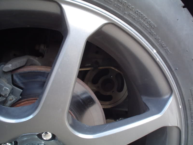

Also got a whole set of drag radials. Why? Because I can. And I like to match. 225/45/17 BFG G-Force T/A drag radials.

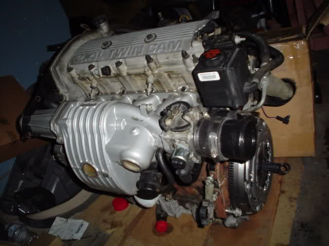

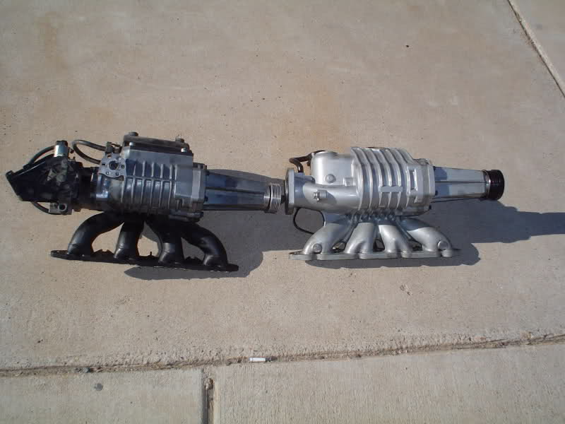

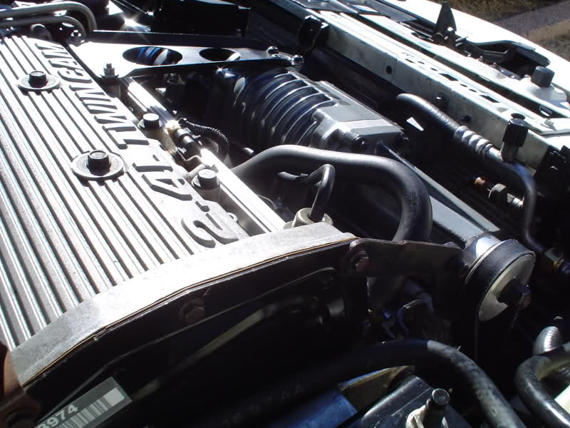

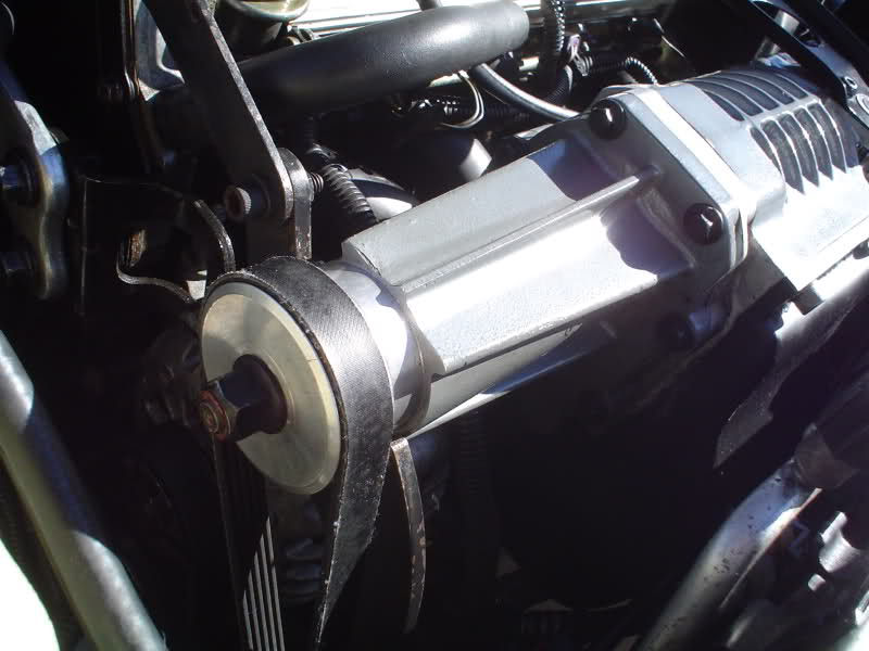

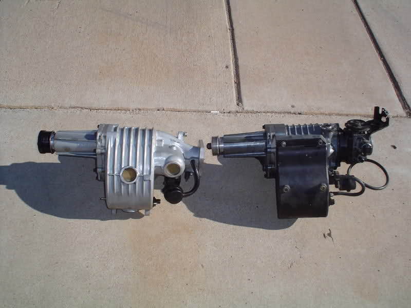

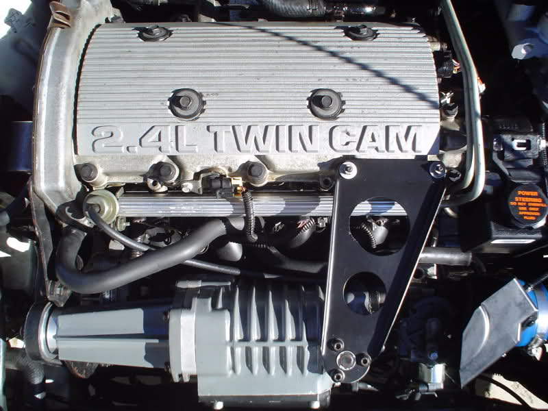

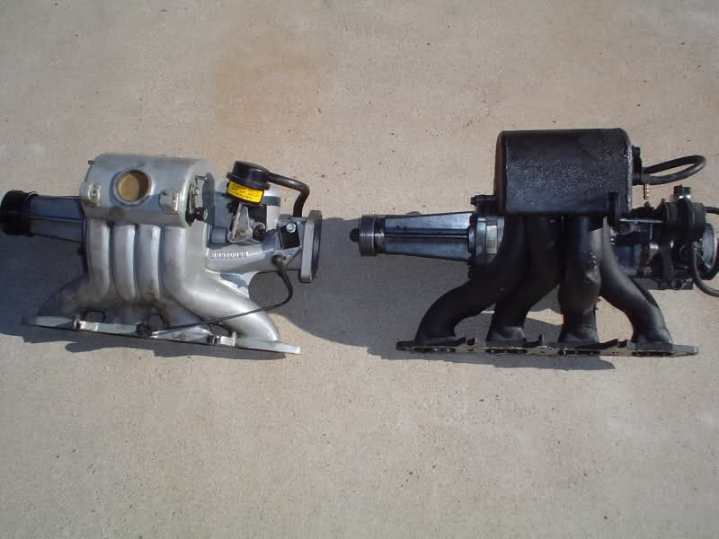

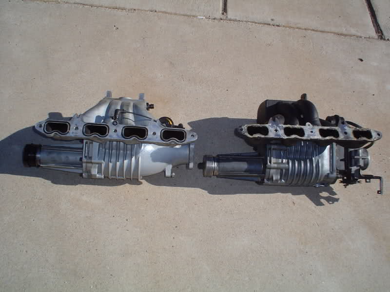

Well here is the fun part. This IS super rare. Supposedly 1 of 5 made. These were the first prototype M45s GM was building for the LD9. Originally they had planned to intercool it but came to the conclusion there was not enough room and that the supercharger can still be as effective and efficient without it. And to save trouble and money, they casted the manifold and supercharger all as one piece. The pulley is somewhere between a 2.5 and 2.6 and should boost up to 9lbs.
What is the advantage to this supercharger? Well I for one like the fact that it is now mine and no one can have it, and its not an option for anyone out there either. It leaves a slim window open for the possibility of intercooling it. And lastly I believe the manifold may be a better design considering this supercharger sounds different. Sounds more like an M62, maybe an M90. Must be higher flowing. I have not full throttled this thing because it scares me. Maybe when I get some race gas back in the car and turn on the wideband and see where the afr is at. Still need the meth kit hooked up too.

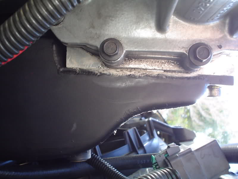

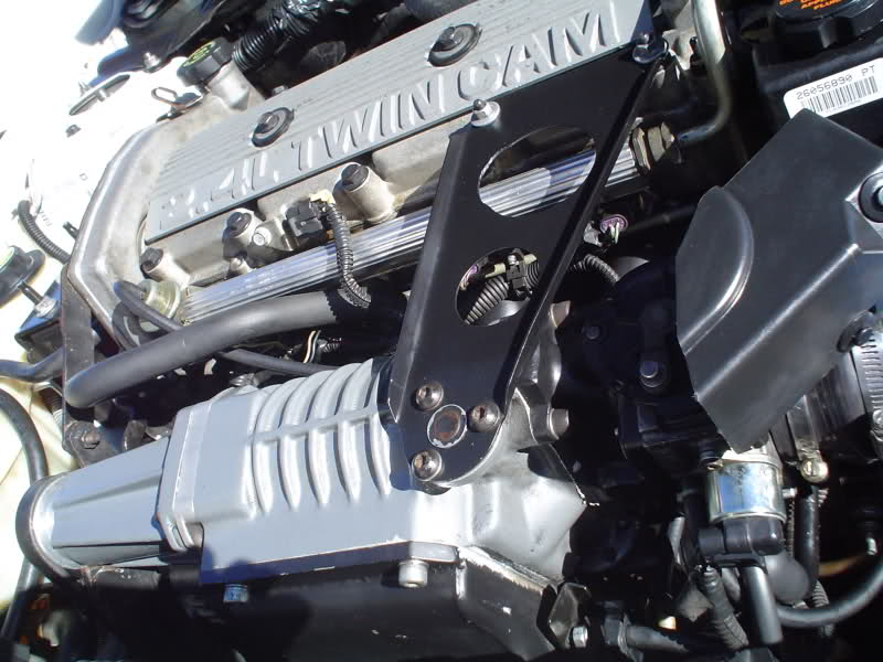

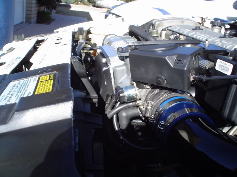

I took a picture of every possible angle. You can see how it mounts, how the brackets are different, even the idler is different. The pulley has the protective wall helping keep the belt wrapped. Also, the fact the throttle body bolts to an adapter that bolts to the supercharger, leaves an option for a much larger inlet. Everything had to be gasket sealed since GM didnt design any gaskets for this kit.

I like it imo though I think thicker rims like the cobalt ss/SC would look amazing

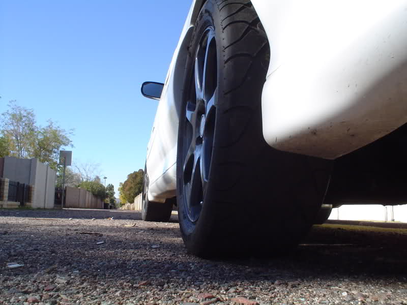

My wheel size is 17x7. Same as the 17" on a Cobalt SS. Unless you are suggesting the 18" wheels that are 7.5 wide but Im not interested in hot roddin 18s on this car.
So what do you mean, thicker rim?
The thing I don't like about the GAGT, the wheels don't seem to have much of an aggressive offset.
A 17x8 wheel with a +30 offset would really look mean.
' timestamp='1326073869' post='64495']
I agree. But I dont want to end up with wheels that look like they are worth more than the car. Plus Ive ran into options but I HATE multi lug patterns. These wheels I have are only 5x100 and I like it that way.
I also like the color of the wheels. They arent exactly black. They happen to be the same color as my GT badges too. Lame excuse to fight for I know but I admire the accent matching.
the wider spokes I think would look the best

After these I think something broke. Engine is fine. I think the trans is fine, but the wheels (I beleive, maybe just one) want to wonder. I was flying down the track in 3rd gear and all of a sudden it just started curving right. I jerked the wheel back and got the car going straight and after that I called it a night. Long drive back noticing it a bit on the freeway, I dont know what it is. Tie rod? Hub bearing? Meh.
Scanned my car with HPTuners. Timing is between 22-29 degrees max at WOT, with xylene in my gas tank no KR, and my AFR is between 11.1-11.5 at WOT. Which is amazing since this is the original tune I had for the old m45 setup with stock pulley and no header. The biggest difference I noticed. Old setup reached 201 degrees intake air temperature. With this setup, highest was 164 degrees. Awesome! This manifold design is better for sure.

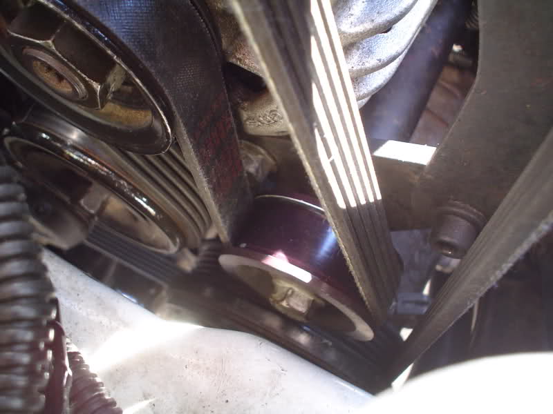

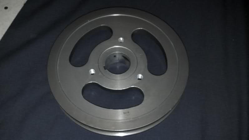

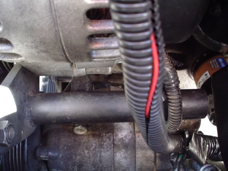

Picked up a OD crank pulley. For those of you who dont know what it does, its bigger than the stock crank pulley, but the revolutions do not change. This will make all the other accessories spin faster. The alternator, compressor, idler, tensioner, and the supercharger. Should be seeing about 3psi more with that. Then I install the meth kit. Then the dyno.
Also think I figured out why the car is slower than it should be and why it feels like its dragging. I have too much advanced timing. Like 10 degrees too much. Need to adjust that on the dyno too.
Pretty cool.
Do you know if you were seeing any knock retard when you scanned last?
So far no knock. I was running high octane though. I think after this is installed Ill be seeing around 12psi total.

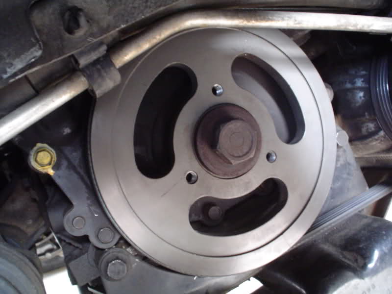

Overdrive crank pulley installed. Im sure the supercharger is now pushed to its limit. Probably seeing 12psi on stock motor. Faster? No idea. Afraid to floor it. Meth still in trunk. After thats hooked up, dyno time.
