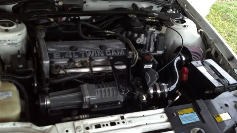

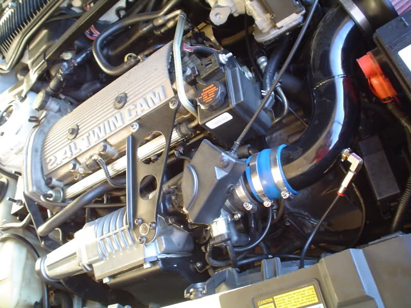

Supercharged Grand Am GT

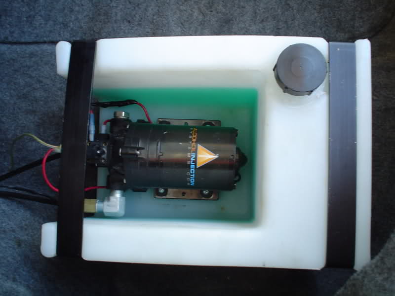

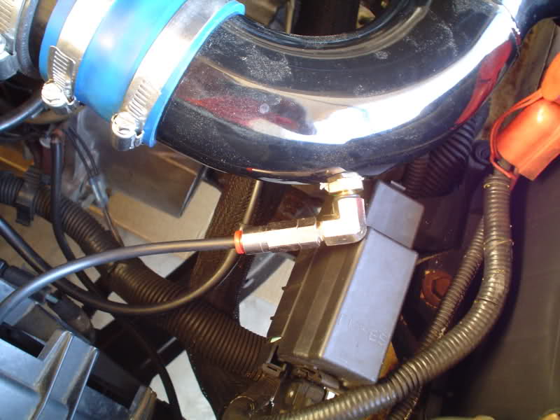

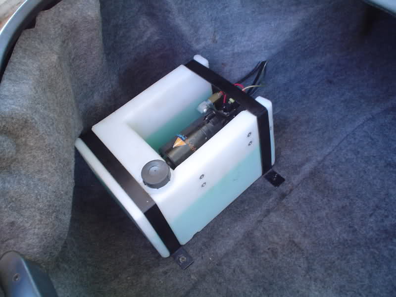

Meth kit installed and working off the MAP sensor.

What fitting(s) did you use for the nozzle? I need to tie into a pipe for an external IAC and it looks like I could use something similar.
Oh Im not sure bro lol. The nozzle was threaded. So I just took it to home depot, looked for a fitting that screwed into it andmade sure the other end was big enough to fill the hole already in my intake that was designed for pcv.

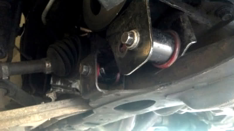

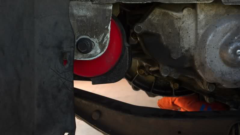

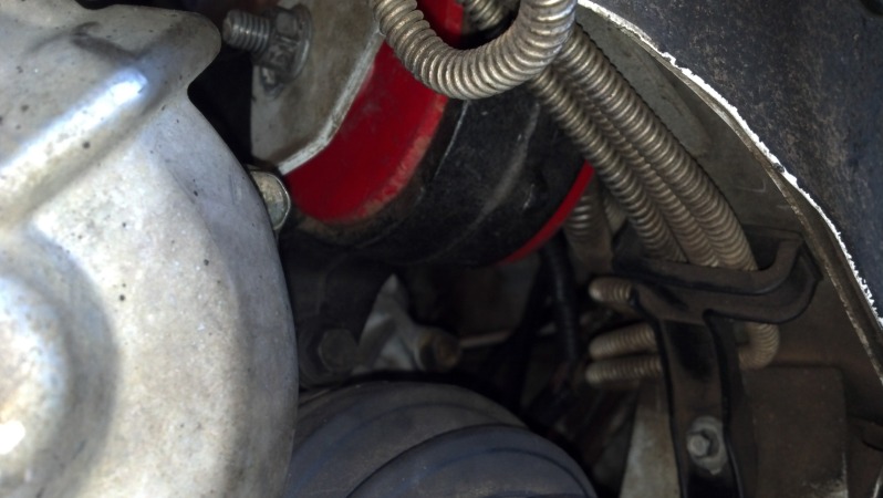

Well some update. Got that damn torque strut mount in, although it was meant for a jbody. Had to hack up one end a bit but its in.

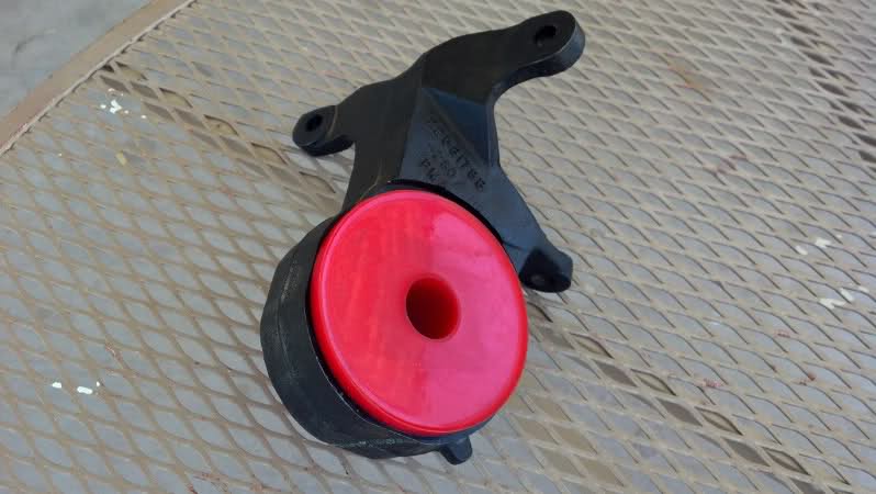

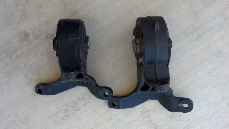

Now for the transmission mounts. I had purchased some from Turbo Tech Racing (which again are intended for a jbody) and sure as it is.... The jbody mounts (although the same platform) are indeed different from mine. The journey begins.

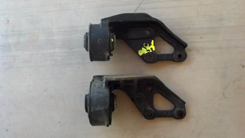

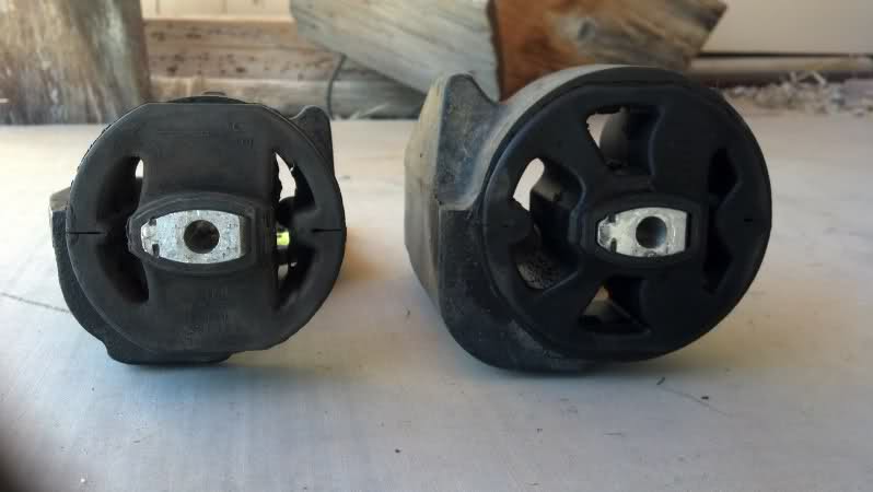

This first pic here is a comparison. The one with yellow on it is mine. Notice how the casting is different and the insert is much smaller than the jbody. You can really see the size difference in picture number two.
After looking at them both for a half hour, I concluded it should fit. All bolt points meet at the same distance. So I am here to tell you YES a jbody front mount will work for our cars.

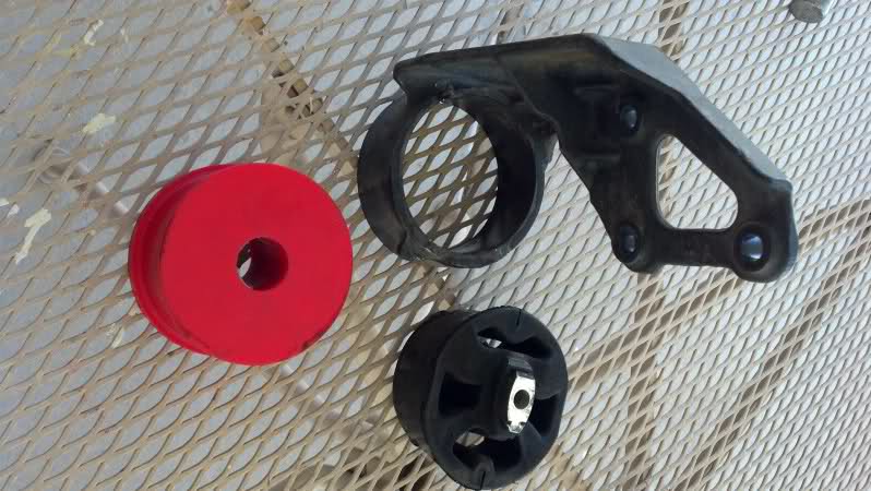

This is where I got a little upset. I was hoping the rear mount would be the same case... Nope. Look closely in this pic. Again mine is the smaller one. Not only is the insert smaller, but all the bolt down areas are NOT at the same distance. The jbody mount is longer.

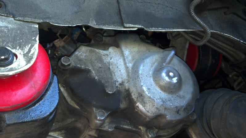

I was able to use the front TTR mount. I cant not use the 2nd one. I cant return it as the two sold as one item, and I am not about to try and have this poly machined down to fit my mount bracket. After much much MUCH deliberation... I decided to install the jbody mount. There was about 1/2 inch distance from the insert holes and I know there is some play in the mount bracket on the frame of the car so I decided to try it.
TEST FITTING ALONE took me almost 2 hours. Wanting to reassure myself this could work. Then pulled it back out, swapped inserts, then about 2 hours again getting this thing to fit. Ladies and gentlemen, the cast iron mount for our cars and the jbody is indeed different. BUT, it will fit. With enough time, energy, patience, and tools, it can be made to fit. And the car drives great with it.
The car feels great. Dash rattles like no other, I feel the car KICK every time the starter makes a rotation, but no more slug. This puppy is not moving lol.

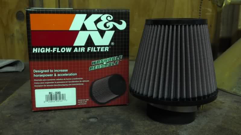

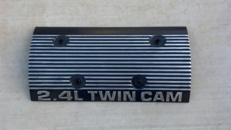

One of the last updates. Got a K&N filter. Cleaned up and painted the IDI cover. Also snagged some factory tweeters for my car from the junk yard. Had to repaint the trim piece but well worth it. Lastly, Trans Am exhaust tips.
