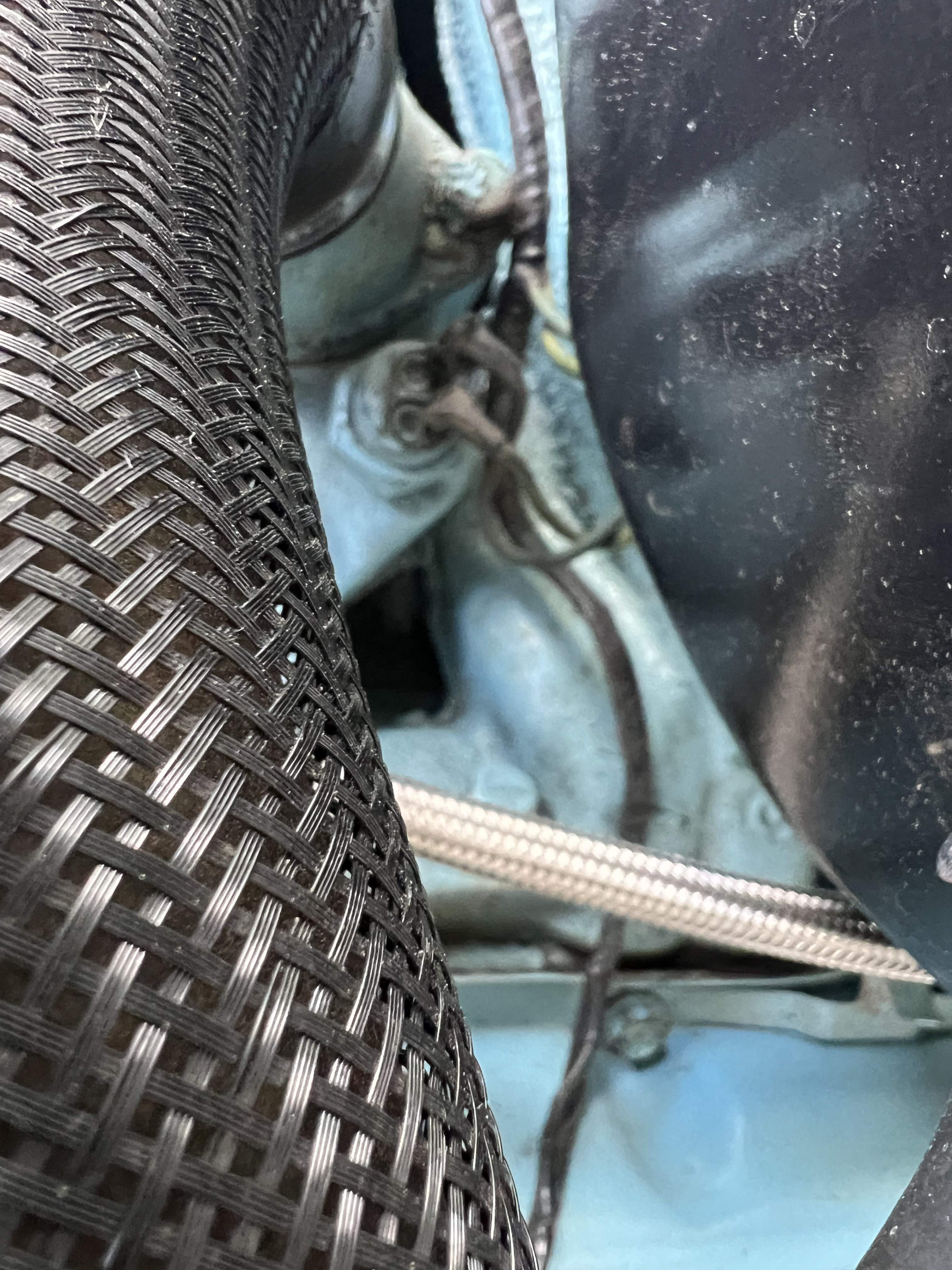

Here is a picture of my factory temp switch Ron, i recon its got 2 wires that sense cold and hot for each light ,,,,,,

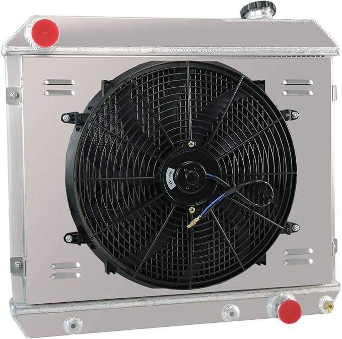

Here is the fan and radiator I have on the car now
