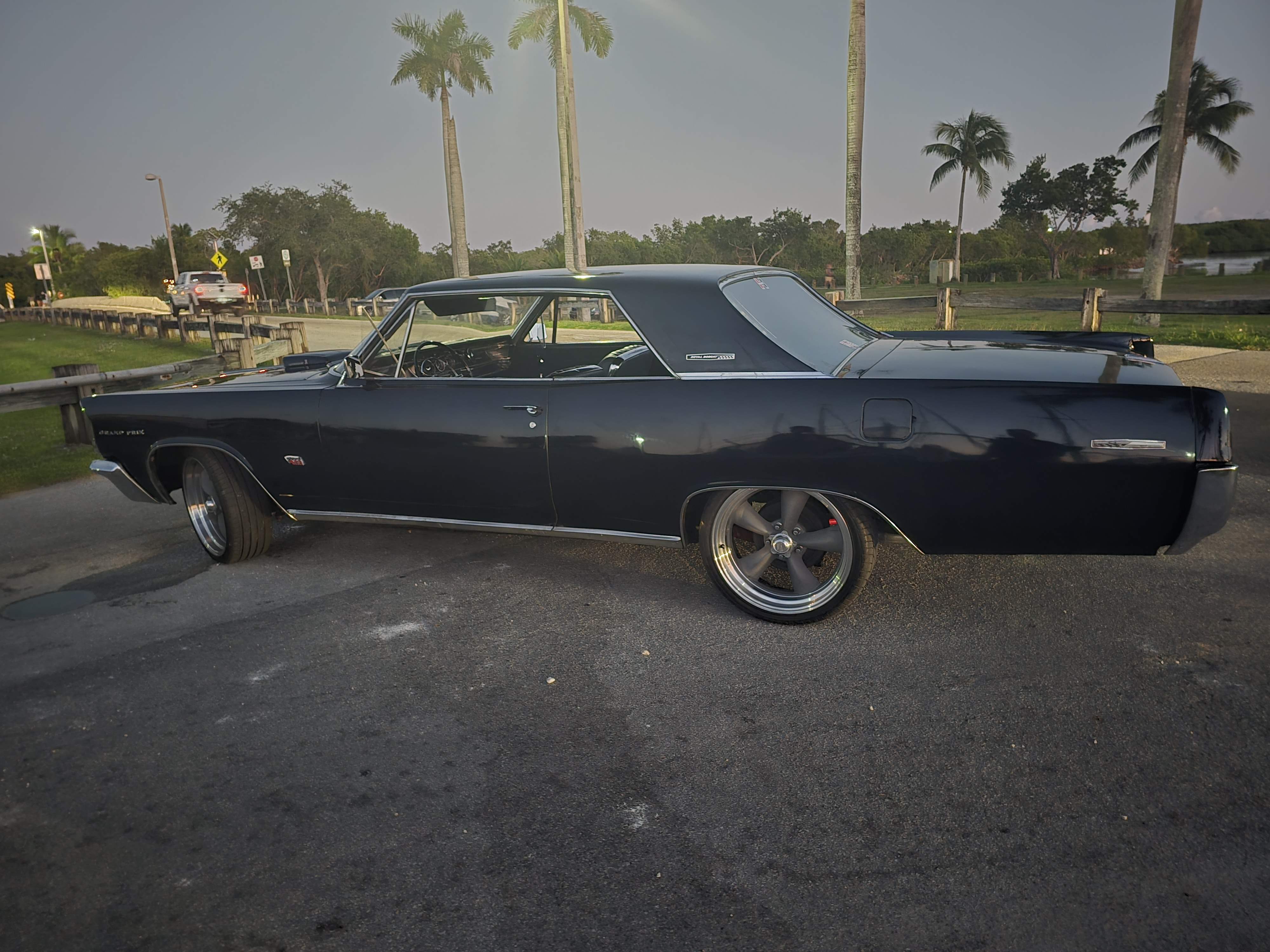

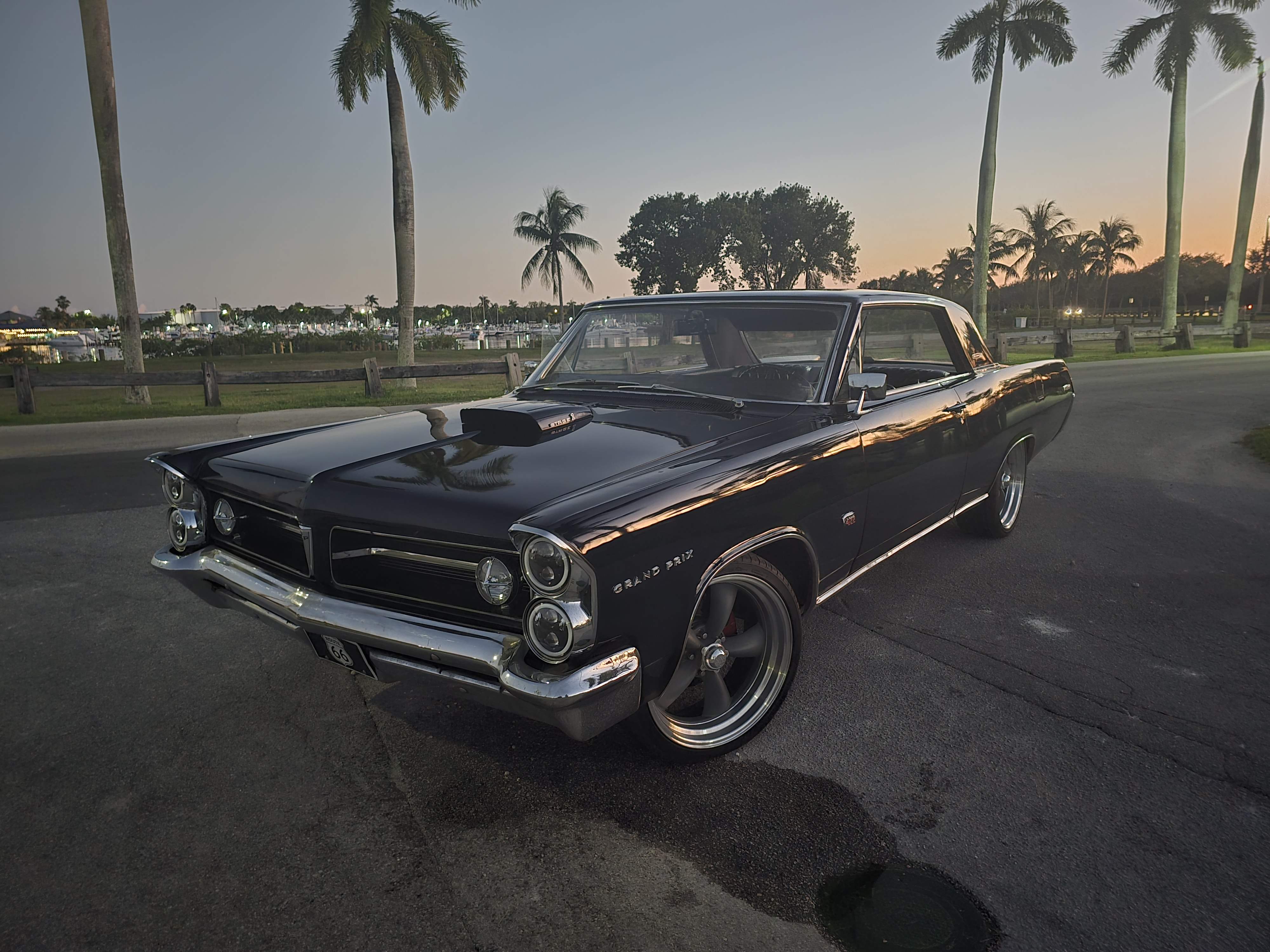

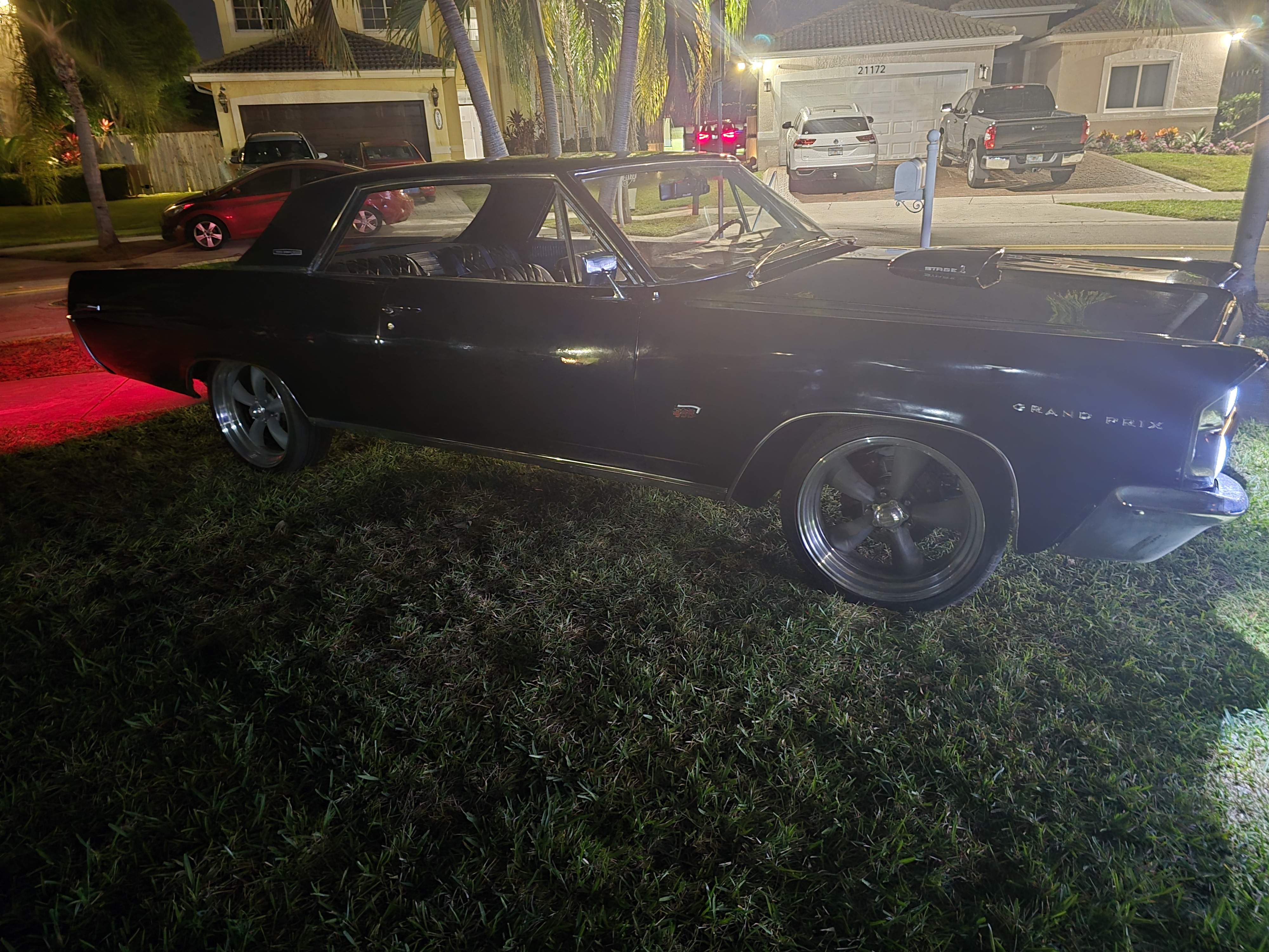

Hello everyone... Hope you guys are doing great!!!
Finally have my car up and running, no overheating problems no leaks... Just had the exhaust installed today sounds amazing

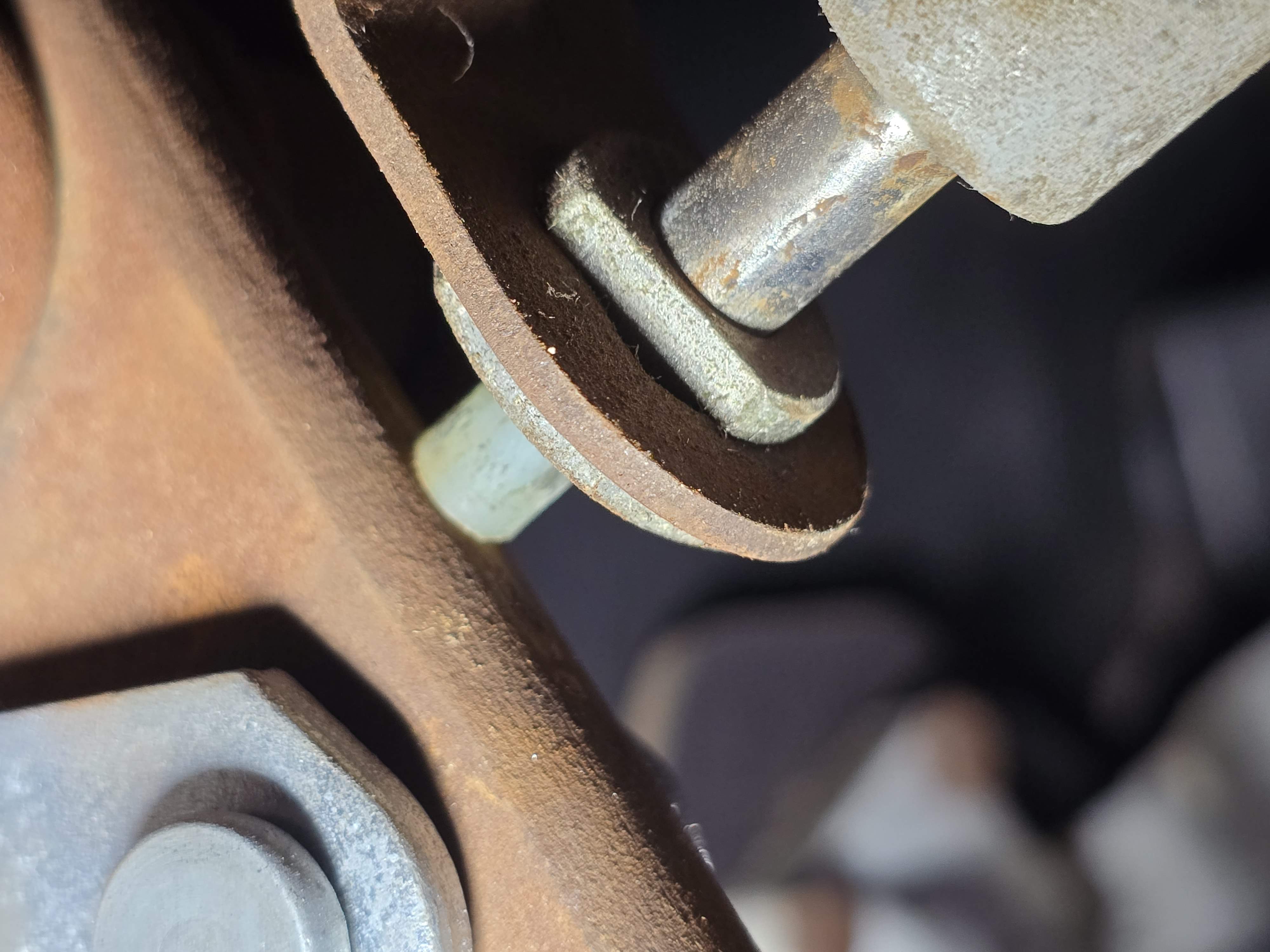

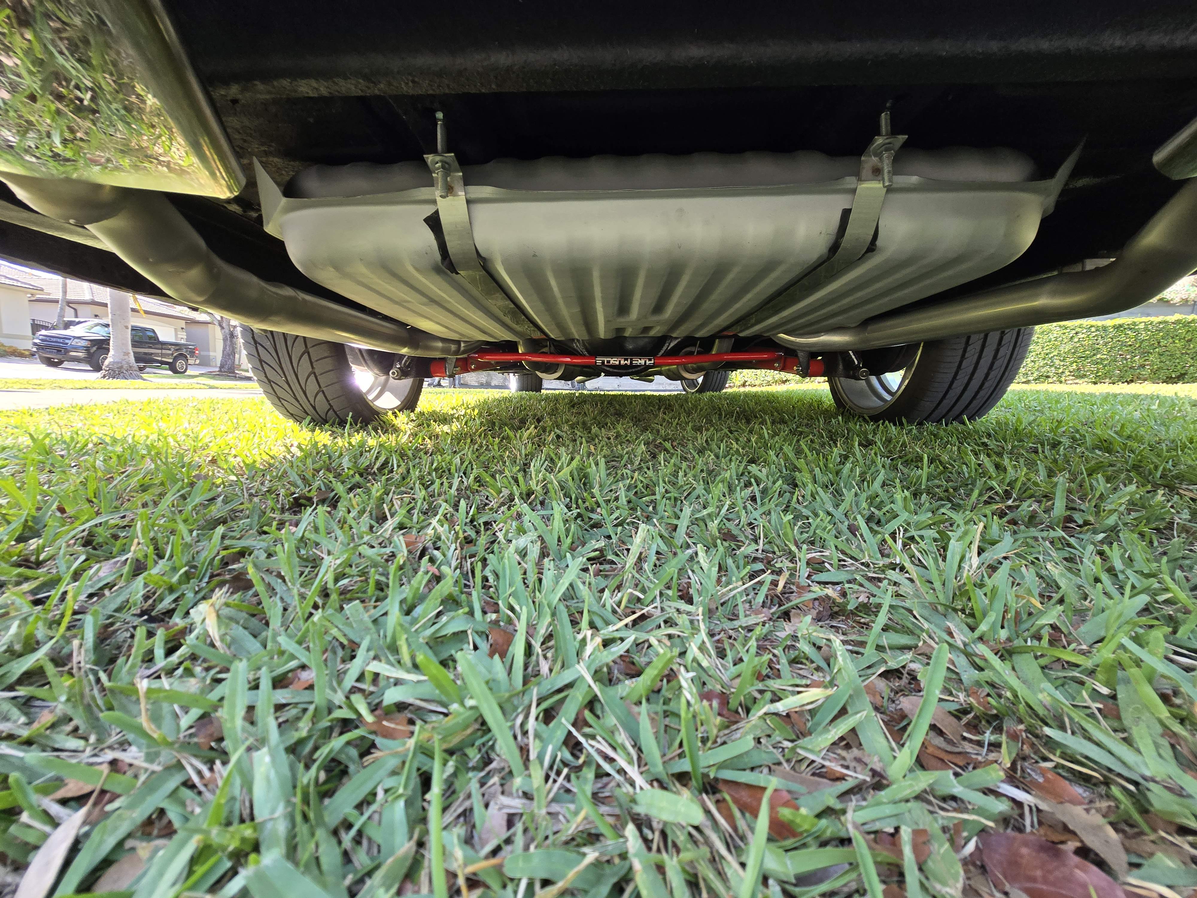

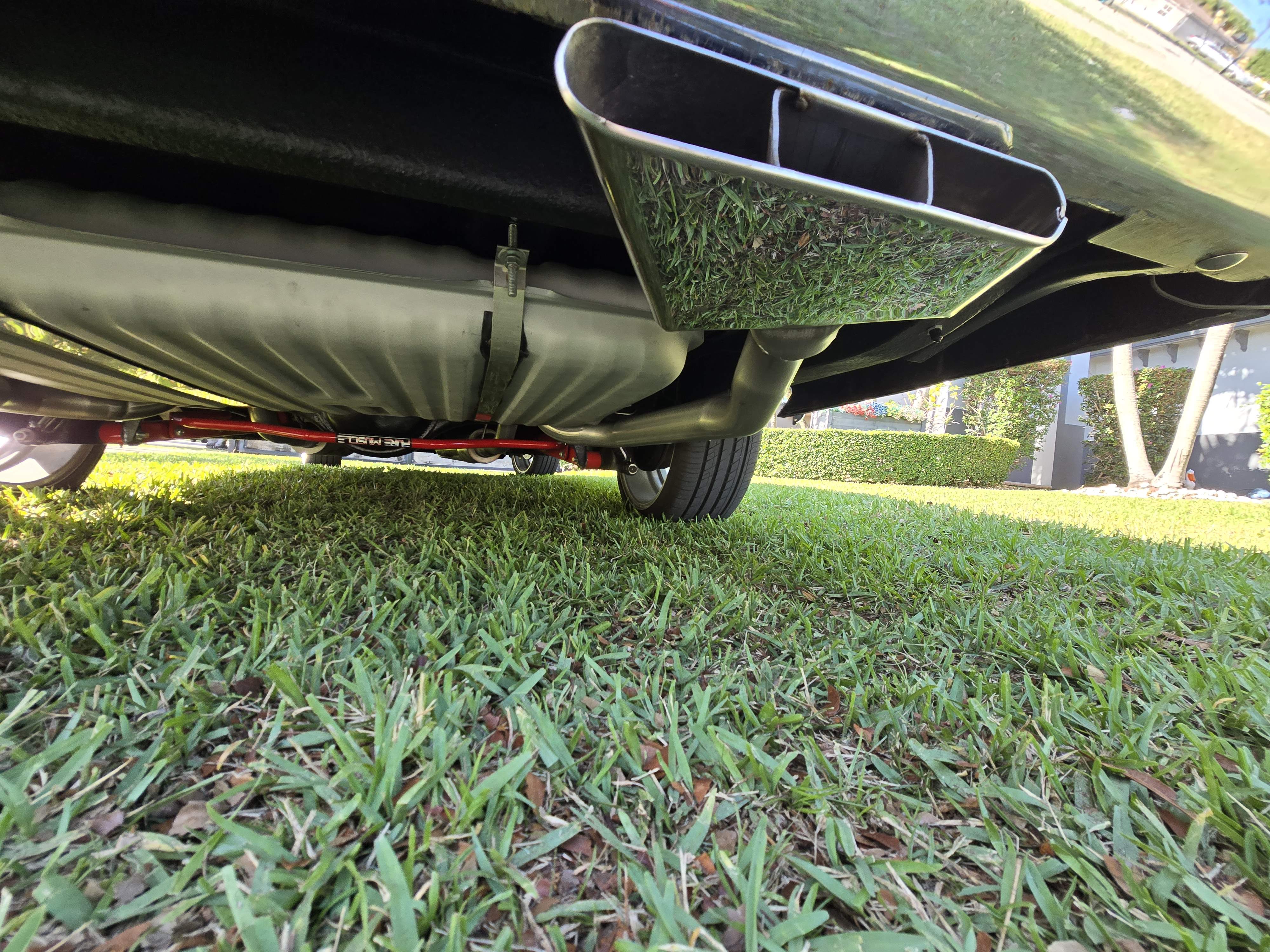

    Got the trailing arms + sway bar installed + the new parking brakes cables this weekend... Also installed the Airshocks on the rear. Car handles completely different what a change on corners..

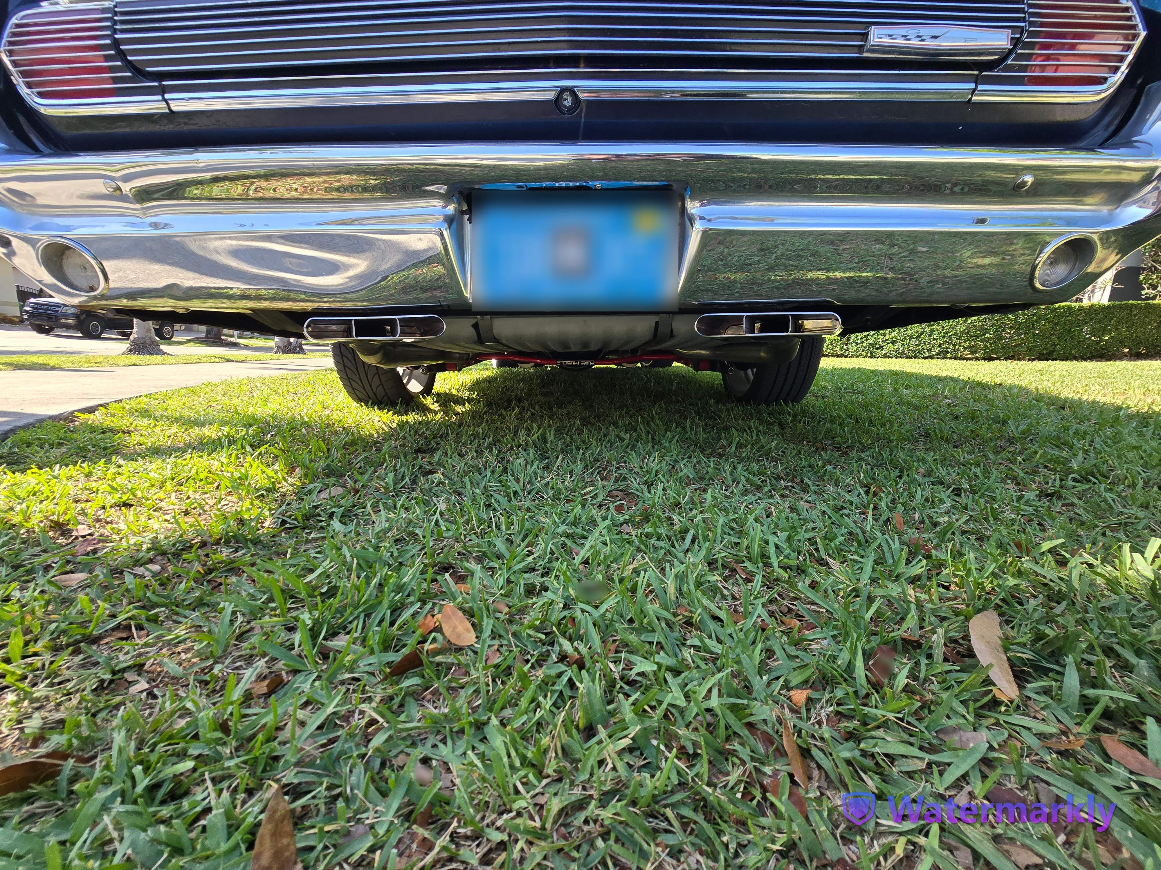

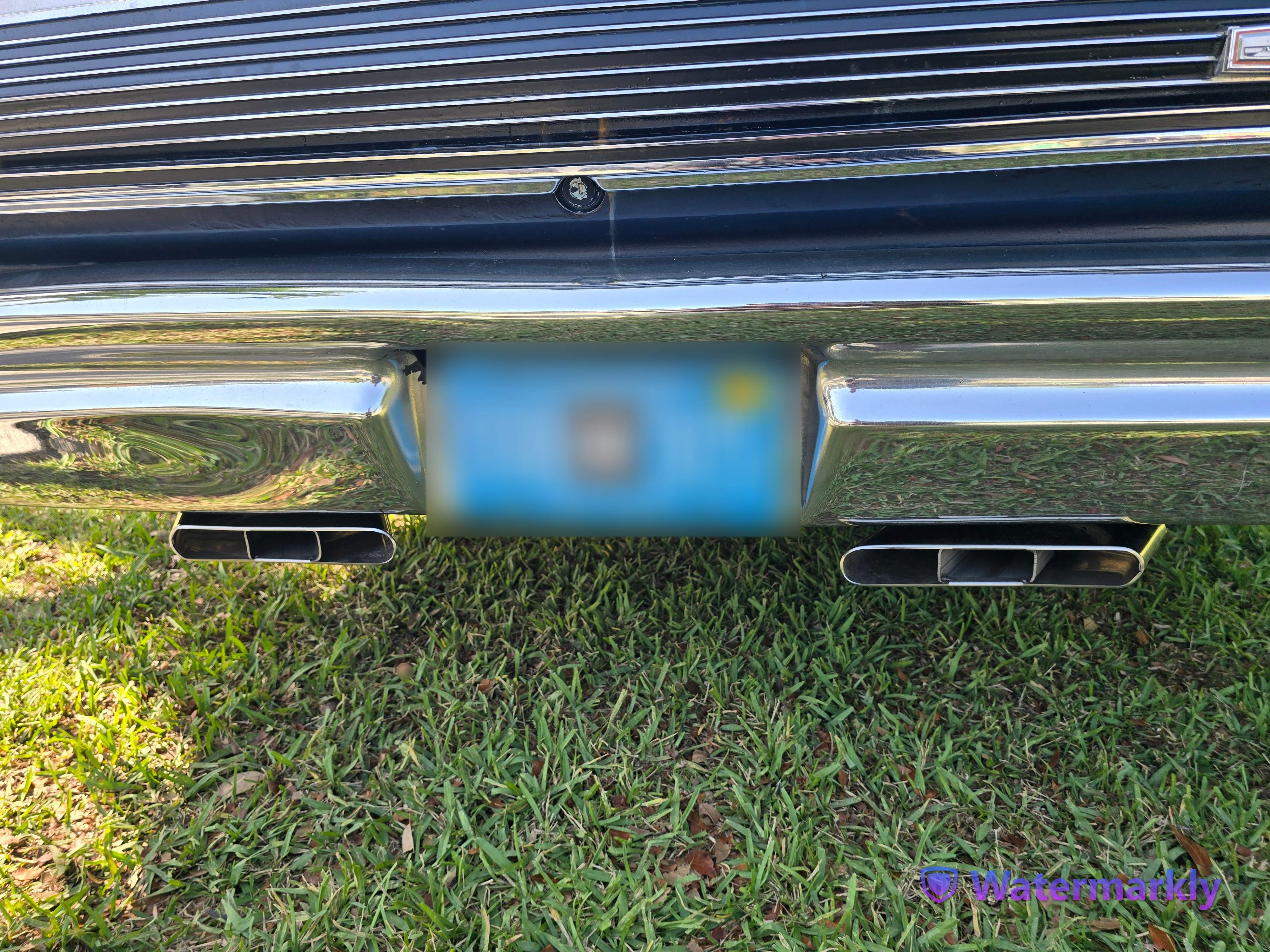

Very nice Ron, did you hpc the whole exhaust ?
 i see a couple of glass pack straight through mufflers ... let us know your set up :cheers:
12 hours ago, B52bombardier1 said:
Lookin' good!!!
Rick
Thanks
Thanks 64 kiwi,
No coating on the exhaust, just the bare metal.
The mufflers are BlackWidow 3" and I also installed 2 exhaust valves with turn downs...

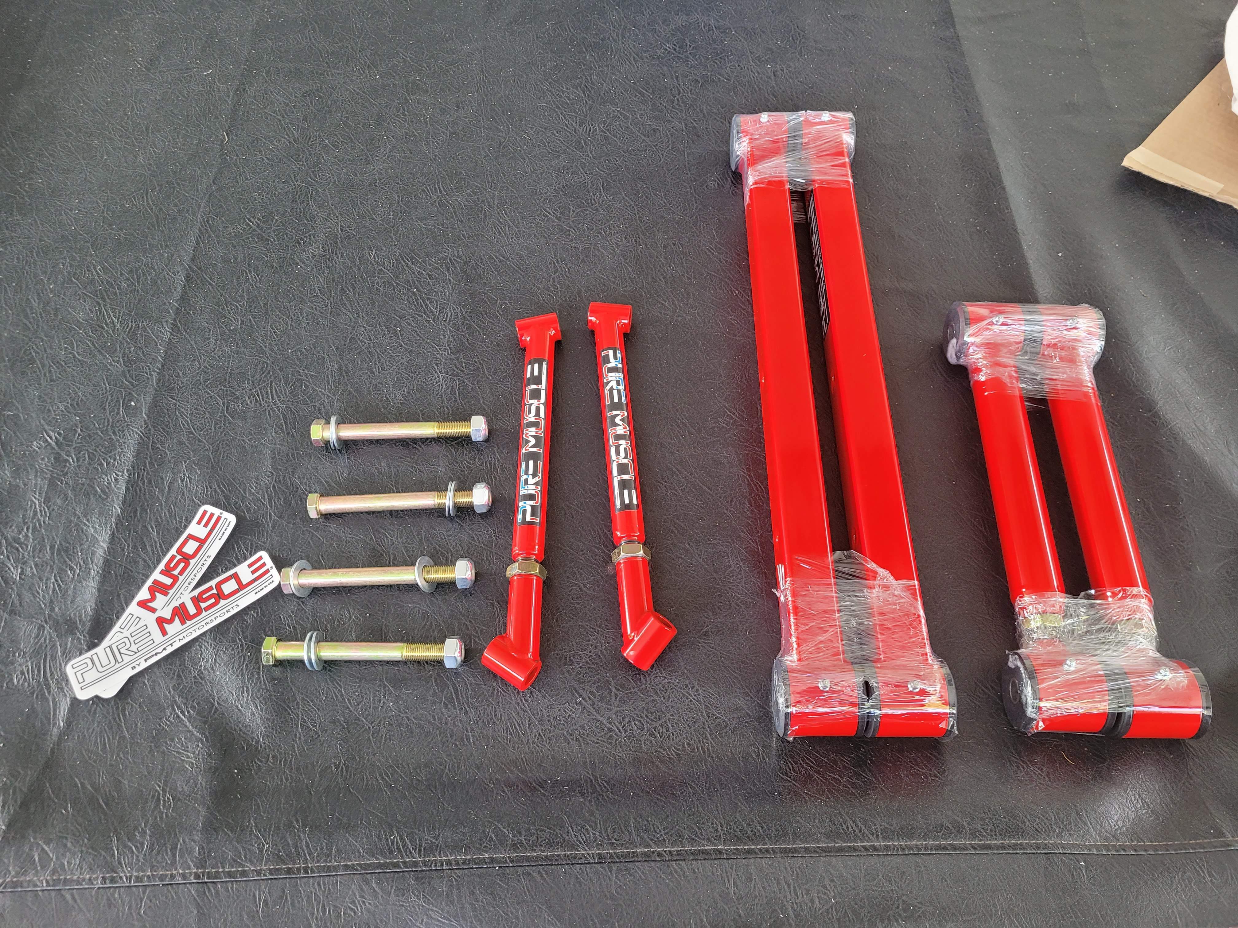

Ron I wanted to ask you a little more about that pmt kit you put in the back end
did you set you pinion angle ? I see the top. Arms are adjustable?
Sure 64 kiwi, what questions do you have?

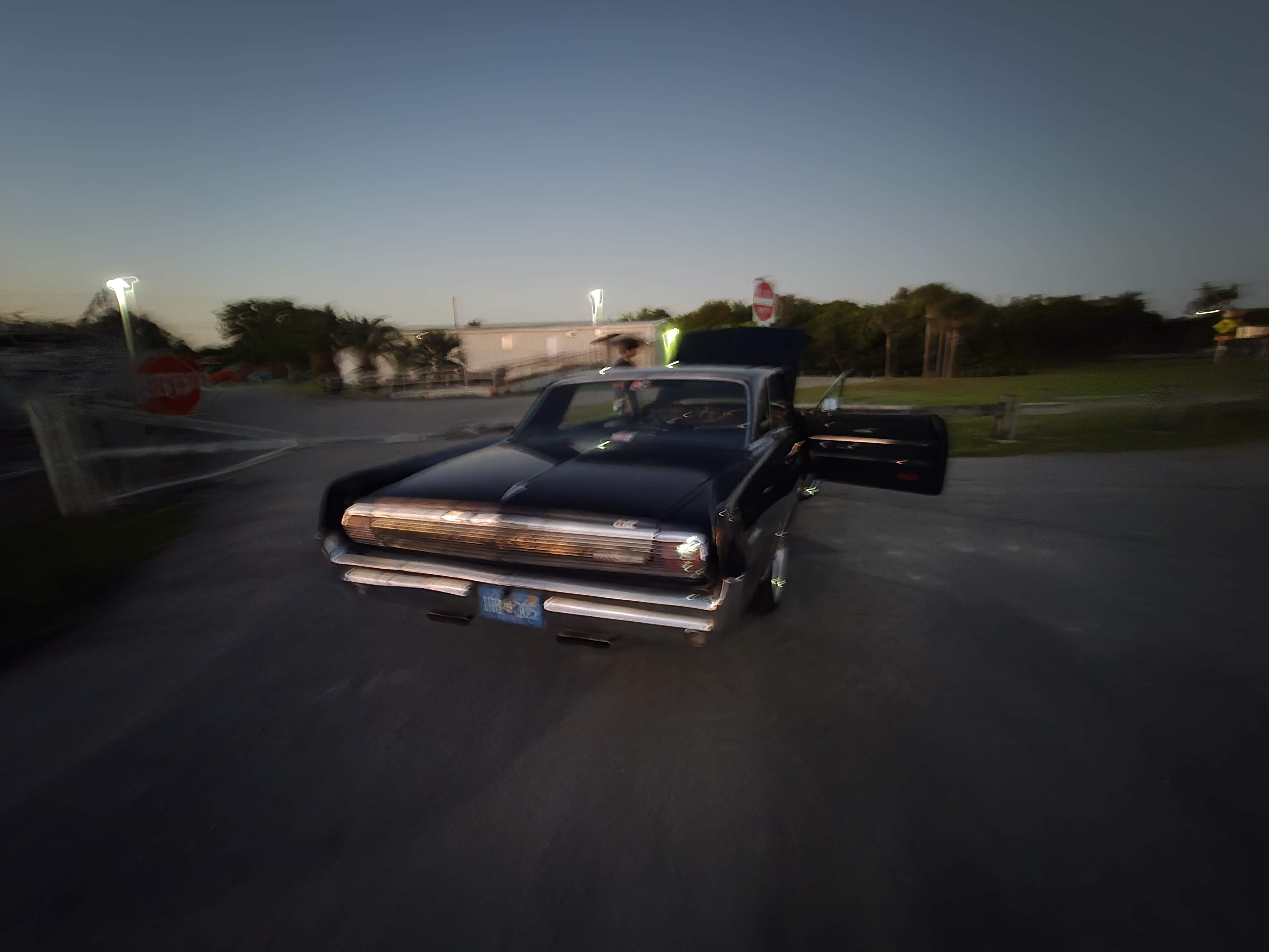

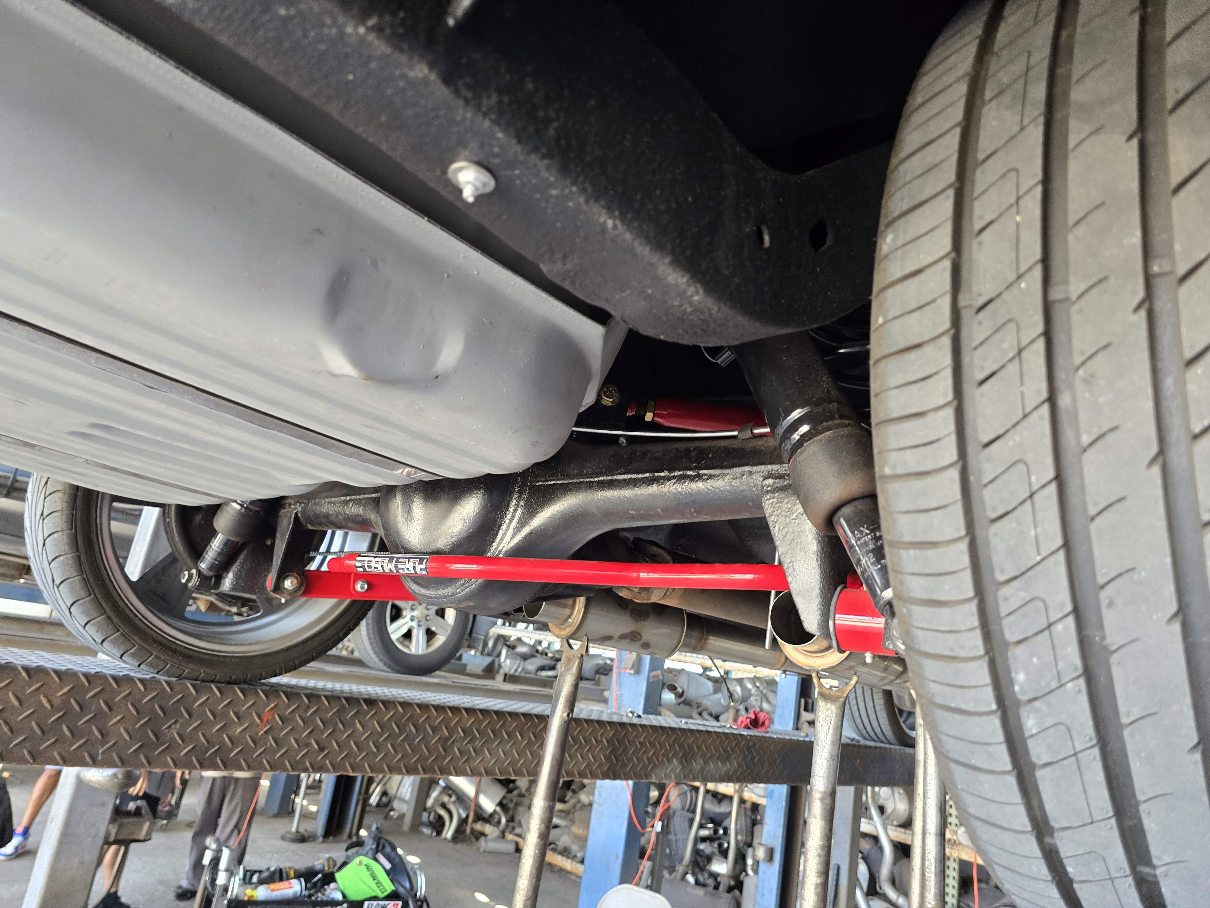

Sorry I missed your question under the picture... I did not set the pinion angle, but I did match the length of the original arms I removed.... And I also installed the sway bar upside down to keep it tucked in higher. I don't think it makes much of a difference the way it goes... And the car handles super nice on corners now... the front still needs some tunning it feels too light. I did replace the upper and lower balljoints, the control arm bushings for lower and upper . Here is a picture of the car on the lift at the exhaust shop.

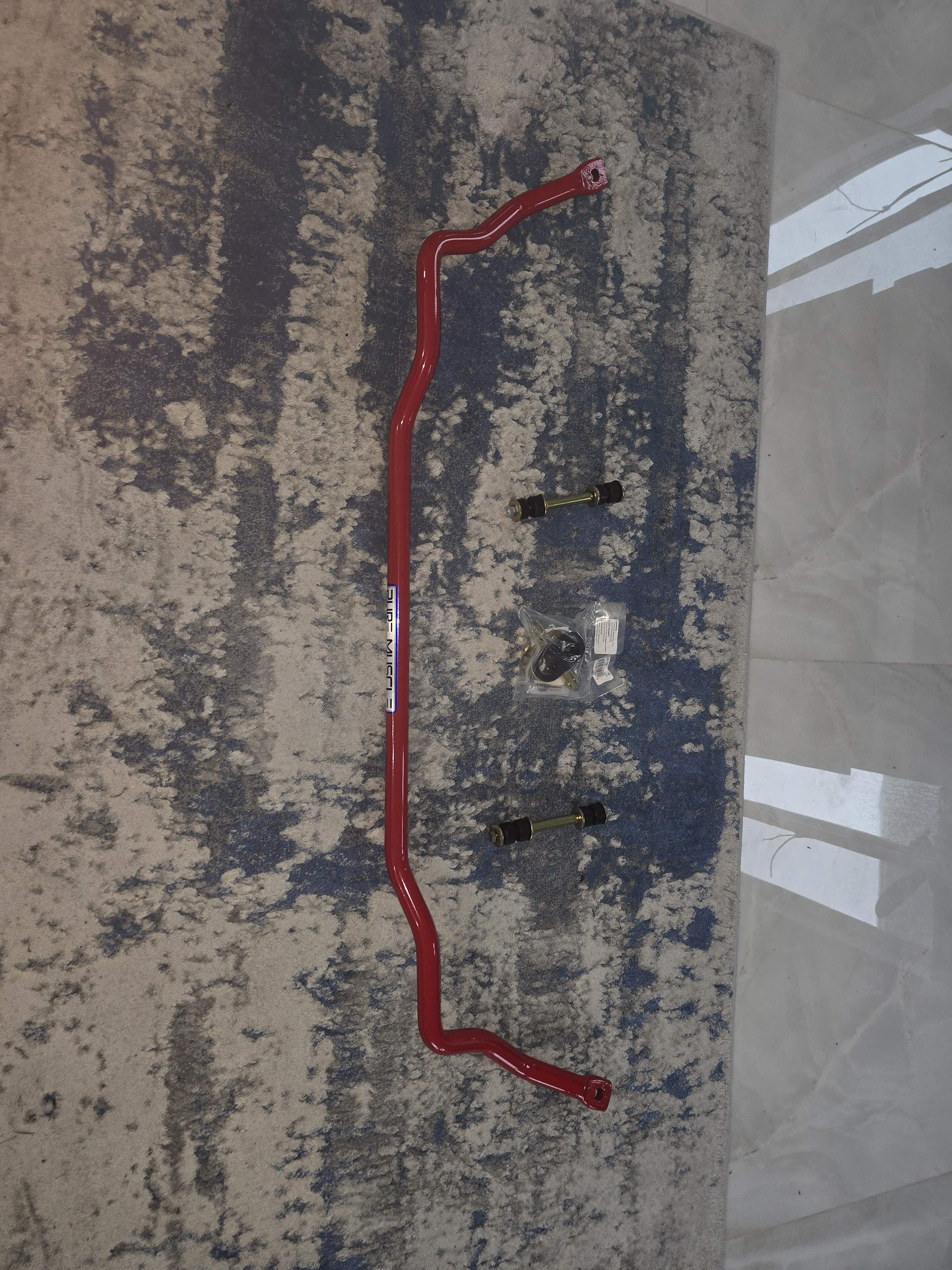

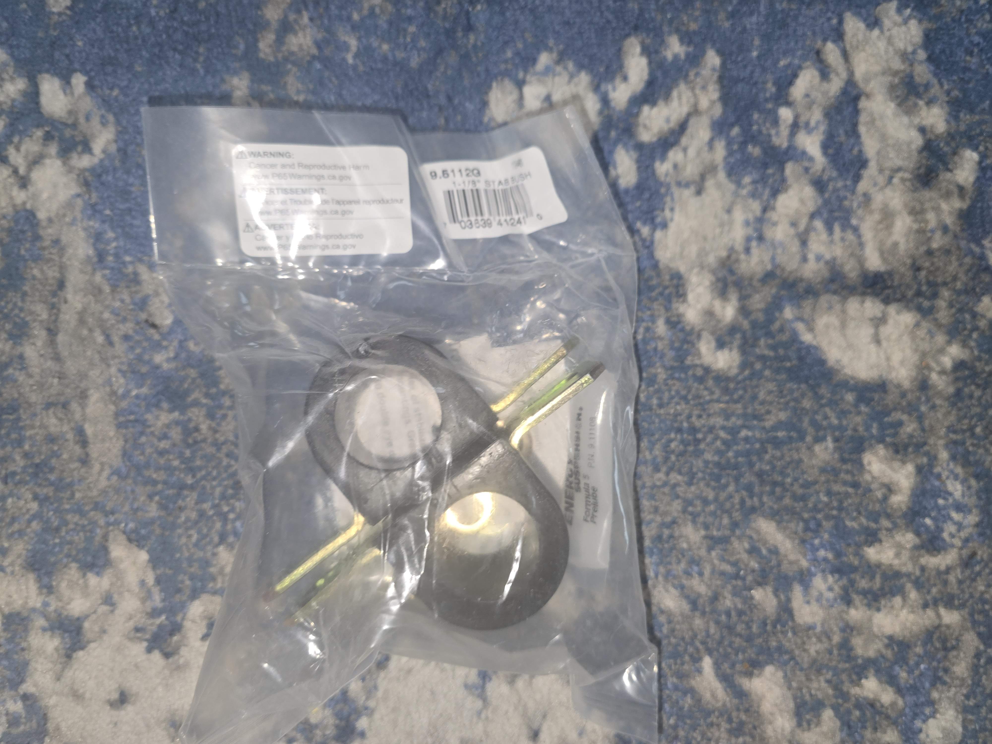

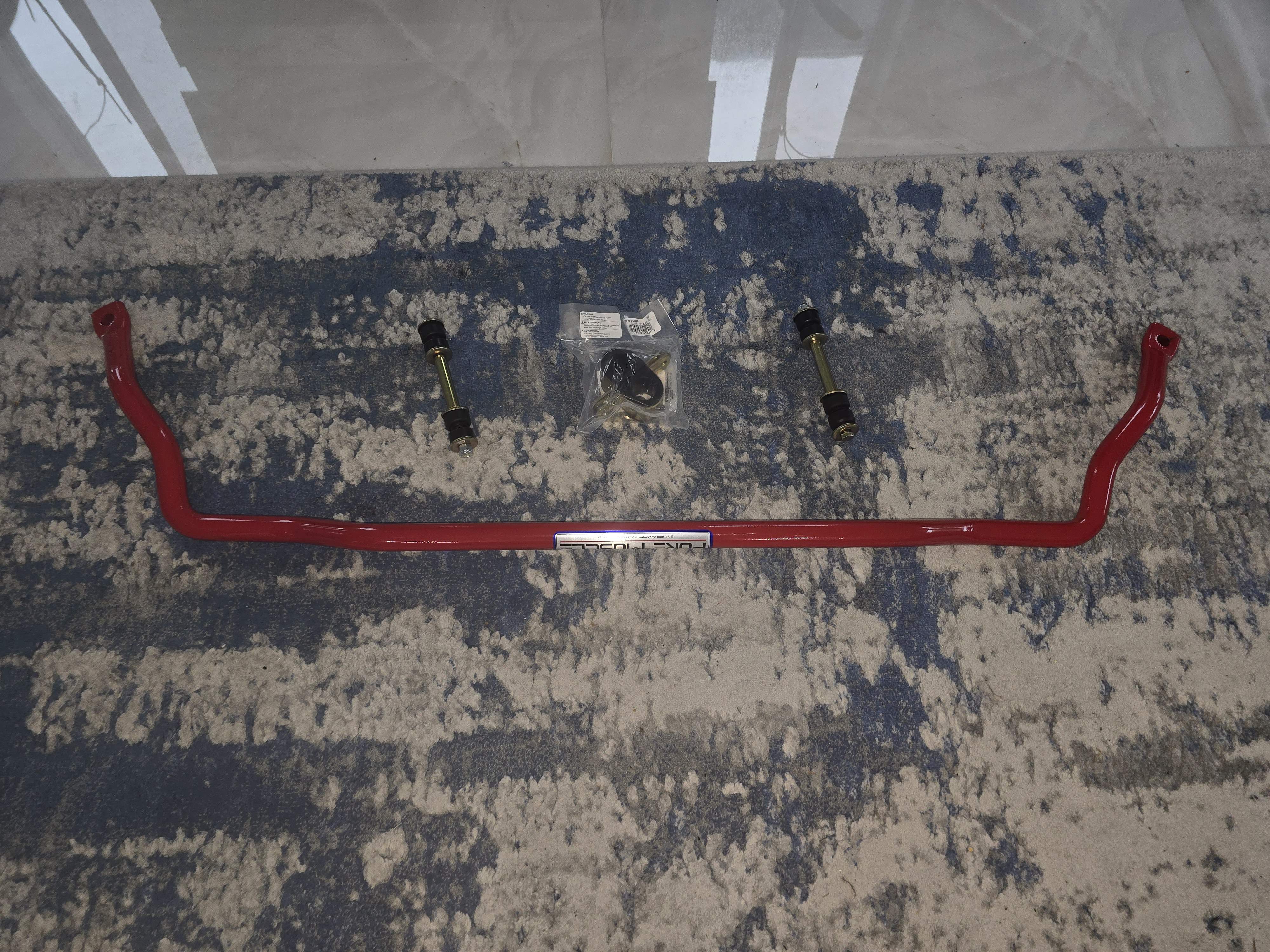

I just received the front sway bar for my 63 GP will be installing it this week... to match the rear sway bar. I was not able to find new bushings for the front bar and it is made a a smaller diameter bar than this one... I hope it will perform better with the correct bushings and thicker bar...

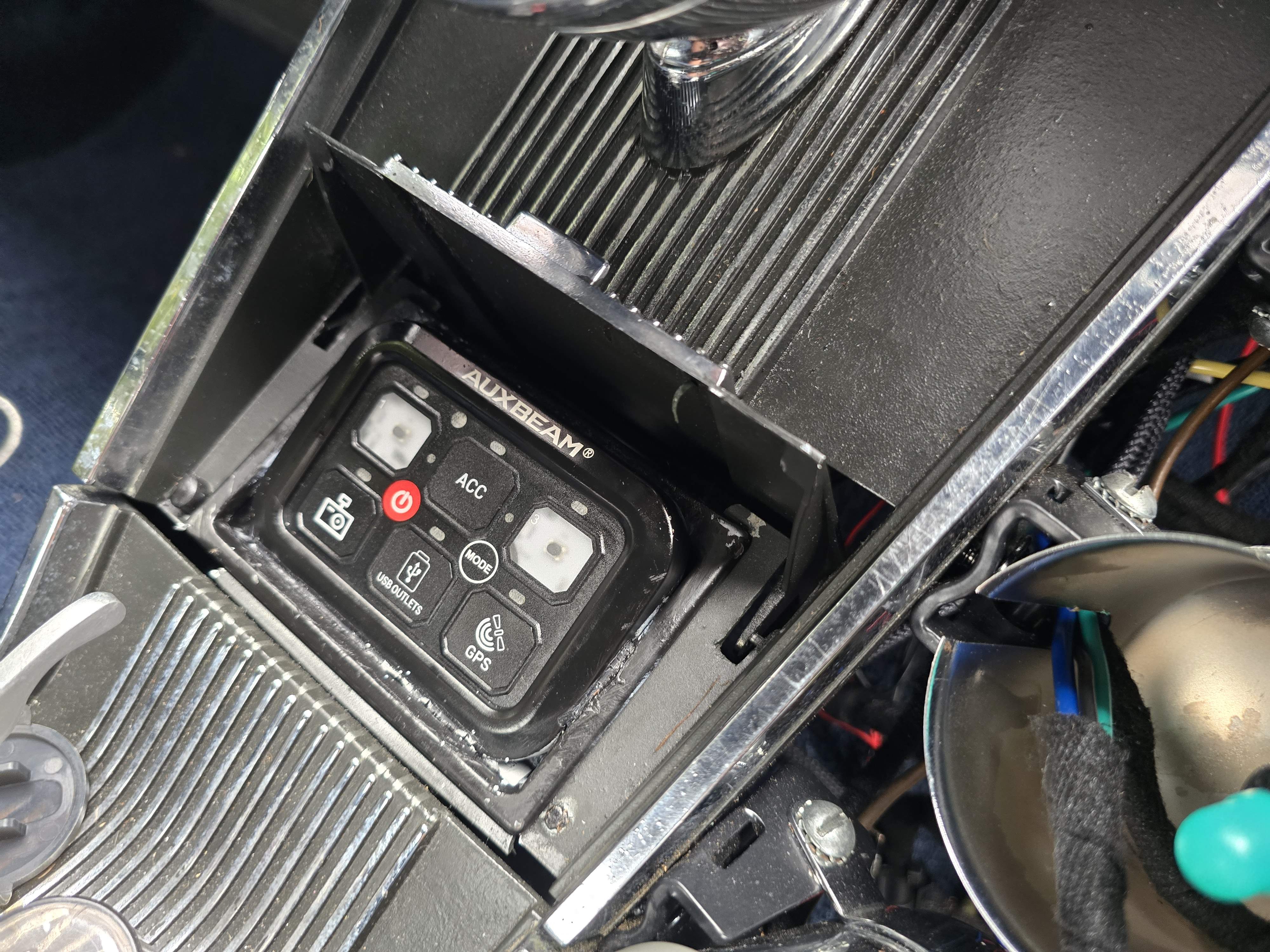

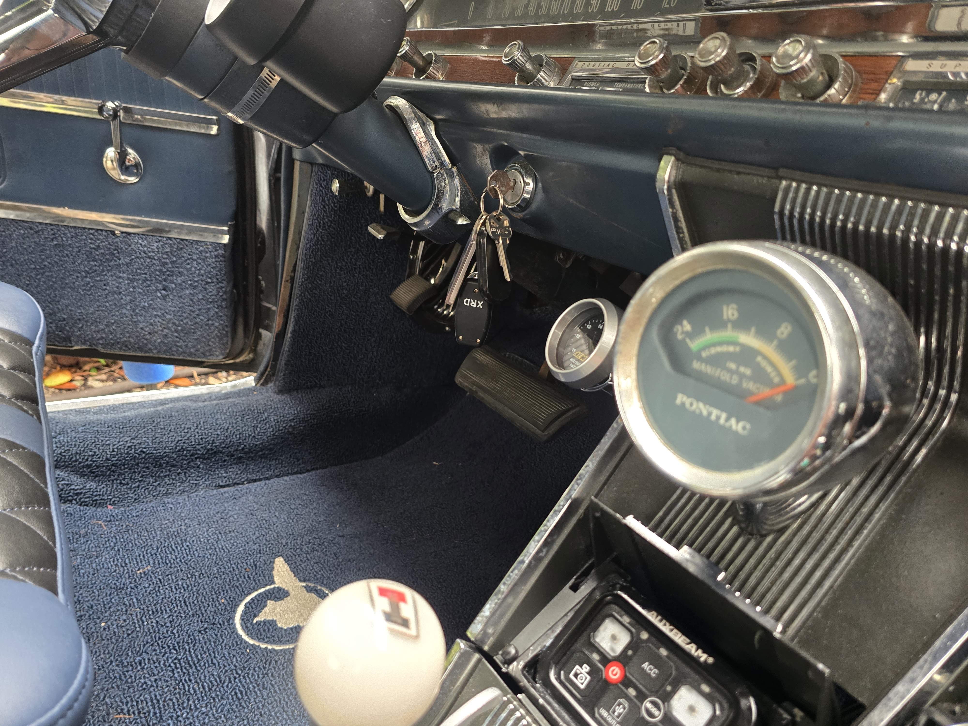

I also added a Bluetooth Marine stereo on the glove box and an Android rear view mirror with GPS / back up camera. To power those devices + the extra gauges + the future A/C system I added a jeep style 6 gang switch panel that has everything in one package fuse block, relay and switches it works perfect and fits on the ash tray perfect. The only cable connected to the original harness is a small ignition on signal wire. The positive and negative go directly to the battery and the kit comes with a circuit breaker as well.

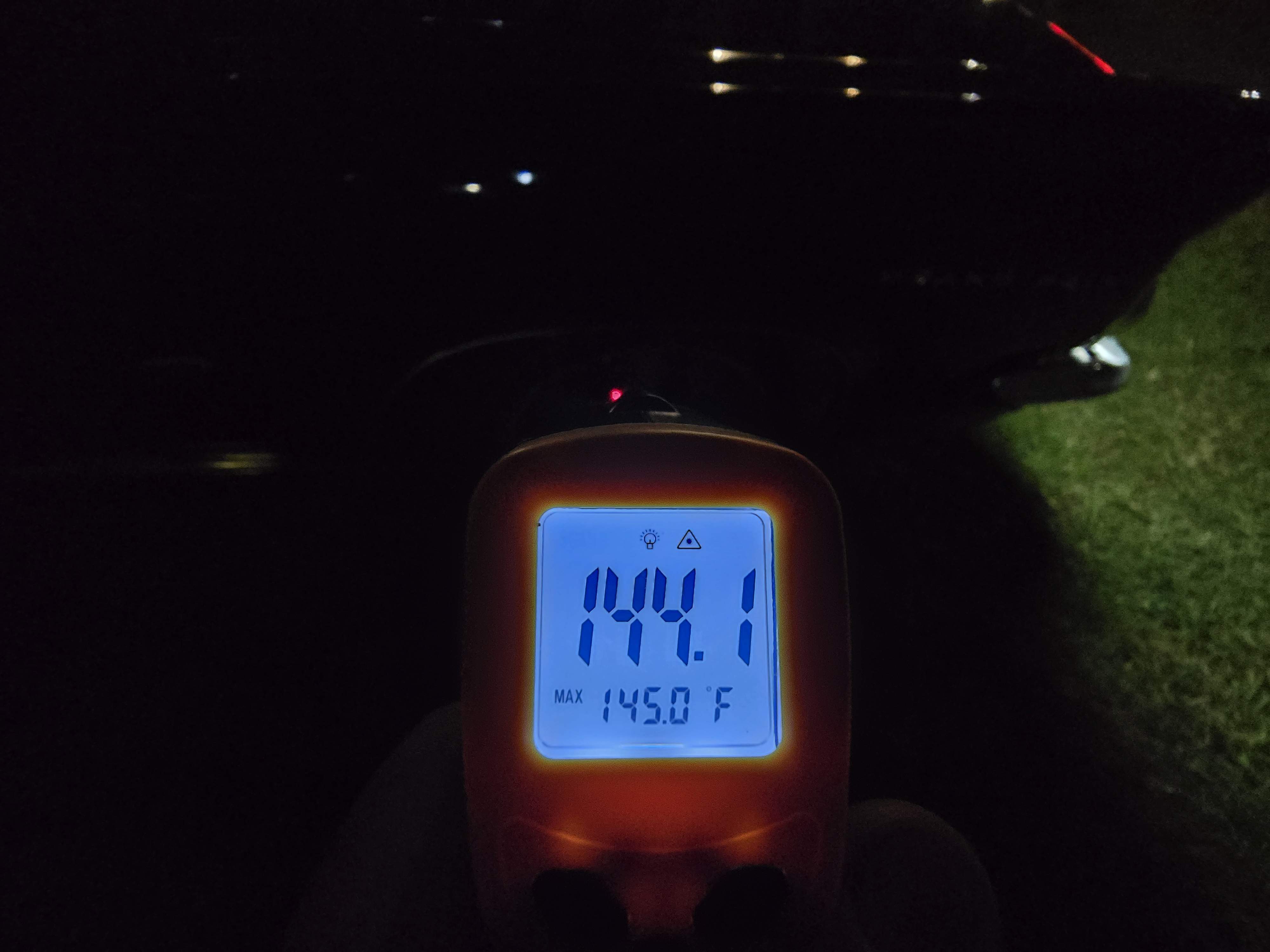

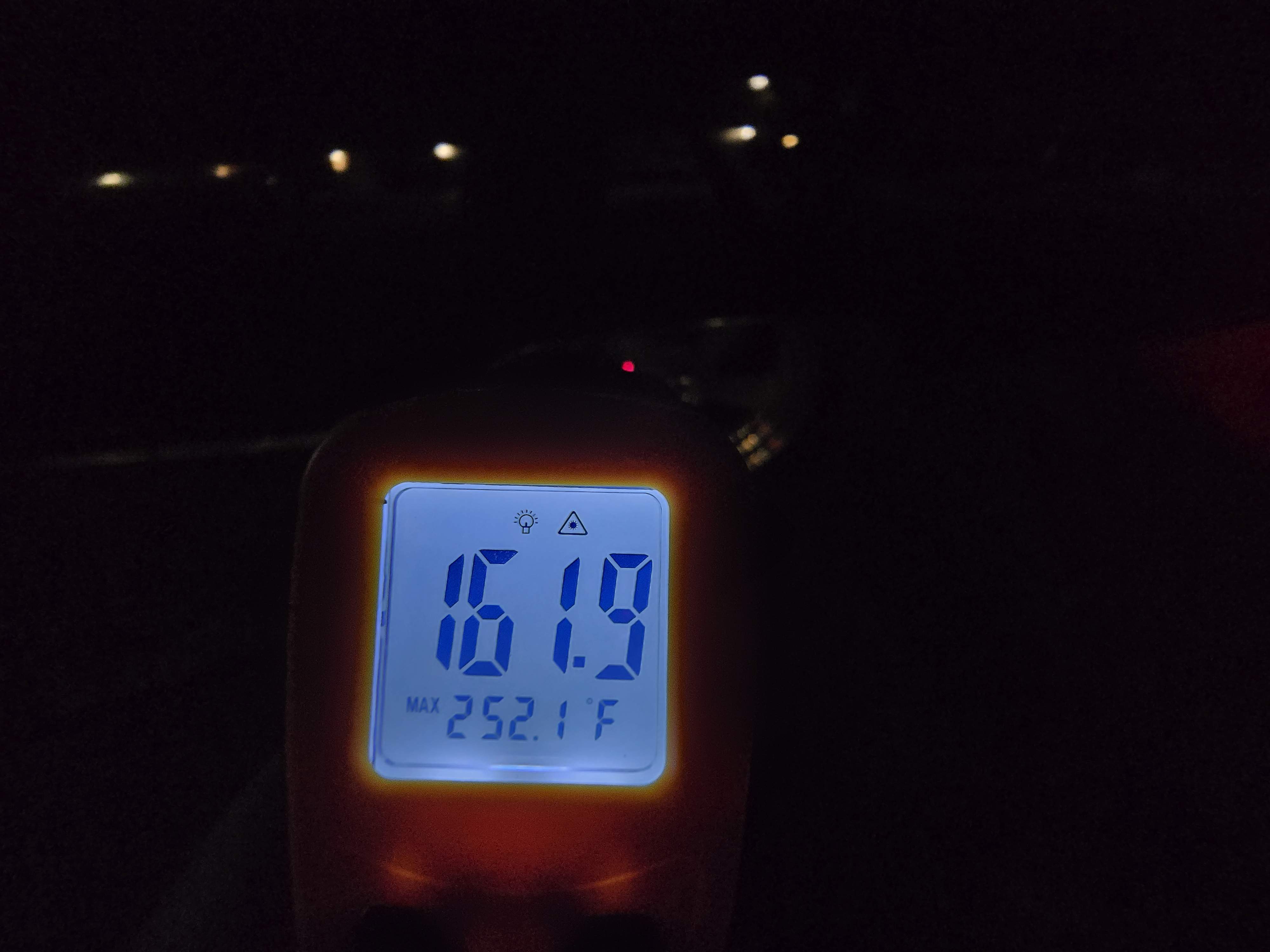

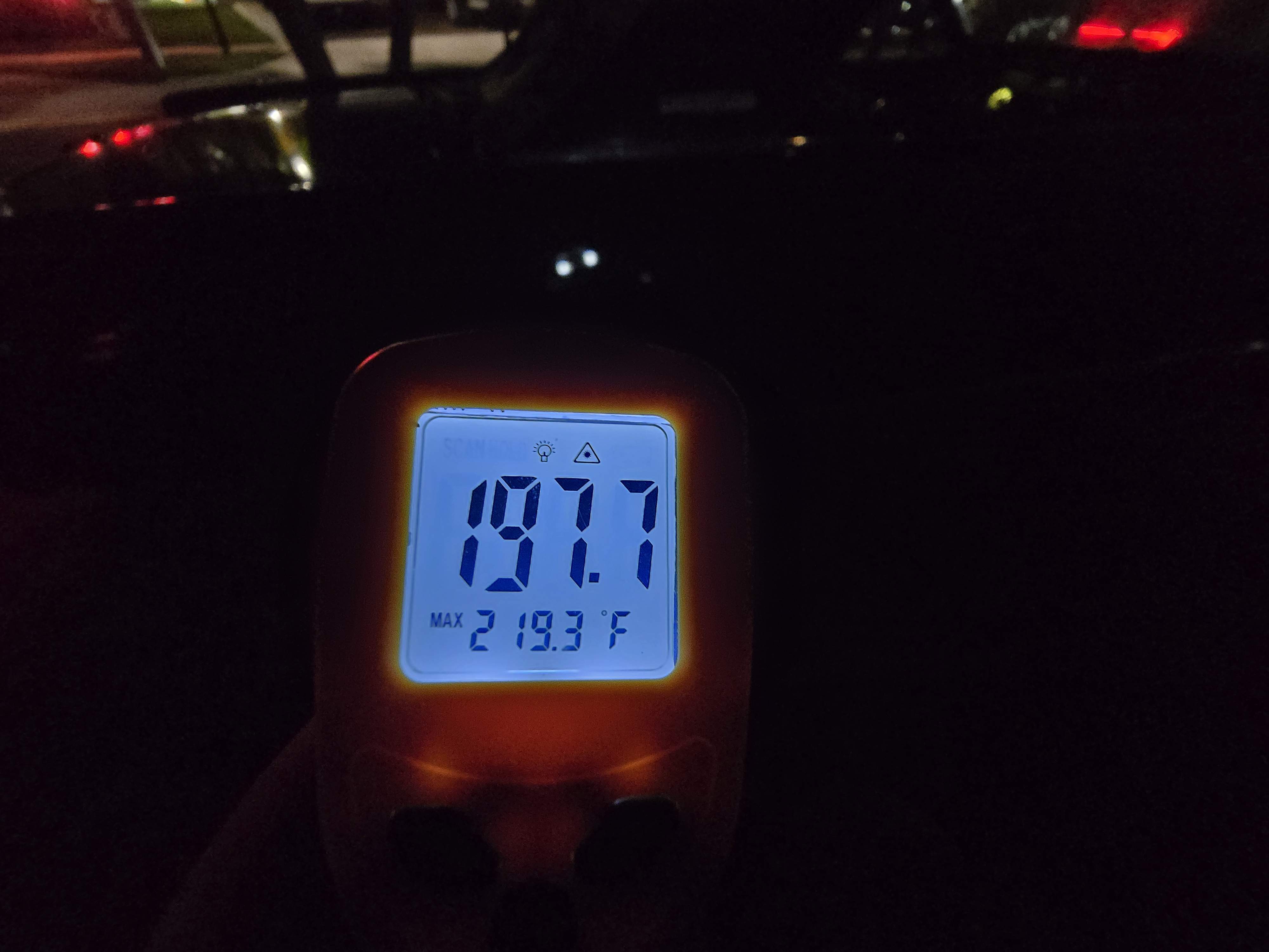

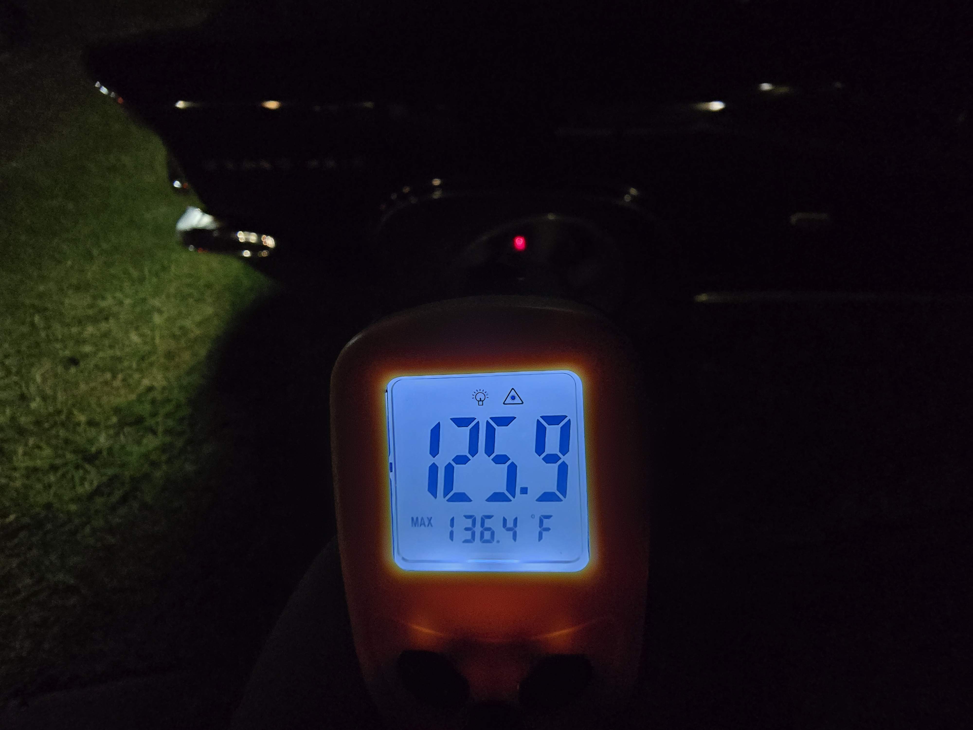

I took the GP for a drive today and it overheated after I got stuck behind some extremely slow cars going around 10 mph for like 10min. I stopped waited for it to cool down and drove it back home with no problems. The funny thing is that if I let in idle in park it never overheats it is only when I am driving slow. One other think I noticed is that one of my rear drum brakes was extremely hot and I could smell the burnt shoes maybe that is just enough effort on the motor to bring the temp up and cause the overheating?
Here are the temps on the brakes rotors/drums... the higher temp ones are the rear drums
Could be your issue Ron, you might need to clean up the self adjusters and justA go through the whole set up to be 100%
Damn she looks good though bro!
Thanks 64 kiwi boni, I will check in the next couple of days...
