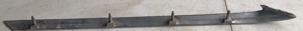

Hello everyone it has been a couple of months since my last post... I hope you guys are doing great and making progress on your projects... I need to remove the Exterior Belt Molding Trim, have you guys removed those do I need to access the pins from inside the car or they will slide out with pressure... I will also need to remove the lower back window trim, I have a small rust point and it is letting water into the trunk
