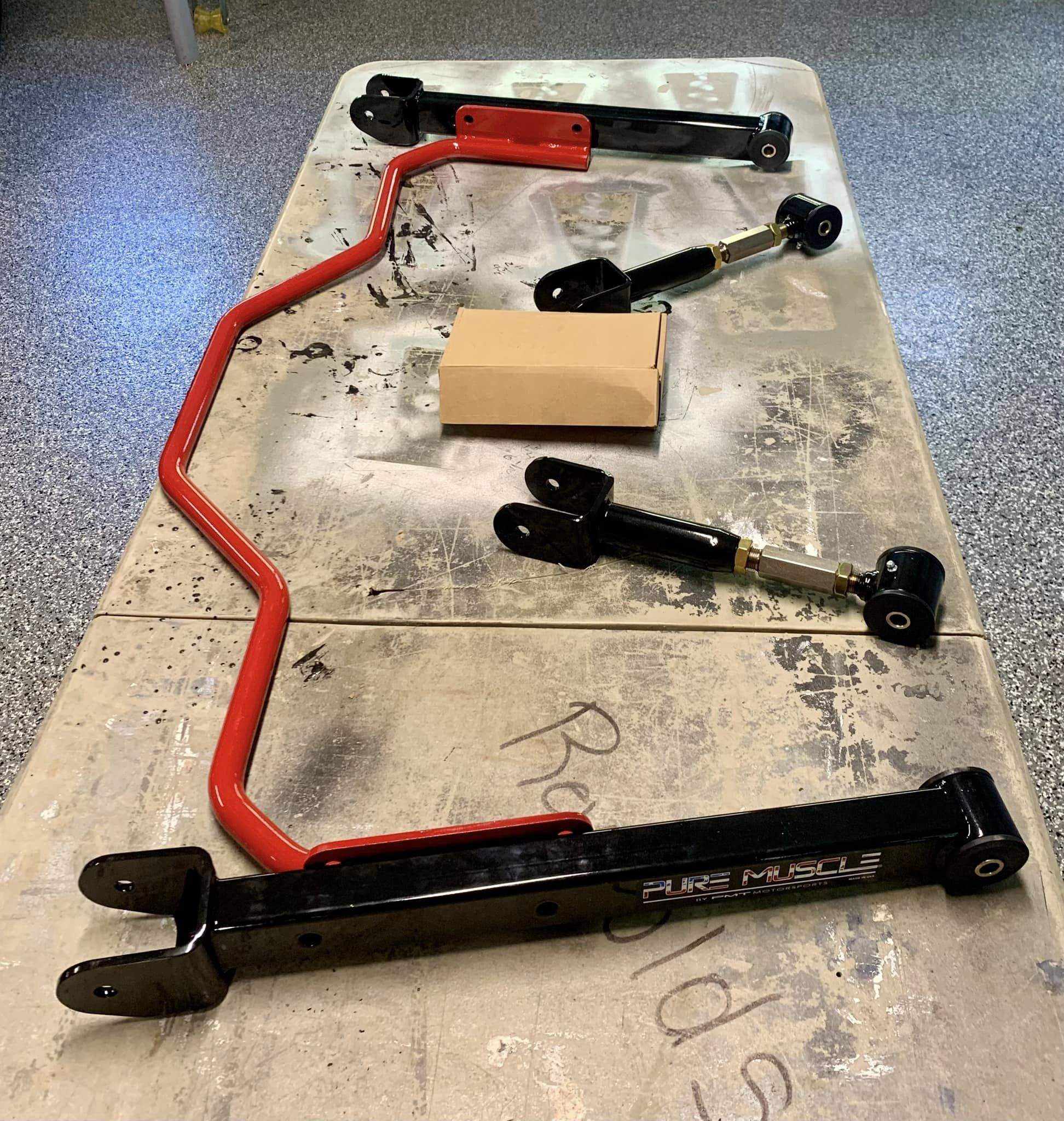

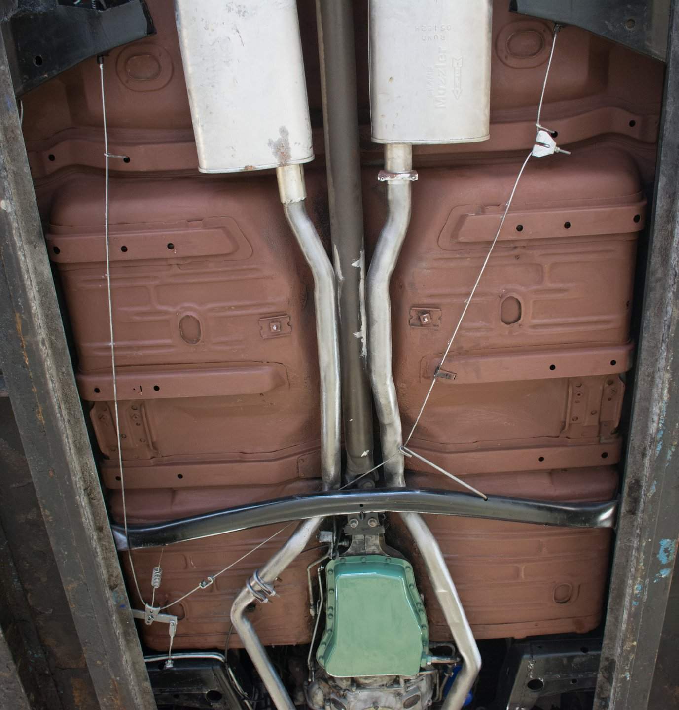

    I thought so and they were not that much extra... and these trailing arms will accept a sway bar. NOT my picture I got it from another forum and saved it. I think that setup is for a 65 gp

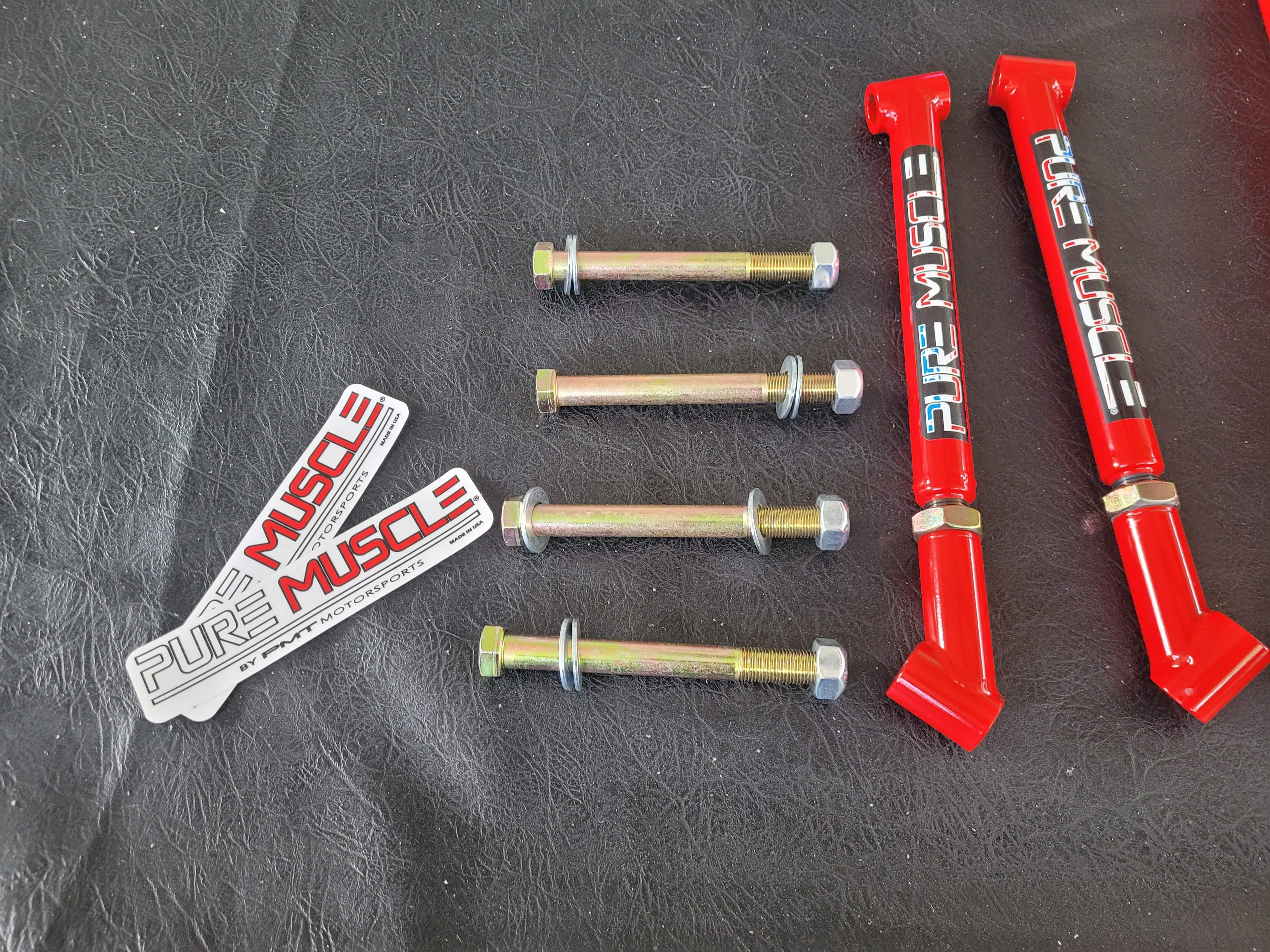

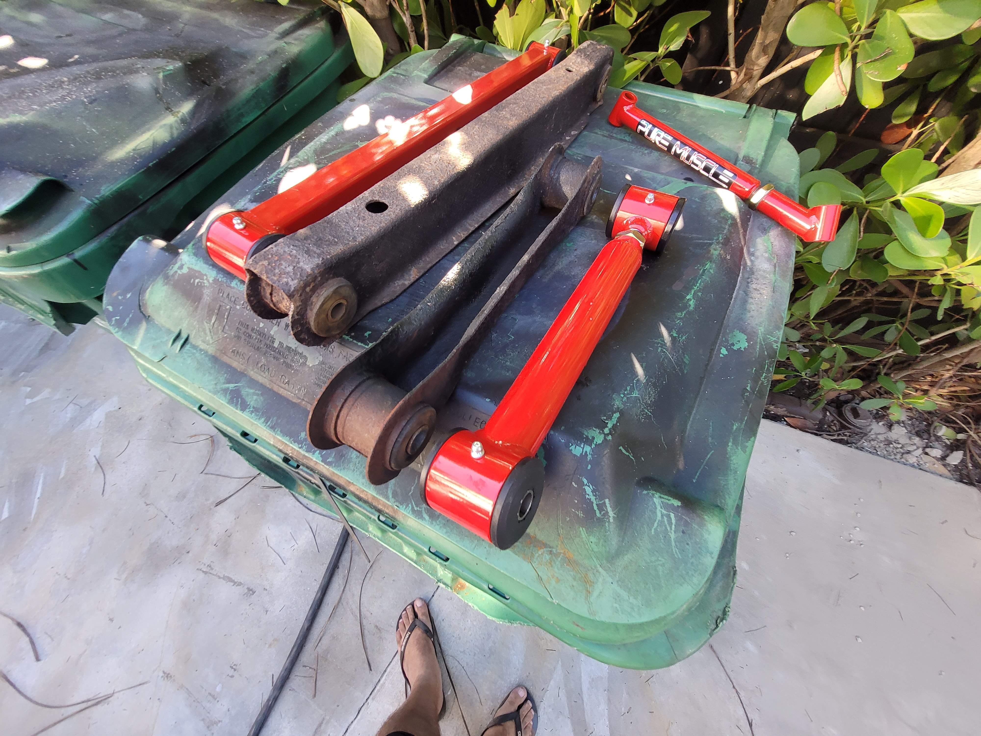

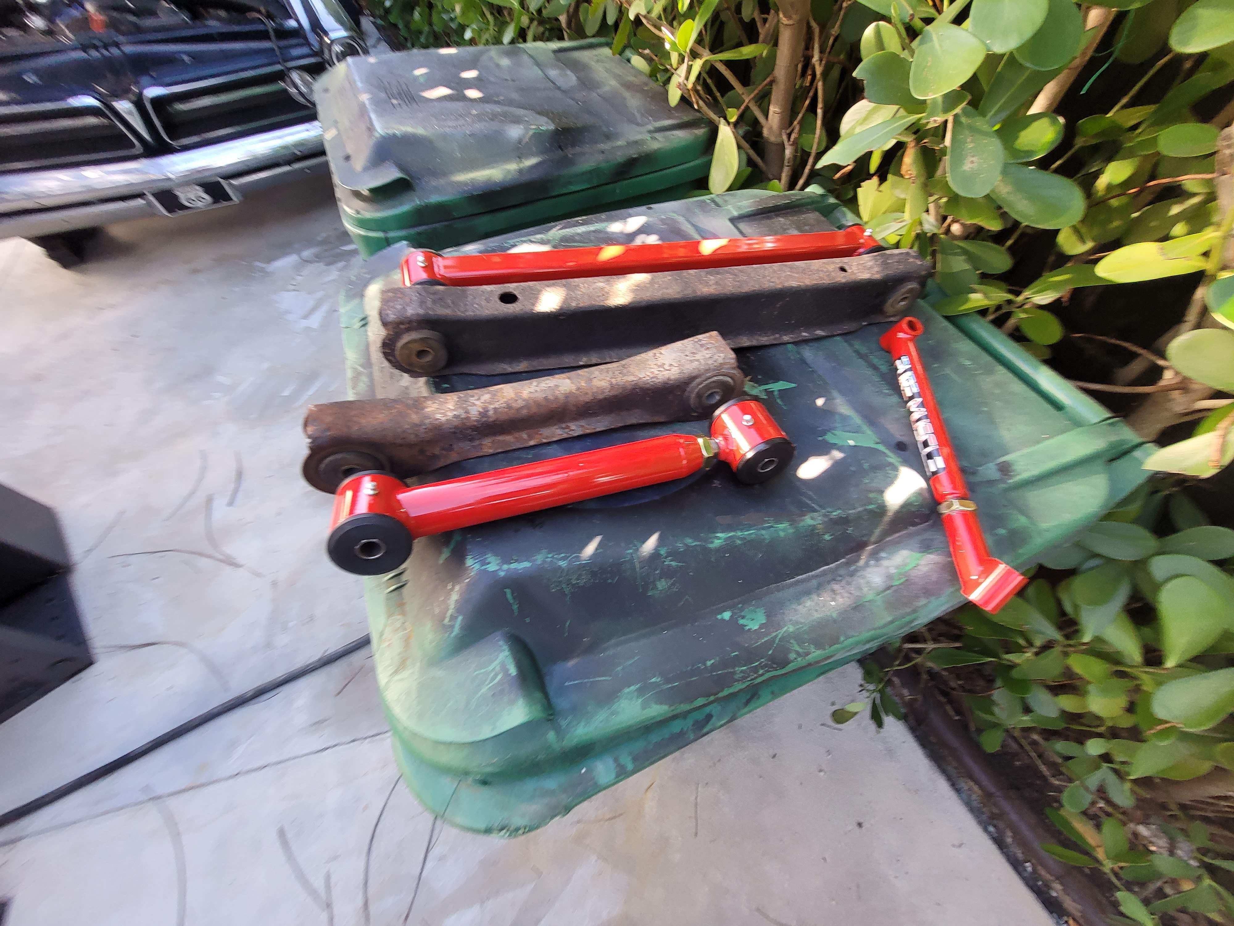

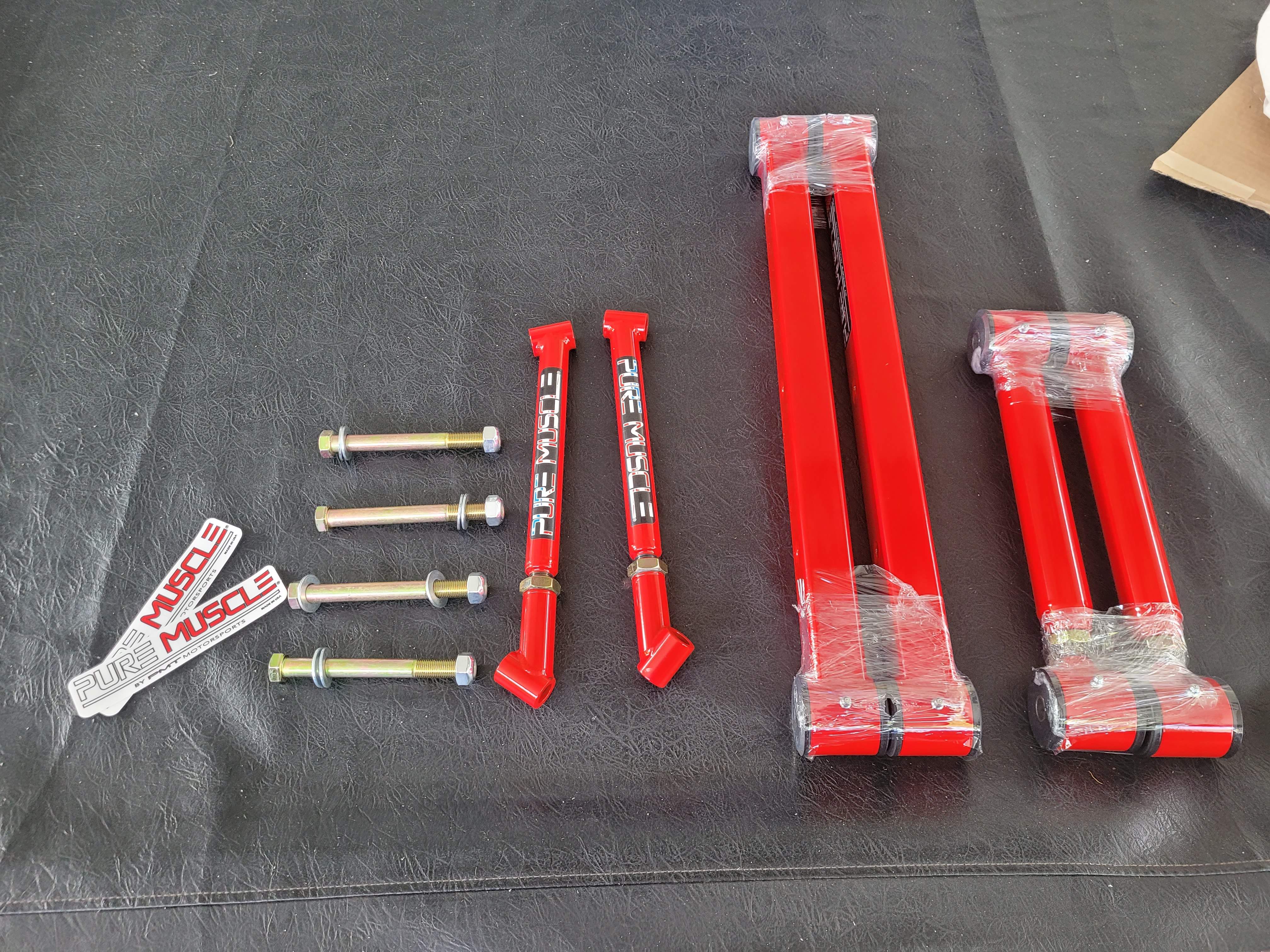

Hello everyone,
Finally received the trailing arms for my car from PMT they look great, waiting to receive the rear sway bar now to install everything.
The trailing arms look great!!
Ron, they look very sexy !! what are the bottom one with the angle on them for ????
Yeah it will make a huge difference on how the car looks under there... almost no one will see it but I will 🙂

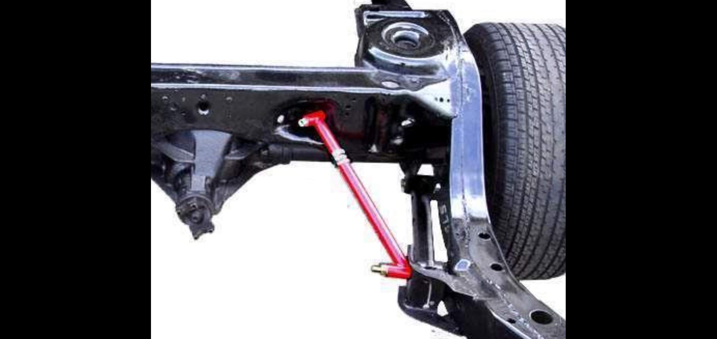

That last phone is for an extra support see pic
wow ! now thats a great idea !!!

Going to use this picture as a guide to install the cables for the parking brakes. I am missing the springs and the arm that comes from the transmission crossmember to the cable on the passenger side, I bought some stainless steel rods from amazon to try to bend and make a custom arm like the one in the picture

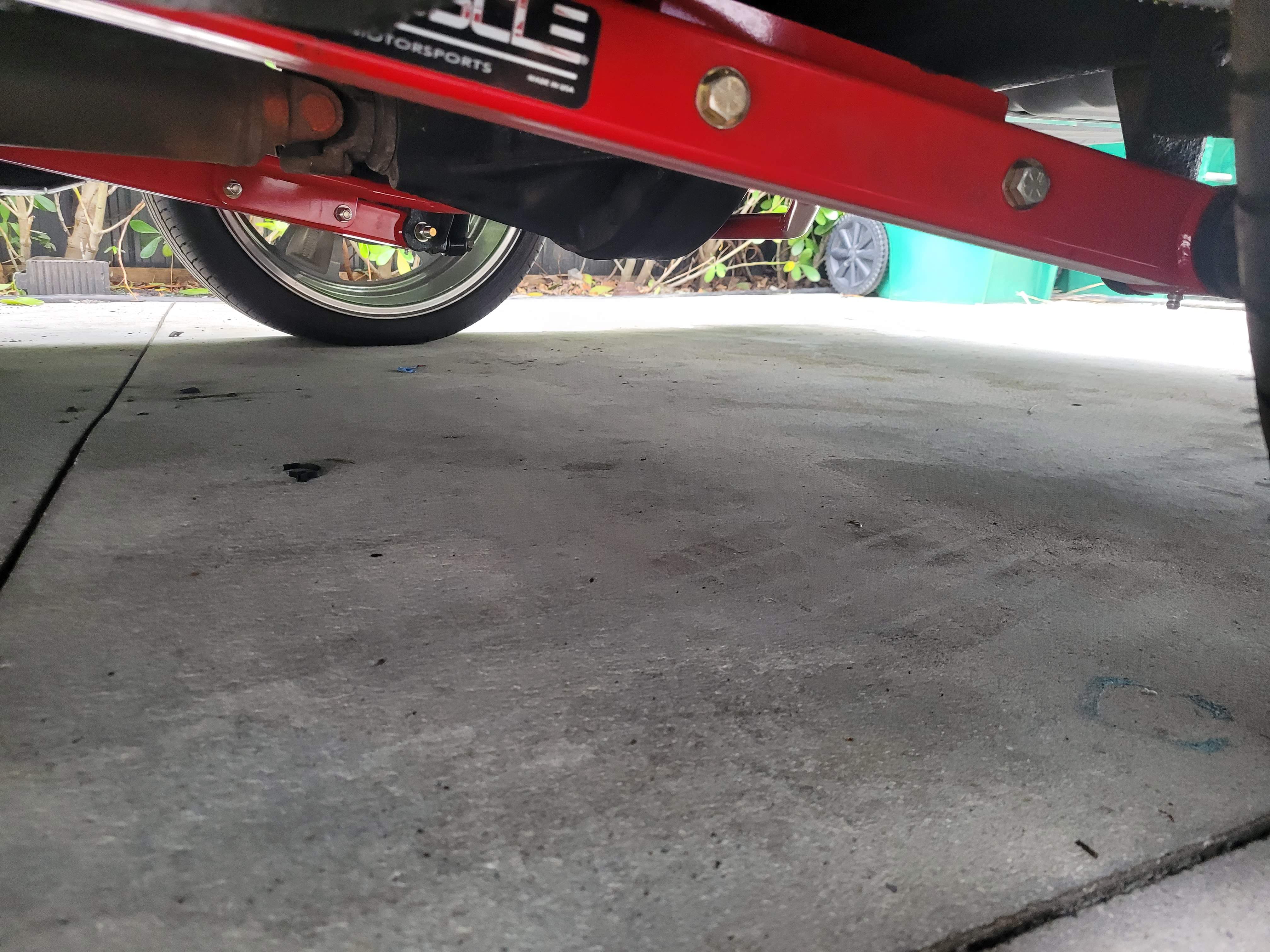

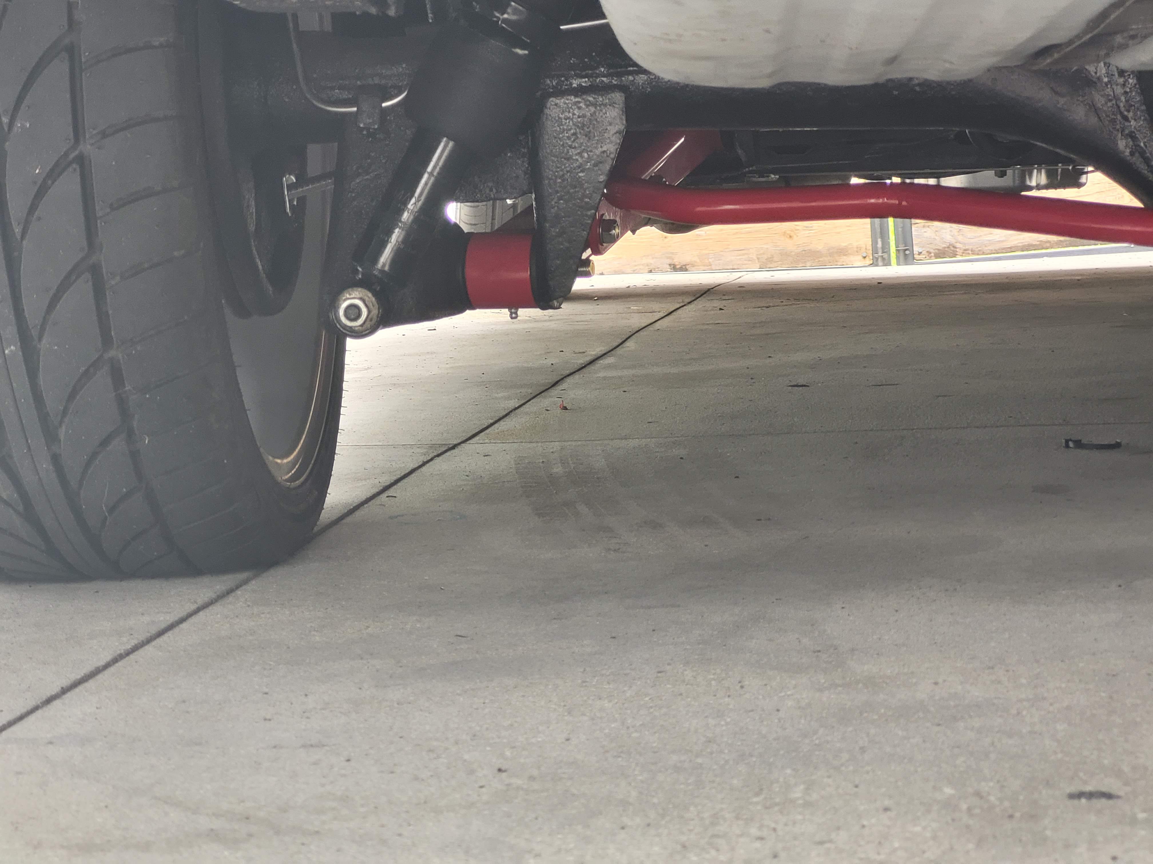

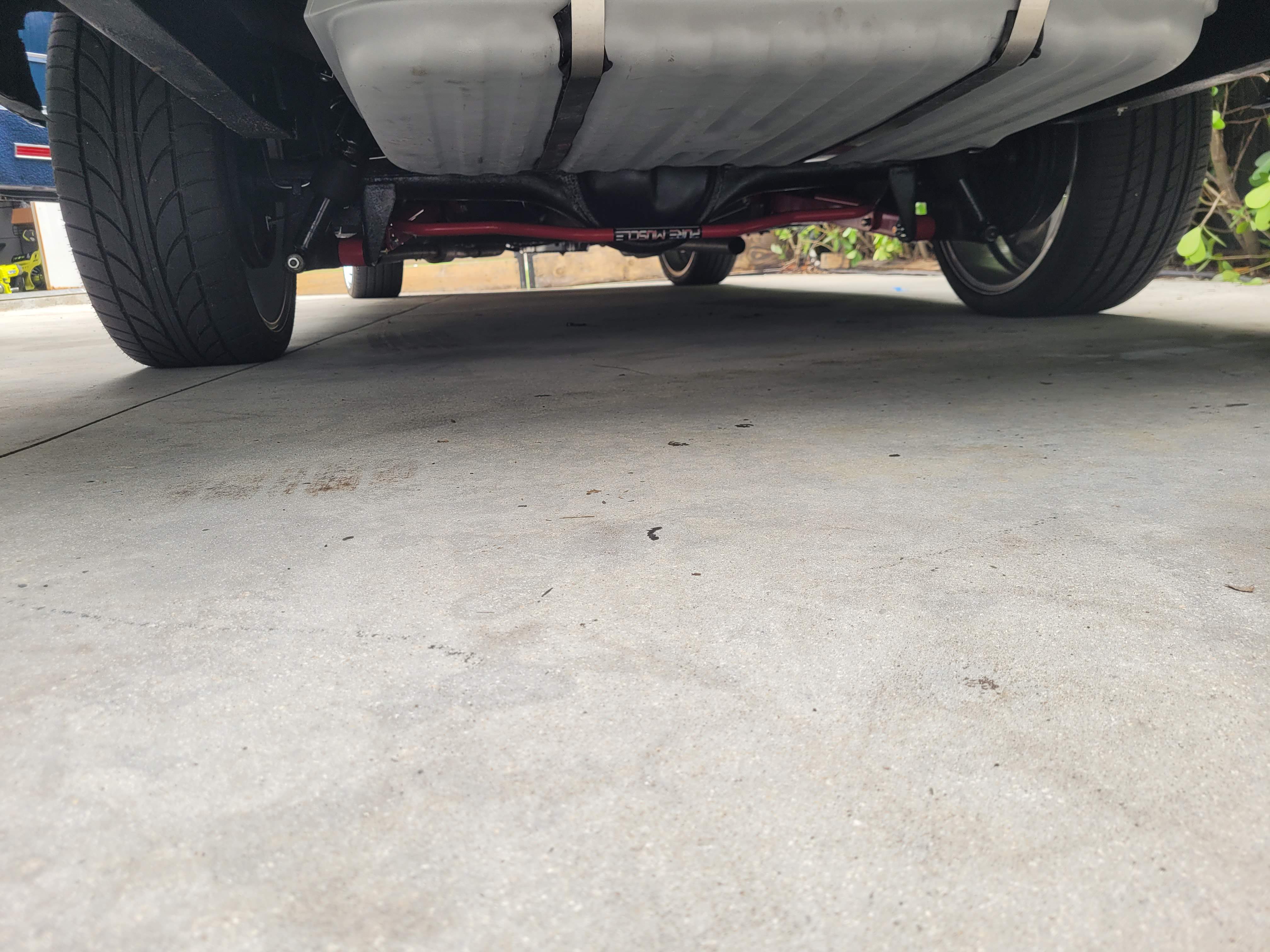

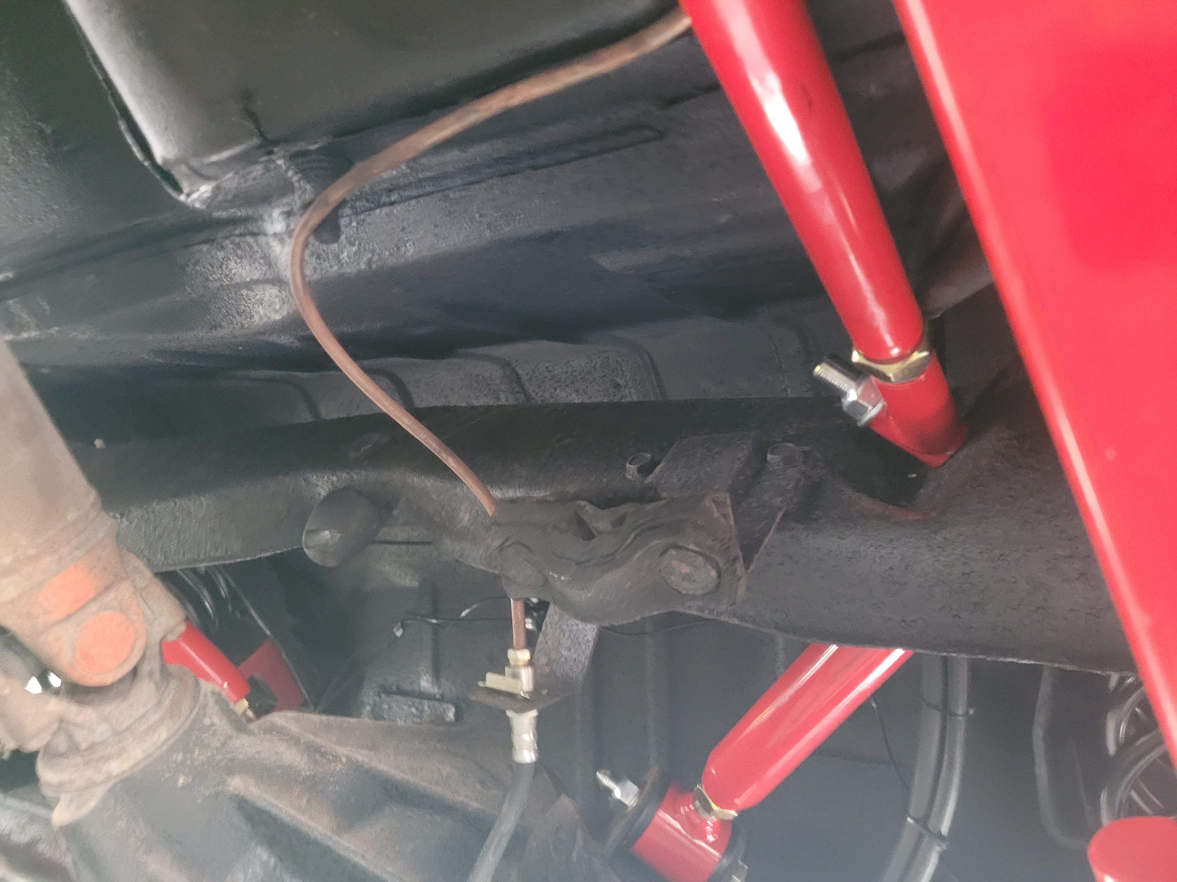

Got the trailing arms + sway bar installed + the new parking brakes cables this weekend... Also installed the Airshocks on the rear. Car handles completely different what a change on corners..
very cool Ron :dancingpontiac:
and i see how those braces work from top mount down to bottom mount :cheers:
i do like the size of that sway bar Too !!
Yeah that was the main reason I got this kit to have that extra support on the frame and the available sway bay with an easy bolt on... They also have an upgrade for the front sway bar not sure if it will make any difference on the front suspension since there is one there already from the factory.
