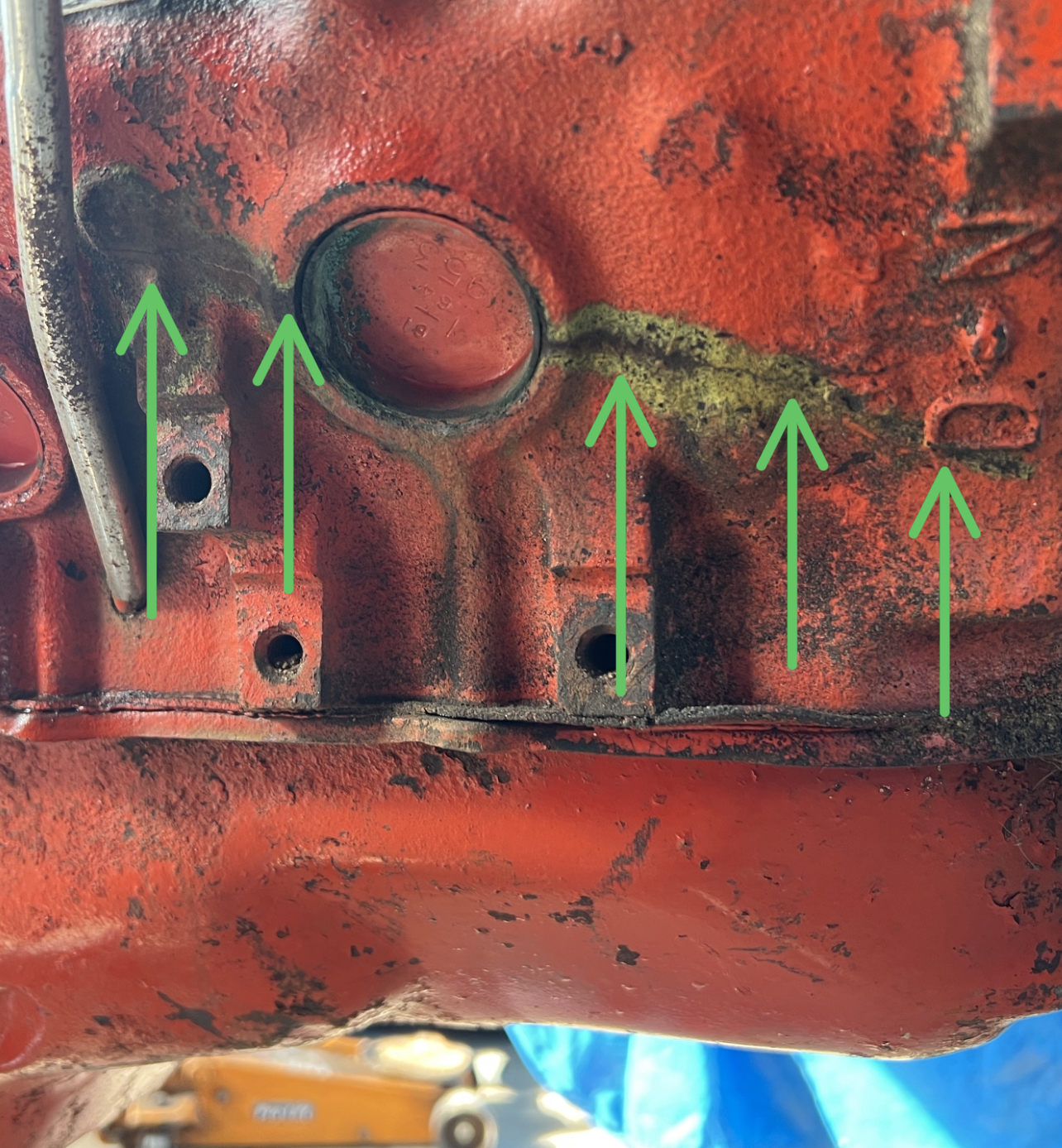

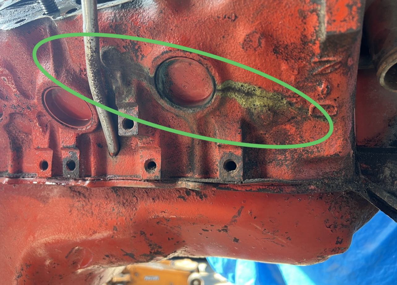

Cool, it took me over 12 months T find this old motor & the owner had no history on it. A complete gamble for $1000 (AUD). Still I would have paid the $1K just for the head if it came down to it. What the video didnโ€™t show was the crack in the block (I ainโ€™t no mechanic) so I missed this crack crap!ย

Ok, for instance, thatโ€™s the water jacket side. So you will, presuming itโ€™s not something you do, find a shop that knows how to weld cast iron, it take a special welding rod. The expansion plug will need to be removed. The crack will need to be grooved the entire length & even into the plug area. Than the plug area will need to be rebored to the proper size so a expansion plug can be re installed. Additionally before doing this the block will need to be clean thoroughly to remove any contamination of oil & antifreeze that might effect the adhesion of the welding.

yip that block is toast!

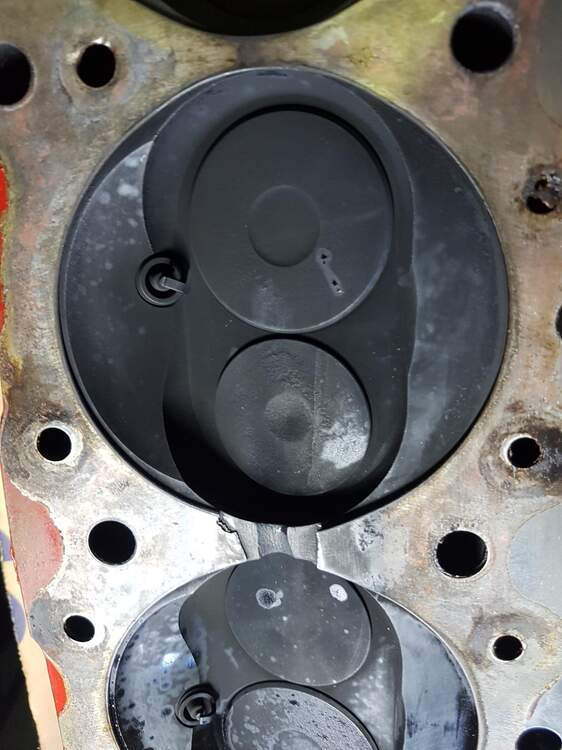

Below is a of photo why I find myself in this predicamentโ€ฆ the offending headโ€ฆ

The question i would be asking, is .... where are the other cracks!ย
and thats a job for a machine shop that can magnaflux the block after its cleaned.

Thatโ€™s from running non leaded fuel & not using an additive to resolve the lack of no lead in the fuel!
