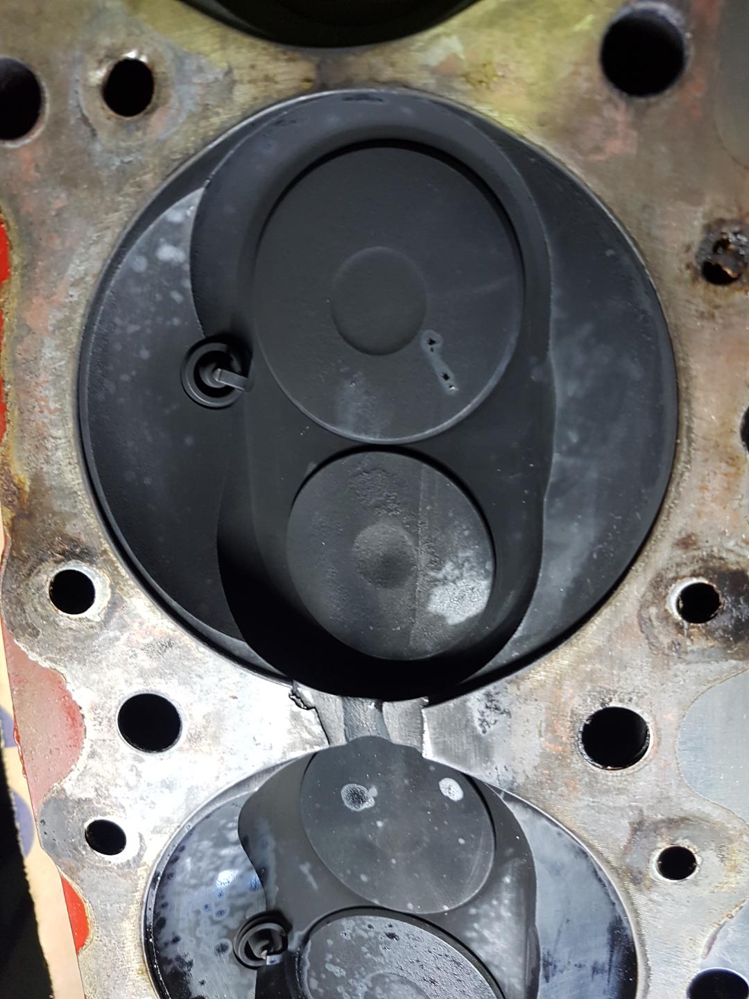

Below is a of photo why I find myself in this predicament… the offending head…
Β
Again, even that is fixable! But you are correct to take the best path that fits your budget. I’m JustA saying, (that’s a term we use here because of our buddy JustA6), those parts in a world of ever depleting & limited parts of their kind have value because they can be fixed!Β

This head with the blowout between the two cylinders can be fixed BUT finding someone with the skills that’s prepared to do the job here in Western Australian has been fruitless! They have ether retired or not interested to help! That’s why I tried my luck buying this secondhand motor I previously posted.

Oh I guess I should clarify that statement a little better! Unleaded fuel of itself really has little impact on old cylinder heads or engines for that matter! Once the change to unleaded really gained ground the OEMs, through extensive testing, found it became evident the valve recession could occur under the right conditions. So the switch to hardened valve seats came to pass.Β
The real problem though was & is alcohol! Before unleaded it was rare to have alcohol in fuel & if it did happen, it was usually short lived. As leaded fuel disappeared & the ill informed tree huggers grew so did alcohol in the fuel.Β
So it goes like this, alcohol in the fuel in a non computer controlled car typically causes a lean mixture, which cause combustion & heat issues! Also alcohol absorbs water, which along with the fact that it has zero volatility it also is incompressible! This raises cylinder pressures & can cause detonation due to an unstable fuel mixture. This is what Spikes engine saw & what caused the damage. Computer controlled engines due things to control these issues, but old school engines can’t.Β
For me alcohol in the fuel is a no no! First, & I’m not a tree hugger, it bad for the in environment for several reasons! Two it’s bad for combustion engines! And three it’s not cheaper!Β
This is why I use the additives that I do! One removes the alcohol from the fuel. The other replaces some of the needed chemistry that helps the combustion system.
So nearly all old lead burning engines can burn unleaded fuel without issue, but alcohol in the fuel not so much!
