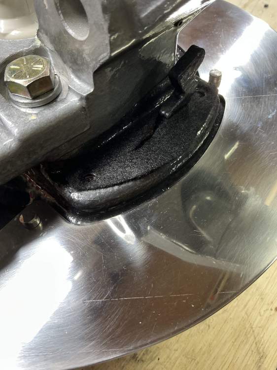

    Well I sqeaked out a few hours with Arctic freeze that set in. So I have just about finish all the mods on one side, including making a reasonable sealing setup for the parking brake, since there is n

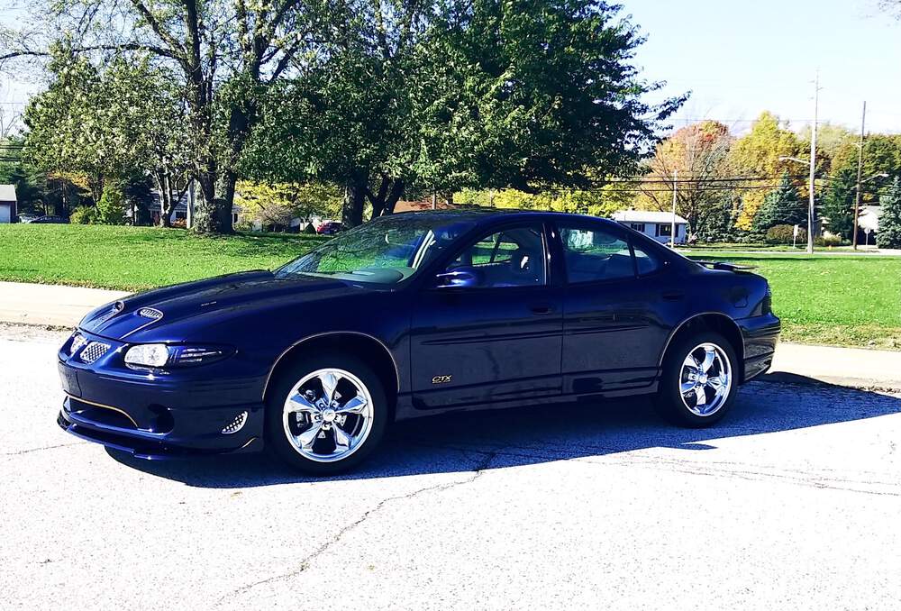

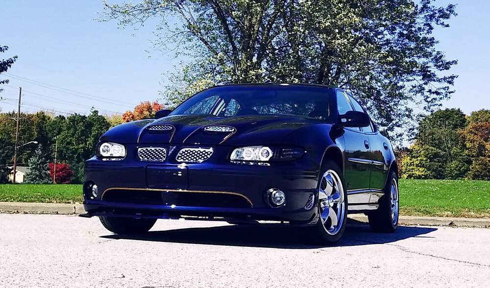

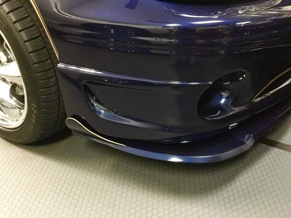

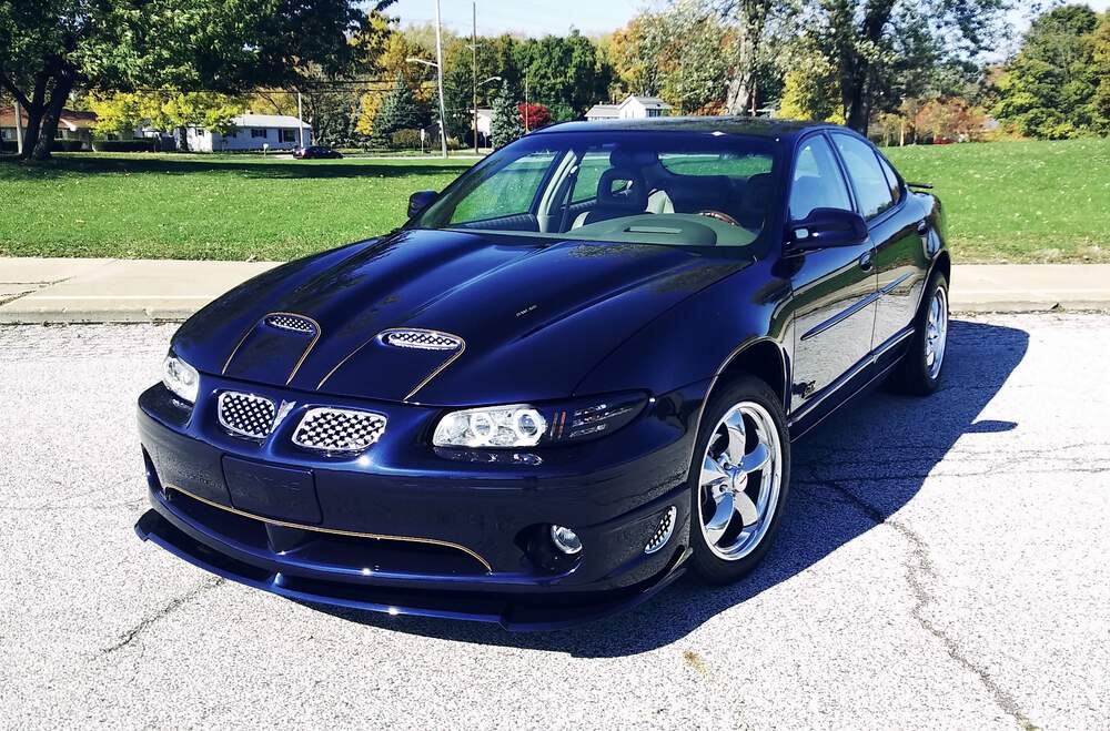

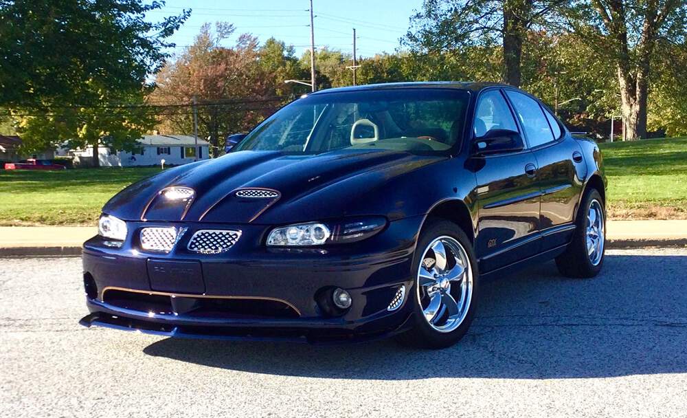

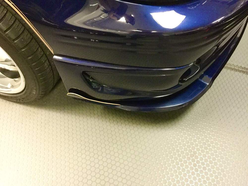

    Well this is the first look at the Indian with the new front cover/splitter/emblem! Not finished quite yet, but getting close. A couple more weeks. Really weird to have it on the ground after 10+ mont

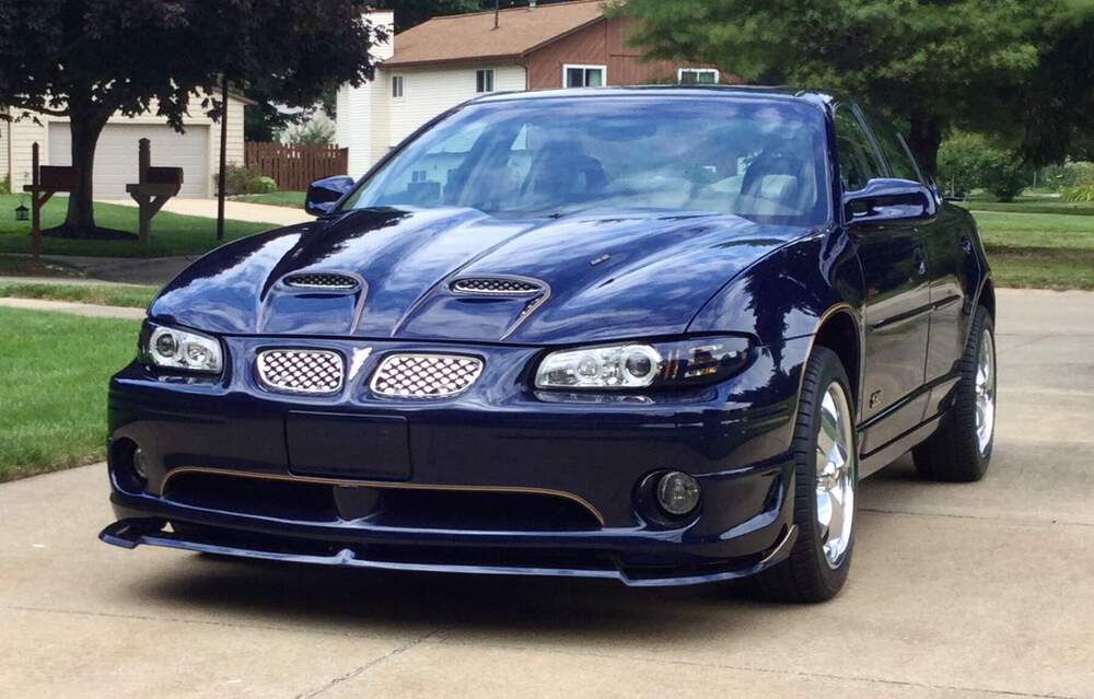

    We just had a unusually warm day Wednesday, 73 degrees here for a high. So I got a chance to paint the polycarbonate cover that covers the spare tire/battery. That said I got a chance today to get a l
Well this is the first look at the Indian with the new front cover/splitter/emblem! Not finished quite yet, but getting close. A couple more weeks. Really weird to have it on the ground after 10+ months in the air! It’s usually on the ground by late May! Took it out around the block to see what the new NACA duct setup and tranny cooler we’re like! It was well worth the work, that’s all I can say! Been a strange year! Still have the inserts for the front cover to finish, as well as the plenum cover and still need to install the interior racing foot pad!
Fantastic work.  Could stare at it for hours.
You will! Beats doing any work around the house!
Last Indian.....:bowdown:
 fantastic work:cheers:
Great work Last Indian. Gorgeous as always!

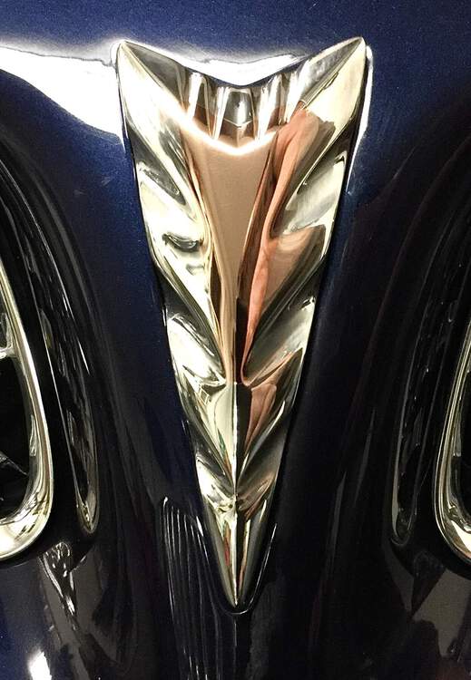

Plenum cover/cooler is done. The real purpose of this upgrade was two fold. One I wanted to take more advantage of the F.1 hood for cold air induction on the plenum now that the new ram air NACA duct was added to the front cover. This cover sits as high as is possible, without hitting the hood when closed, to get it in to the air stream of the F.1 hood scoops. This air is now diverted into the  open area of the cover. Than flows over the plenum and is extracted out through the top and back of the plenum cover/cooler. This reduces plenum air temp more than before creating a denser charge!
The other was  too have deeper finned top, a little more bold! So to speak.
Edited by Last Indian
Would take a mighty big hand to wear that jewlery.

last indian..... :bowdown:
Super impressed with, not only your Craftsmanship, but also your mentality around getting cold air into your engine to maximize your bang for buck !:cheers:
 And clearly your a very patient man.:bowdown:
 and geees it looks wayyyy cool to !:cheers:
Looks awesome bro!
