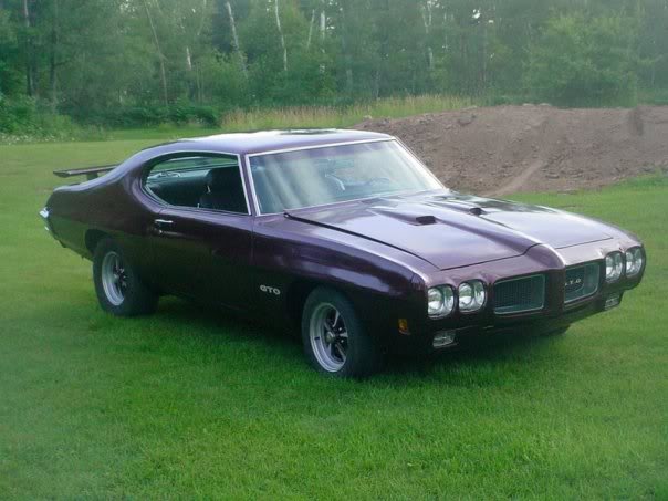

Heres a pic of it ghost. Its still uploading the album to photobucket and when it is done I will post the link here.
thanks. and thats very nice. i still prefer a '67.
why does the hood look lifted near the windshield?
Because the hinges are crap and I have yet to buy a good set

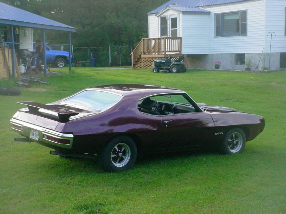

Hey not nitpicking just asking but why in some of the pics does the exhaust look so out of place and funny looking? Is it just a temporary one that you made? I could of swarn on those GTO the exhaust was tucked up and couldn't really see it except for the tips that hooked down from the bumper.
The exhaust is 3" mandrel bent and the tail pipes just didn't fit well, I have since done a bit of cutting and welding and got them tucked up in a bit better.
