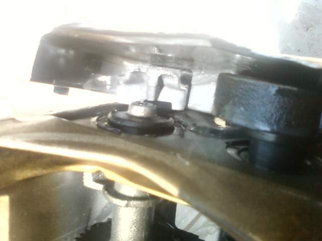

  • When my dad removed the old oil pump/balance assembly, this is what he found: It's a bad cell phone picture, but I think it's pretty obvious that the pump is shot! It literally self combusted. Th
It's a bad cell phone picture, but I think it's pretty obvious that the pump is shot! It literally self combusted. That would be a viable explanation for all of the metal we found in the drained oil.

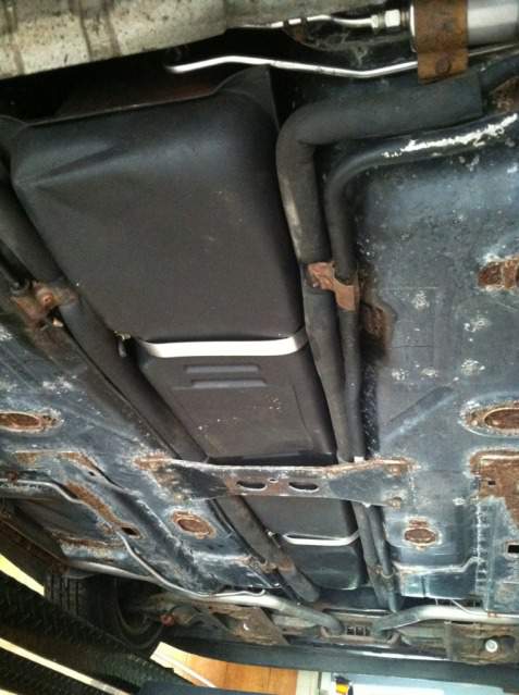

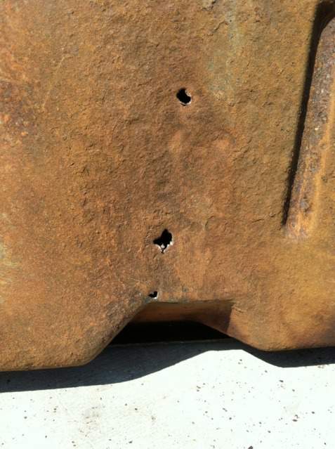

My dad put the new oil pump in and had to wait a week before putting the rest of the engine back together, filling her with oil, and starting her up. He managed to get her started up and didn't hear anything negative. However, I was still convinced there was going to be something wrong with the engine. At this point, the next problem presented itself: the fuel tank was leaking. I had completely forgotten about this issue, which had begun right before the oil pump went out last year. I went down to my dad's to help take the tank out and sure enough, we found the culprit:

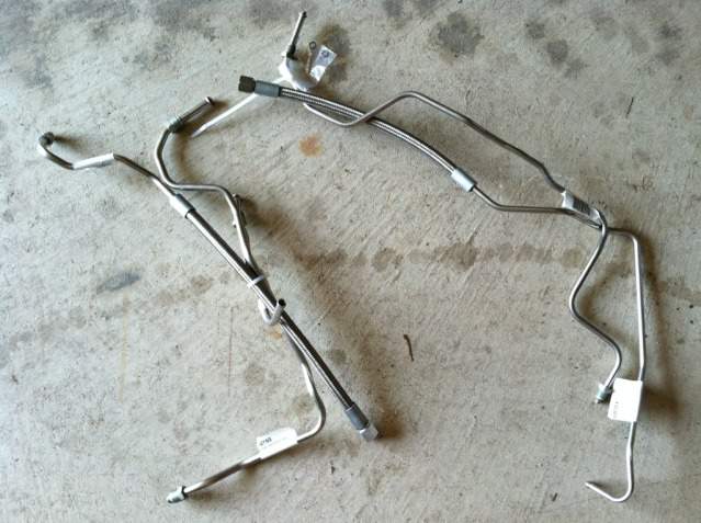

These holes were present all along where the rear tank straps rested. We decided that the tank wasn't salvageable, at least not immediately so, because the holes were so many and the metal on that part of the tank was so thin. We replaced the old fuel lines with new stainless lines and had to stop at that point since we didn't have a useable tank.
