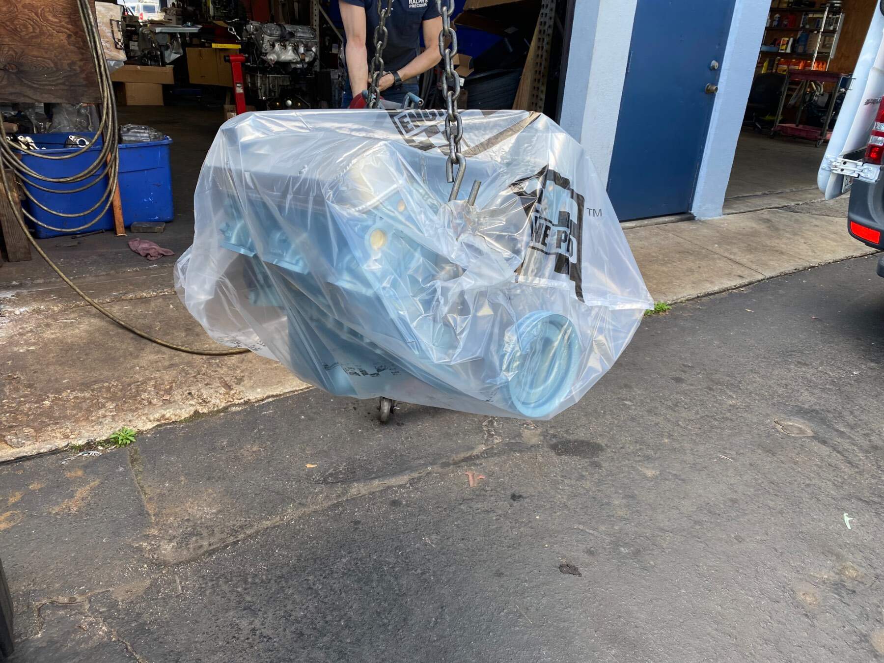

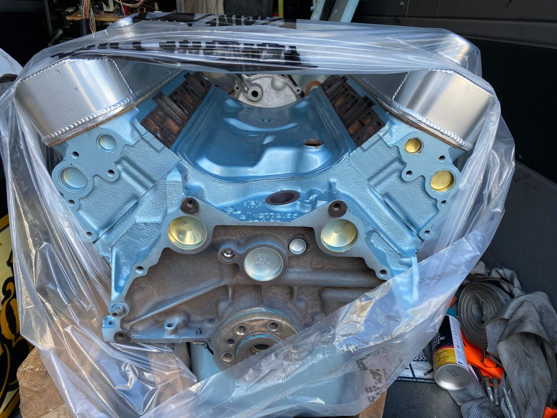

Picked up my original motor from the fresh rebuild. Can’t wait to install this baby
christmas all over again!!!:cheers:
Del - what's the info on the motor rebuild? Stoker? Cam? Heads? Estimated HP and torque? Details man, details!
I like to daily drive the car so I want it mostly stock. I don’t care for the deep idle that feels like a plug is out.  Original heads with new rocker arms. High performance timing chain. New pistons .30 over. Standard bearings. I added a mild cam and lifters from edelbrock.

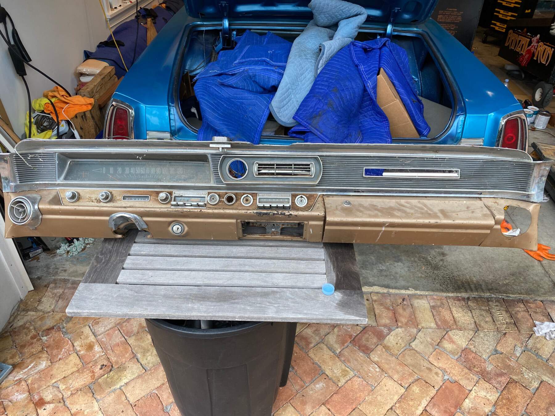

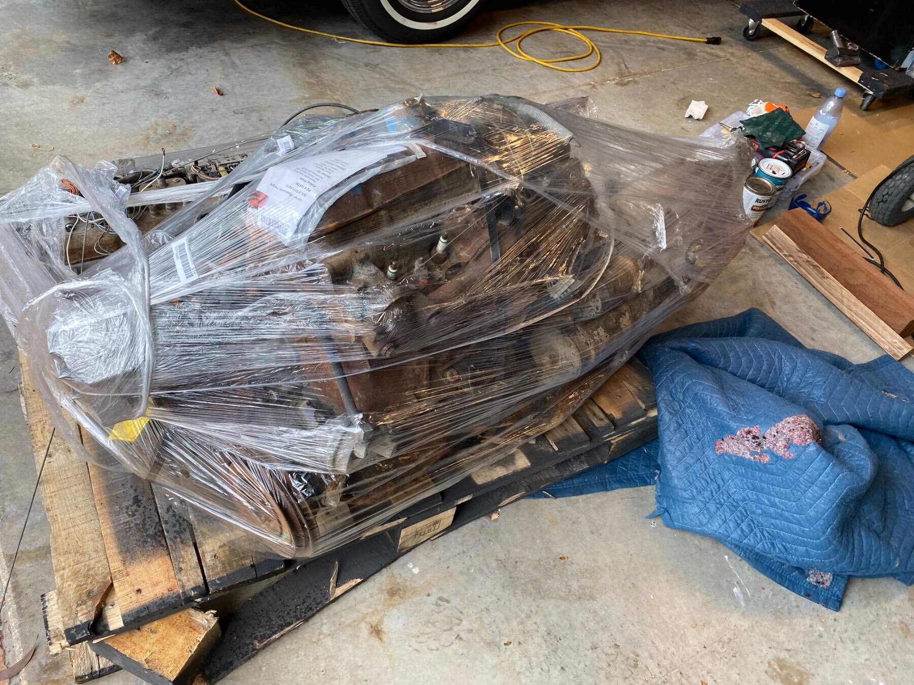

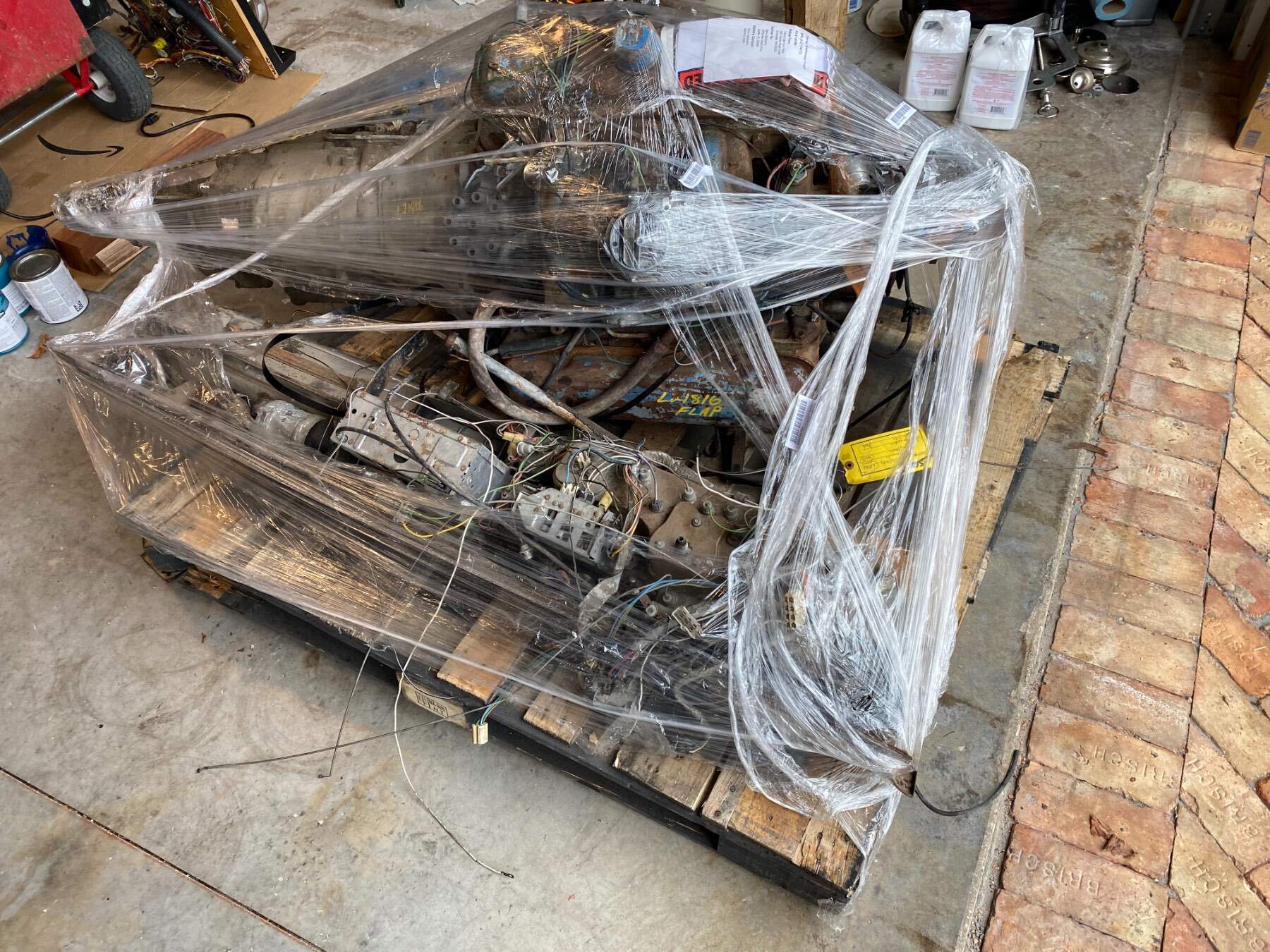

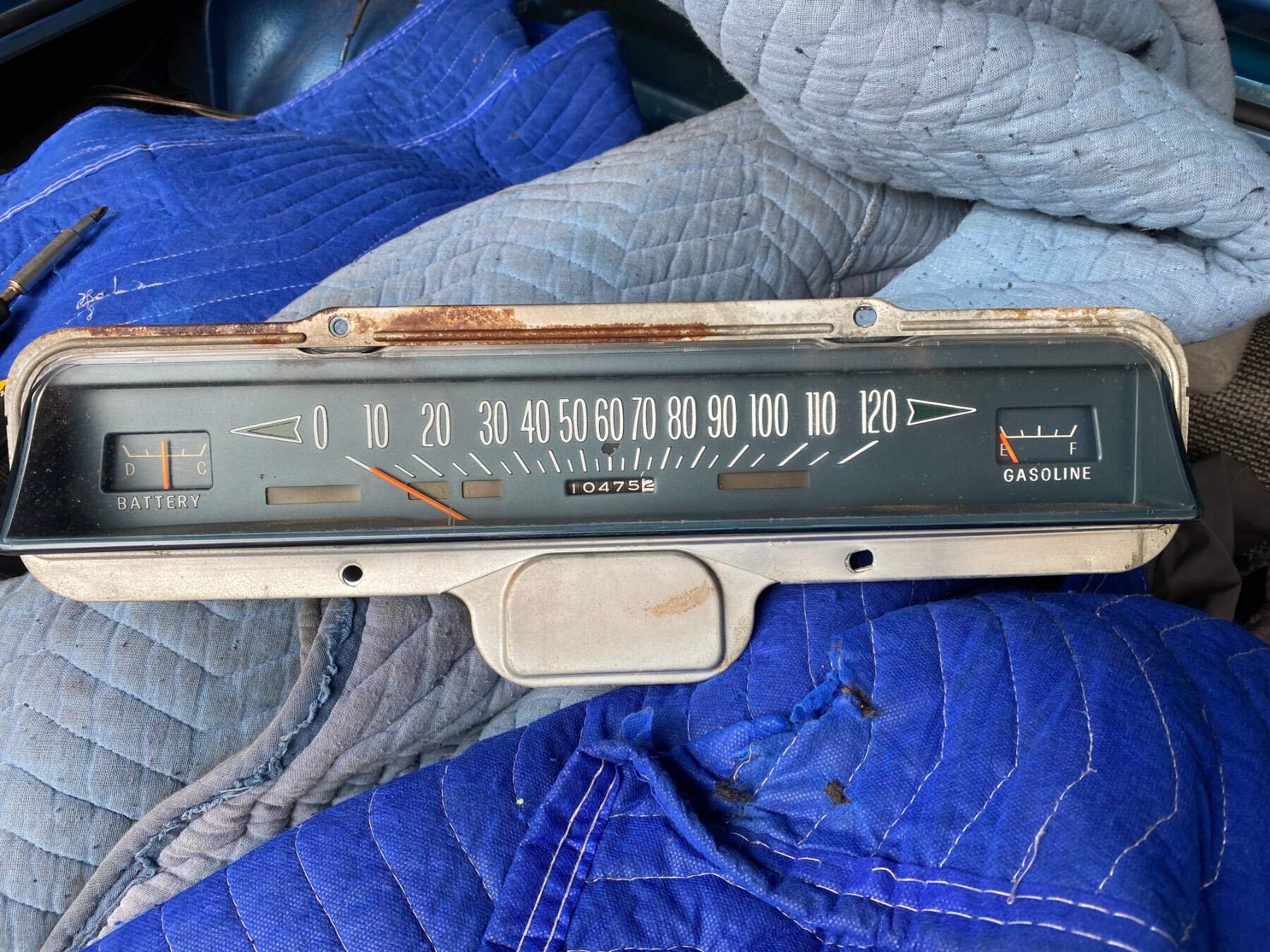

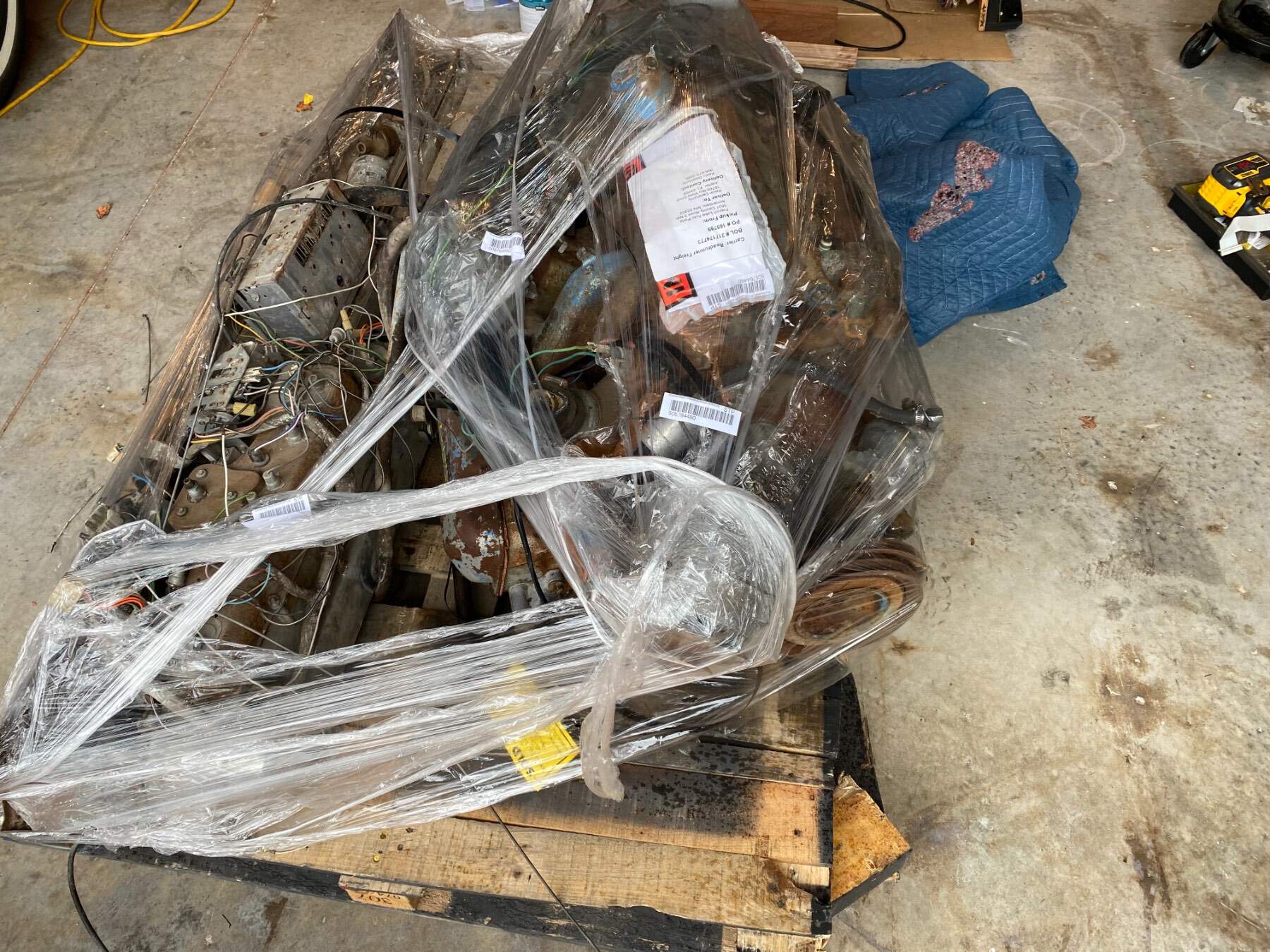

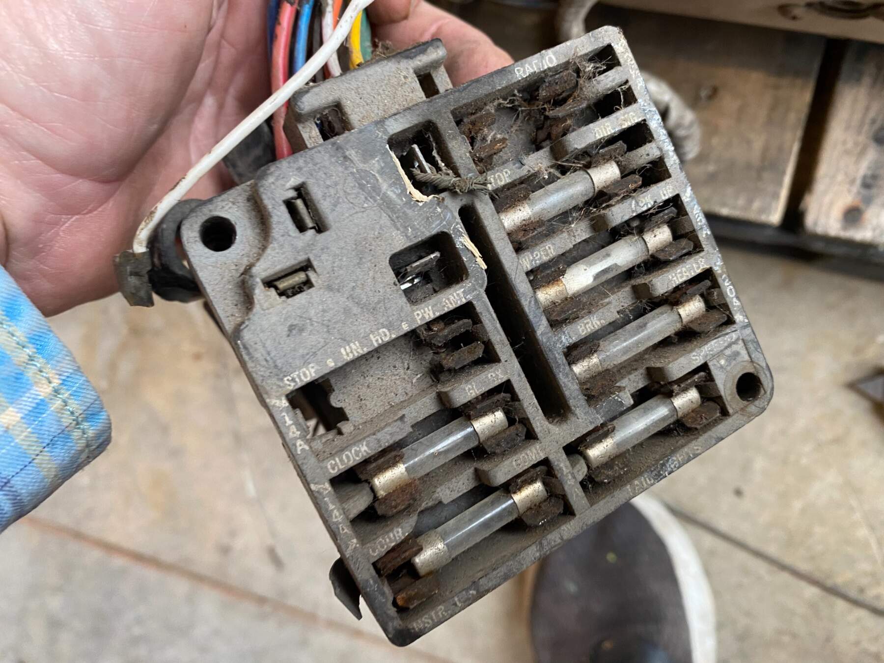

Big day today! Christmas in January. The delivery of motor, transmission, and dash came. I spent most of the day taking the parts off the dash. Almost too many to list. I was like a kid in the candy store; clock, ignition, ac/heat controller, wiper switch, drive park display, lighter, ashtray lights, speedometer box, radio, speaker reverb, headlight switch, total wire harness with fuse panel. Tons of cool stuff. Now I have a dash for ac if I decide to add it to Bonnie #1. Tomorrow I will check out the motor and transmission. I can’t wait!
score mate!!! thats the speedo you need to run with the Rally gauges!!!
oh ! oh ! and you scored another ignition switch !!!:cheers:
is that another super hydro trans????.... geess i can see why you said a January christmas !!!!,,,, well done :cheers:

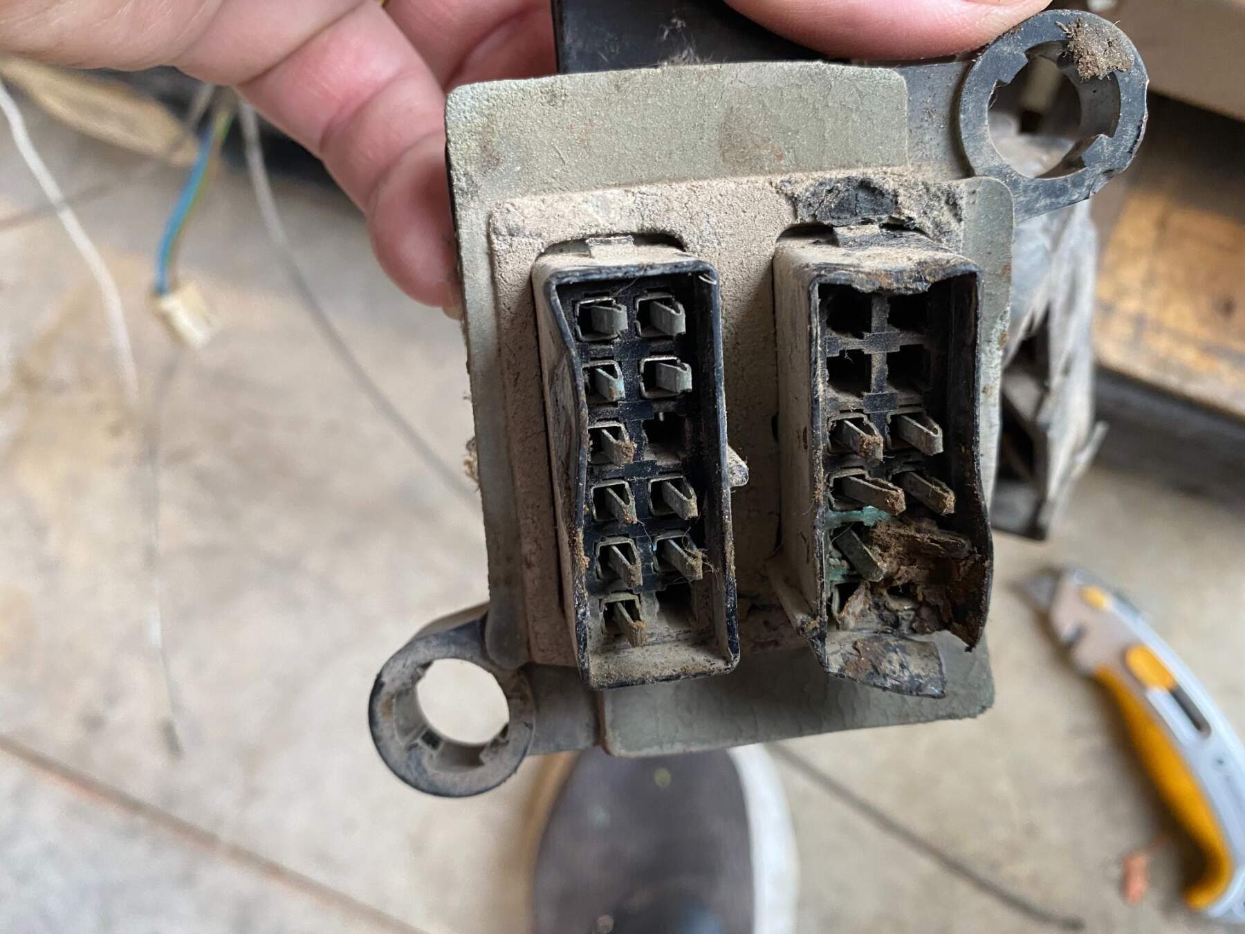

i have to ask, did you get the whole wire loom ? as in right to the fire wall plug?????
Yes. It would need to be repinned.
I have been searching for replacement pins to recrimp/rebuild  the fuse panel. So far nothing. I think most people buy a replacement harness but the wire harness is fine except for the fuse clips which are rusted and pitted.
oh ! perfect !! you can use this loom to make your rally gauge set work perfectly!!!... rearrange the loom by moving the sender wires for the fuel and temp over into the main speedo loom, and move the tell -tail light wires for oil and temp over to the 3 angled gauge cluster... 2 new sender units to make the temp and oil gauges work... and your basically have a plug n play set up !!
hmmm, someone must make those fuse cradles !!! millions of gm cars had them .... i would rebuild that fuse block, maybe after market fuse cradles are the same??? then its justA soldering job ???
And some one made millions of those fire wall plugs.... each of those pins can be pushed out and replaced

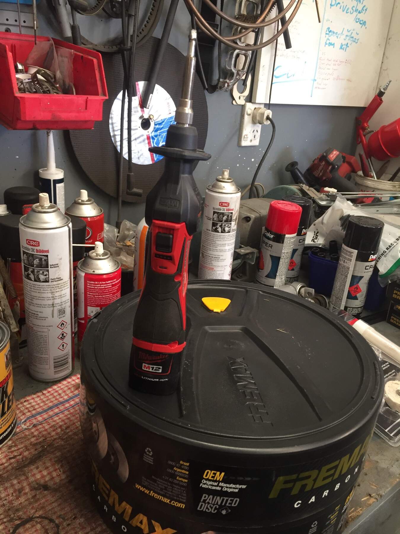

you need one of these !!!
best solder iron I have ever had for wiring 👍👍👍😀

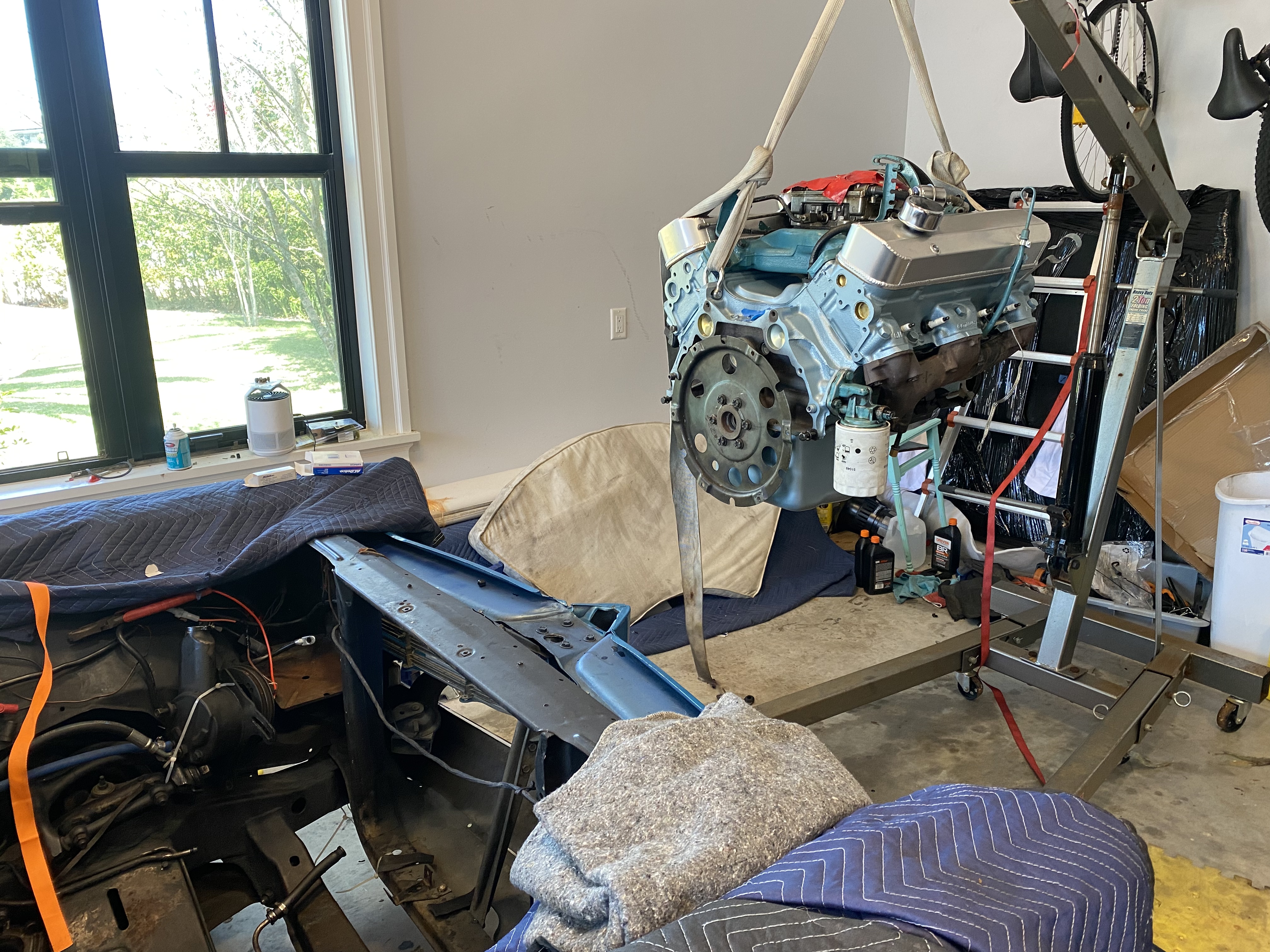

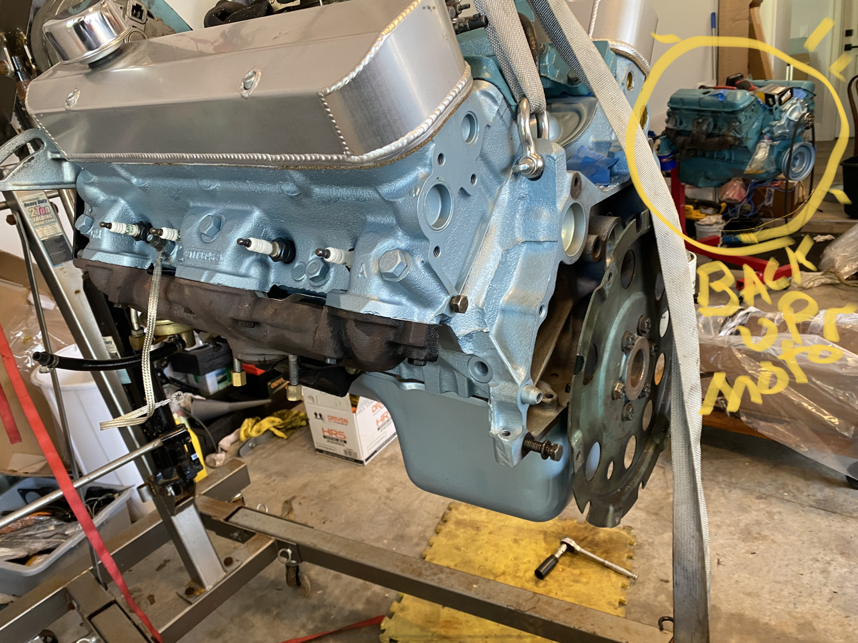

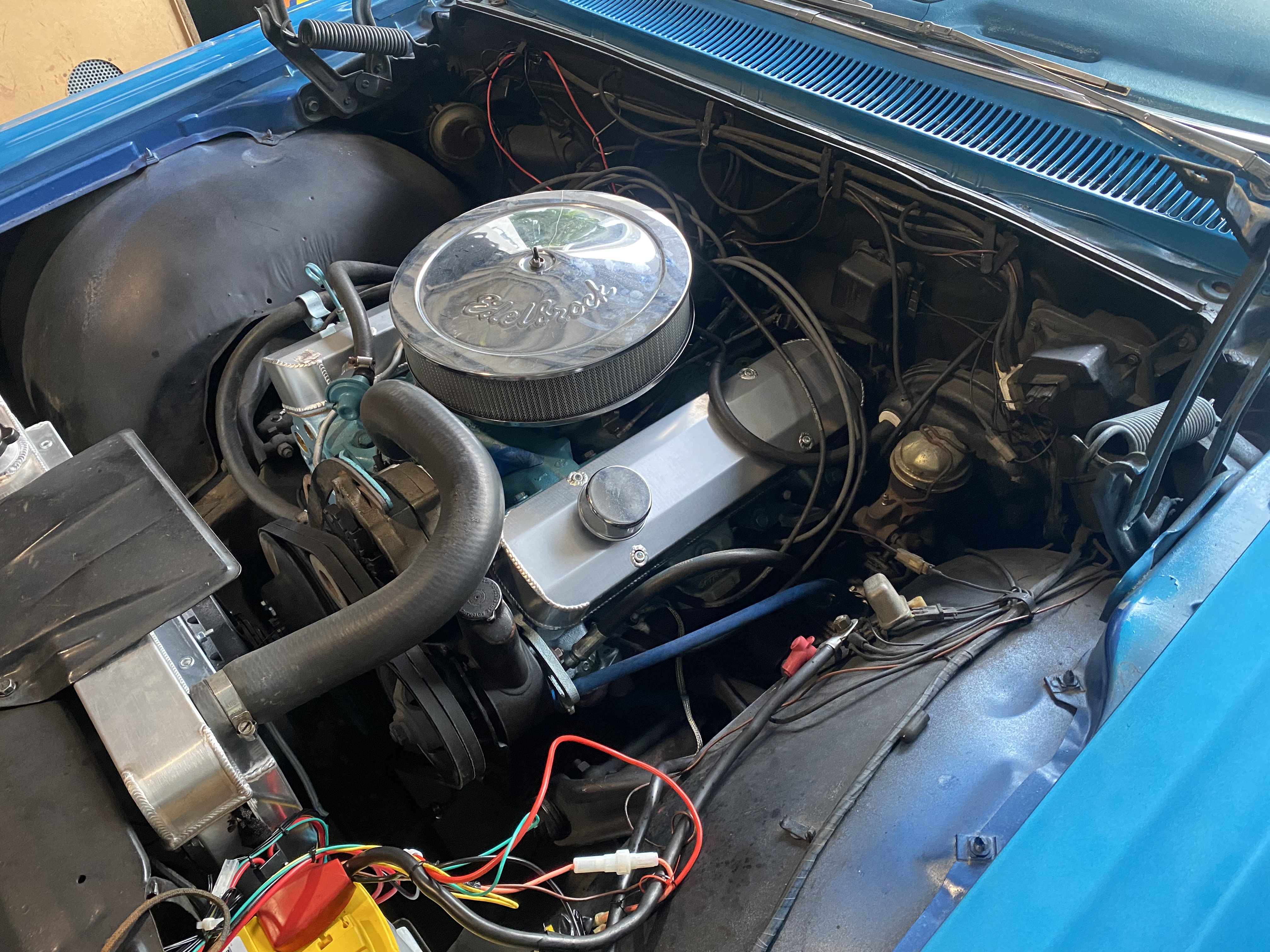

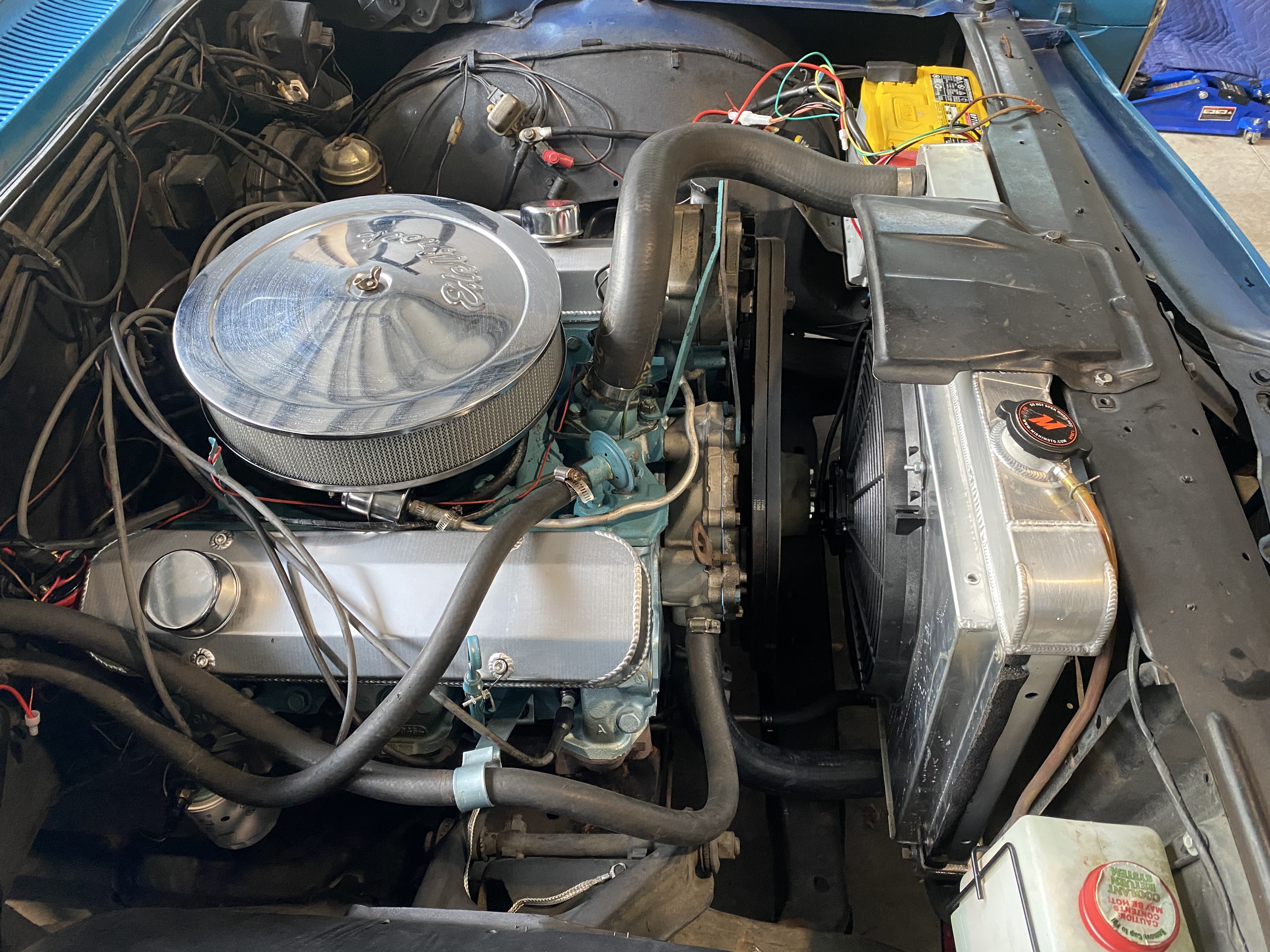

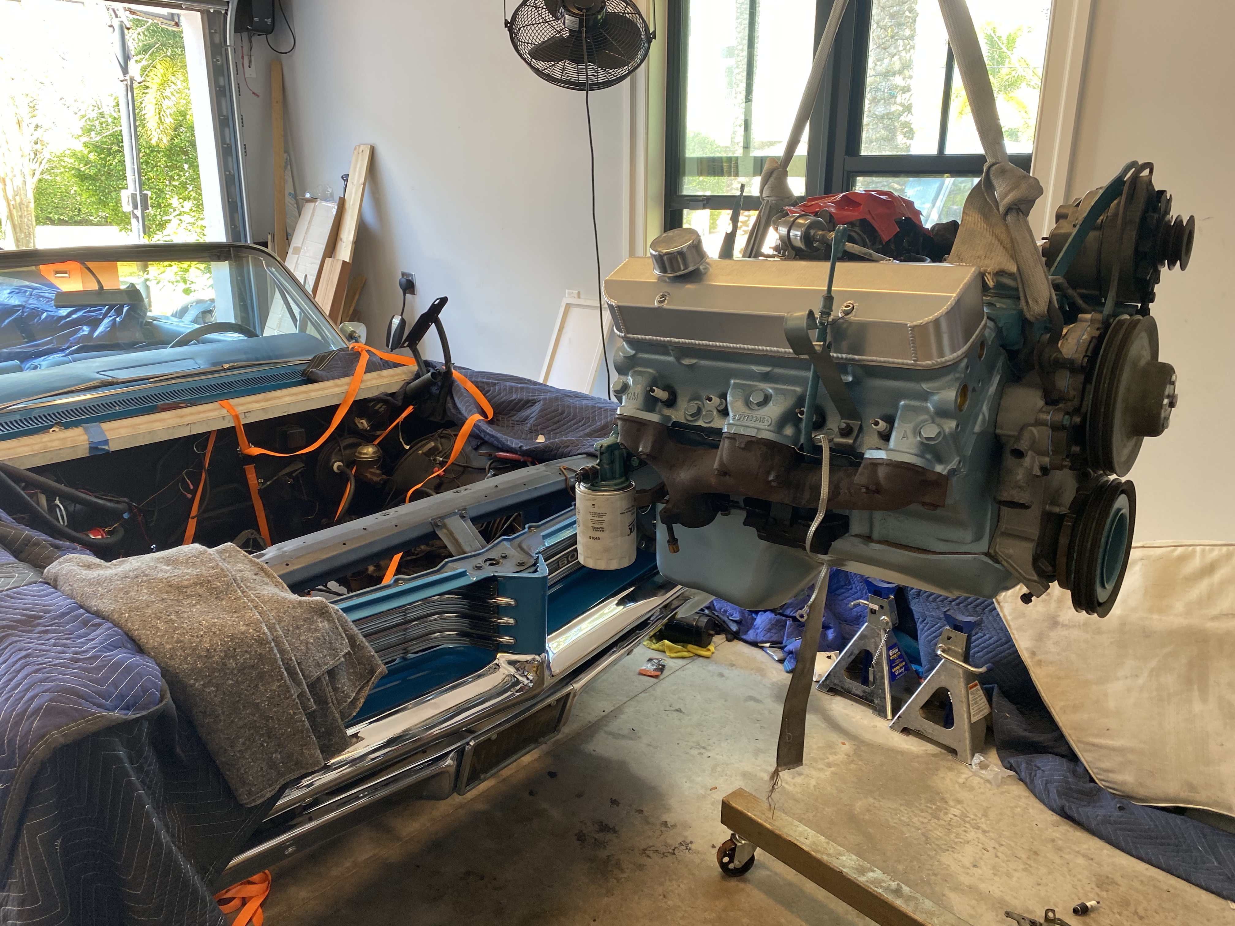

After 17 months I finally have the rebuilt original motor back in! I put 2600 miles on the loaner motor while waiting. Now I have a nice backup motor for a quick substitute if ever needed. This was the plan since motors are not getting any cheaper or easier to find. She runs great! Lookout tires, your going to get burned off! I added the electric fan to keep her cool
Awesome job.  Thankz for sharing, great pic's
Del !!! nice work mate!:dancingpontiac: i bet your getting really good at installing 389's now !!! hahaha
i really like that radiator with shroud and electric fan !!! very neat arrangement.
i also see thats a 64 block too as its drilled for the engine mounted starter motor mounts !!
question whos your co- pilot ? pic4 and 5

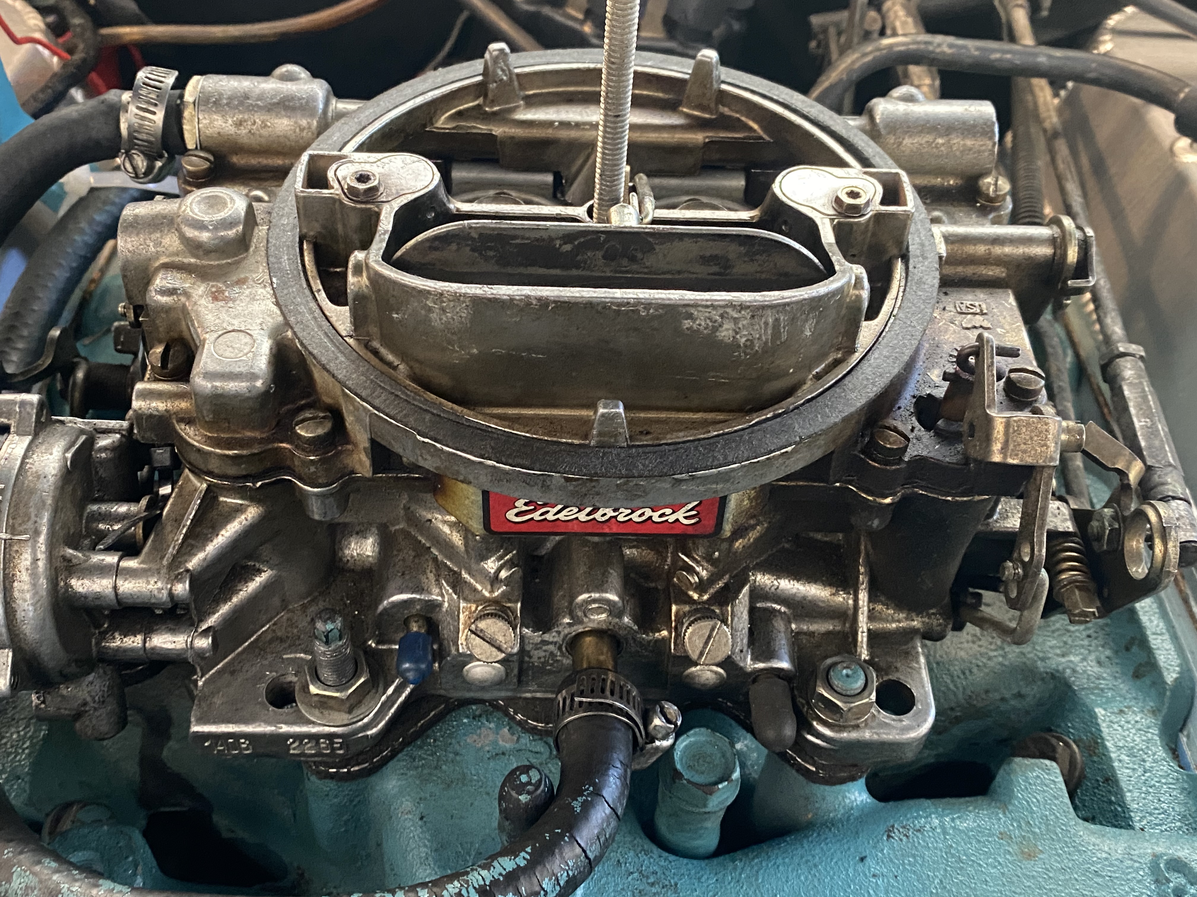

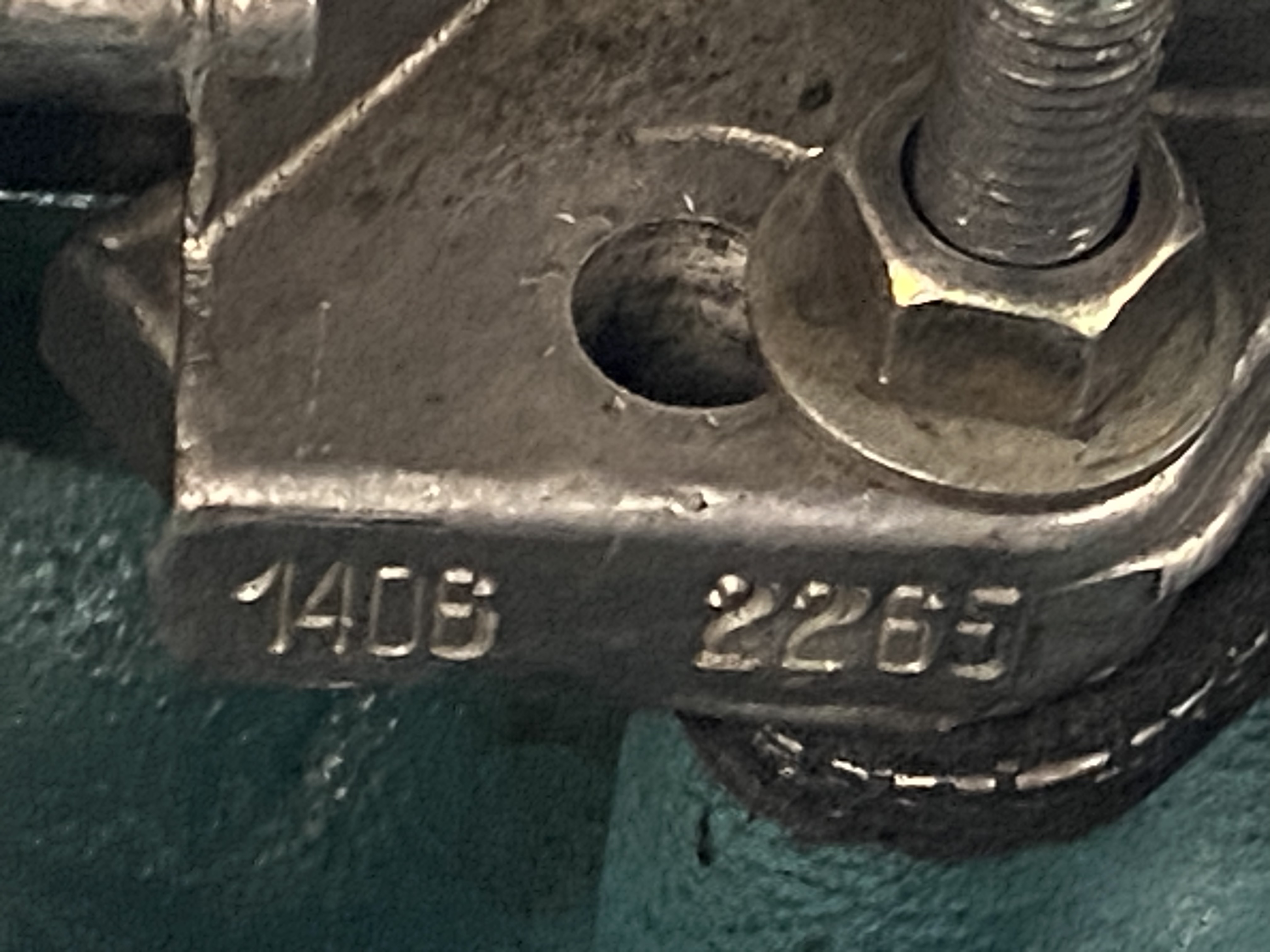

what carburetor are you using ?
Thanks! The car came with the edelbrock 1406. This guy sells them https://www.ebay.com/itm/384910080026.  I did rebuild it a while back. Seems good but I hear an air leak from some unknown place. My co-pilot is my new shepherd. My last one passed a while back. This is my 3rd German shepherd and he’s awesome. Big, smart, and lovable. The perfect accent to the beautiful 64 Bonnie.
   Your right, I’m getting good at the engine swap after four times.

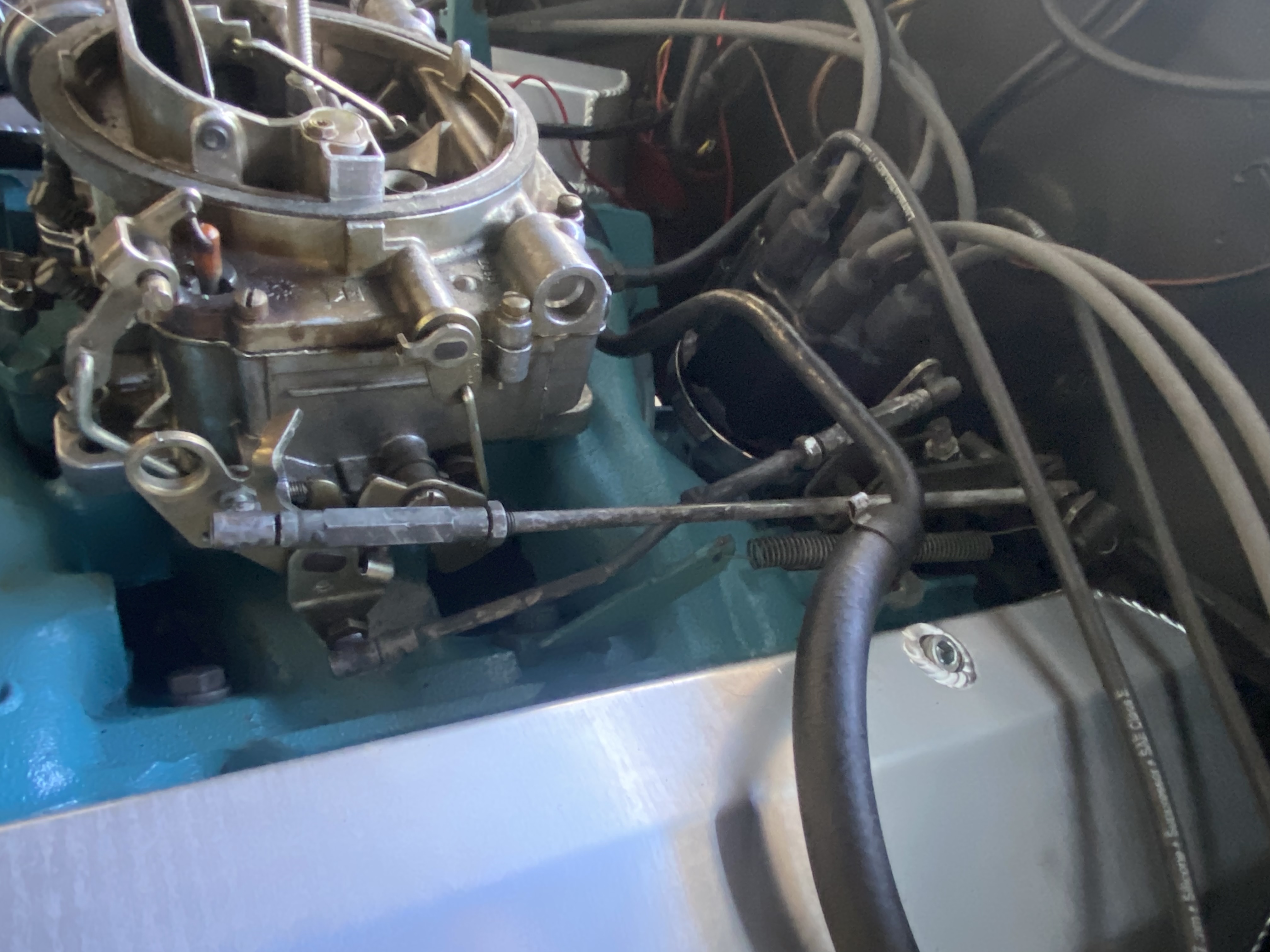

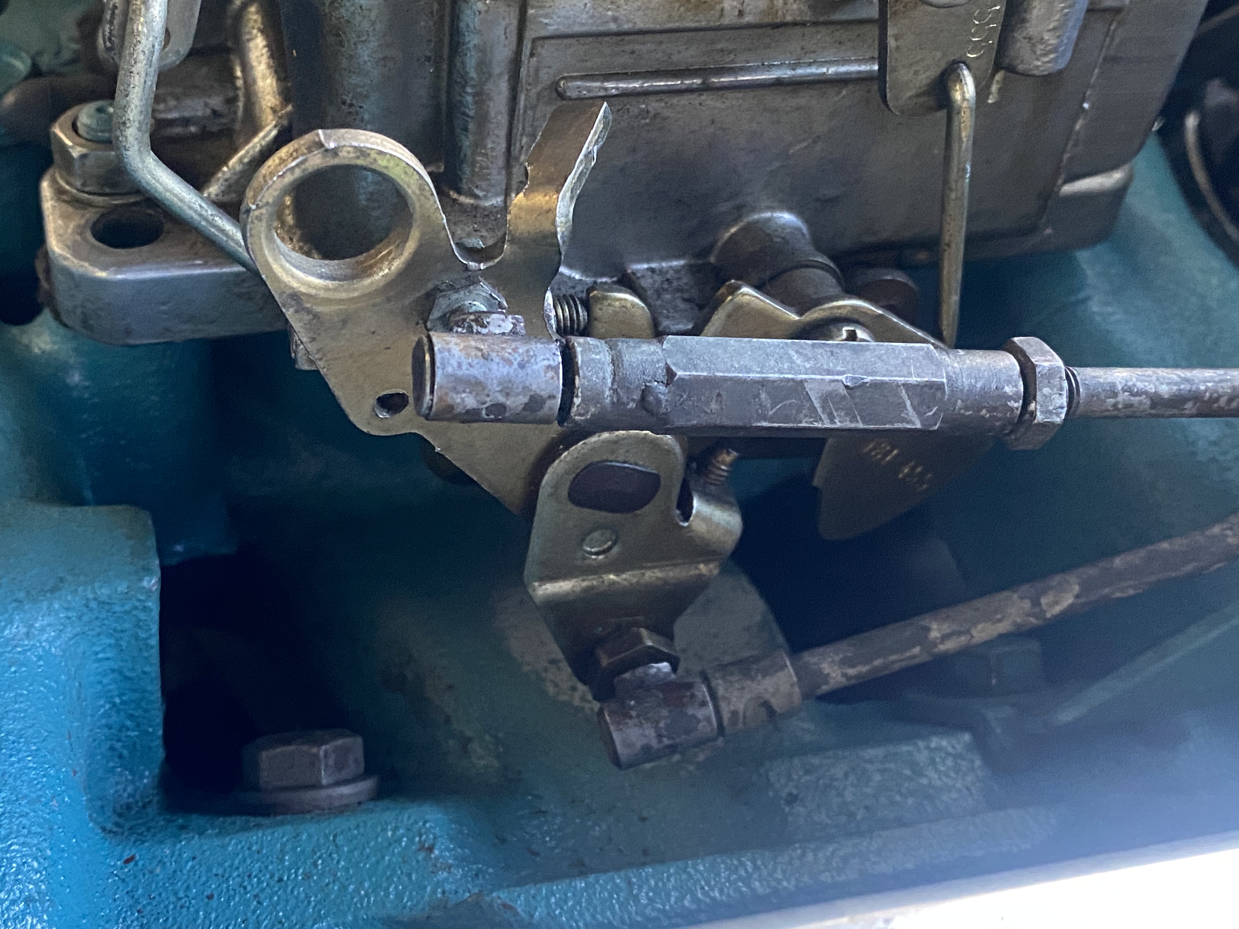

Del can you post a pic of how your linkages are on the carb to the pedal and the super hydro trans !... i am about to fit my vs2  edlebrock to my 389 and those 2 mounting points are super important !!!!
once we get passt the wedding !!!! in 2 days ...:stars:
Let me know if you need more
Thanks Del :cheers: too easy !!!
here I was thinking I will need to make adaptors !!!

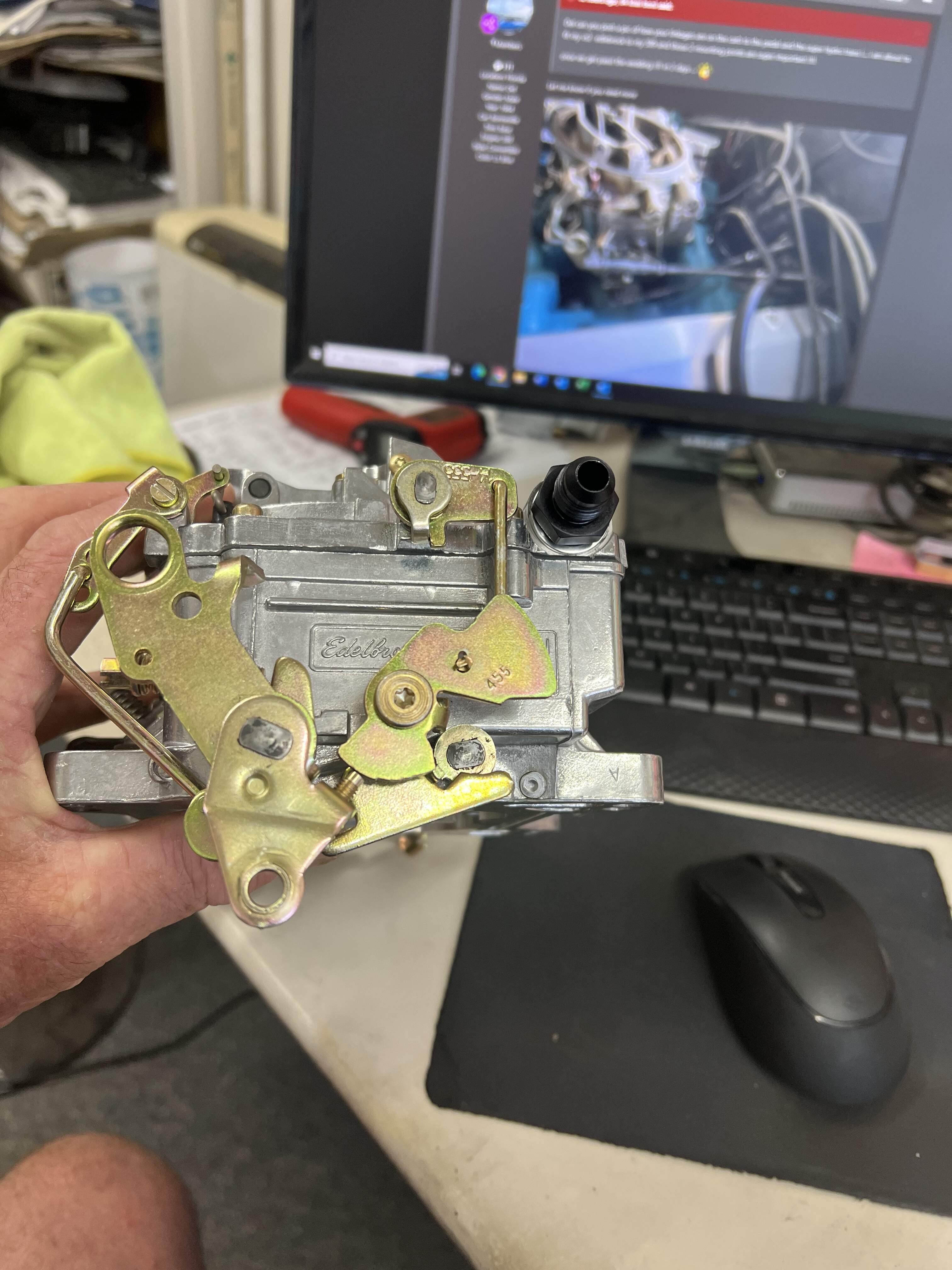

Is that the Edelbrock 1906? Mine has a vacuum leak causing a whistle and problems. I want to upgrade it. I would love to get what you have so a can ask questions if needed. Got one today.if it’s good enough for you it’s good enough for me.
Edited by Bonneville convertable64
yes  mate its a 1906 electric choke 650cfm, avs 2
i got it from speedway motors via ebay
