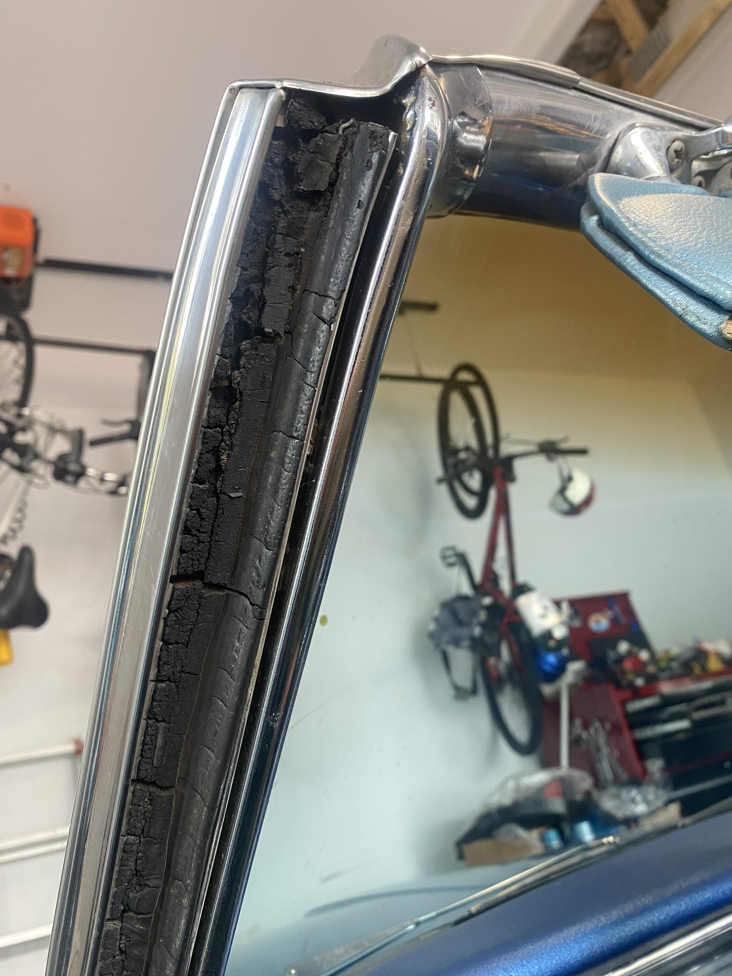

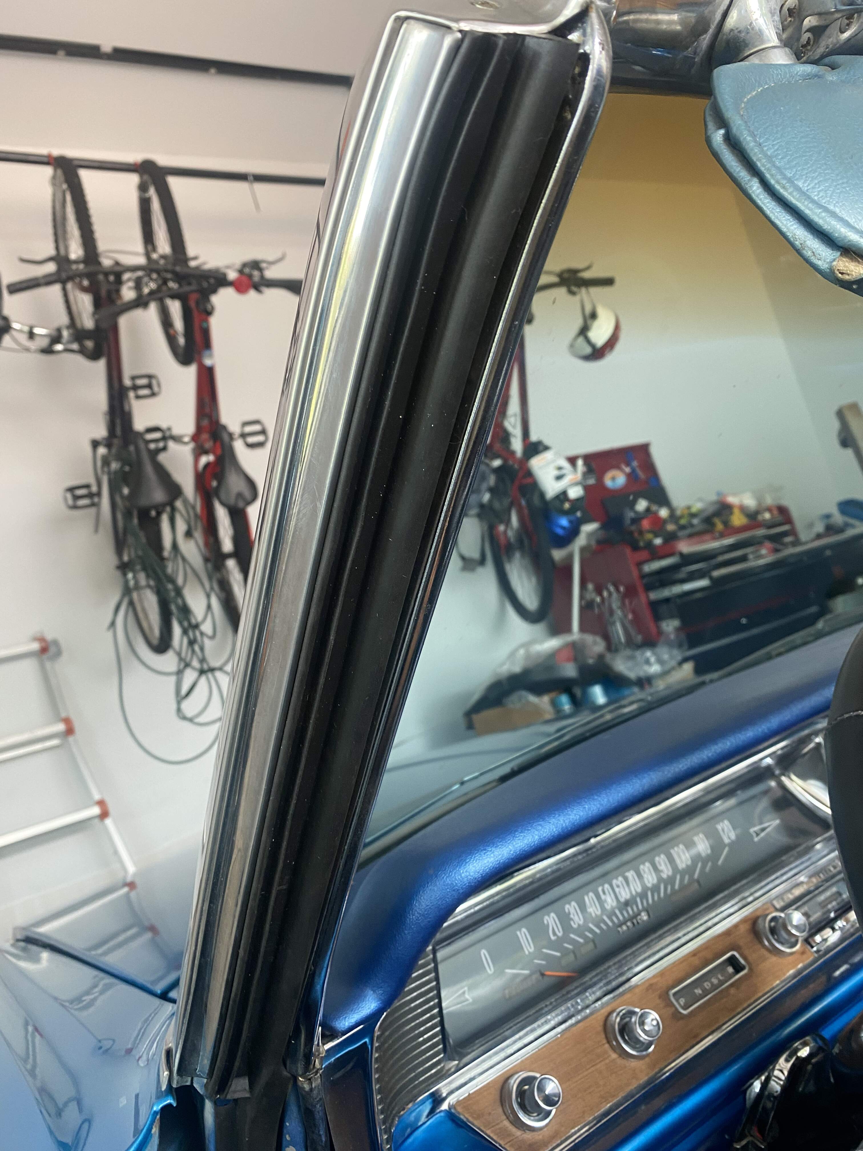

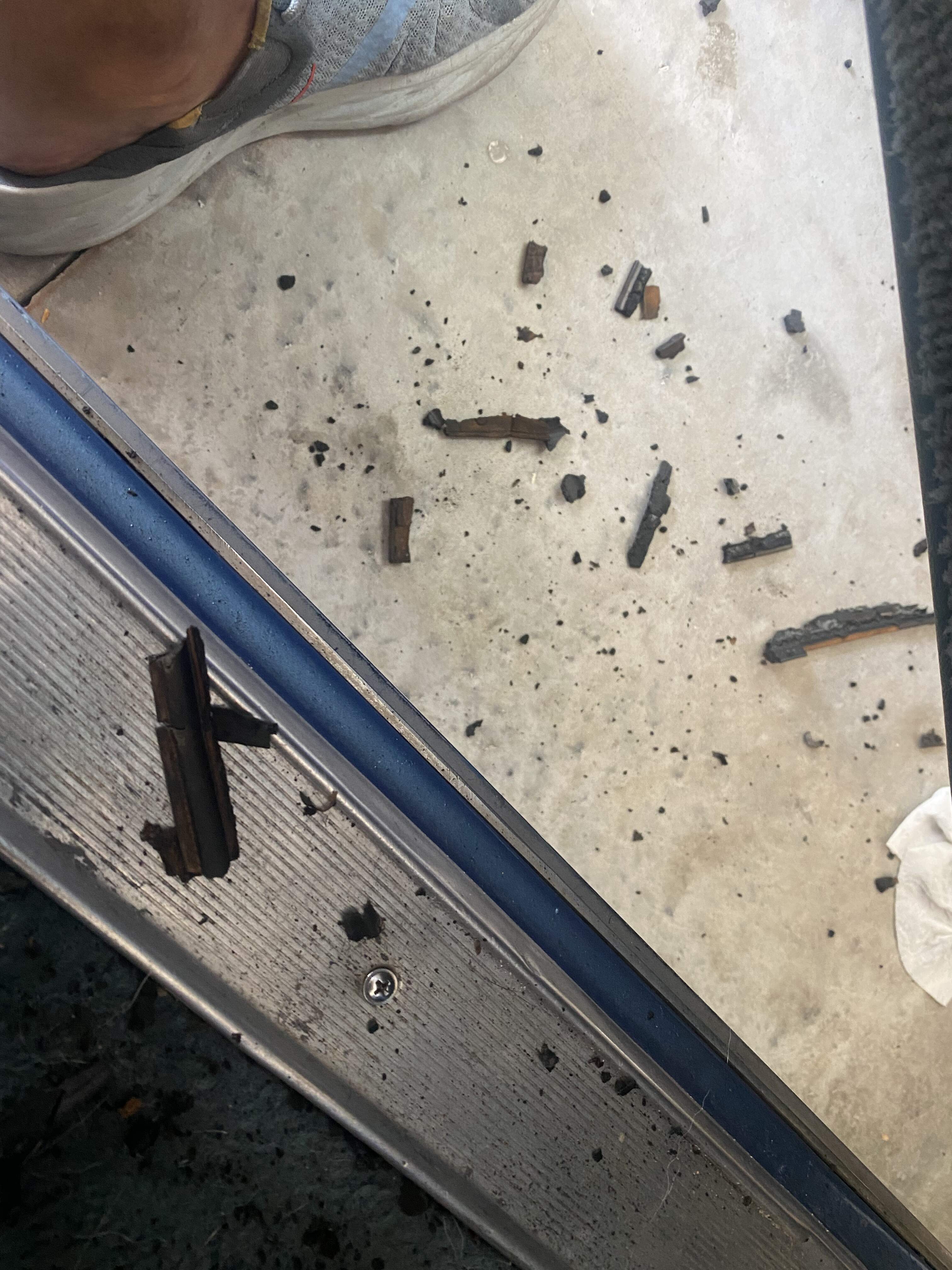

Much needed door rubber!

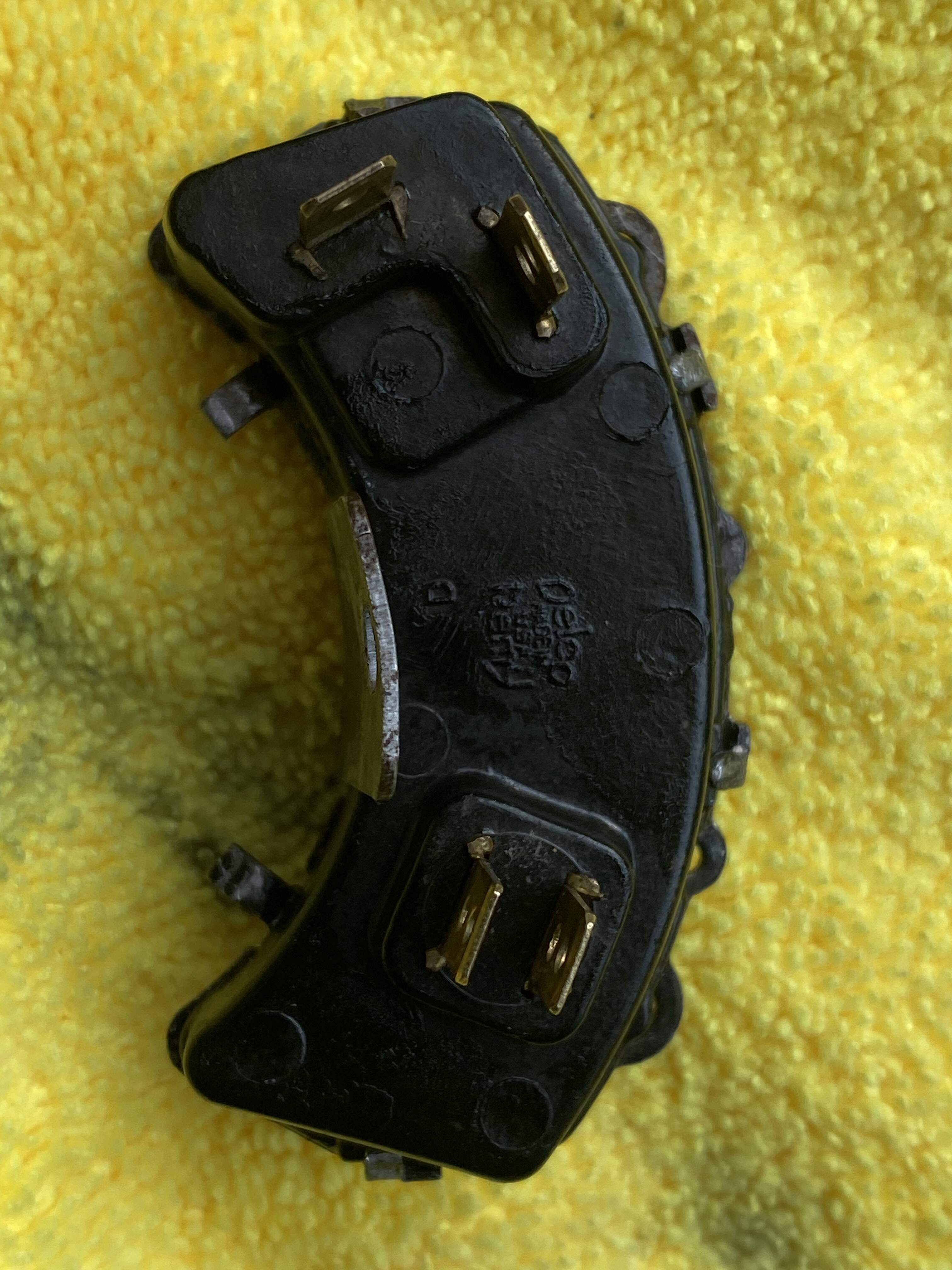

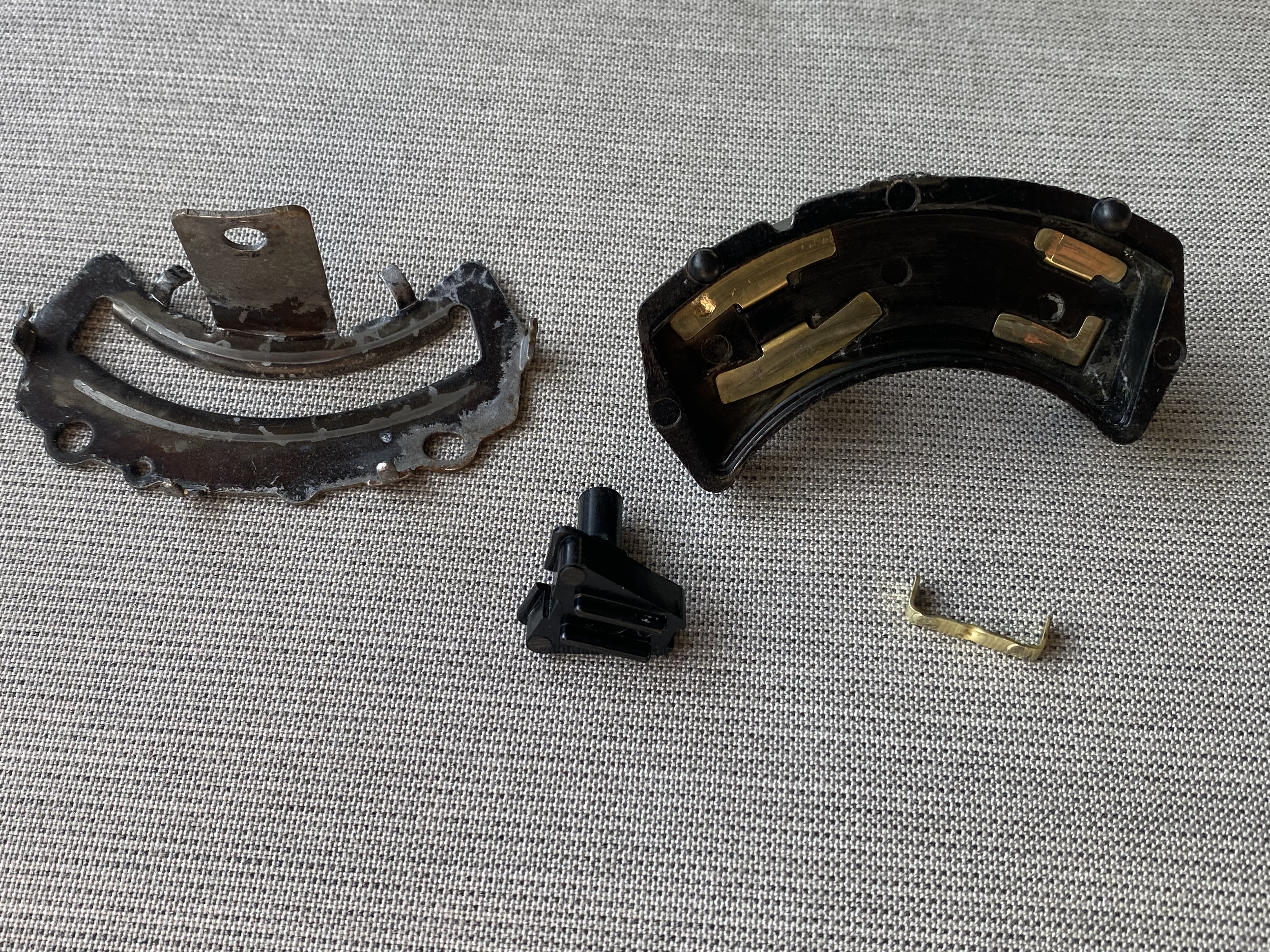

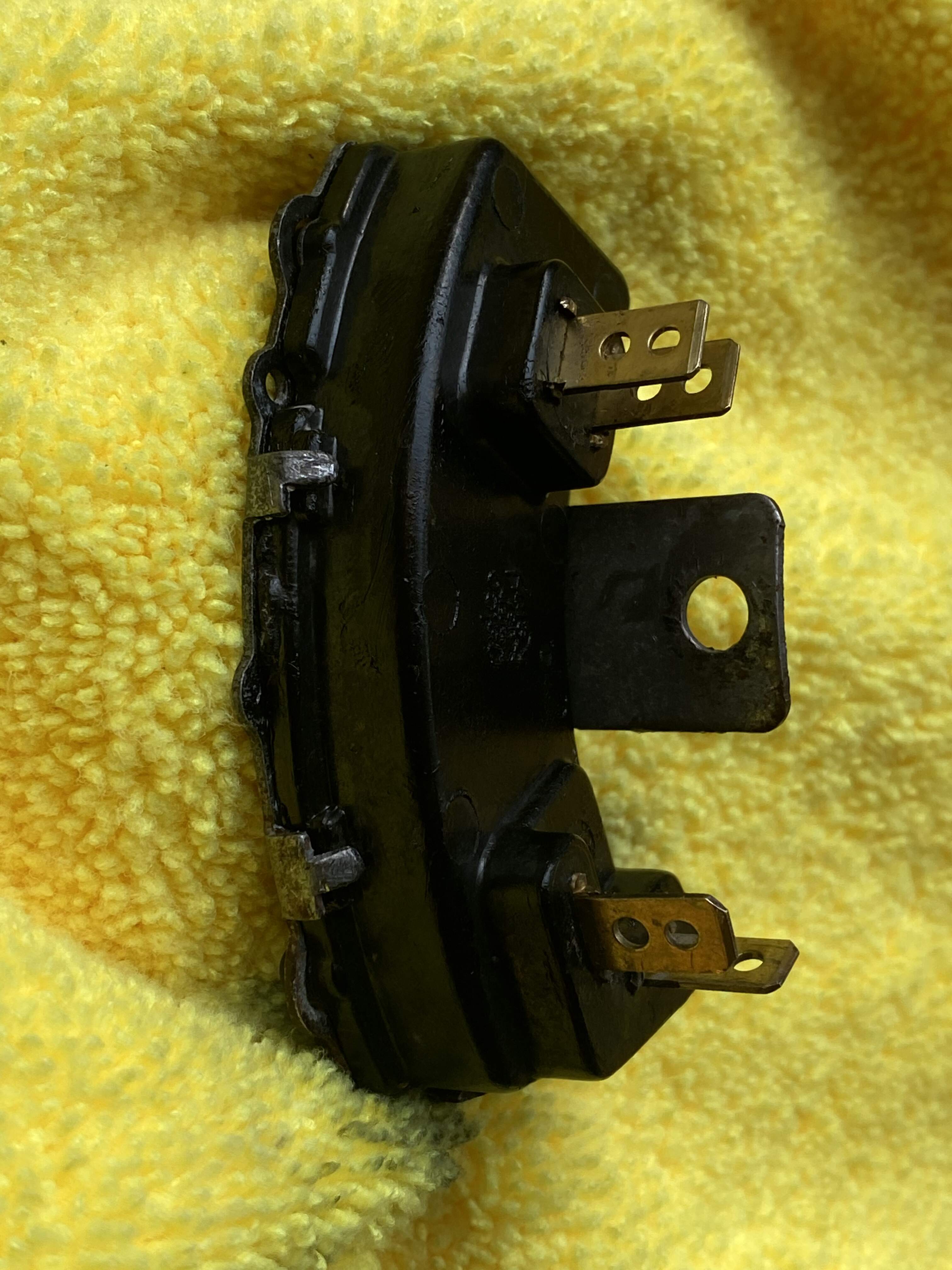

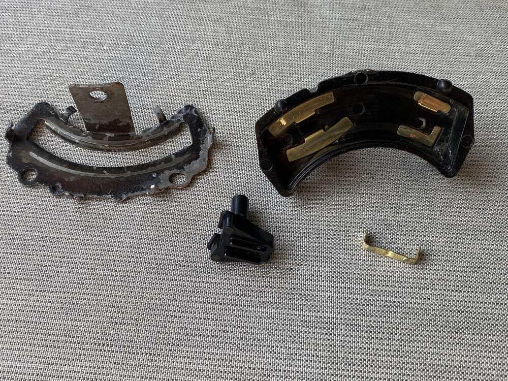

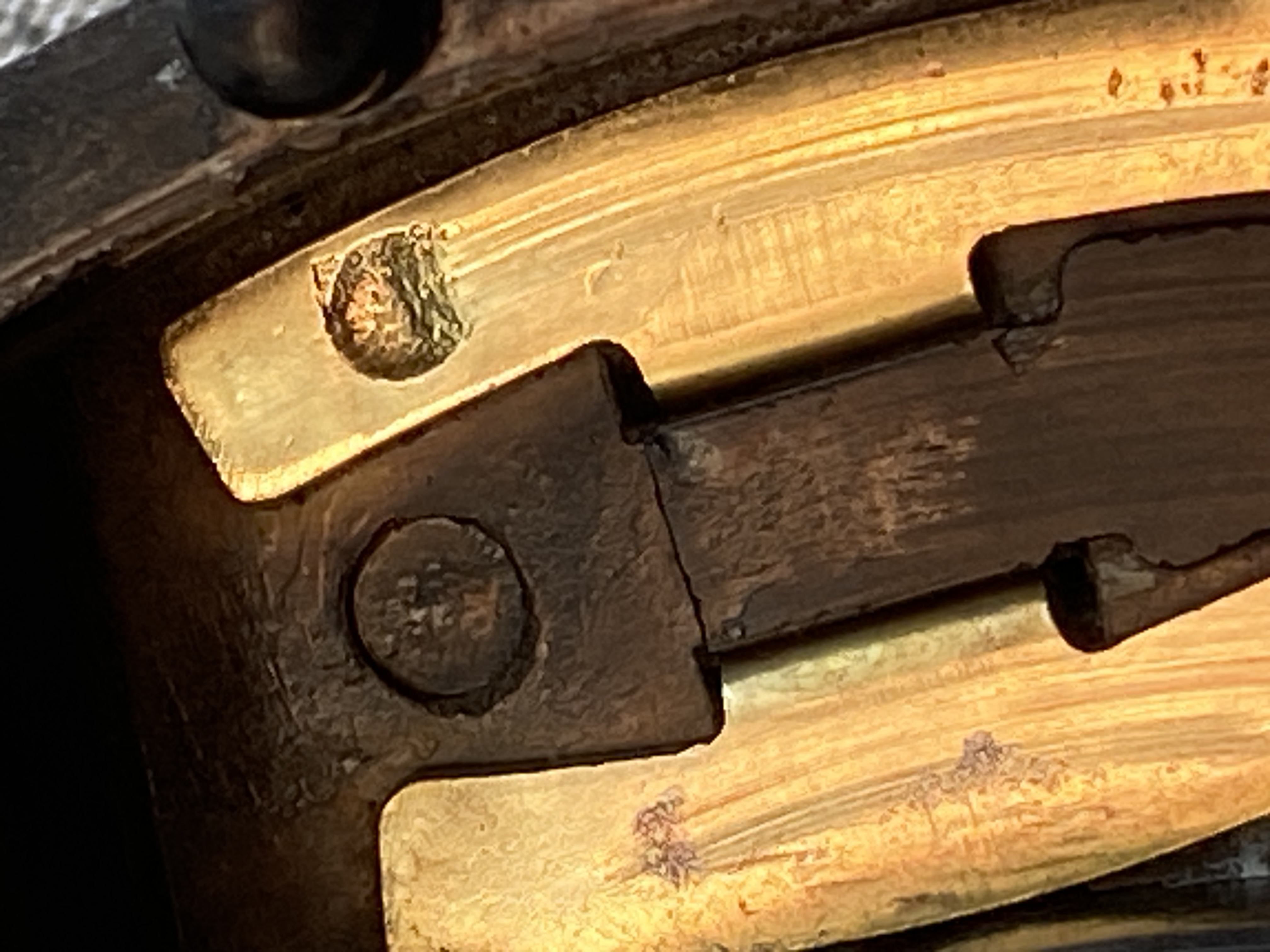

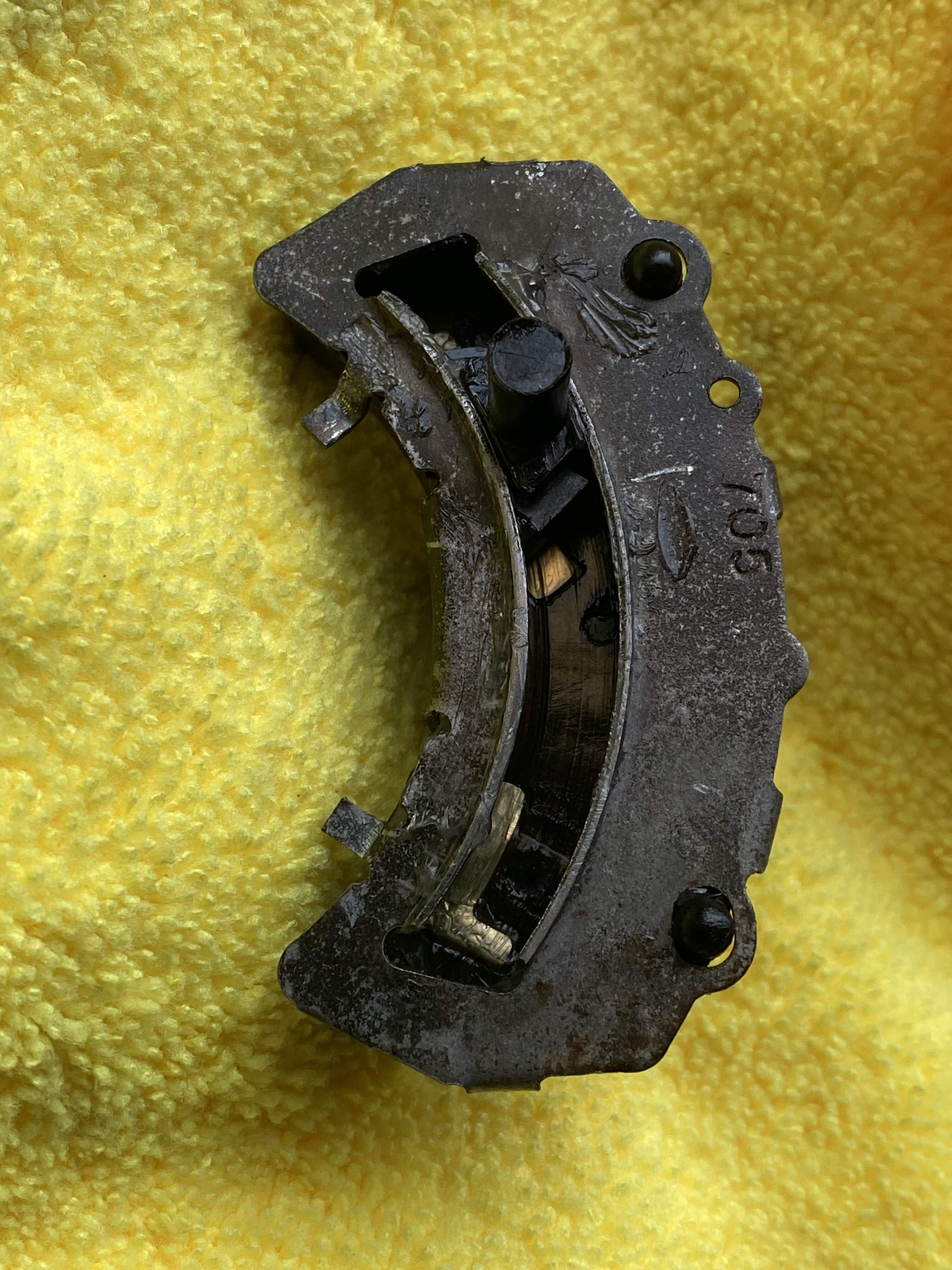

Well, I was dealing with a grinding noise as I put the car in park. It’s been like that since I bought it a few years ago. I was thinking I needed to rebuild the steering column or buy another one. Today I tracked the noise down to the neutral safety/backup light switch. Since no one has them available, I took it apart, cleaned, and greased it. It’s not perfect since the copper tabs are kinda dug out, but much better so I can be happy with it.

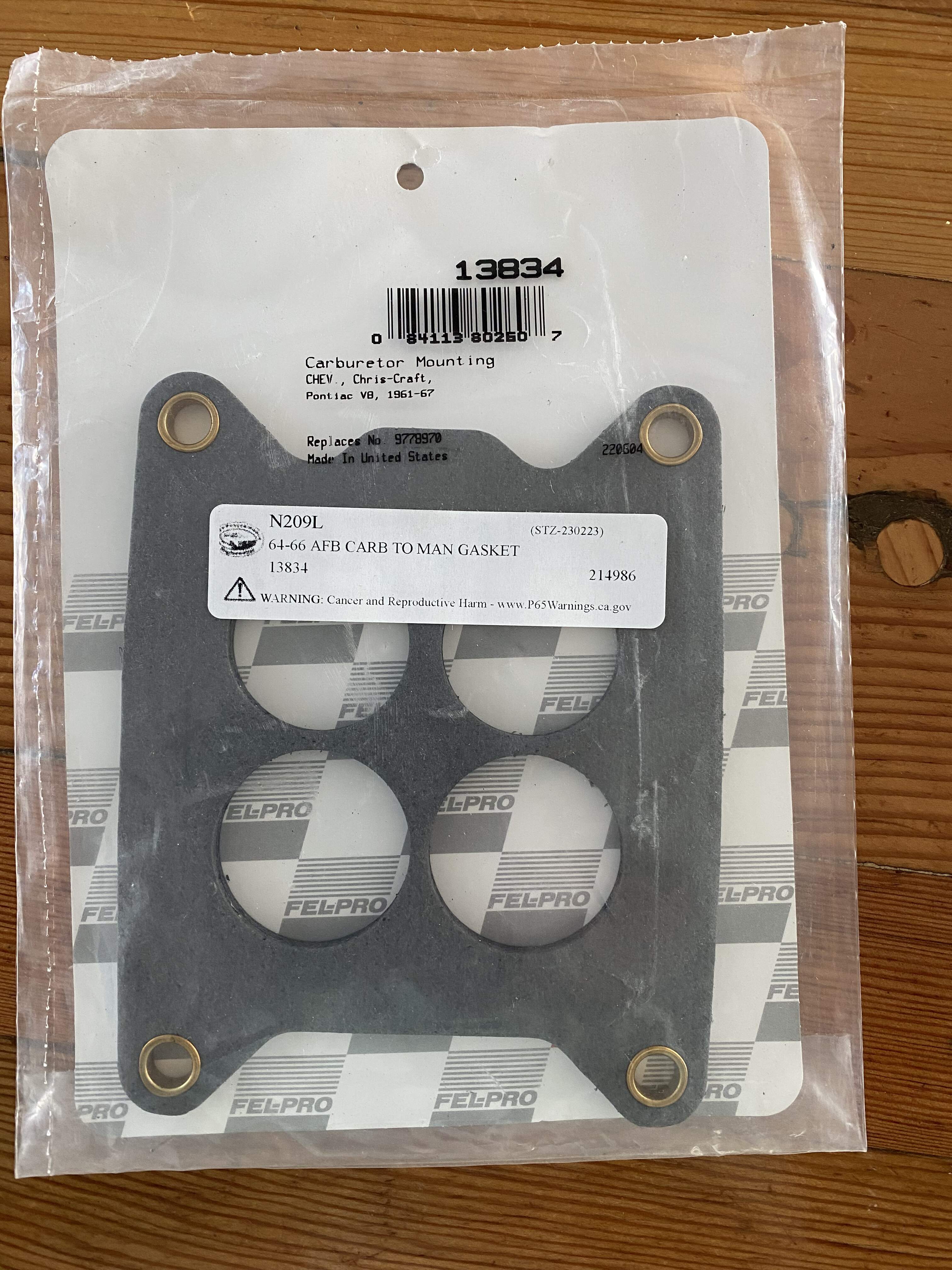

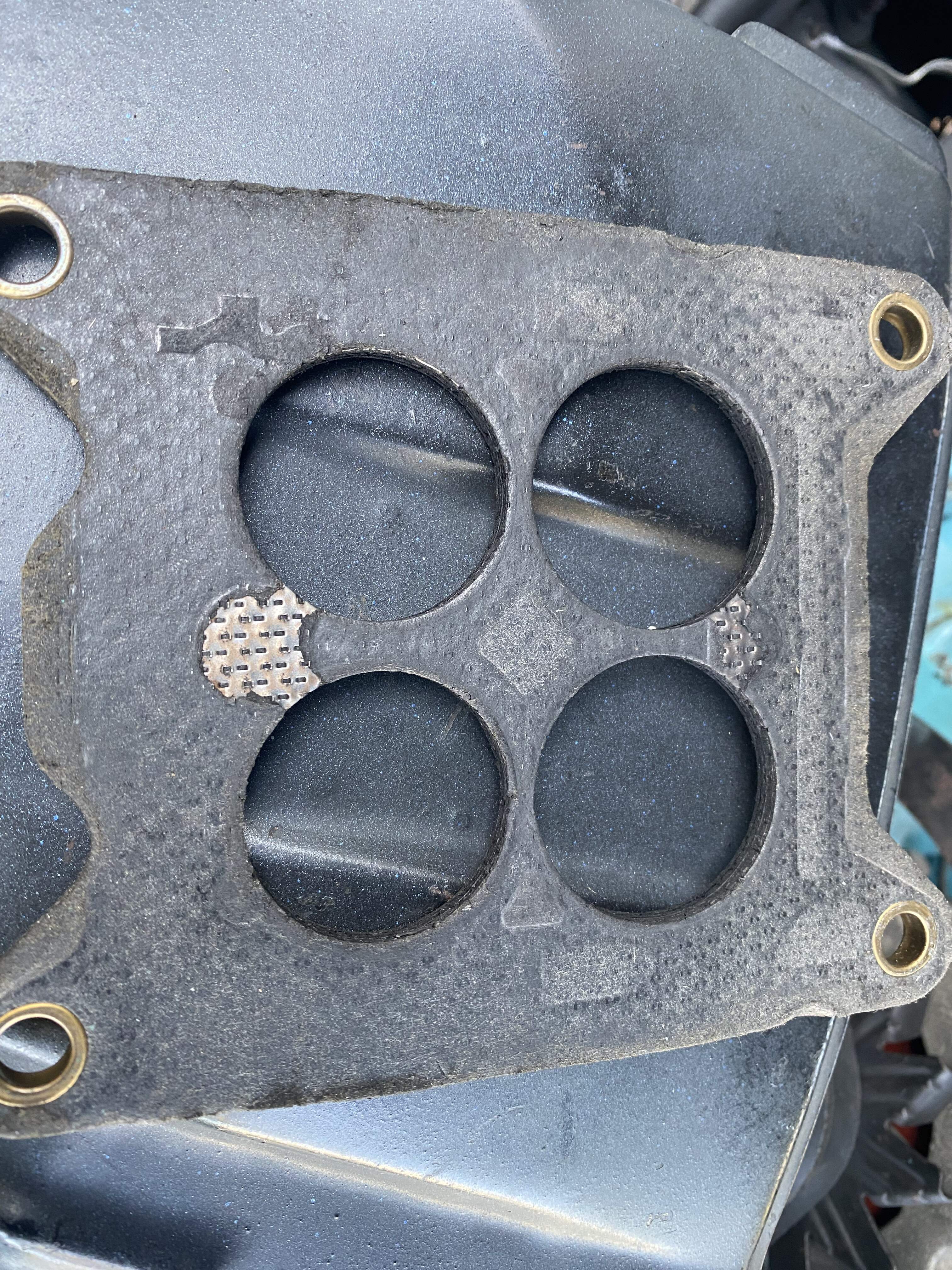

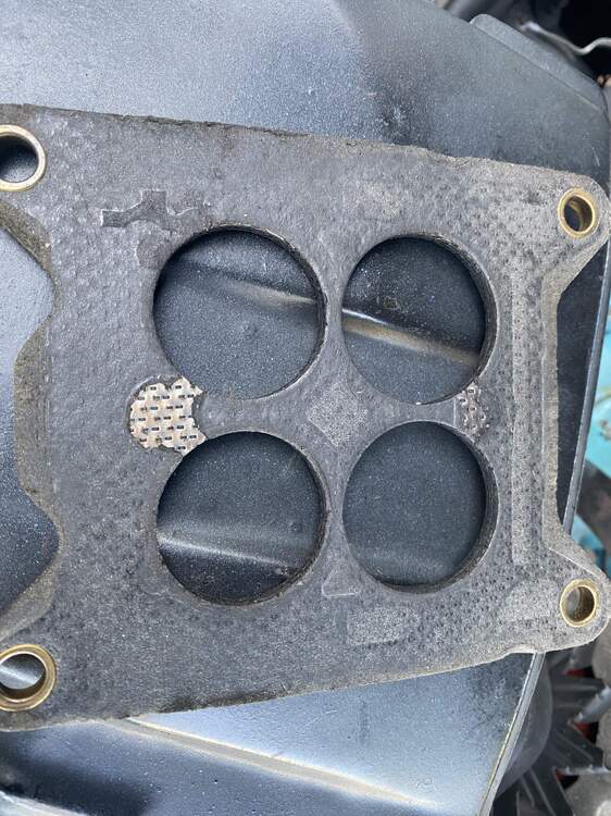

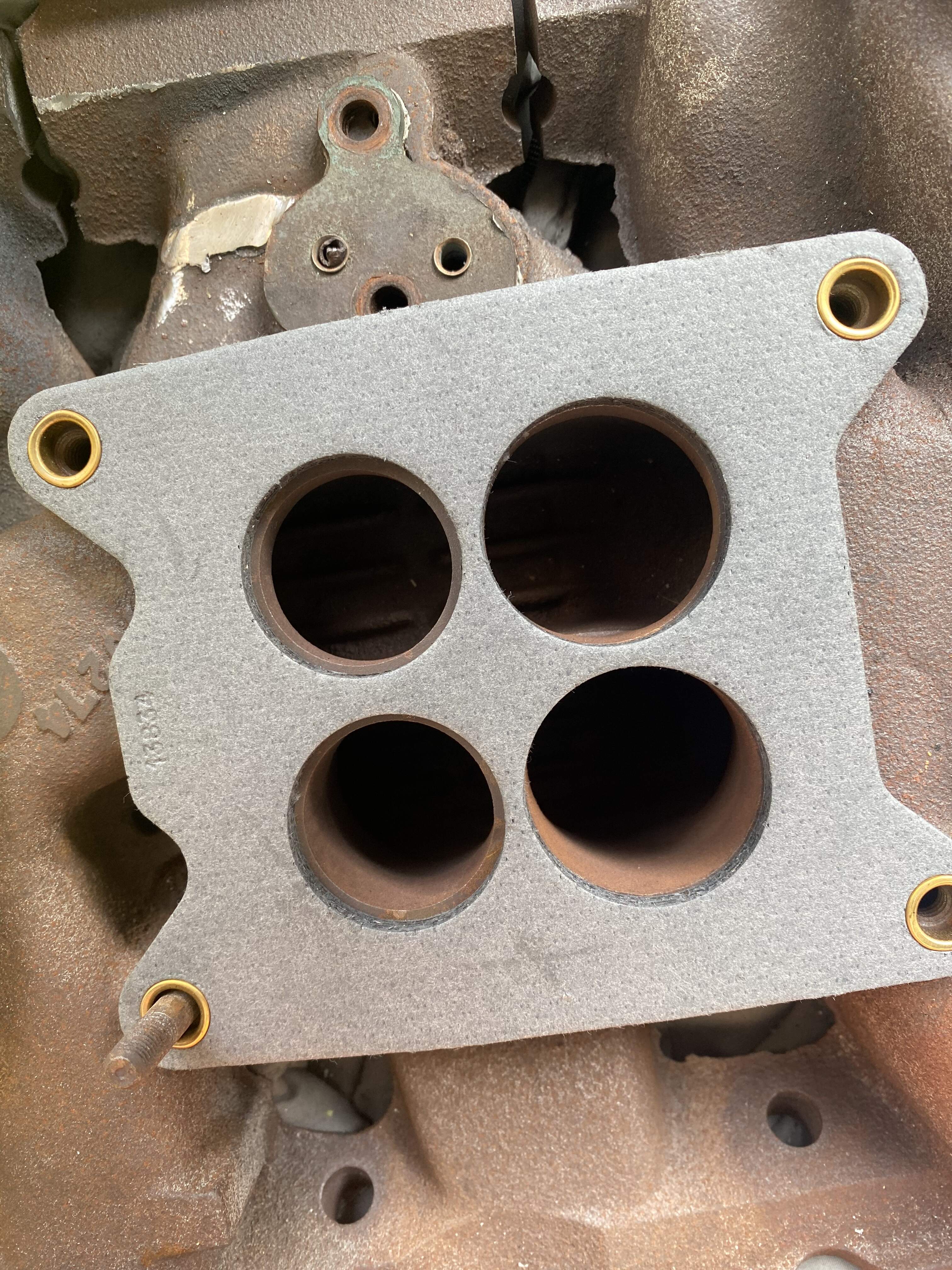

Finally found the source of the vacuum whistle. I went as far a replacing the carburetor. Turns out the gasket was torn, worn and bulged in spots. Apparently just enough to make it whistle with acceleration. I’ve been looking for the thick gasket but couldn’t find it. It actually is a cheap felpro easy to find if you know the product number. Another Bonneville problem solved!
