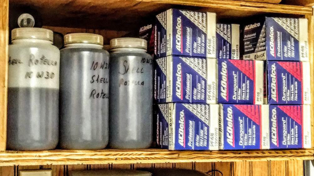

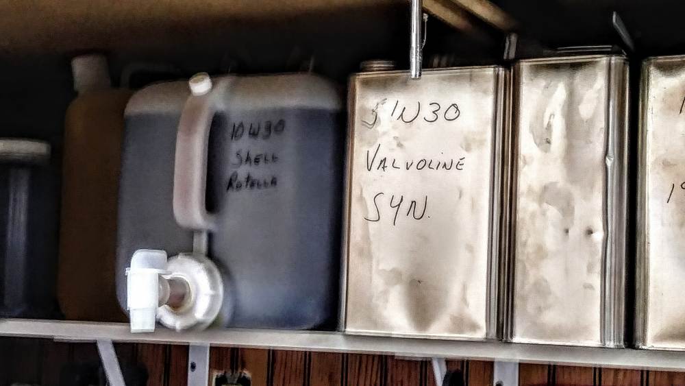

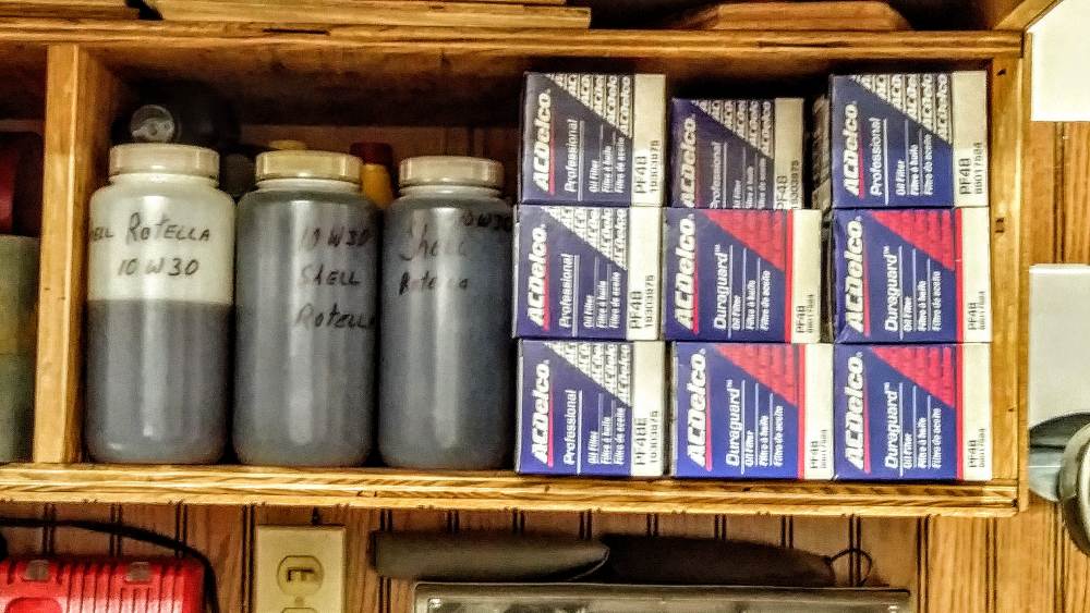

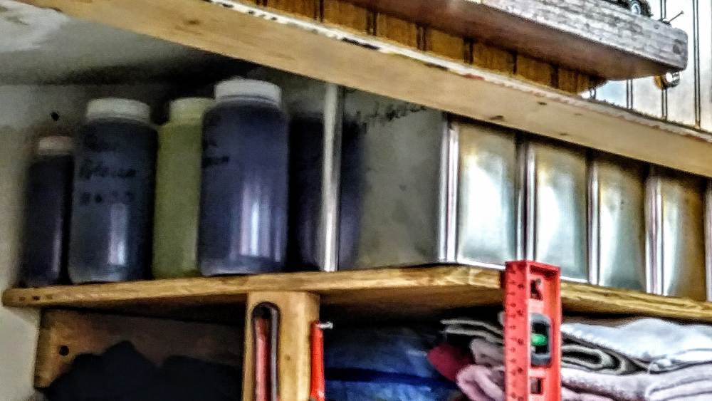

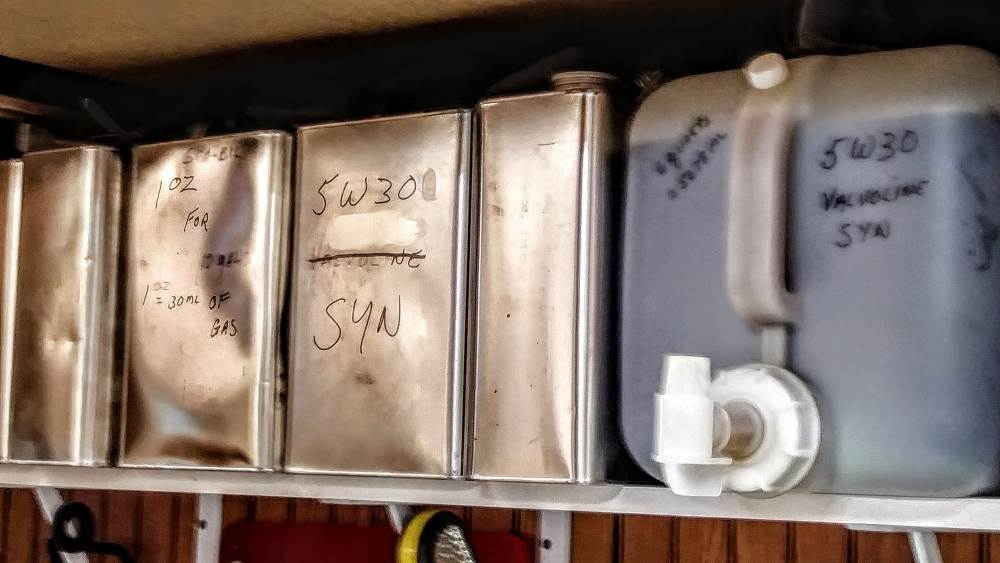

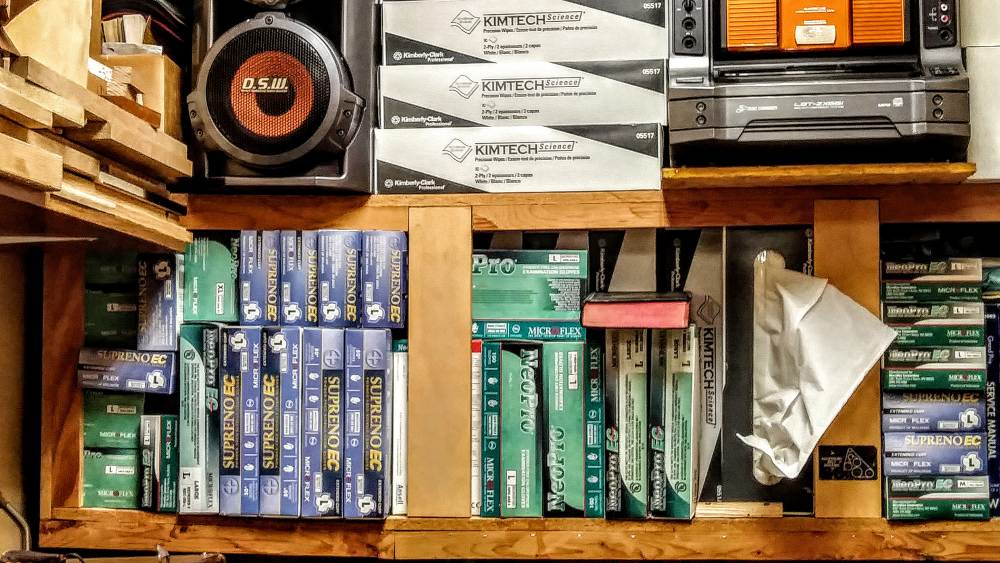

Most of the stock is in my attic in a well insulated cooler since it will be years before I need more, but here some pics of what I do have down I my shop. Also a lot of nitrile gloves and Kim wipes clothes.
also forgot I have some PF52 they’re the long filter for the Indian, either one can be used.
