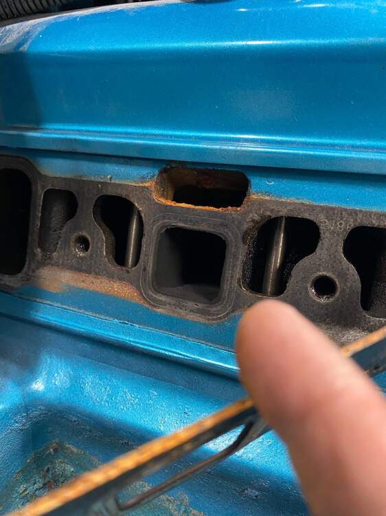

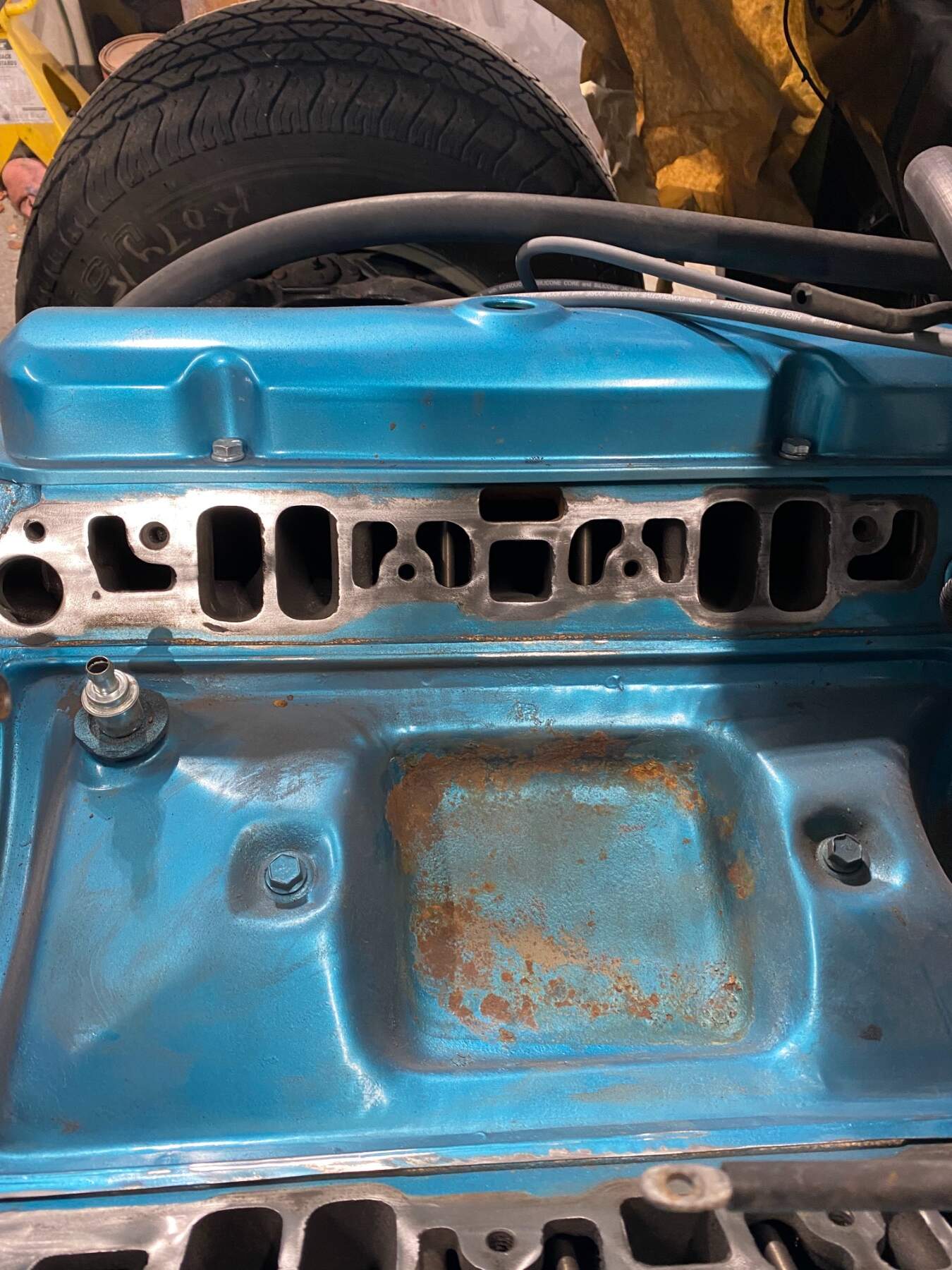

Can someone tell me if this center top hole is a coolant jacket.  I ask cause coolant bubbles up out of it when I got engine to temp. But the gaskets do not completely cover itD9BCFA1B-935A-4110-A92B-8C218F68C017.thumb.jpeg.fe3ca4bfe780d27cc60155feae63d158.jpegC2FE0F0B-B049-457B-82DA-8DA4BB5F568E.thumb.jpeg.b332782d9ca5f8c7dcc8ebe04282b04b.jpeg
