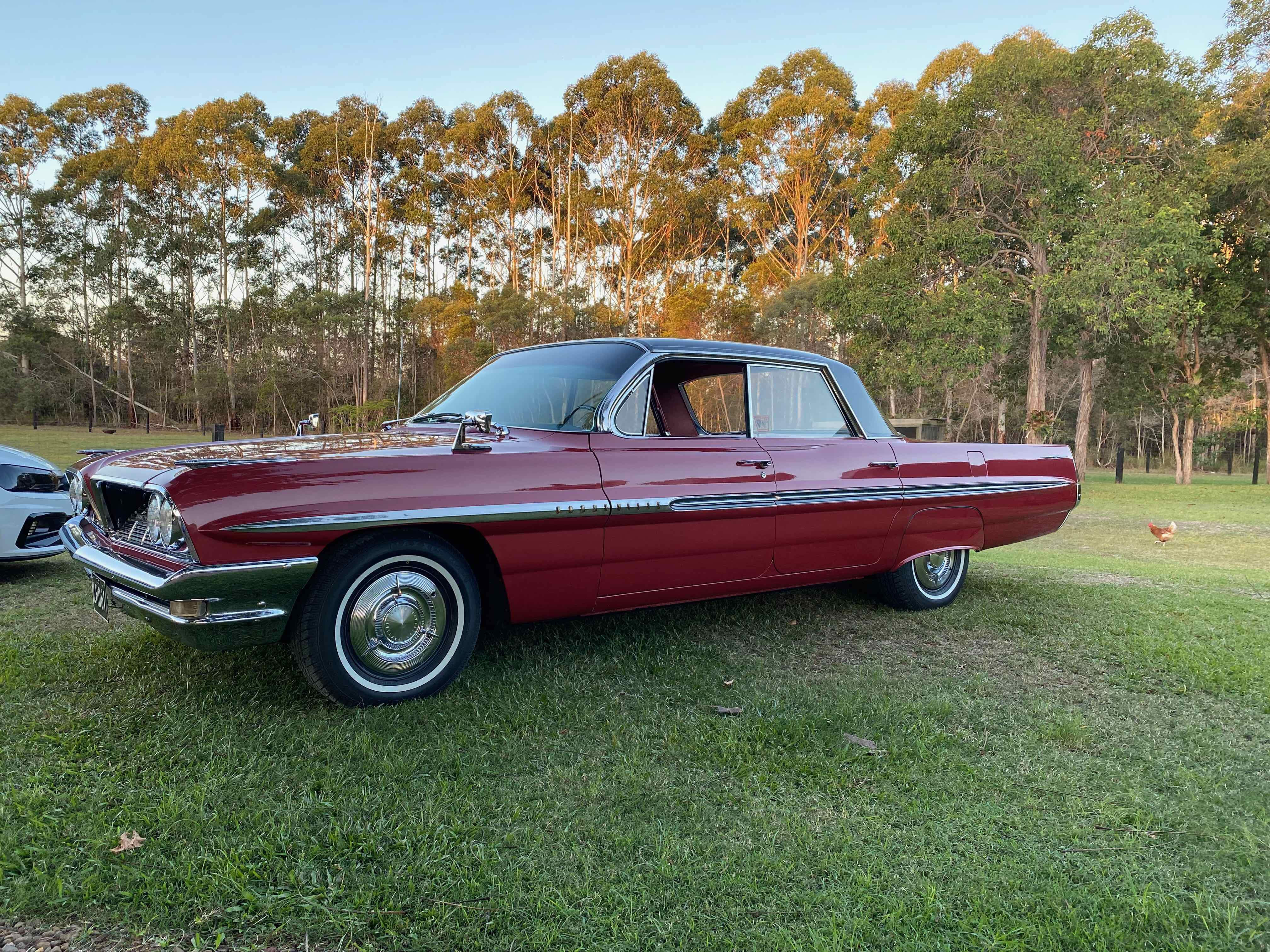

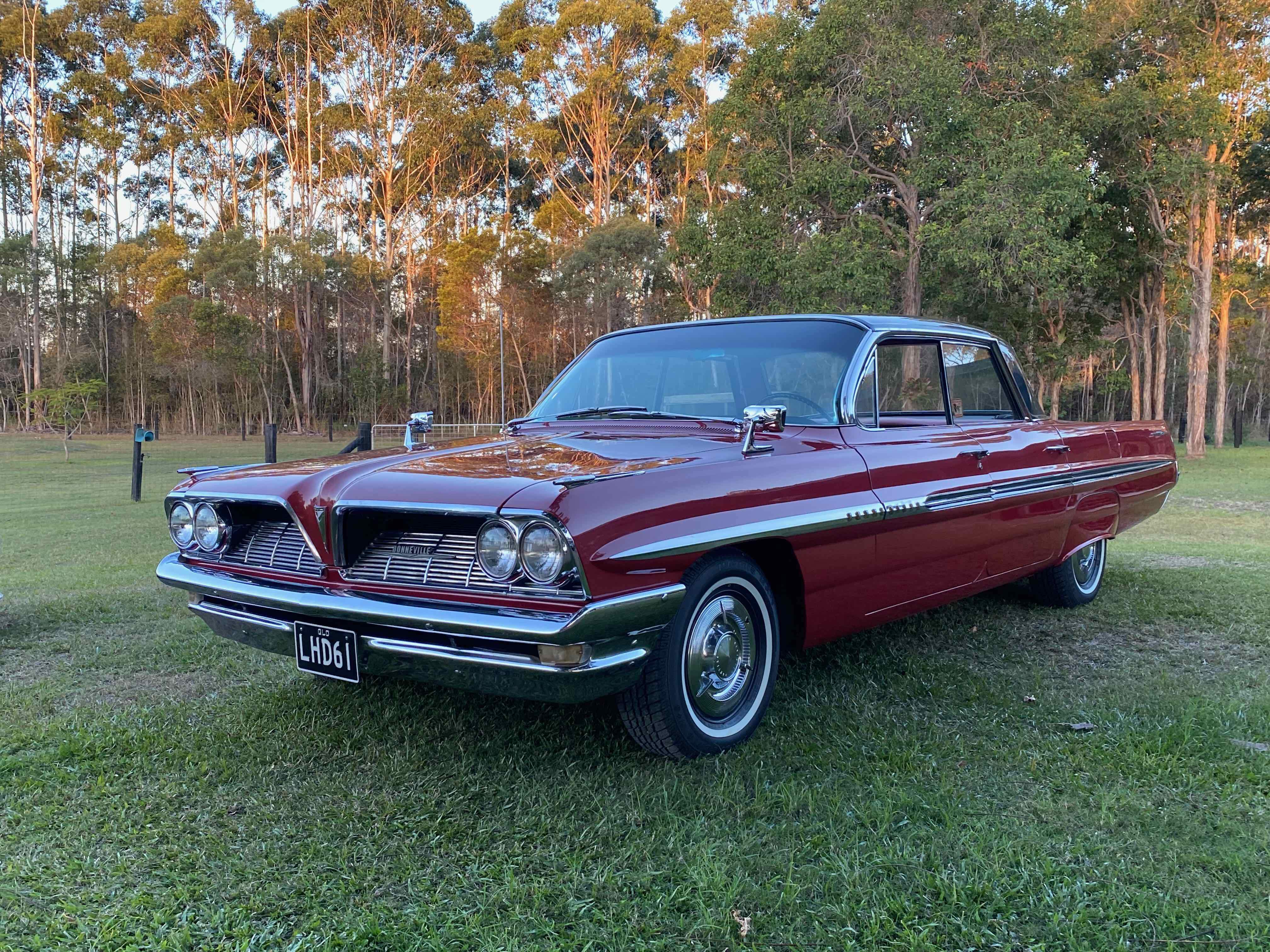

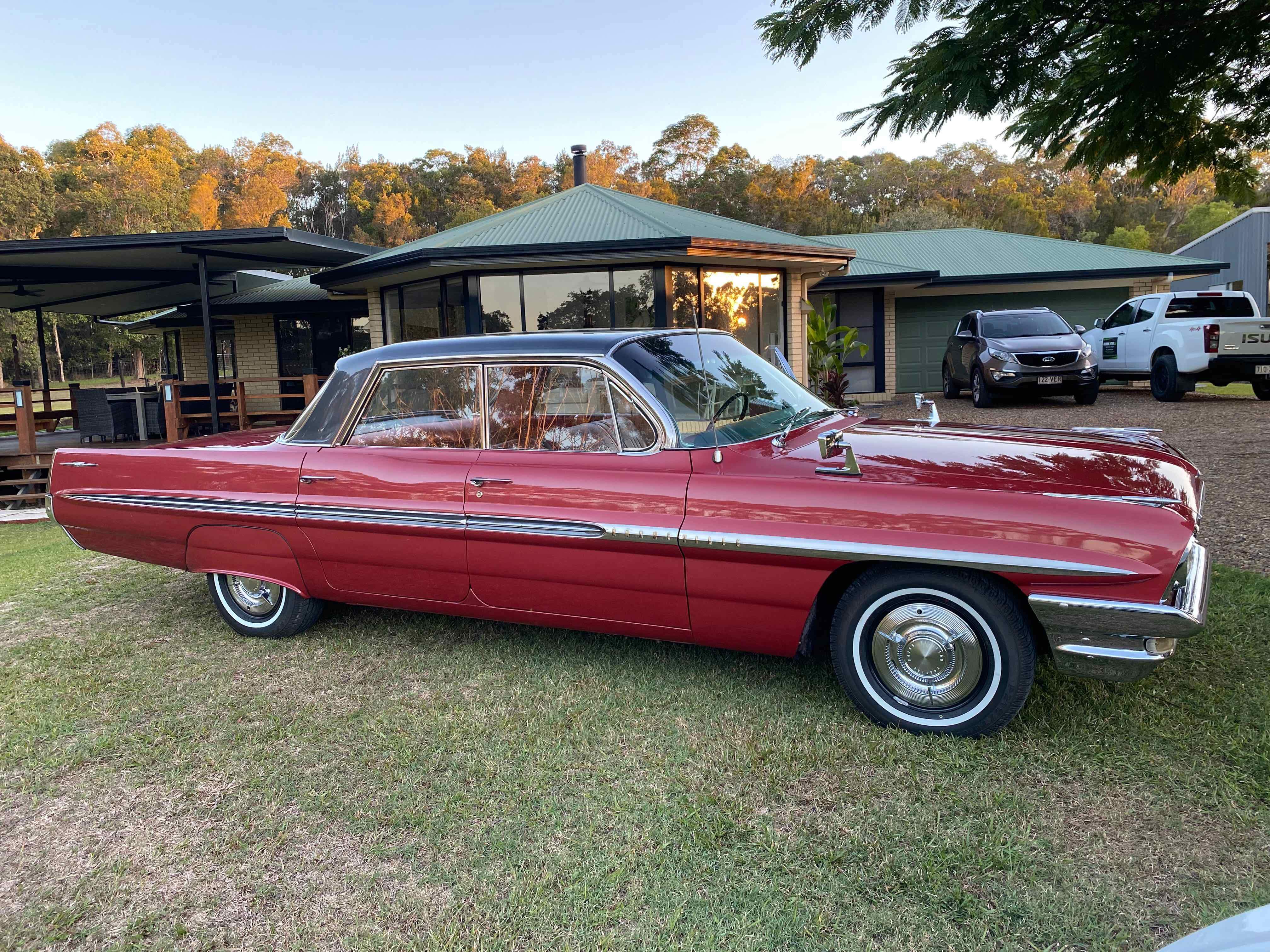

After months of waiting, we finally picked up the Miss Pontiac earlier tonightĀ šŸ˜€
I have attached a few teaser photos below - more to come tomorrow, & when I work out how to upload videos you can listen to the sweet sounds too 😈

What a find!!!Ā  Can't help but sit here N stare.

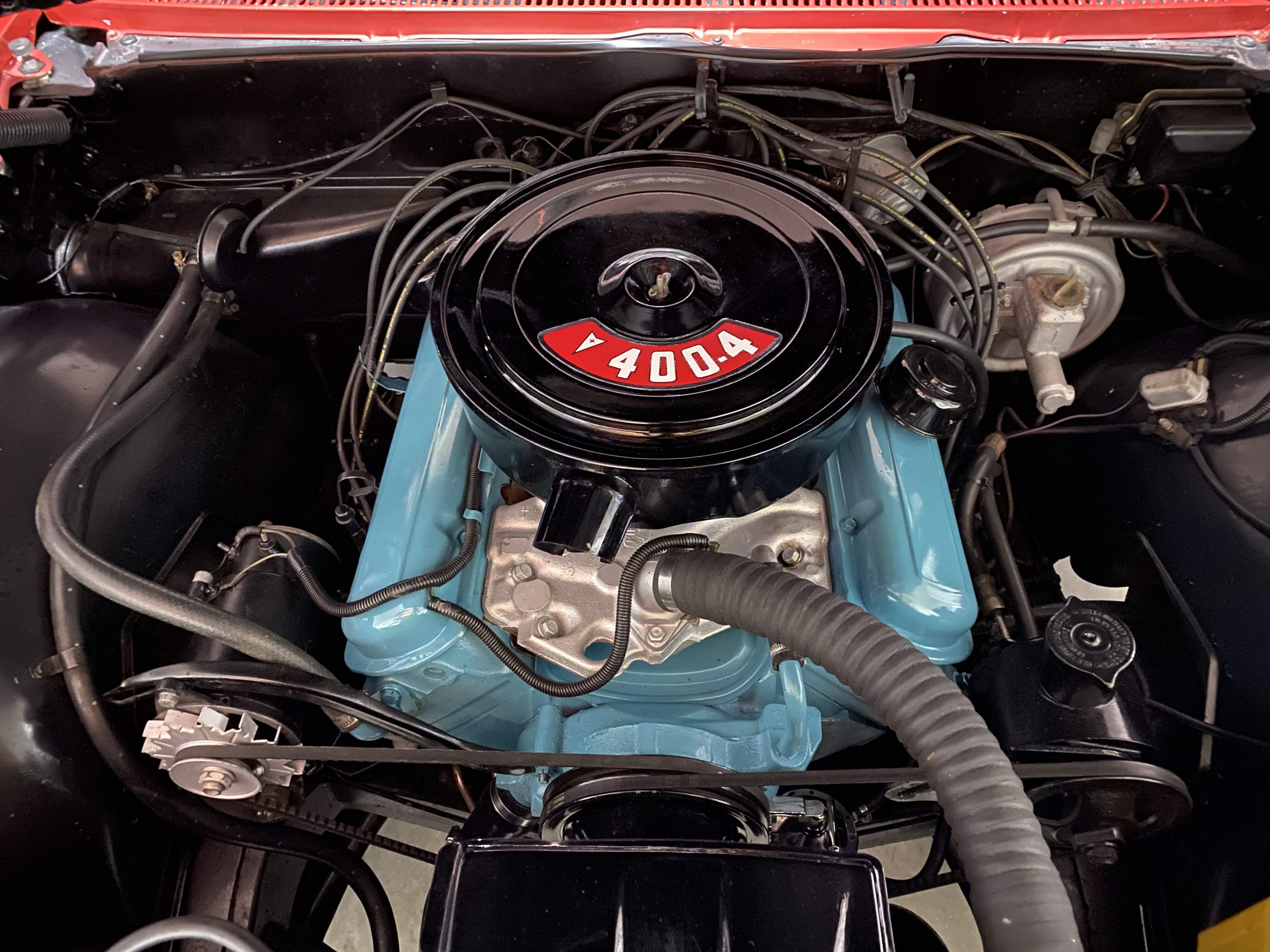

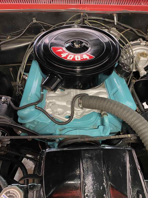

Hehe, we've actually owned her since September last, but it's been in for an engine rebuild since January.
A long wait, but an awesome outcome. Original 389 (.060" over, now a little over 400ci) with a "mild" cam, shaved heads & block, & Butler forged pistons (to name but a few bits).
Love that soundĀ šŸ˜„
looks fantastic PaulĀ :bowdown:... now you soooo have to put her in next months potm !!!Ā
Awesome Paul!!!

Brand new 61. WOW
Damn it Paul, now thats clean bro. Super impressive.Ā :cheers:

Thank you šŸ™šŸ¼Ā

clean!!! wtf!! i could eat my fish n chips off that motor !!!:bowdown:
That's how mine looked after it's rebuild. Don't worry, Paul. After a few thousand clicks, it'll settle down with a little oil mist, some dust and some road grime. Looks damn fine right now.

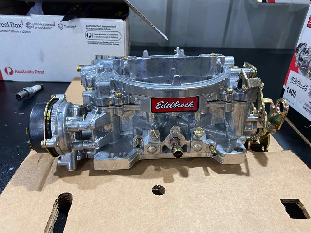

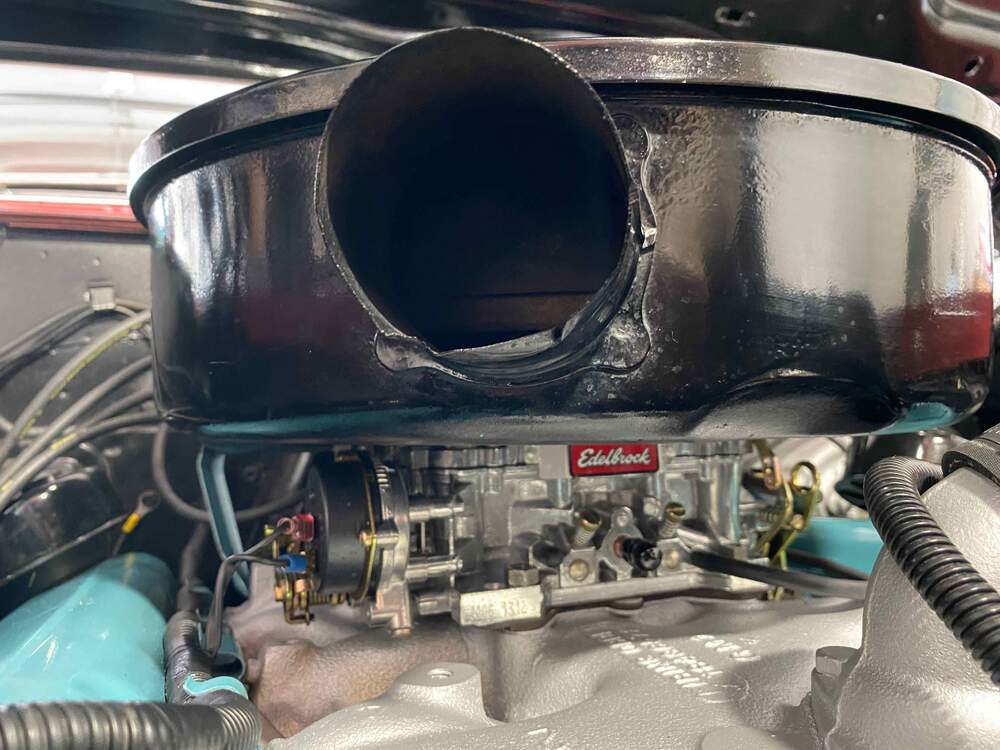

We were originally going to install a Holley as part of the build (my builder has a lot of history with them through building cars for drags & racing), but what with some research & advice opted to remain with the Carter (it's a 4242s from a '67 Firebird, not the original 2820s).
Current economy (after about 400 miles over the last 5 days) is a little under 16l/100kms, which I feel is fantastic. However, it has become apparent that the Carter is too worn to provide the drivability I would like on initial start up & at low sped cruise speeds.
So, an Edelbrock has been proposed & ordered - hopefully it will arrive & be fitted this week, just in time for the big run to Cooly Rocks On.
I'll keep you posted...
Nice! Any idea which Edelbrock was ordered, 1406,1906 or???
