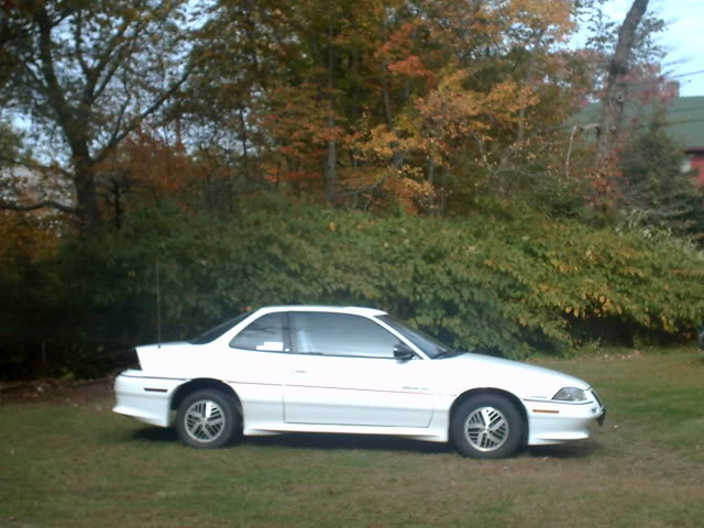

Onilink67's 93 Grand Am GT HO
Well with the amount of repairs the 94 needed were starting to pile up I decide to get another. Thanks to Randizzle who I bought the car from and drove 1500 miles back with I know have a 93 GAGT HO.
Car already has a few mods
- Header back exhaust
- Custom CAI
Mods coming up
- Dick Read PnP head (3k on it)
- HG2 Cams
- Dual Borla ProXS mufflers with GP GTX tips
A few pics of how it stands some with the 94 and the sebring in them

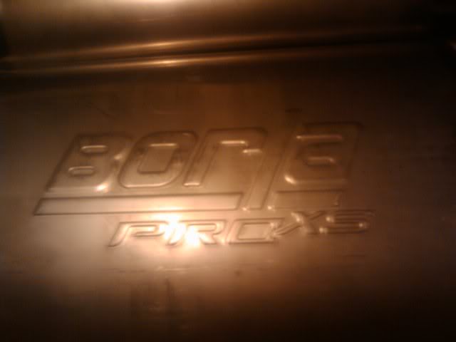

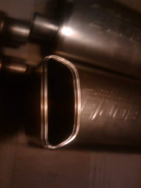

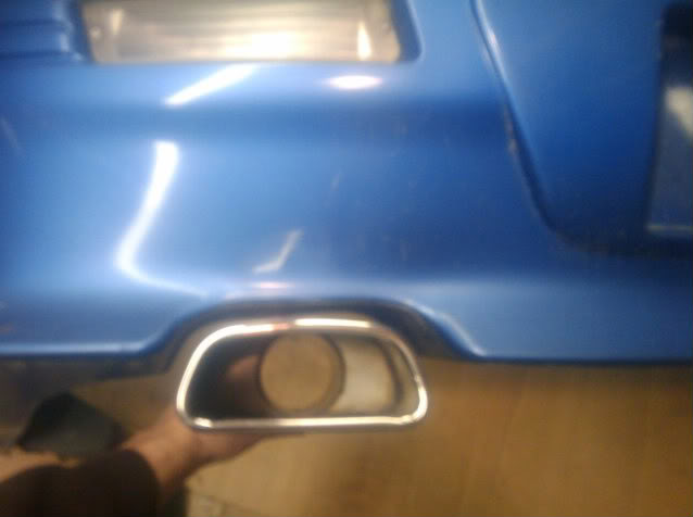

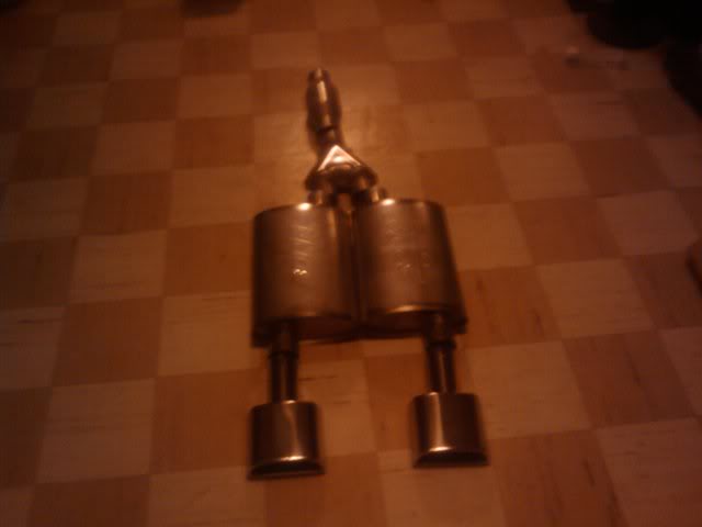

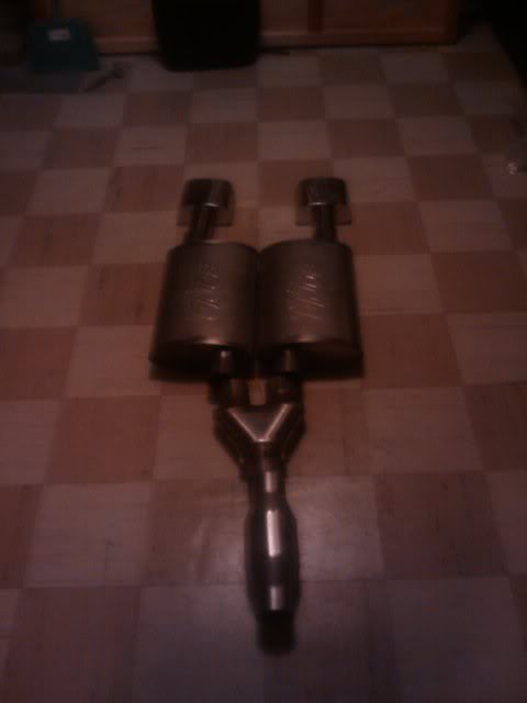

Well apparently exhaust shops around here don't like to bend stainless steel because "it crimps too easily" :wtf: I never had this problem with my 2000. I found a place on the other side of the state (45 min away :) ) That will do it for me and even better they do mandrel bends. So the car is back in the driveway and exhaust parts are home again I decided to take some pics of the shiny exhaust parts before they get put under the dirty car never to be seen again.

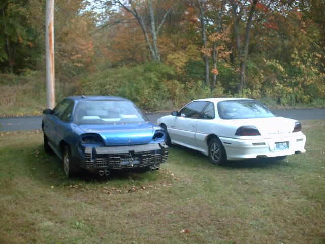

And here is one of the 94s Goodbye

Actually Not really the problems kept adding up with that car and finally was easy to just start over. I did learn a lot on it though and it was worth the $400 I paid for it initially.
