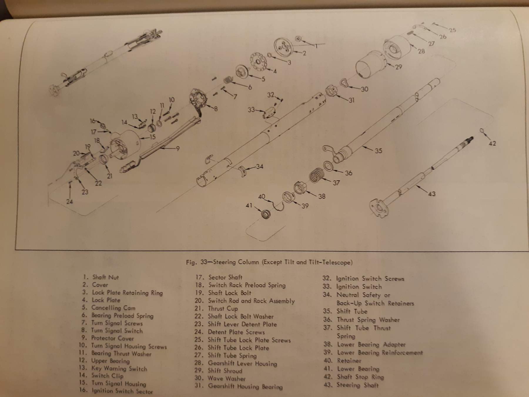

If you decide to go with the tilt wheel...I would agree with Kiwi...It would be hard to go wrong with an OEM unit..16390132172052450779640155711.thumb.jpg.afcdde93b1fa13cd40a13f8234f355ae.jpg
GM..Non tilt column...

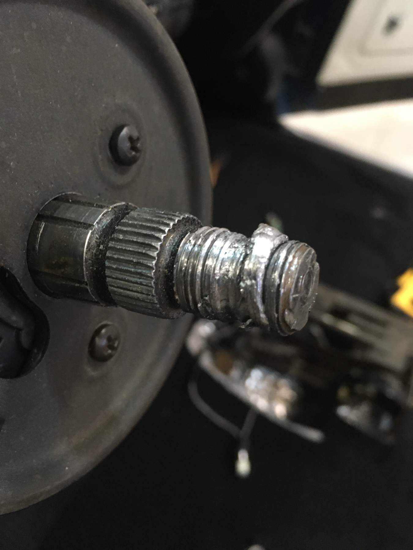

Justa to satisfy my own curiosity...Would it be possible to post a couple of detailed pics of the threads and the nut...??
Sure Two Lane. I justa need to find it again. Here it is.....I f'd up the jam nut pretty good too in the process of removing it. I didn't take a picture of the nut. I will have to do that the next time I am at the garage mahal.
Careful you Justa might get whatcha asked for.   Good Night whatta mess.  Not worth welding and retapping those threads.😟

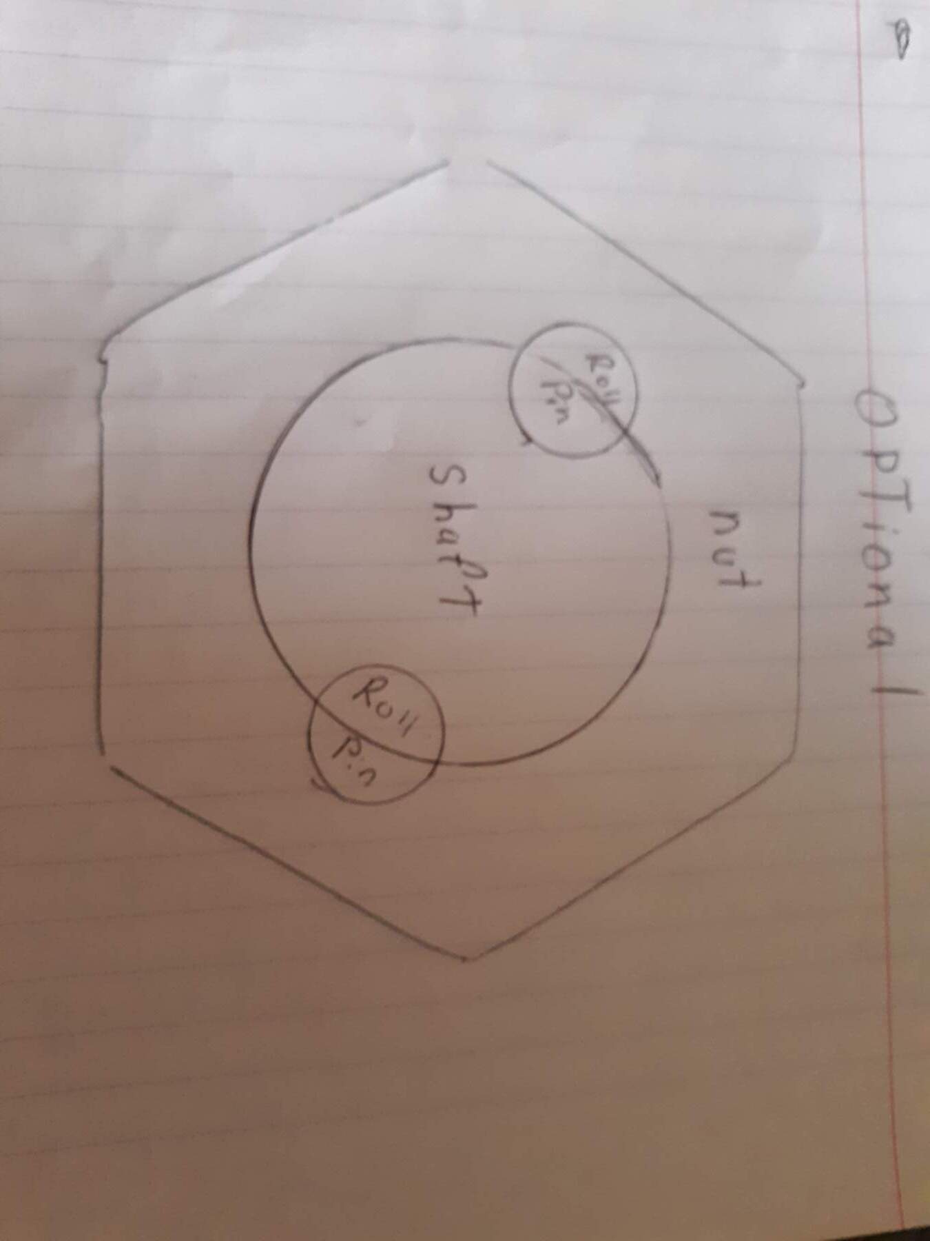

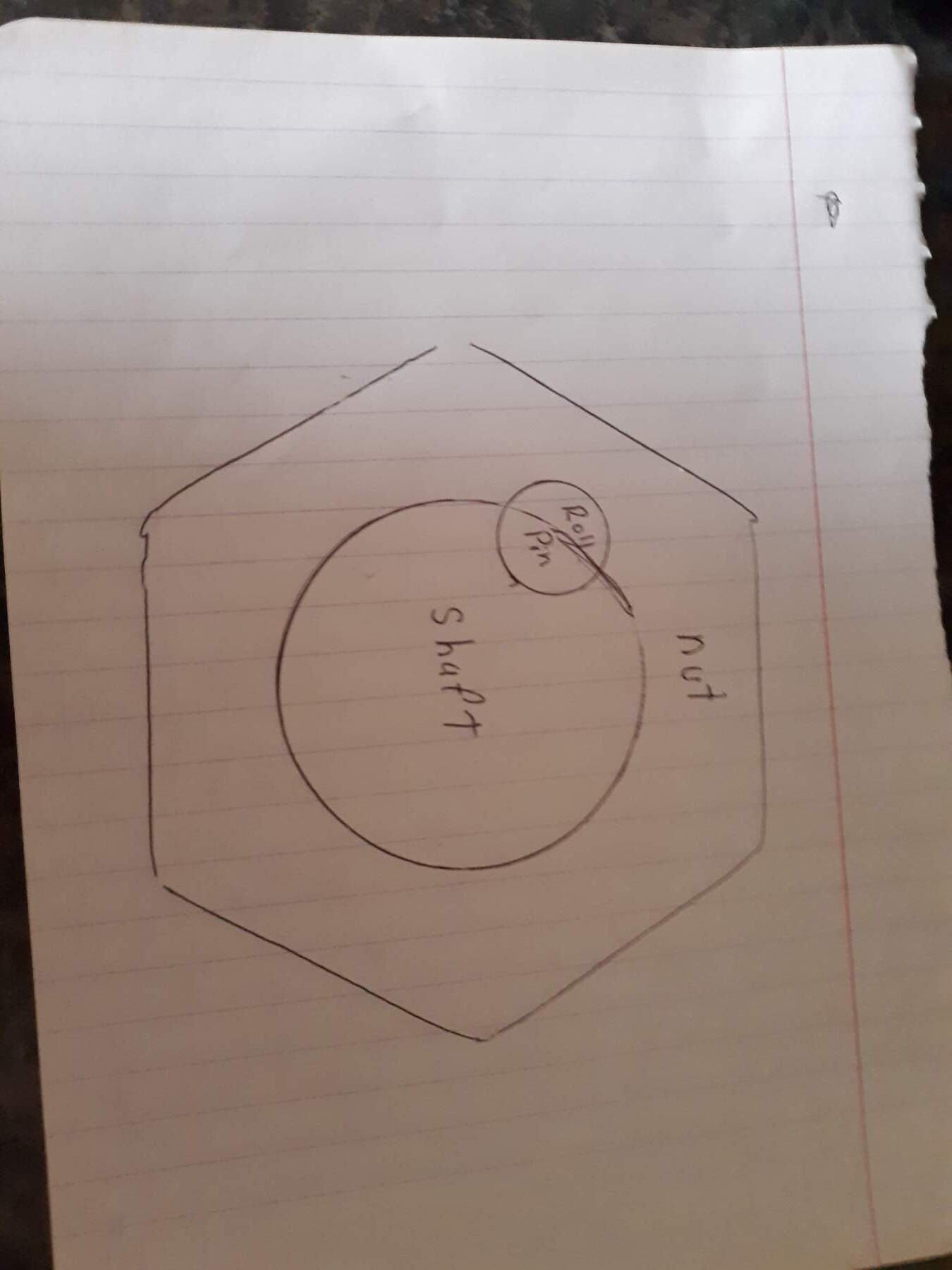

Yeah..It is in pretty bad shape...But..There is another option besides welding up the shaft and rethreading....That may work really well...
You might be able to "pin" the nut and shaft...What I mean by that is...If when the steering wheel is seated all the down..If It is even with the top of the spline...There is still some threads left right above the spline...There also appears to be a couple of threads left at the top of the shaft..
First thing to do would be to file down the high spot where the threads are gaulded up... To the point to where it is even or justa below the circumference of the shaft being really careful not to hit the the existing threads at the top of of the shaft...Use a thread file ...To carefully straighten out the few threads at the top of the shaft... justa be really careful take your time and pay close attention....Once you get the top threads straightened out enough to where a nut will start...Take your time and check and double check that the nut is starting on the shaft straight...Once that is accomplished...Use the thread file to clean up what is left of the threads above the spline...Then carefully run the nut down until it bottoms out against the spline...Don't use any unnecessary excessive force when snugging the nut..Carefully...Take the nut back off..The put the steering wheel back on the spline insuring that it is clocked right...(you will only have one shot to get it right) Then carefully run the nut down against the wheel...Once that is done...Use the proper sized drill bit..for a 1/8 (.125) split roll pin...Then drill a hole with the center line between the shaft and the nut..Once that is done drive the pin into the hole and cut it off even.. It doesn't matter if there are no threads contacting the inside of the nut all the way down just as long as the remaining threads Above the spline are still intact...The Roll pin will effectively hold everything tightly together and keep the nut/shaft as one unit..Forever.. If you ever need to remove the steering wheel again you can drill the pin out...and everything (nut) will come back off just like before...
That is an option...if you really don't want to remove/replace the steering column...

Actually that’s pretty easy to salvage. On or off the car, but it sounds like the snow cone wants a tilt wheel?! Am I right? Go t to run, but I’ll give instructions as to how to fix it like new, and there are several option to it!

I find your shaft/nut/roll pin idea very intriguing. It's something I definitely need to file away for future use. Thanks for that. That is something I had not considered at all.
That thread looks seriously screwed - how on earth did you manage to do that? I consider myself a Master Of Screwing Things Up, but not even I could make a mess like that.
I wish I knew Fitzy. I was test fitting a new steering wheel collar for the Formula steering wheel at the time. I had taken the dash in and out so many times in the past year that I had scratched up the old one pretty badly. I went to take the jam nut off and I discovered I had "magically" cross threaded it somehow putting it on. It was so badly cross threaded that my 1/2" drive socket wrench would not get it off, it would not budge even with my back into it. I was forced to use my 1/2" Porter electric impact gun to get it off. That jam nut was hot to the touch when it came off!!!! I'm pretty sure using the impact gun really helped to screw up the threads even more!
Oh, so as you were sliding the dash in & out, it was dragging along the thread? Yeah, that'll do it. Threads are temperamental buggers: if treated properly they work beautifully. One little compromise and if you're unlucky, it's all over. I should be touching some wood as I say this, but I am yet to ruin a spark plug thread. I could think of no less a harrowing scenario as that: oh the tears I would shed as I leaned into the engine bay and sobbed uncontrollably.
Not quite no. I was dragging the dash in and out onto the steering column and the collar of the steering wheel. So the collar got scratched and damaged. I purchased an exact replacement collar for the Formula wheel. I put the collar onto the steering column and spun down the nut. Like I said, I have no idea how I buggered it up and cross threaded it. I"m still pissed at myself for that.
