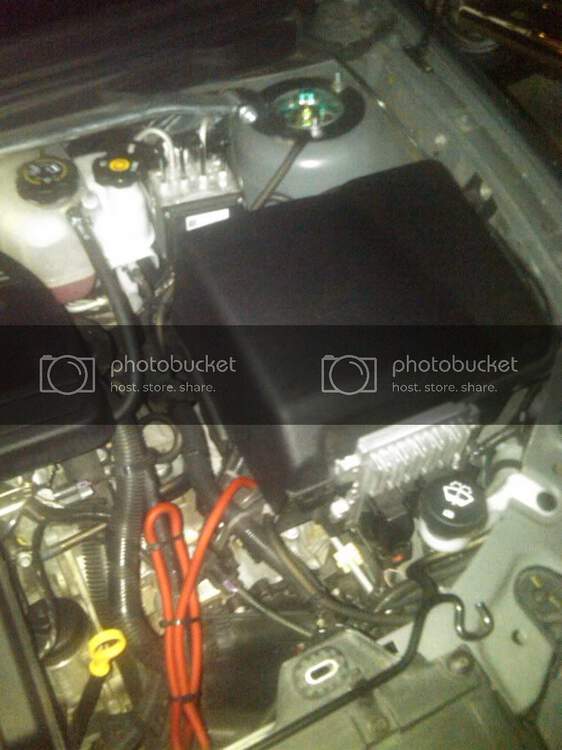

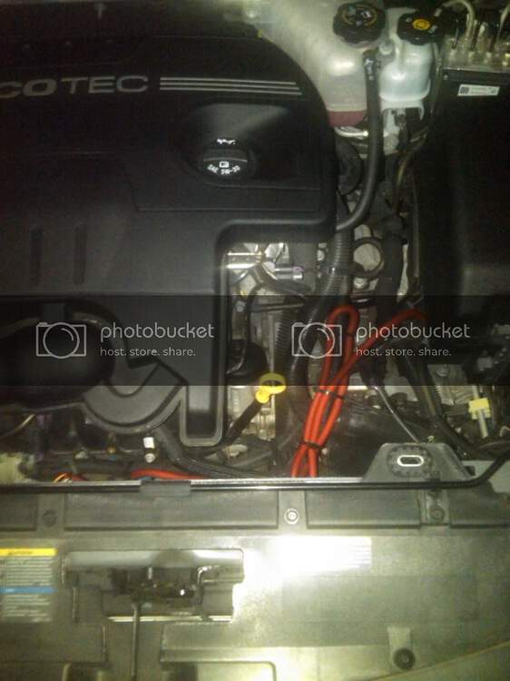

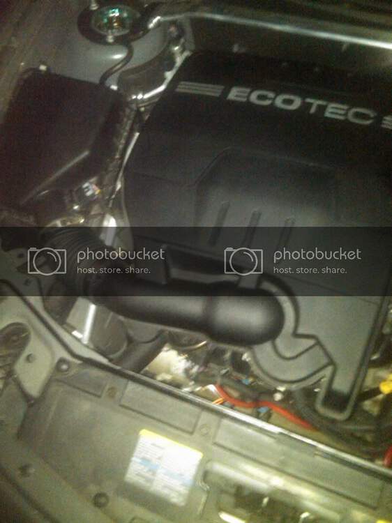

Well, I got the grounding kit installed finally. I need to finish tucking a few of the wires though. It seems to help with the lights dimming.
Thanks.
Update!
After driving her around today, I noticed that the rpms at idle were only about 700. 'll have to wait and see if I notice any other benefits.
Here are the pics!
The setup I ran was
Bat - to Body
Alt to Block
Block to Body
Block to Tranny
Tranny to Body
Alt out to Bat +
