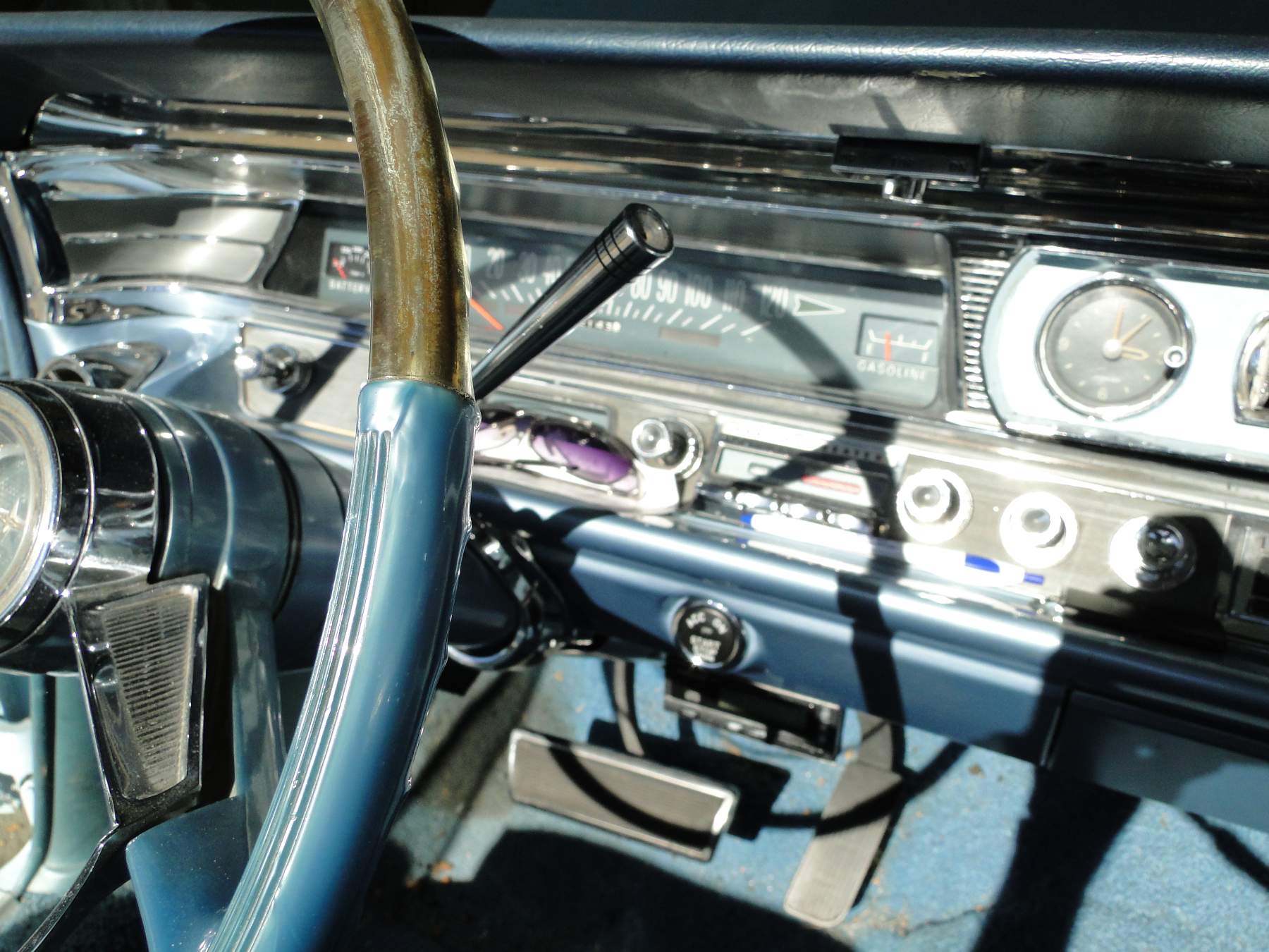

Not much to see on the keyless entry. It is all under the dash, only visible modification is that the original ign switch is gone and the start button has taken its place.

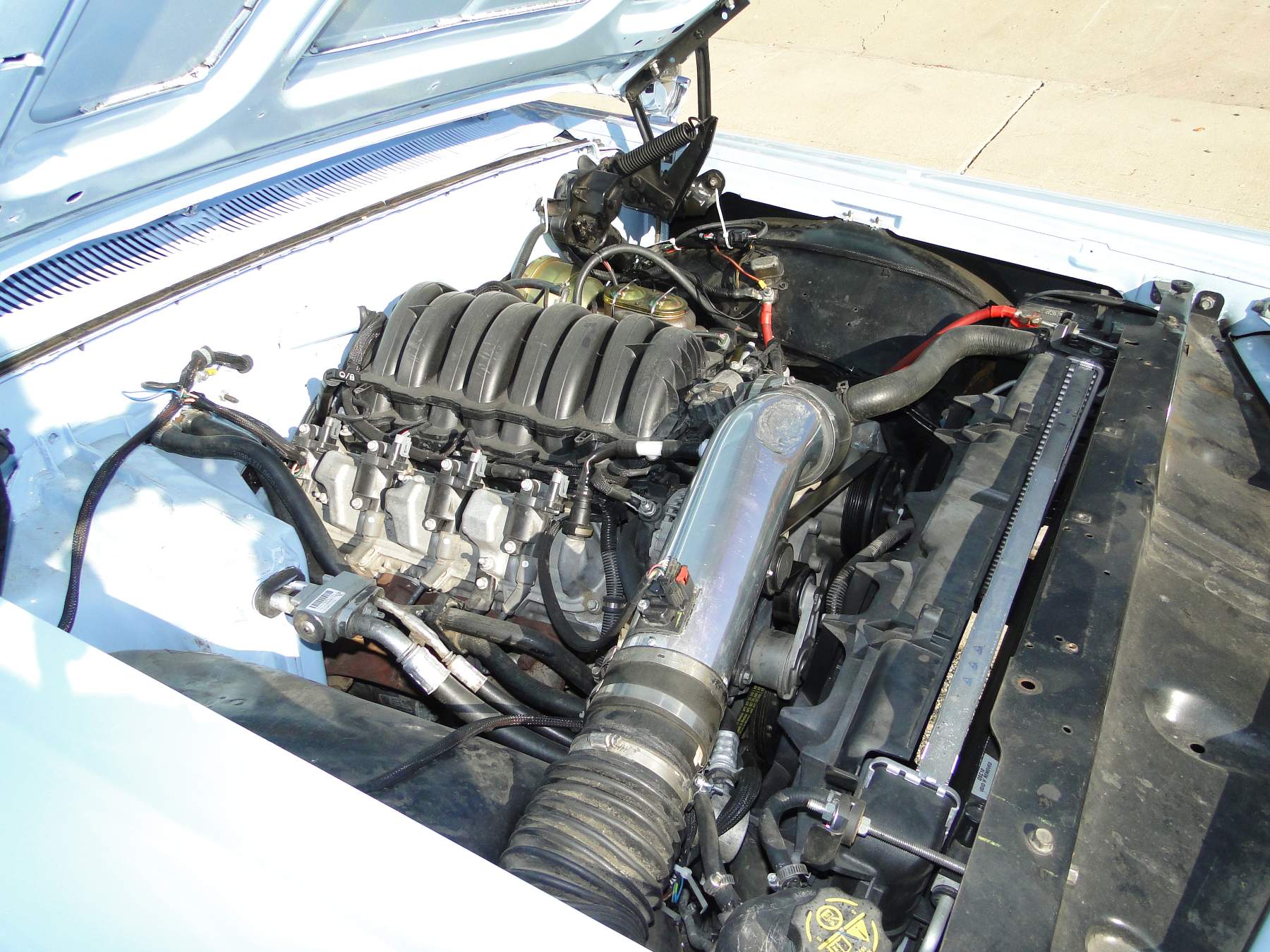

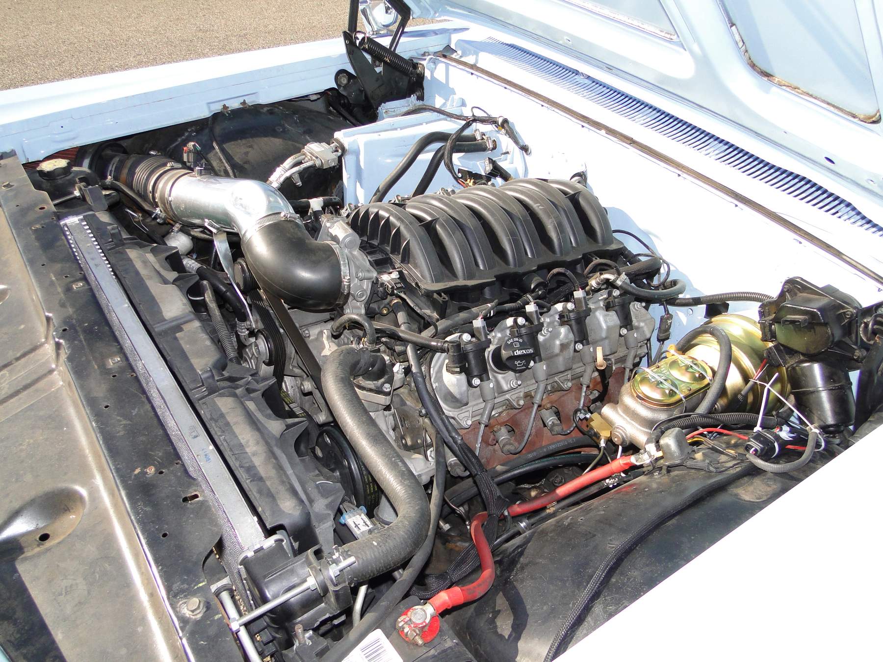

Finally took the time to take some pictures and upload them. The picture of the dash just shows the keyless button in place of the original ign switch, the rest of the installation is under the dash. With the LT installation I actually have two completely separate wiring systems about 50 years apart in technology. It was a bit of a struggle to incorporate the keyless/push button system. It required separating some wiring and isolate the systems to make it work but Gallo Tech was very helpful and patient in helping me to work it out. As for the engine/trans install it was beyond any shadow of a doubt the most difficult installation I ever did, lots of cutting and fabricating.
