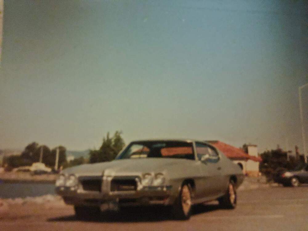

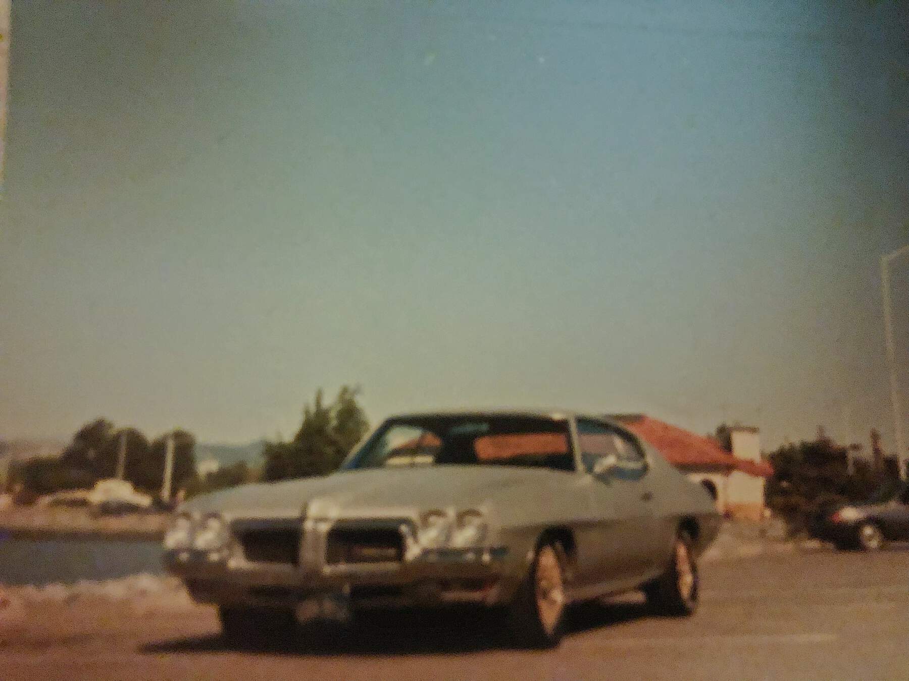

im rebuilding my uncles 1970 Pontiac lemans. He wanted to make it a drag car, but passed before he finished the project. He already put a ford 9 inch rear axle and some pretty fancy suspension in the car, but from there it’s a blank canvas for me.

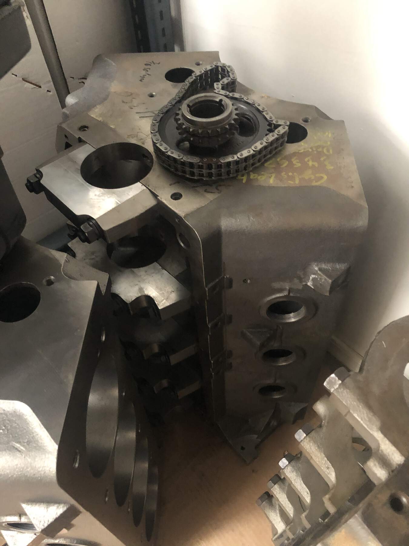

I met the co-owner of a company called allpontiac. They build aftermarket aluminum Pontiac blocks. If you don’t already know them, look up allpontiac.com. They’re incredible. Anyways, with his help, I’m putting a 535 engine with aluminum edelbrock heads, a Holley street dominator intake, and I’m working on getting more parts!

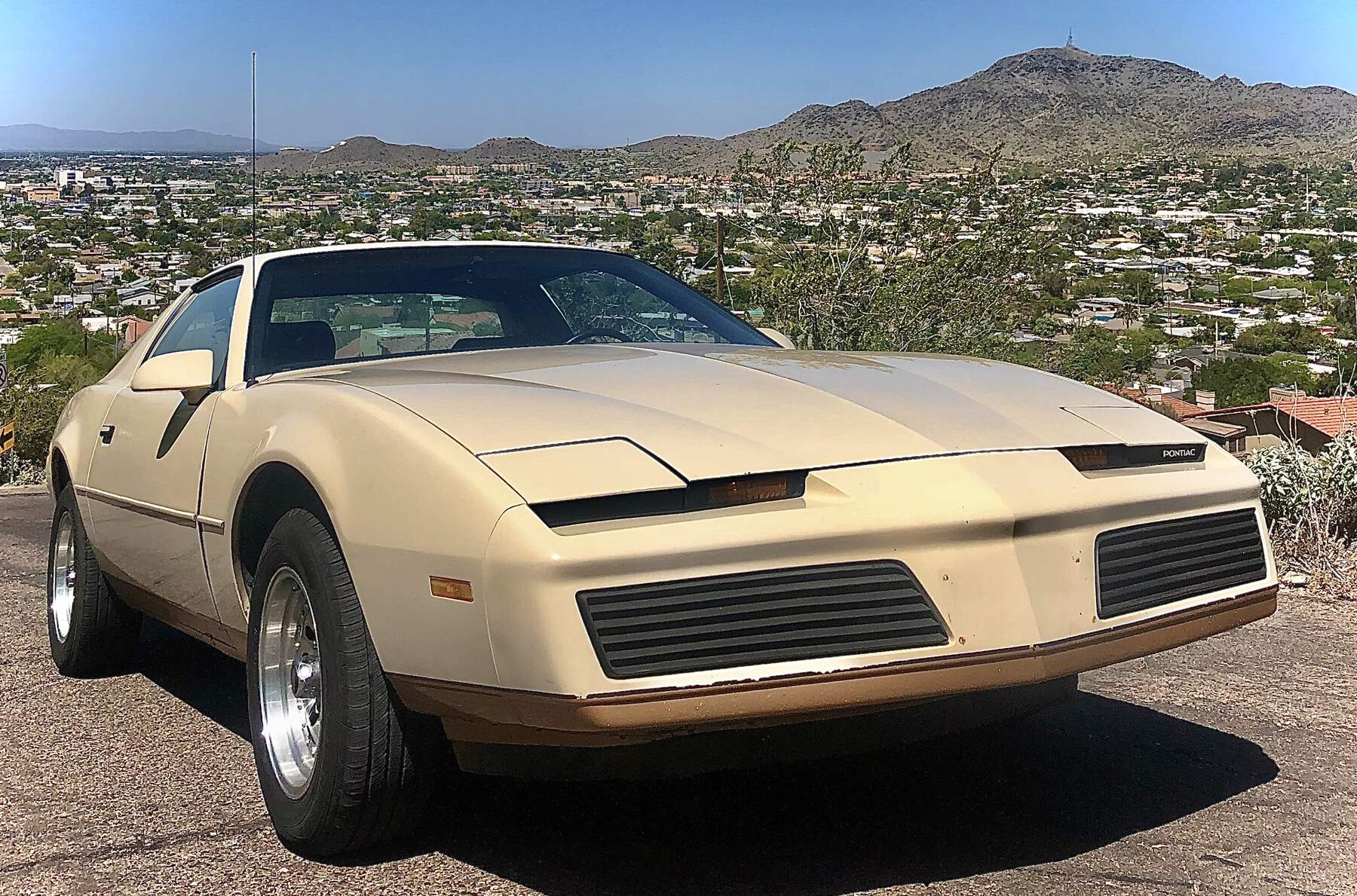

I just have the 350 for parts. I will be using a 535 cubic inch engine from allpontiac in the lemans. I also have a 1984 Firebird that I will drive a lot more often, I just want to be able to drive the lemans on the street. I appreciate all the advice! I will make sure to update this thread when I make progress!
