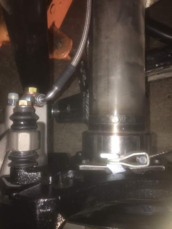

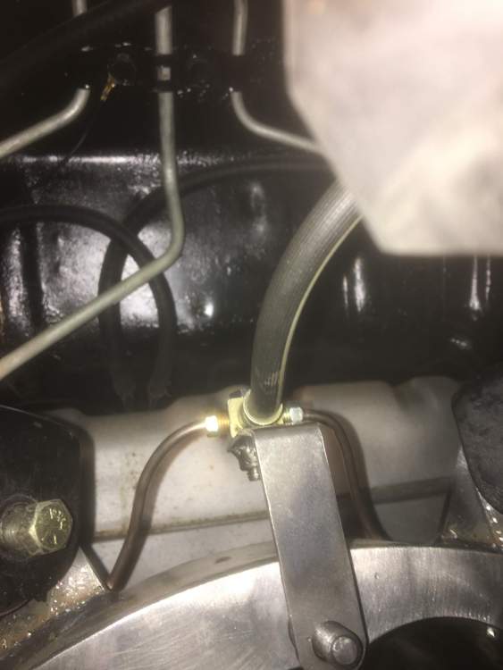

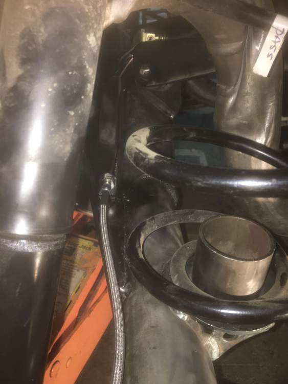

Well the old rear end is out. All the Parts from QP arrived in the last week. Total bill was 3300.00 .
I will not be using their upgraded brake line kit. ( not worth the $75.00 and would look like crap in my opinion )
Instead i went to my parts store ( autovalue ) and bought weld on brake line retainers PN 60029 allstar performance, and ford replacement rubber hoses PN BH25665 parts master and PN 50150 allstar performance brake line clips.
I made a bracket to bolt to the 3rd member to mount the original brake tee.
I am using NiCopp hard brake lines from the rubber lines to the tee.
This will look Factory i hope. Pics coming later today. I hope...

I'm going to send you all the pics frosty. I just finished the brake line mess tonight. Original mock up on bench didn't include the damn shocks in the way. An order to summit and all is good now. Sway bar is the next hurdle and i'm working on that tonight. They closed the track do to another lawsuit so..i have time now. The e-brake is the next chapter then the prop valve (adjustable likely) Taking longer than i wanted but i want it to look and function as if it was stock. If anyone has some old E-brake cables i will pay shipping. The ones from the drum thru the frame with the micky mouse clips.( i have the clips fwiw)

I just dont know what i need lol. I am getting closer though. i want to be able to use the original E-brake cable. Sway bar is in!! had to cut a small piece off the jack pad but it fits now and doesnt hit anything!
I'm Joe's local tech support. He sent me those photos so I could upload them for him into this thread.
This is what they sent Joe for e-brake clamps and hardware. Sufficient it to say he ain't going to use it.
This looks a lot better and function a lot better
Its installed right now for mock up purposes, Joe has to pull it all back out to paint it.
Here is the sway bar problem, it's hitting the jack pad at the front. The sway bar bolts in the front of the trailing arm were very close to lining up but he had to cut the jack pad to get them to line up.
After raising the right and left side axles all the way up and all the way down independently, the sway bar does not hit anything now! Yes!
