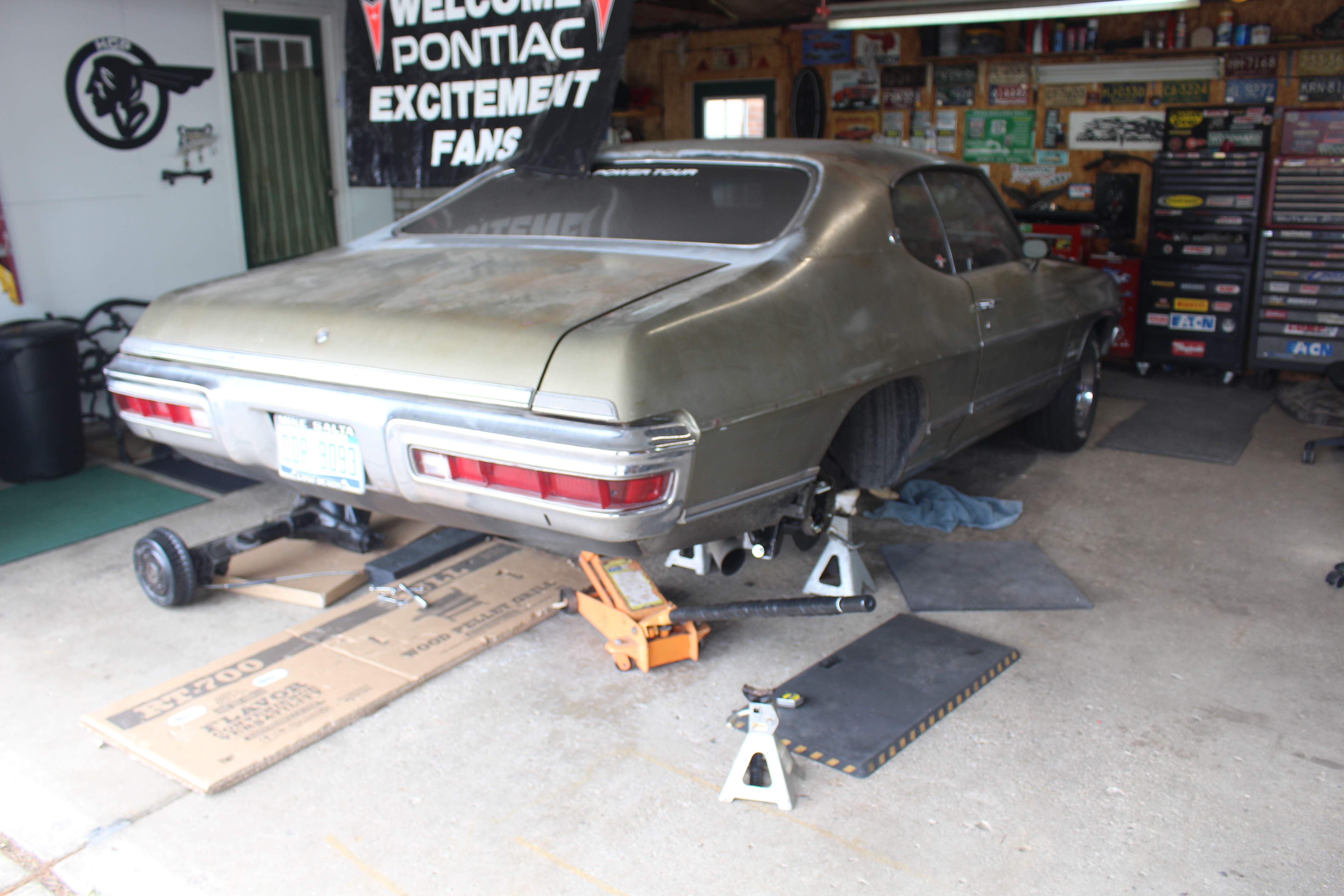

I paid Indyman Joe a visit yesterday. I dropped off a set of 15 inch rims too. I bought them from him a couple of years ago, I had them powder coated silver and then I had used the Eastwood Charcoal gray on the rims. I had not finished the touch up or clear coat work. I gave that all to Joe since I know he needs another set of rims to use to mount street slicks on for applying more undercoating to his rear wheel wells. I will be buying a new set of 15" chrome wheels here real soon for Lucy.

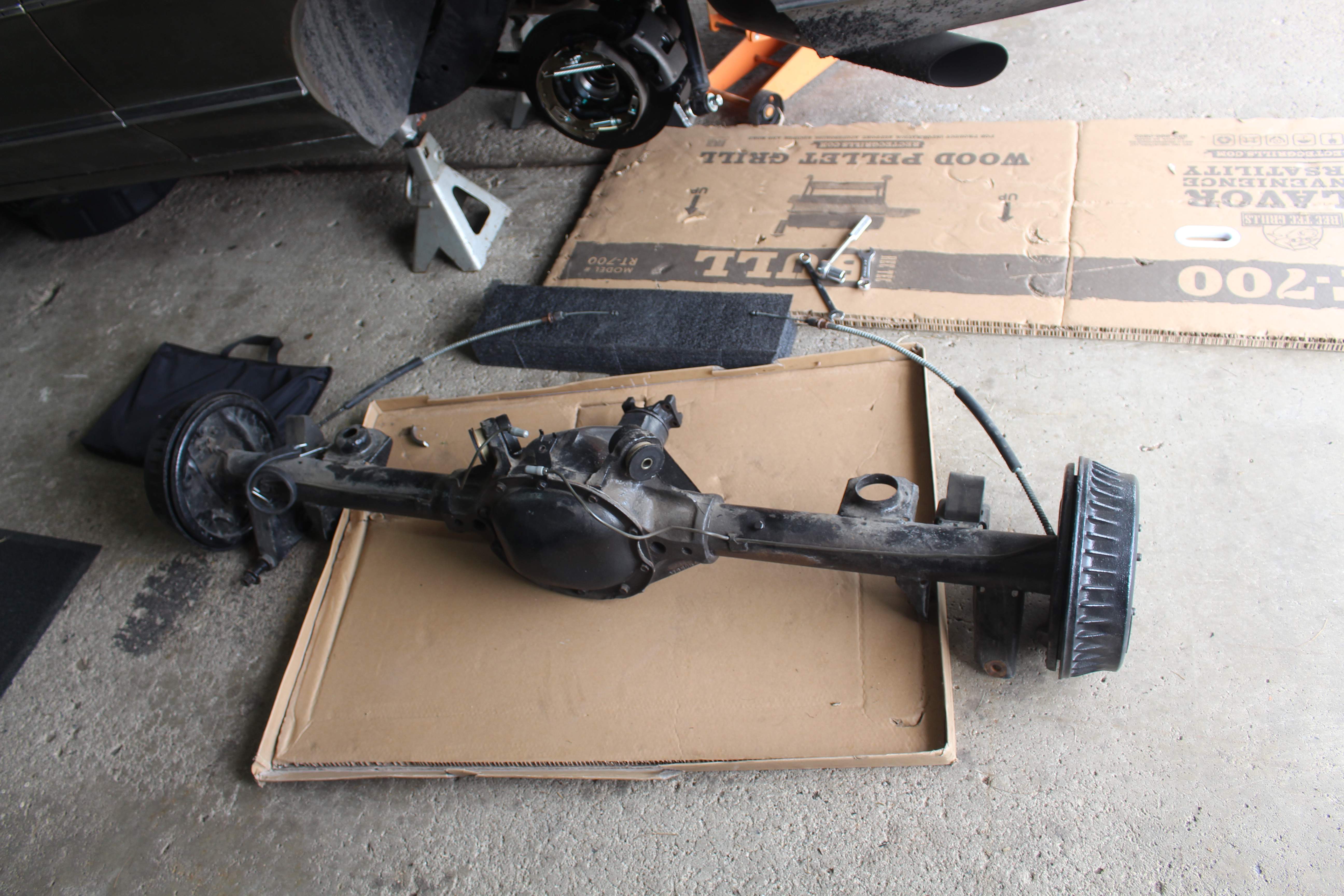

So while I was there I took so shots of what the car looks like at the moment, especially since I know how technically challenged Joe seems to be in uploading pictures to FP!!!! :rofl:

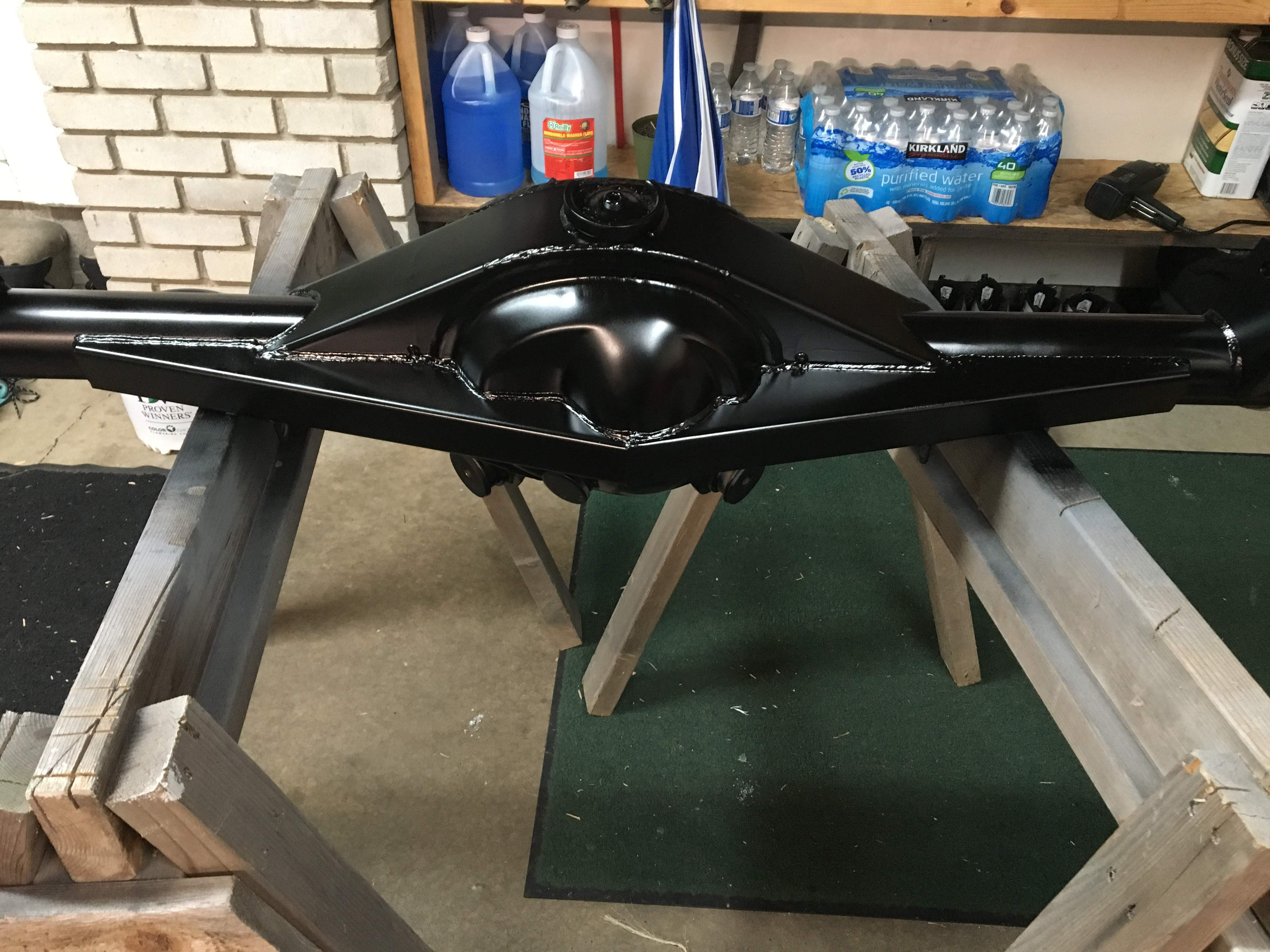

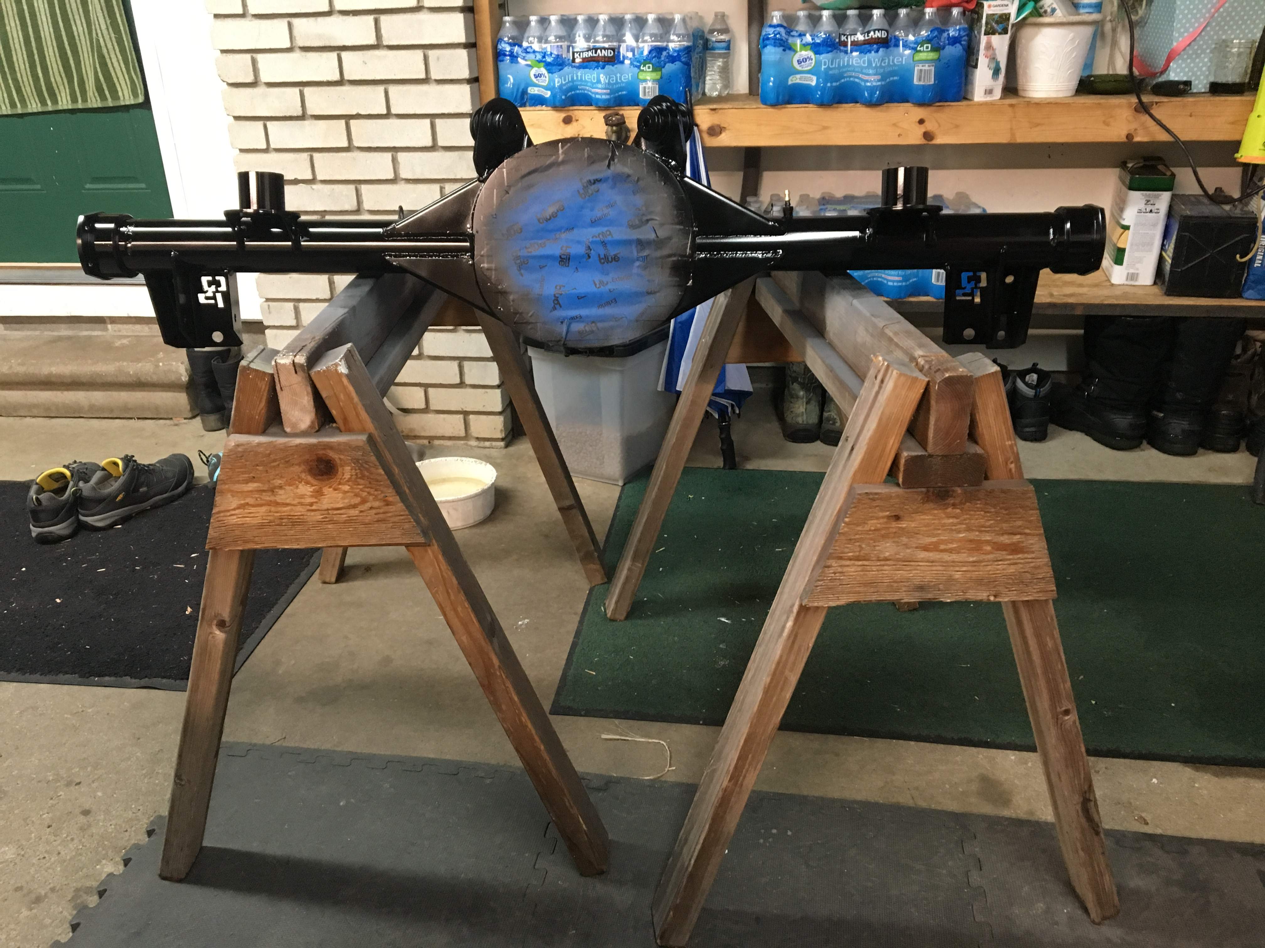

Old rear diff

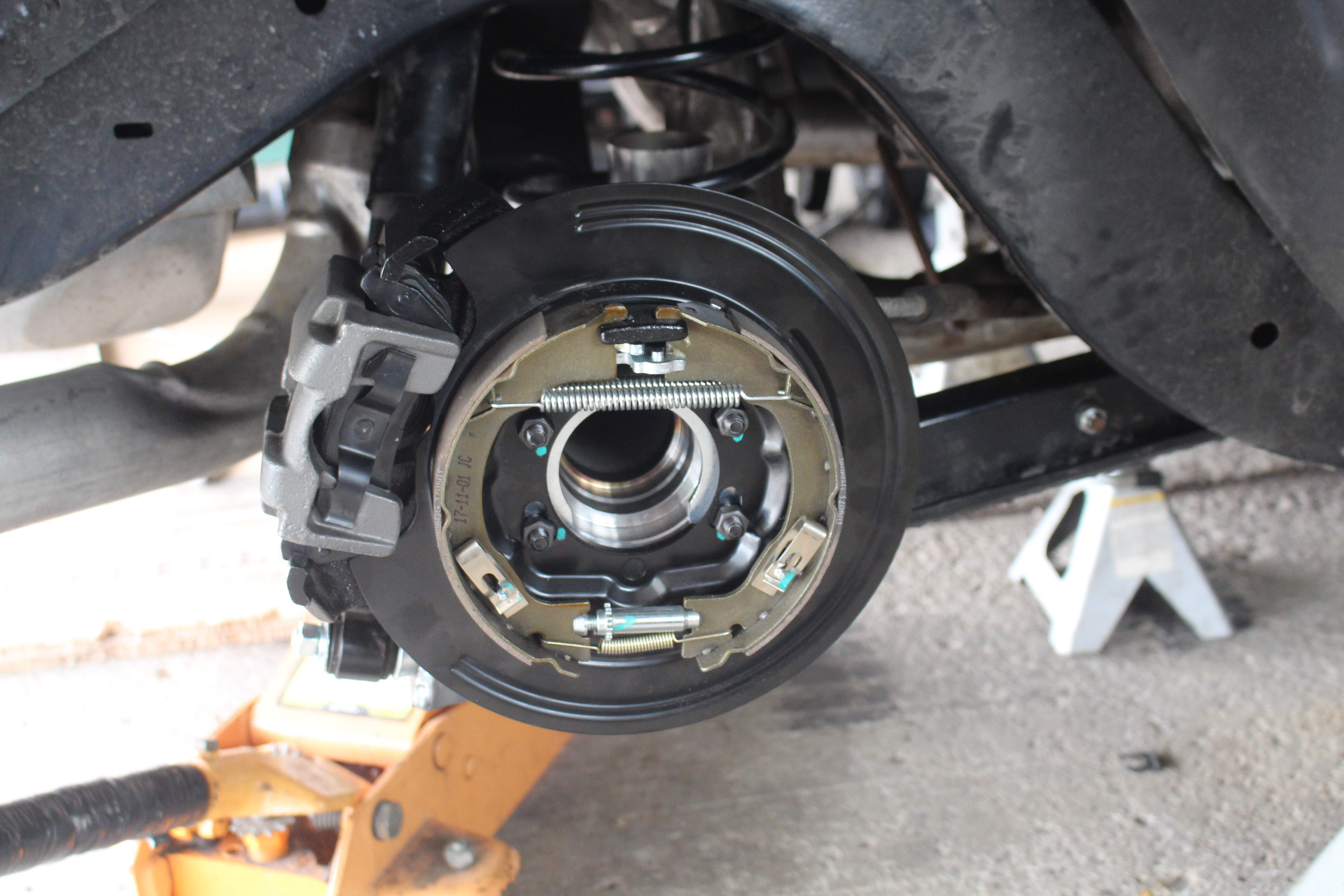

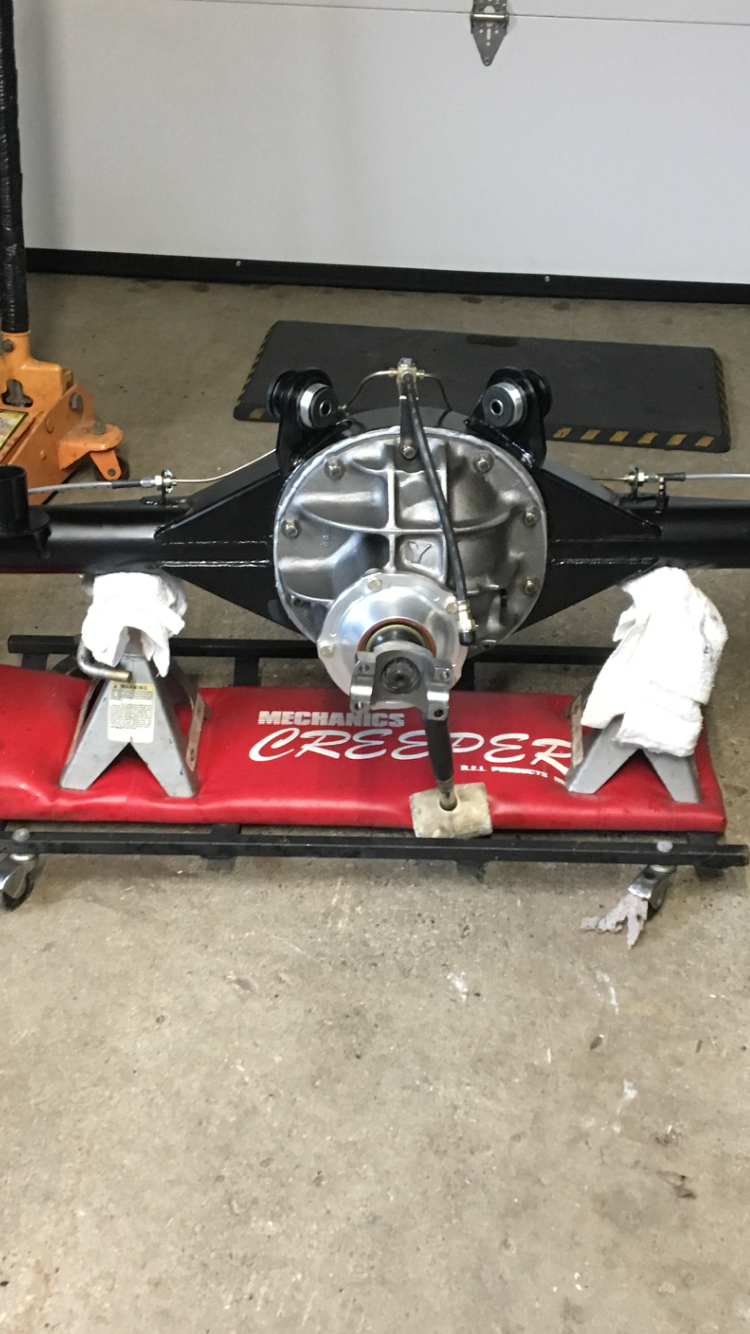

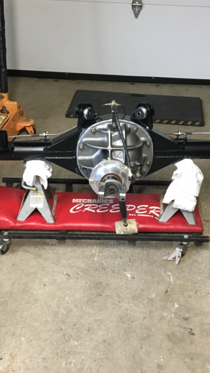

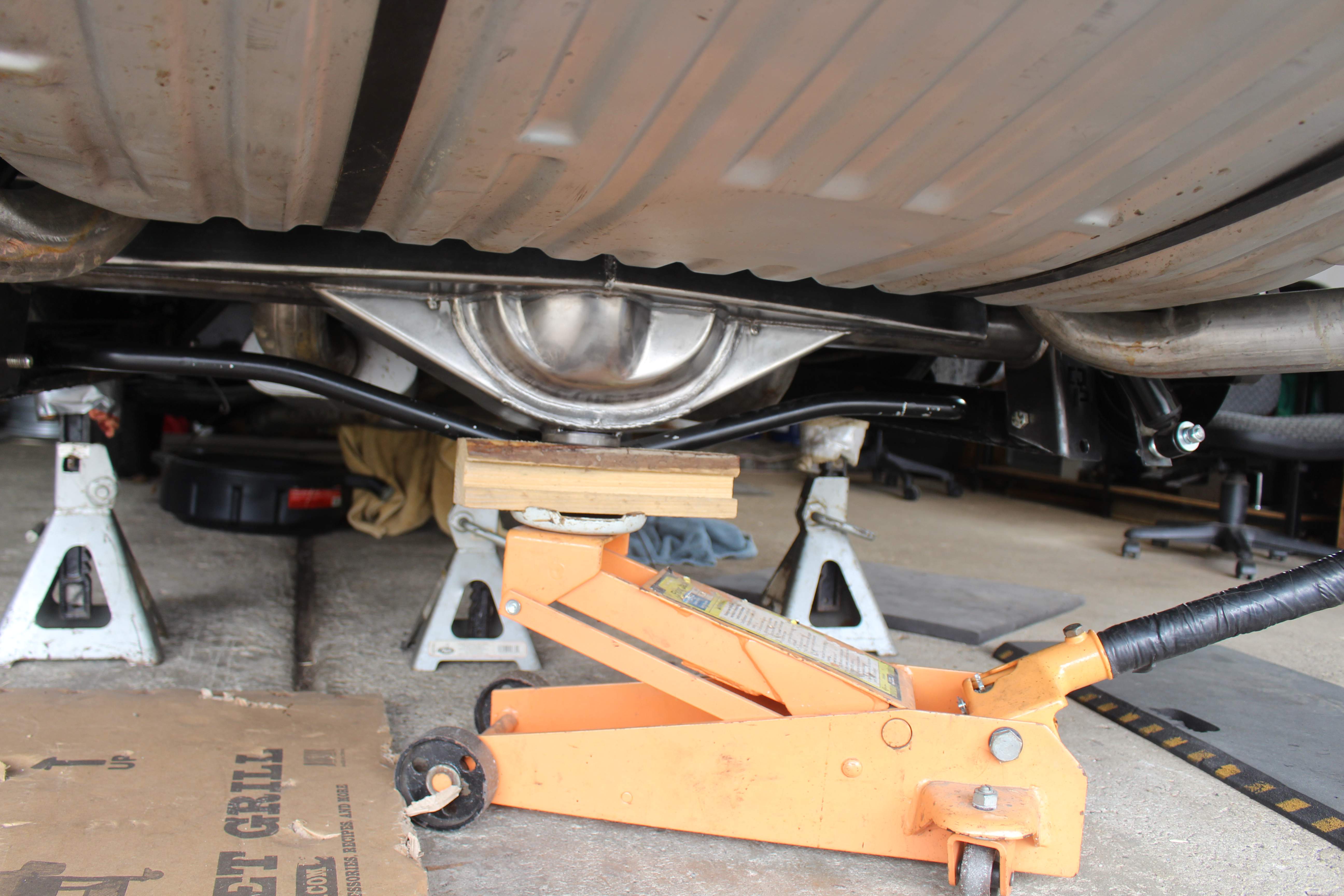

New diff case in place along with the sway bar and parking brake assemblies

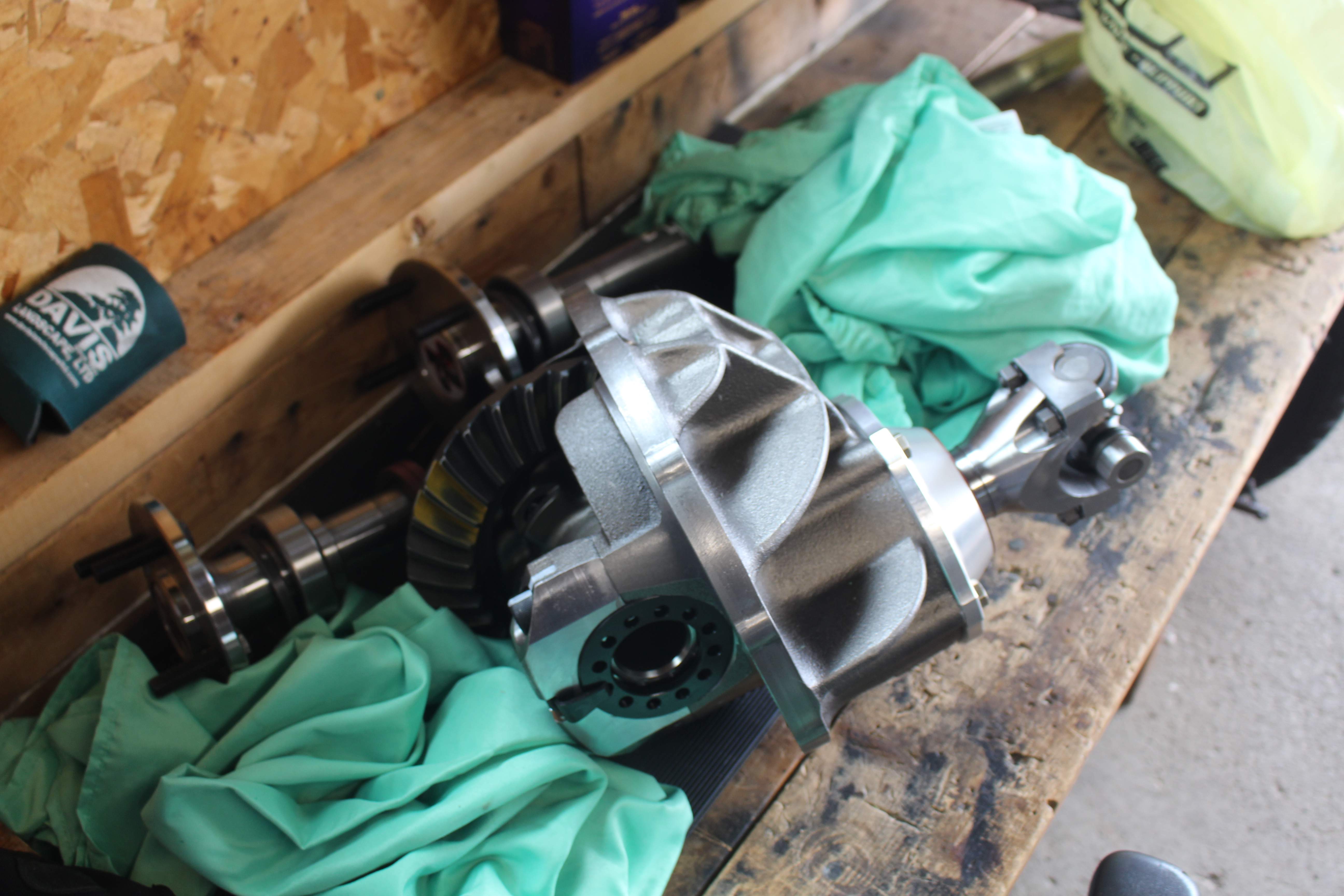

3.50 gear center section sits on the work bench, along with the 35-spline axles.

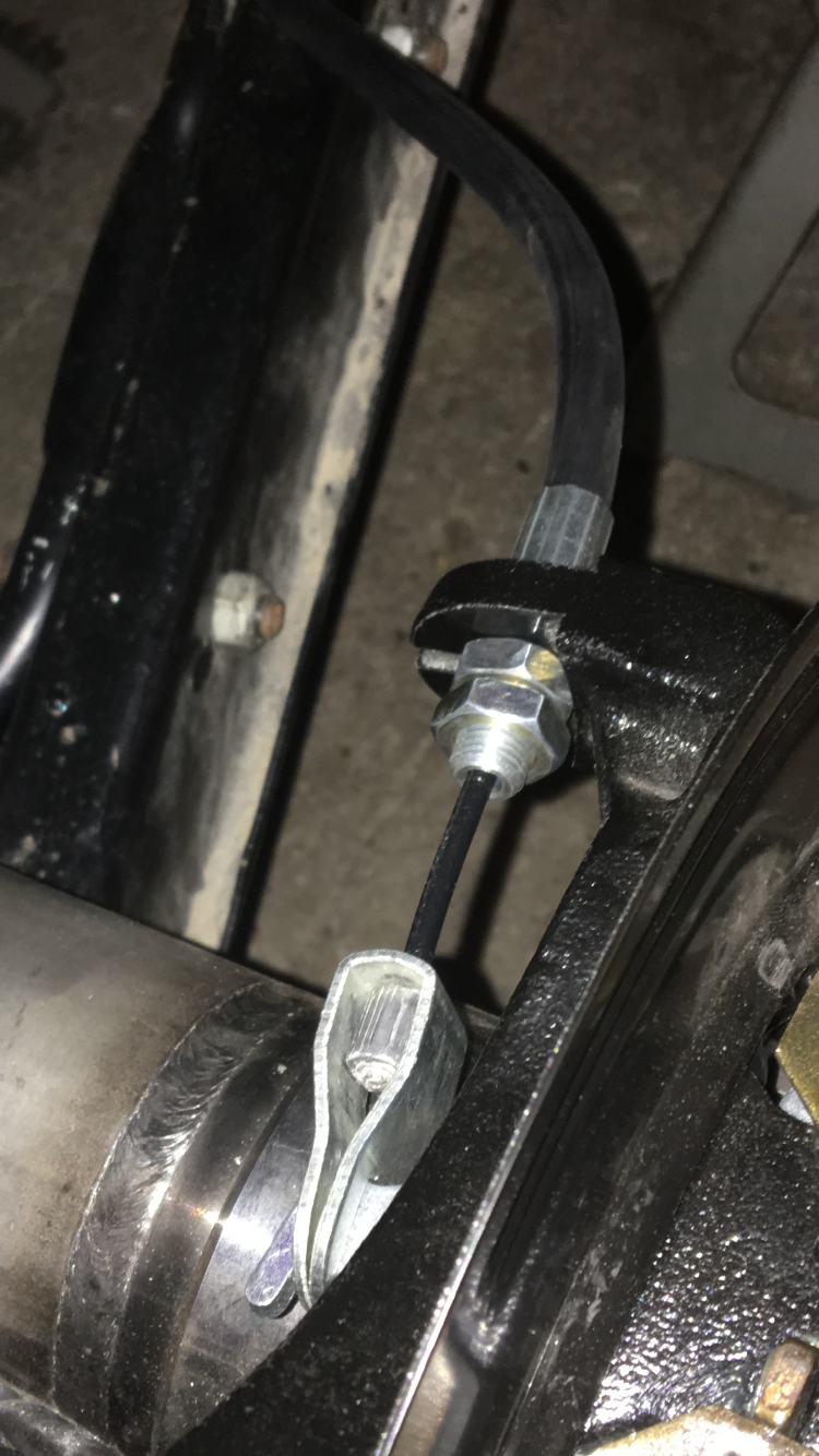

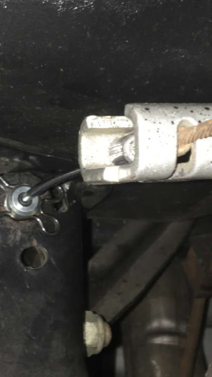

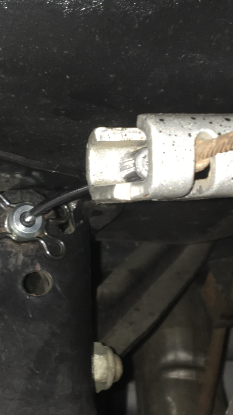

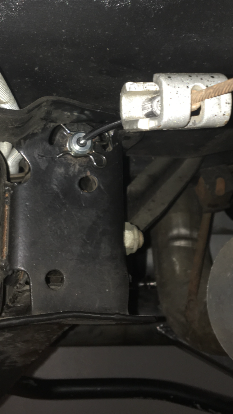

Joe's Tech Support Here with more pictures from Joe.....he went to Inline Tube yesterday and they could NOT help him. However, he found a shop nearby that could. It cost him $95 a cable but he now has functional emergency brake cables for his 9-inch.
Looks like the ones that I had to use from POL for the car and soon to be on the truck.

Well its all in.Painted, 3rd member installed sway bar hooked up brake lines yada yada yada..too tired to bug frosty for pics.should be done tomorrow. Key word should. 1 man shop this thing kicked my but today. Tomorrow axles installed i hope. we will see.G-night all. Indy Out!

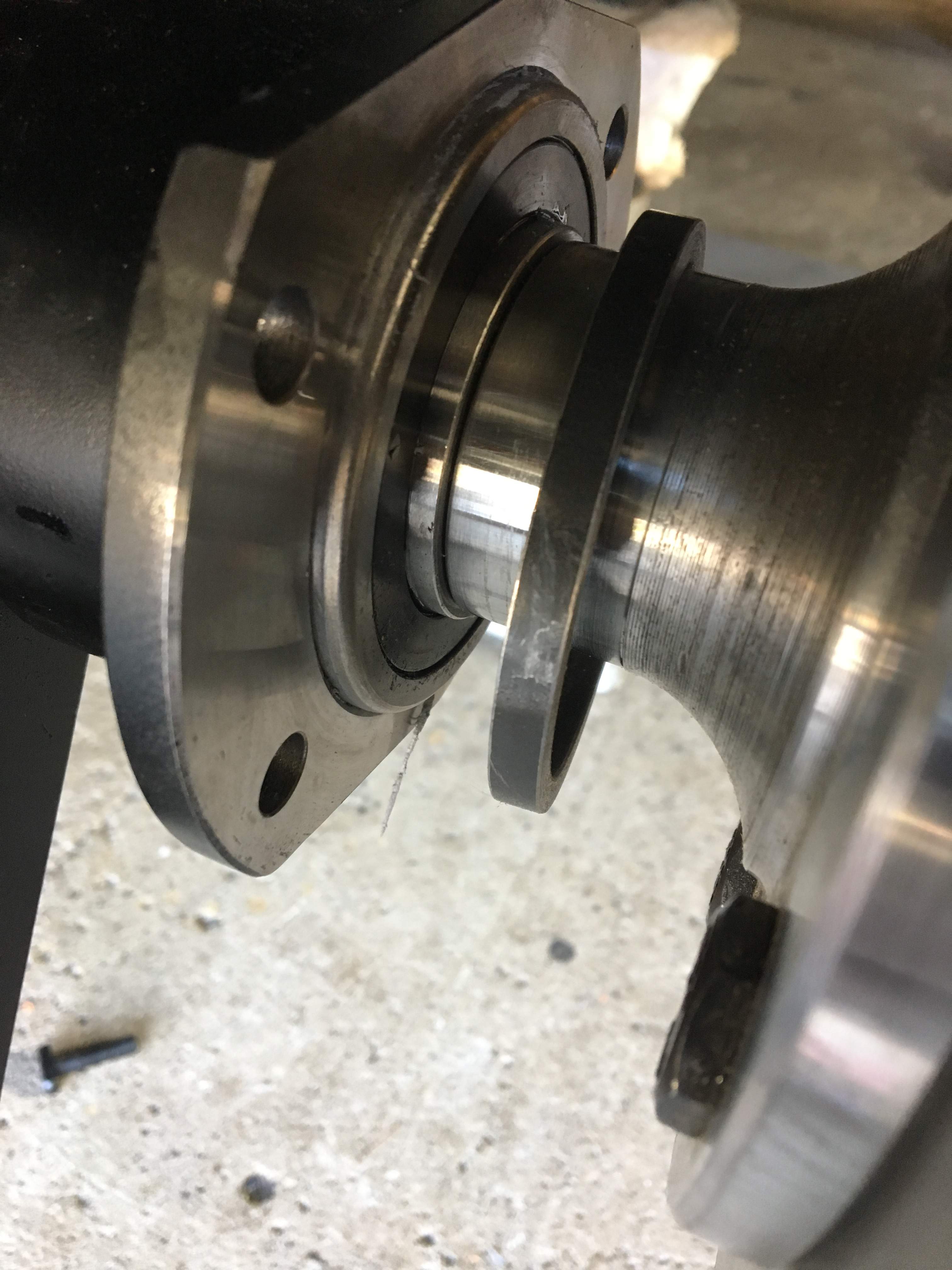

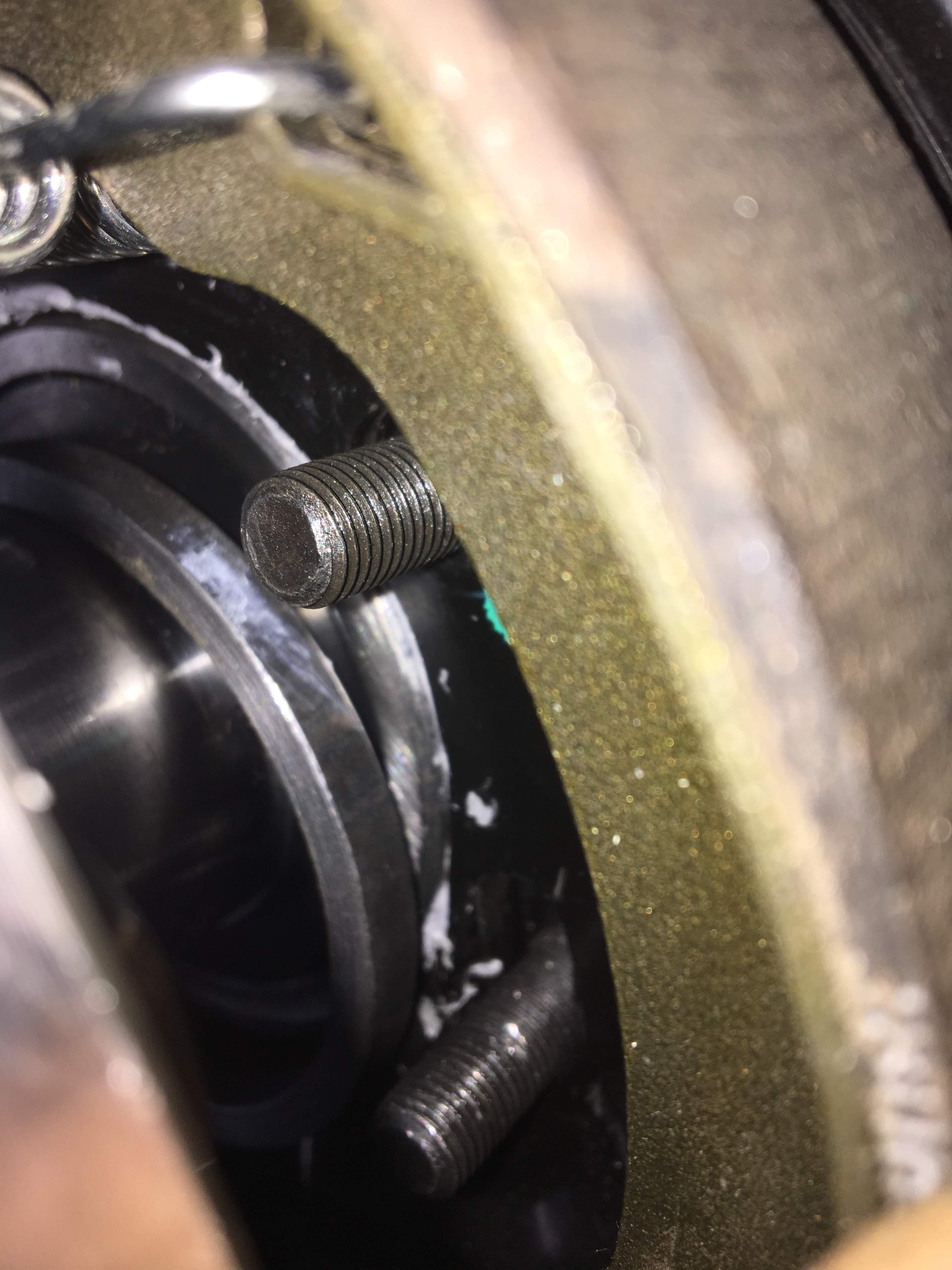

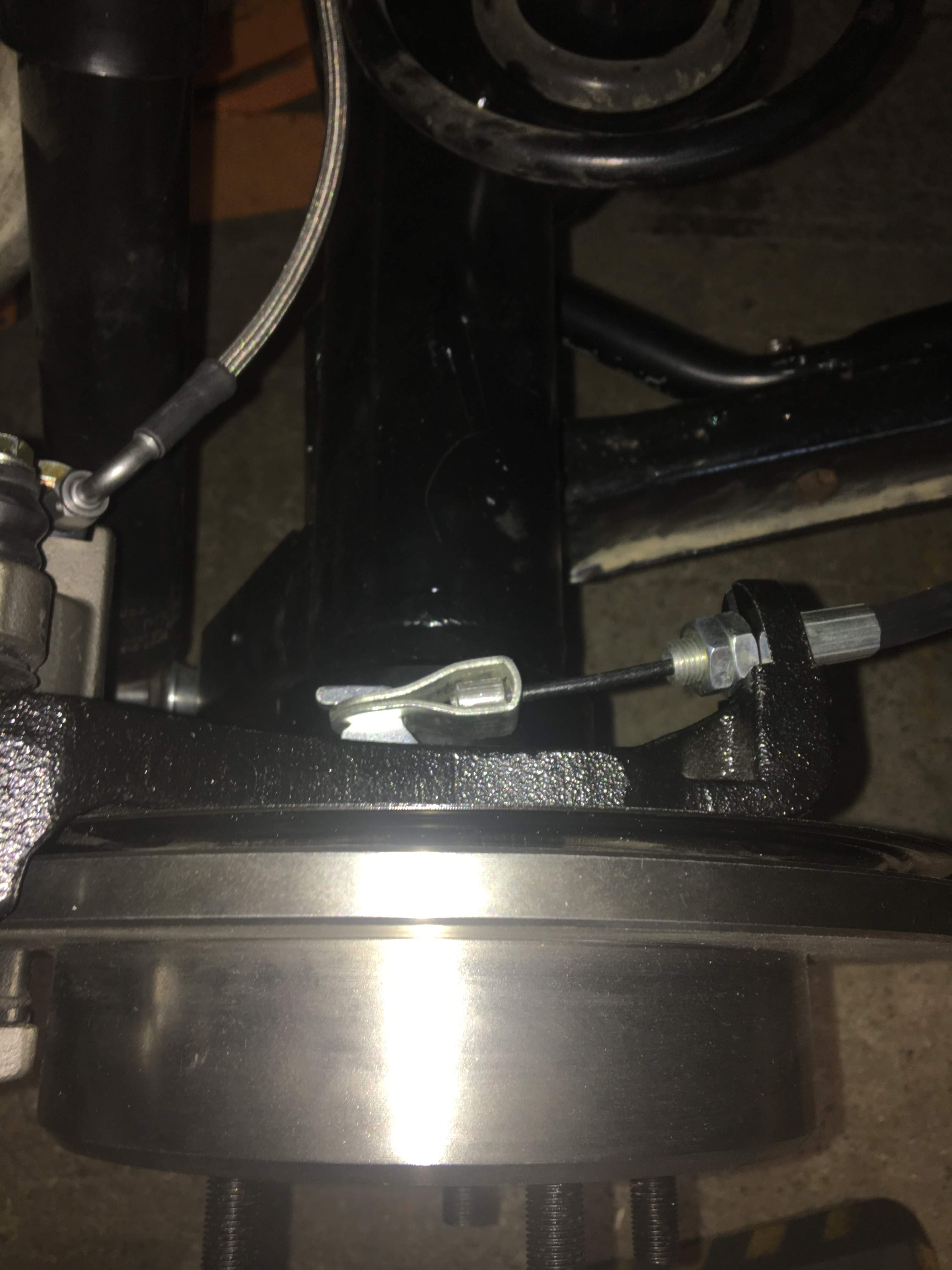

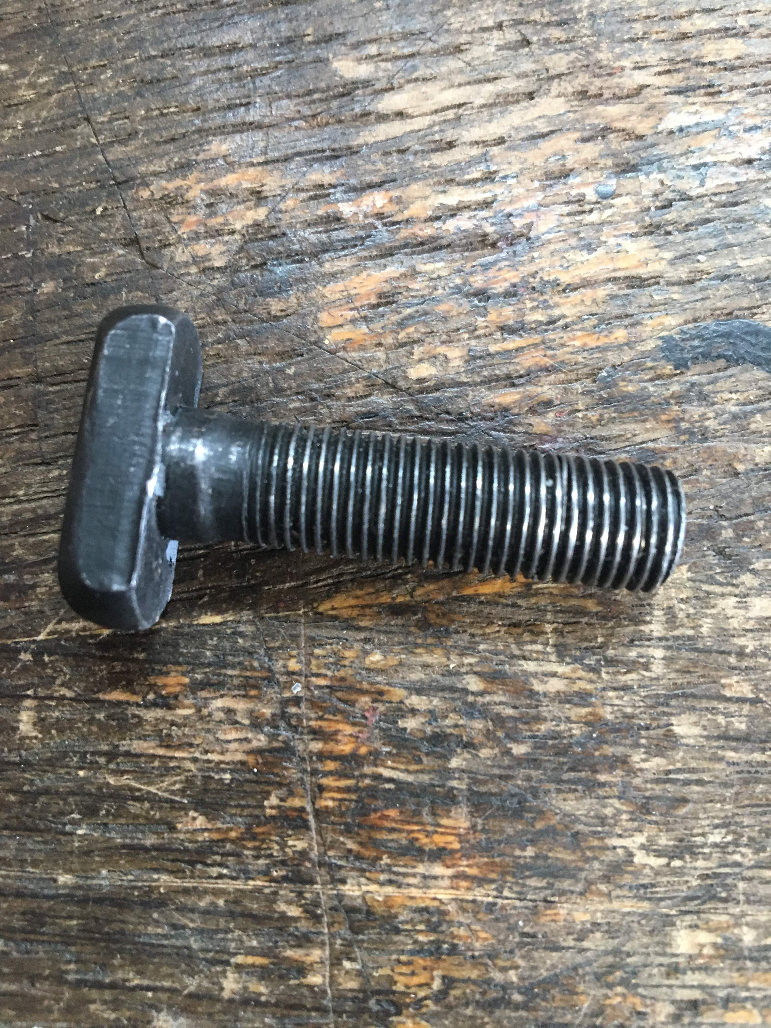

Got a text update from Joe last night. The axles are now in - it was an ID-10-T error.
Something about a small retainer that has to goes inside the new disc caliper brackets.....
I've been promised pictures.
Joe's Tech Support again: More photos of his Ford 9-inch rear end installation.
Dang retaining rings that made install the axles such a pain!
Painting the carrier.
Using the creeper made moving the rear end around a lot easier.
Stripped a couple of studs in the installation process.

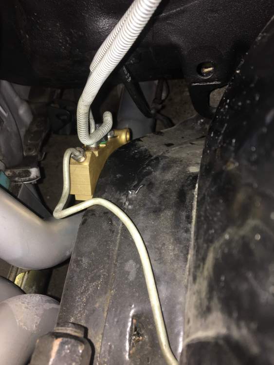

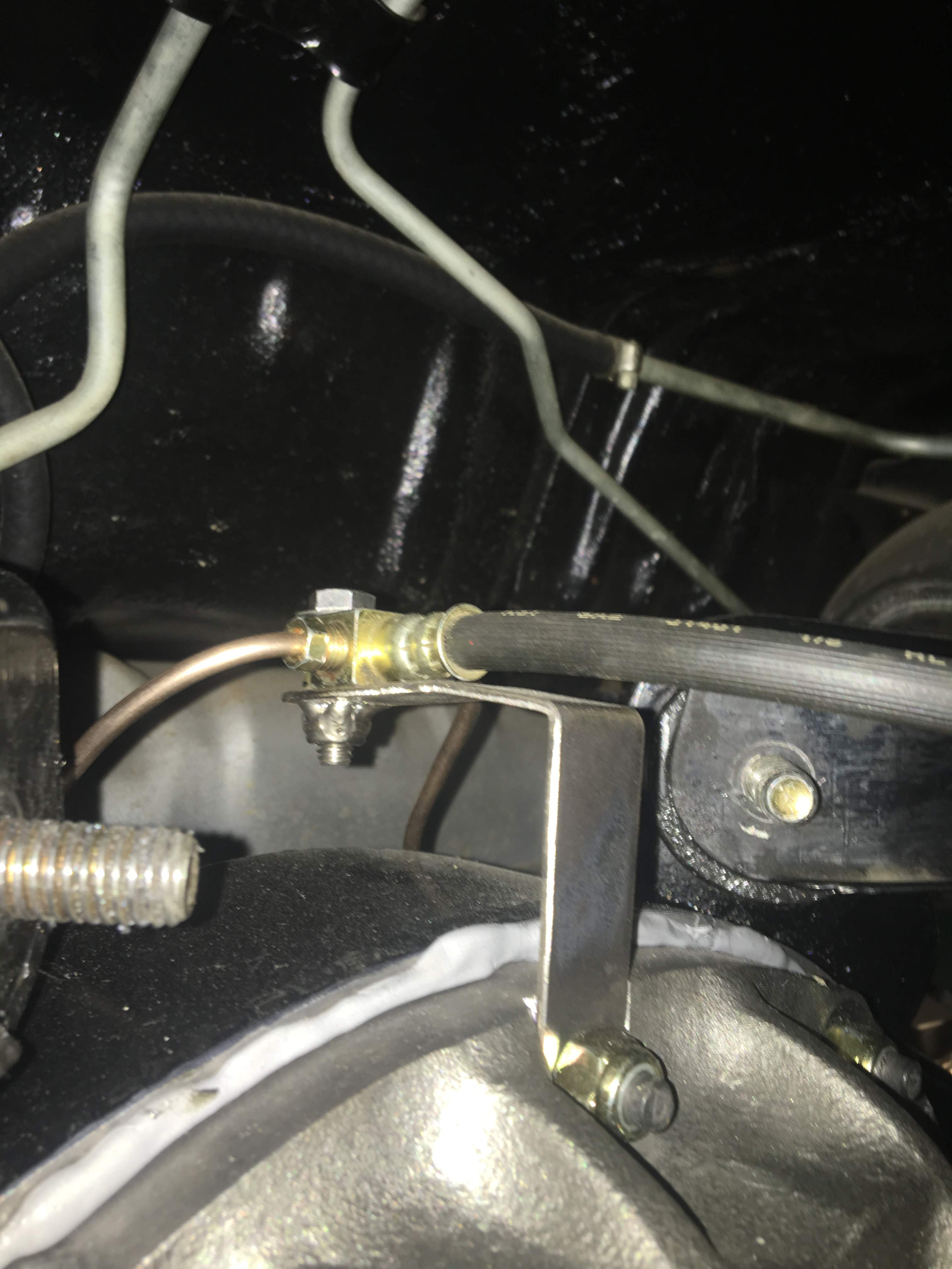

New prop valve from summit went in tonight. Brakes bled its all done! Fill it tomorrow with some stinky gear oil then tighten all the control arms now that its on the ground and i should be good to go. Well then its break in time but hell i'v waited this long soooo.
