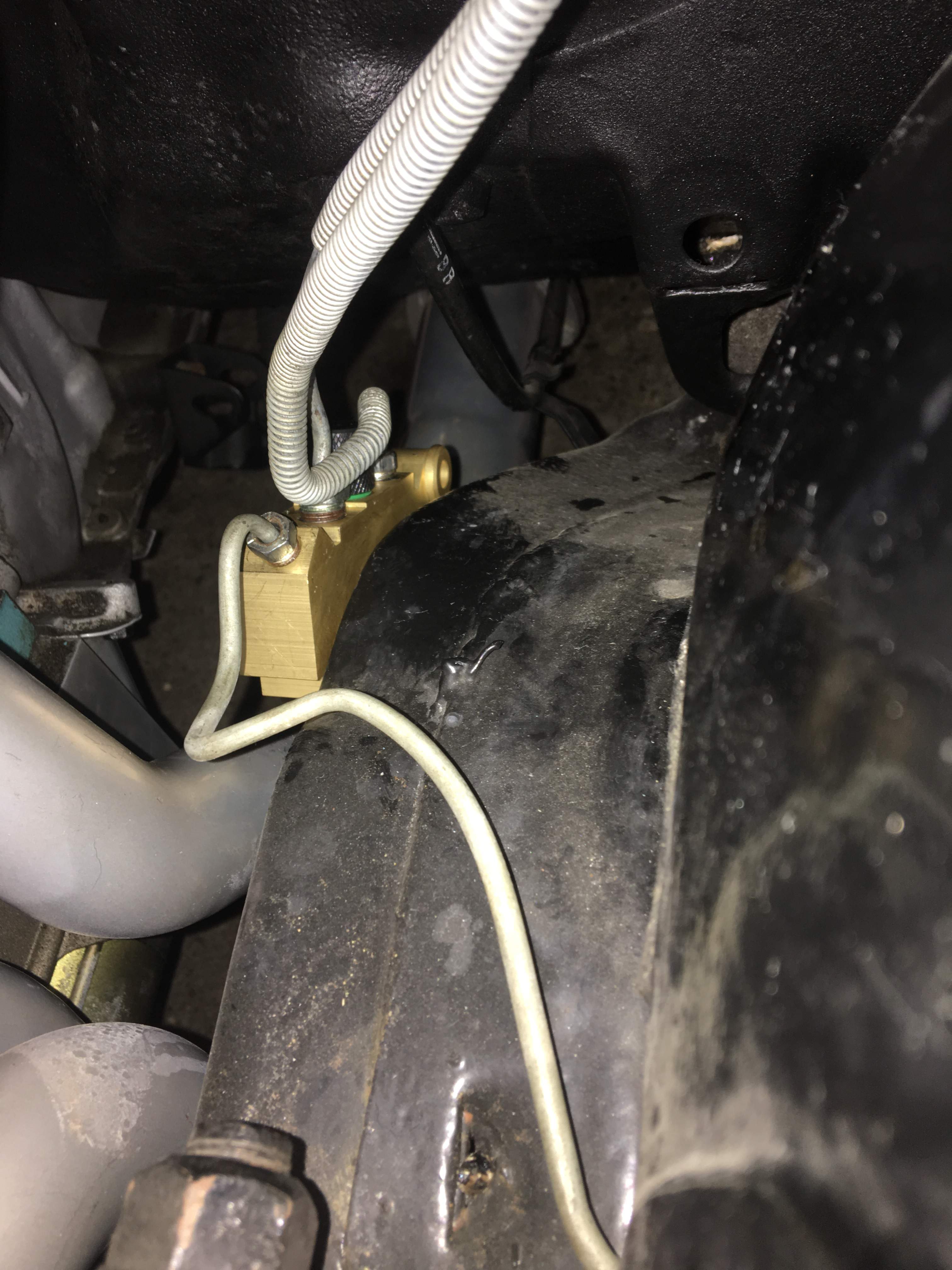

New prop valve from summit went in tonight. Brakes bled its all done! Fill it tomorrow with some stinky gear oil then tighten all the control arms now that its on the ground and i should be good to go. Well then its break in time but hell i'v waited this long soooo.
Joe's Tech Support here - picture of his new proportioning valve.
Something about a "mutha' to install or location.  :stars:

Yea that prop valve was a %&*@'er!
That pic makes it look like there was room LOL

Ok anyway, you may have them already and I just didn’t see, but a couple things. First, yah the prop valve looks close to the header tube, that would be a pain! You might want to see how hot the prop valve and lines get as a result of that proximity. It might affect fluid performance if it gets too hot.
Also, you say low vac motor, so I assume power brakes? if you don’t have one, you could get a vac canister. That will help. Also you could change the master cylinder to a larger bore unit. That will move more fluid which builds more psi quicker, but requires more leg effort. Additionally, even more work, you can change the pedal ratio, which gives you a bigger mechanical advantage over fluid movement.
