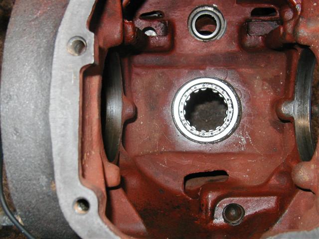

I know what bearing that is. My tractor has a similar one.
This is a look at the diff housing on a Farmall Cub from the rear. The top hole is the main shaft bearing and the bottom, bigger, hole is the counter-shaft which runs to the diff and PTO.
I bet that is the one that needs replacing, because that same shaft also powers the PTO and when I engage the PTO it makes a similar grinding noise even though the tractor is in neutral. But I bet its either the main or counter-shaft.
Those are both excellent places to examine. 60-year old needle bearings is excellent shape would be hard to imagine after all these years - not impossible, just improbable. Is there a bearing on the back end of the diff going to the PTO (that we cannot see in this picture) that might also need to be inspected?
