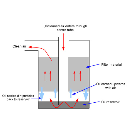

The air filter is another neat-o thing. Some of you may have heard of it: an oil bath air filter. The way they work is that in theory the air is forced to make an abrupt change of direction directly over the oil sitting in the bottom of the filter. Dirt and other particulates are heavier and don't change direction as fast and hit the oil and get trapped. There is no mesh or filter at the intake part... air goes down the slot below the lid toward the oil puddle, and momentum carries the bigger crap down into the oil where it gets stuck. Air then makes a U-turn upward and is drawn through a large mesh of woven material that is wet down and by oil being pulled up and then dripping back down, which catches anything the first part didn't.
