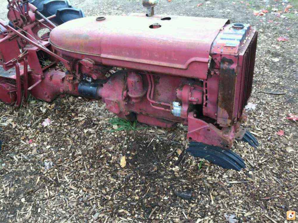

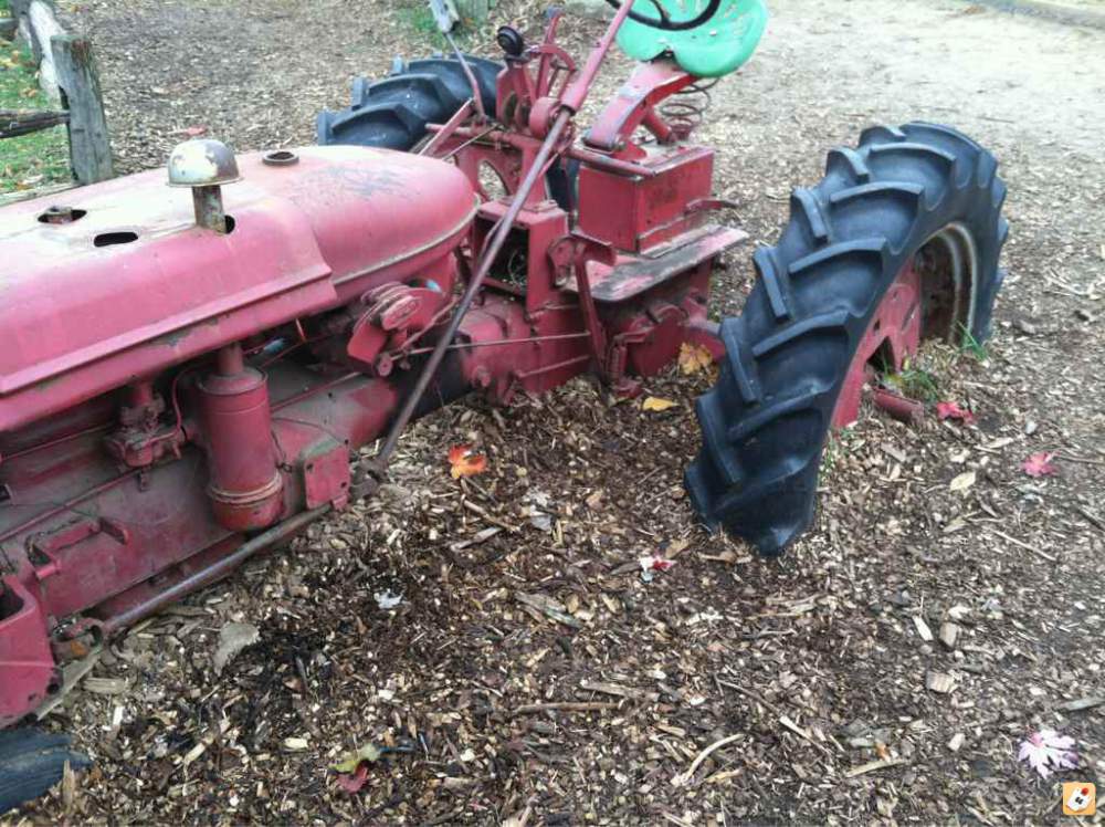

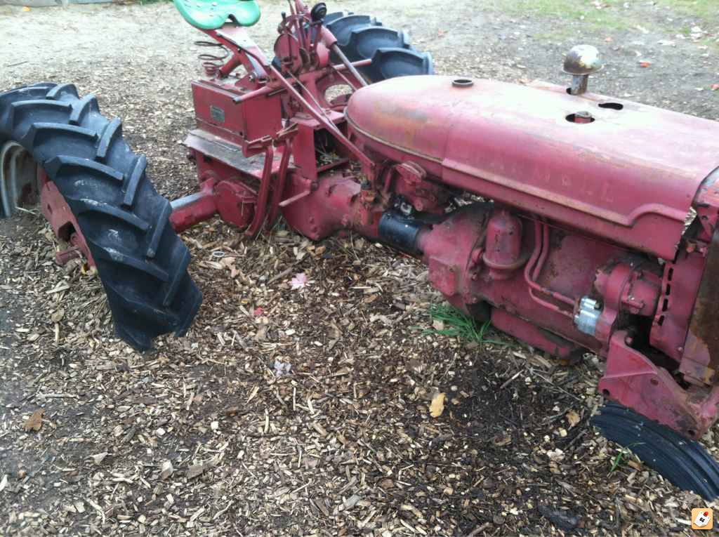

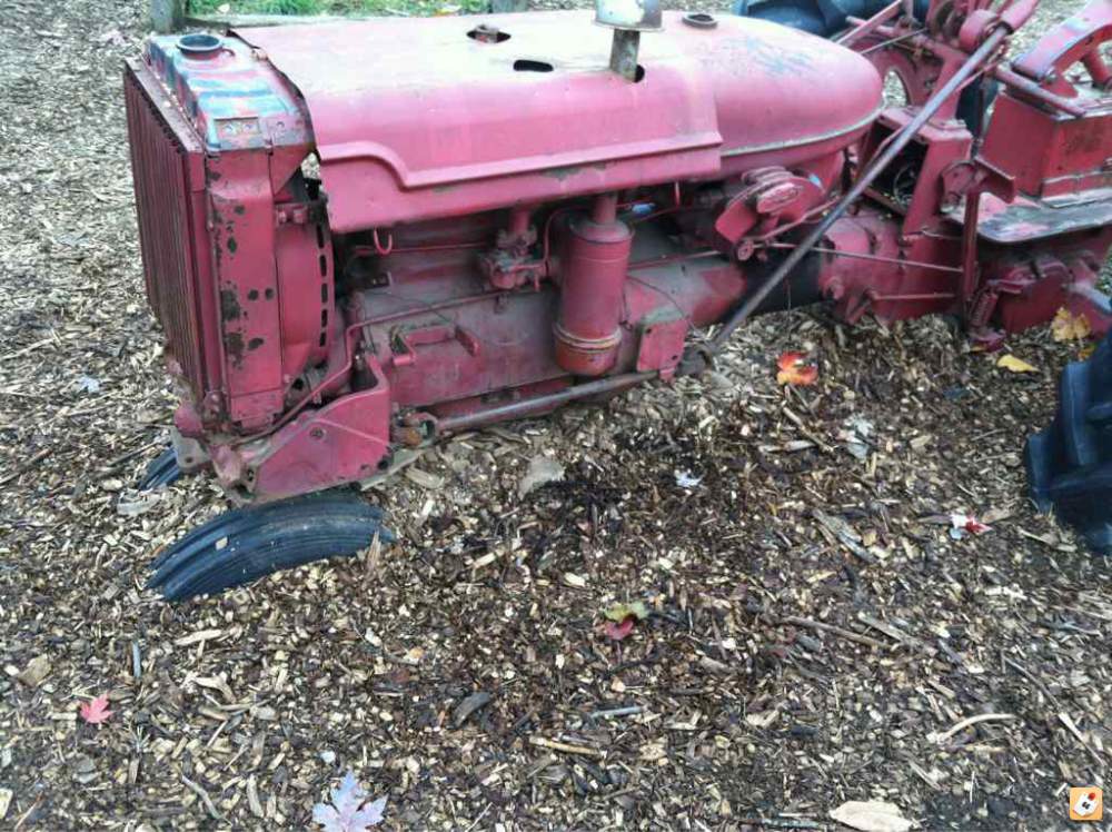

Found these while hunting
Posted ImagePosted ImagePosted ImagePosted Image
Pretty well sunk in the ground
The flywheel starter did turn once I released the brake though
Wow! Looks like an old Super C. Without the exhaust cover there is probably water in a cylinder or two. If I were you I'd see if there was a way to preserve it. Put a cap on it maybe. It looks like its in good condition, it'd be a shame to let it go to waste.
EDIT: Yep definitely a Super C. It has Touch Control hydraulics and I spot the disc brakes, a tell-tale Super C, H, and M feature.
Is this thing for sale? Ever thought of trying to restore an old tractor? Its much easier than a car lol
Now did you say the starter turned? How? I see no battery, or do you mean the flywheel itself moved? Is the engine seized up? If the engine isn't frozen then GET A DAMN COVER ON THAT EXHAUST! Frozen engines are a pain in the ass to loosen and sometimes you cannot at all. It really kills me to see such a beautiful machine just sitting there getting no love.
I have a feeling it was used as a parts tractor. Its missing all of the eletricals... Lights, generator, coil pack, and magneto. Grill is obviously gone too, along with the radiator cap, gas cap, exhaust cap, and oil cap. Still though, other than being stuck in the ground I cannot see why it can't be restored. Parts are easy to find and they are actually still available via independent companies AND CaseIH.
