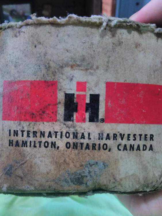

Box of Canadian Secrets
"Box"
Hamilton Ontario: home of Tim Horton's Field, and sister city to Flint, Michigan. Been there, done that, the kid pitched in the CANUSA games there last year (in 2015).
Please it's not a box from Canada....it's a Canuckistani coffer!
