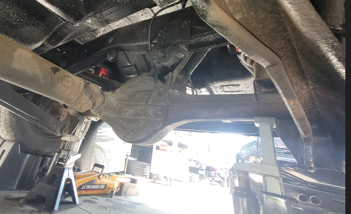

Hello Everyone,
I need to order new trailing arms for my 1963 Grand Prix... Mine are bent I think someone tried to use a jack to lift the rear on both sides and the metal is very thin... Do you guys know anyone that sells aftermarket trailing arms that are stronger?

from what I can see they are repairable . Save your money
get them straight and box them with a bit of plate steel
both my lower trailing arms on my 64 where damaged by a fork lifter I recon .. but I put them in the press and straightened them

Mine are very soft not sure if there are all like that or it is because they are rusty, the bushings are also very dry rotted and will need to be replaced... I rather replace with a tubular design, I will take a second look at it tomorrow.

Short of finding a true after market replacement, the suggestion earlier to remove them, straighten them, and then box them up is the correct answer. Boxing kits for stamped steel control arms have been around for awhile. You can also make your own if you have the fabrication skills to cut and weld your own steel.
