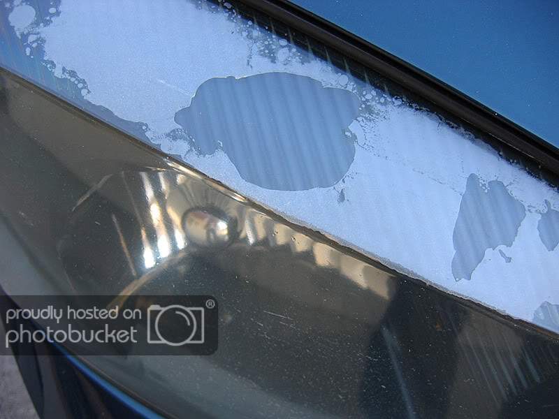

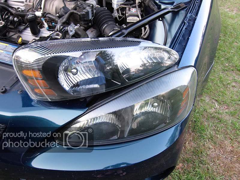

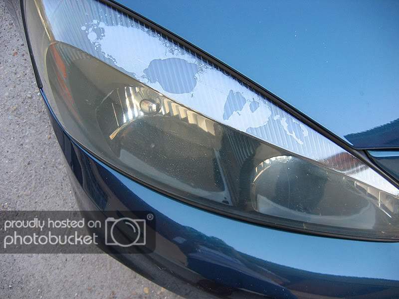

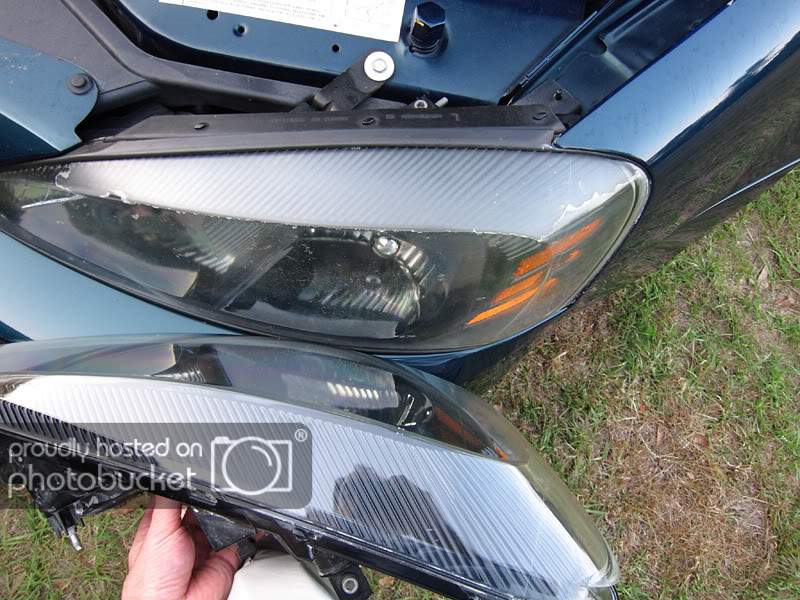

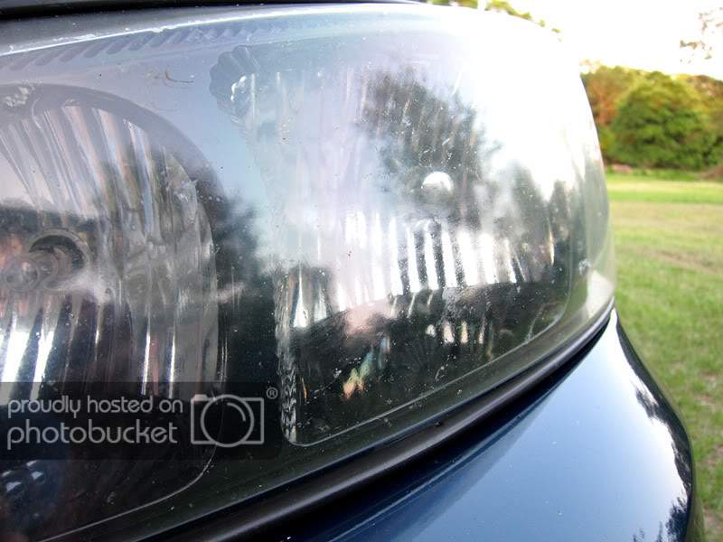

Here's my latest project I did this week.
Pictars
Driver Side
Passenger Side

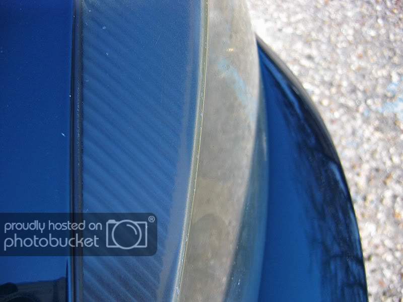

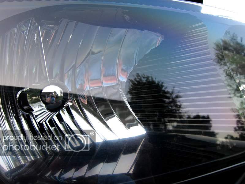

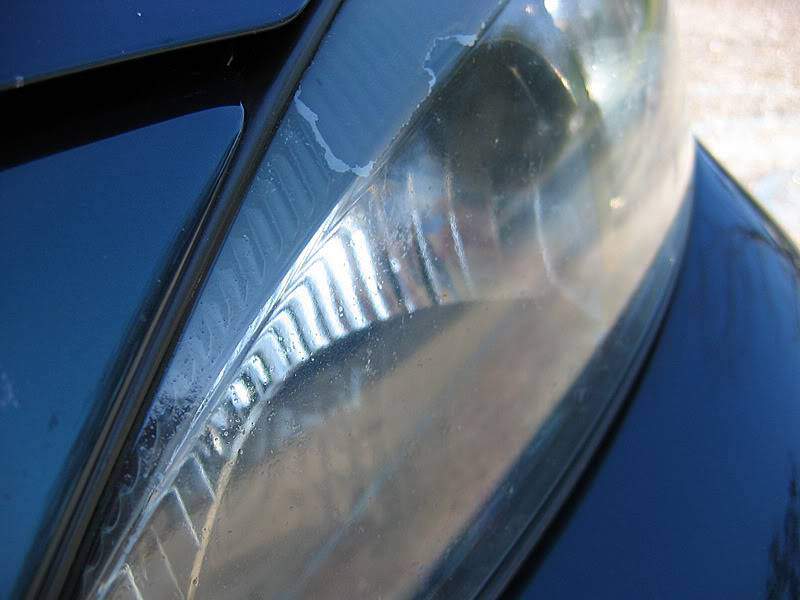

Process and Before/After sidebyside
I did 400, 800, 1000, 1500, and then 2000 grit wet sanding.
Then I used Prima Cut with a cutting pad. Then 3M Rubbing compound with a lighter pad. Then a coat of the urethane. I'm probably going to do a 2nd or 3rd coat once it dries 4 hours between each coat. Any suggestions on what grit to sand inbetween coats?
Results
Undone Light
Completed Light
Sorry about the solenoid, plans on rebuilding it?
Headlights look fantastic, great job!
it looks fantastic dude, i gotta clean my lights too, they are disgusting lol.
Looks great man ! I'd do 1500 grit in between coats. :P
