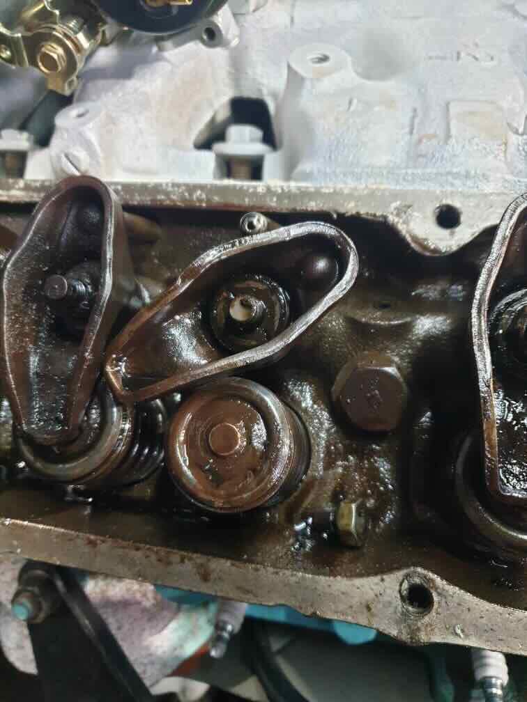

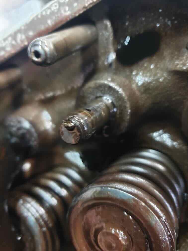

After many happy days of cruising around smoothly in the car, carefree, BAM!
My wife and I were cruising home after an early Cars and Coffee when suddenly the car begins missing again, just like before. Showing her lack of trust with my judgement on the fuel gauge (fair I suppose, we did run out of fuel once early on😆 ), we pulled into the closest servo to top up. Nope, didn't solve it (I knew it wouldn't🙄).
Naturally I suspected the distributor again, as it was exactly the same as the last one that had proven to be at issue (plus NOTHING else had changed).
We drove home, and after checking to see all was well with everything else (leads, plugs, timing, carb settings, battery, etc), I decided to fit the distributor I had rebuilt (will describe what was done to this later on, once car is running well again and I can verify how much better it actually is), plus the plugs the guy recommended and reset the timing as advised. Quite confident that all would be well upon start up I happily cranked away to find that NO, it was still the same. That is to say, missing like a bastard, presumably on one cylinder.
To shorten the story it turns out that it had snapped a rocker post on #4 cylinder, thus the miss🤷‍♂️
I will start another string to continue this saga, as now I need to ask everyone for some advice - please follow along...

What method did you use to set the valve lash when the engine was reassembled...??
Screw in studs can be a good upgrade...And should work with your existing valve train...Just be sure to use new hardware..lock nuts...Etc.
Roller Rockers can be hard to maintain a consistent valve lash adjustment on engines with hydraulic lifters...And they probably won't Fit under the stock valve covers...And I personally (I'm sure others will disagree) don't see any real advantage to using them with your engine combination... Unless you're planning to spin the engine at High RPMS for extended periods of time...
Something else I think may be worth mentioning..
Did you reuse the old Damper/balancer...When the engine was redone...??  If so you need to be aware that the outer ring on old high mileage dampers tend to slip around the inner hub and will render the timing mark completely inaccurate...

Hey @TWO LANE BLACK TOP, thanks for your response.
I should have said that the engine was rebuilt by a professional who, while not having heaps of experience with Pontiac engines specifically, does have a lot of experience with stock, street and race engines. And I've known him for a good few years so have had a lot of conversations with him prior to engaging him. And he spent a lot of time researching and speaking to Butler to arrive at the combination we have. The machinist also is a very "old school" (also older😀) guy with years of experience, who specialises in "old" engines.
So at least (I hope) I had the best chance at getting a decent outcome. It was too big a job (and with too much money involved!) for me to want to try and attempt it on my own.
And can I say, I've been very happy with the build (barring the electrical issues we've had to sort) up until this failure.
The lash was done at rebuild, again at 1000km, and twice since while chasing the original "miss", that turned out to be electrical. Also prior to the failure, the engine had 150psi compression on all cylinders dry, and 165psi wet.
I like what you say about not using the roller set up - it seems to depend upon who you speak to about that. As usual, there are those that say it's the "only" or "best" way - I just don't think those people are listening when I say the car was intended (and is used) primarily as a street cruiser. Sure I get up it from time to time, but it never gets over revved or "dragged". If what I end up going provides me with a few extra horses great, but I'm not chasing more power necessarily. Reliability, longevity and simplicity are key for me.
And the entire focus for me has been trying to maintain the originality of the car, at least in appearance. So if I can maintain the original valve covers, so much the better.
Thanks again 🙏
Certainly sounds like you should go back to your mate and get him to replace all those studs 👍

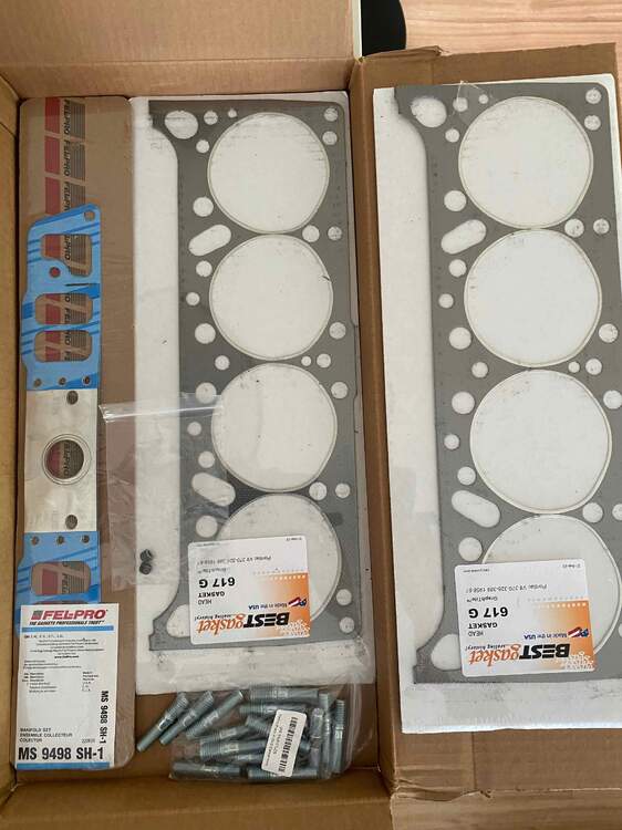

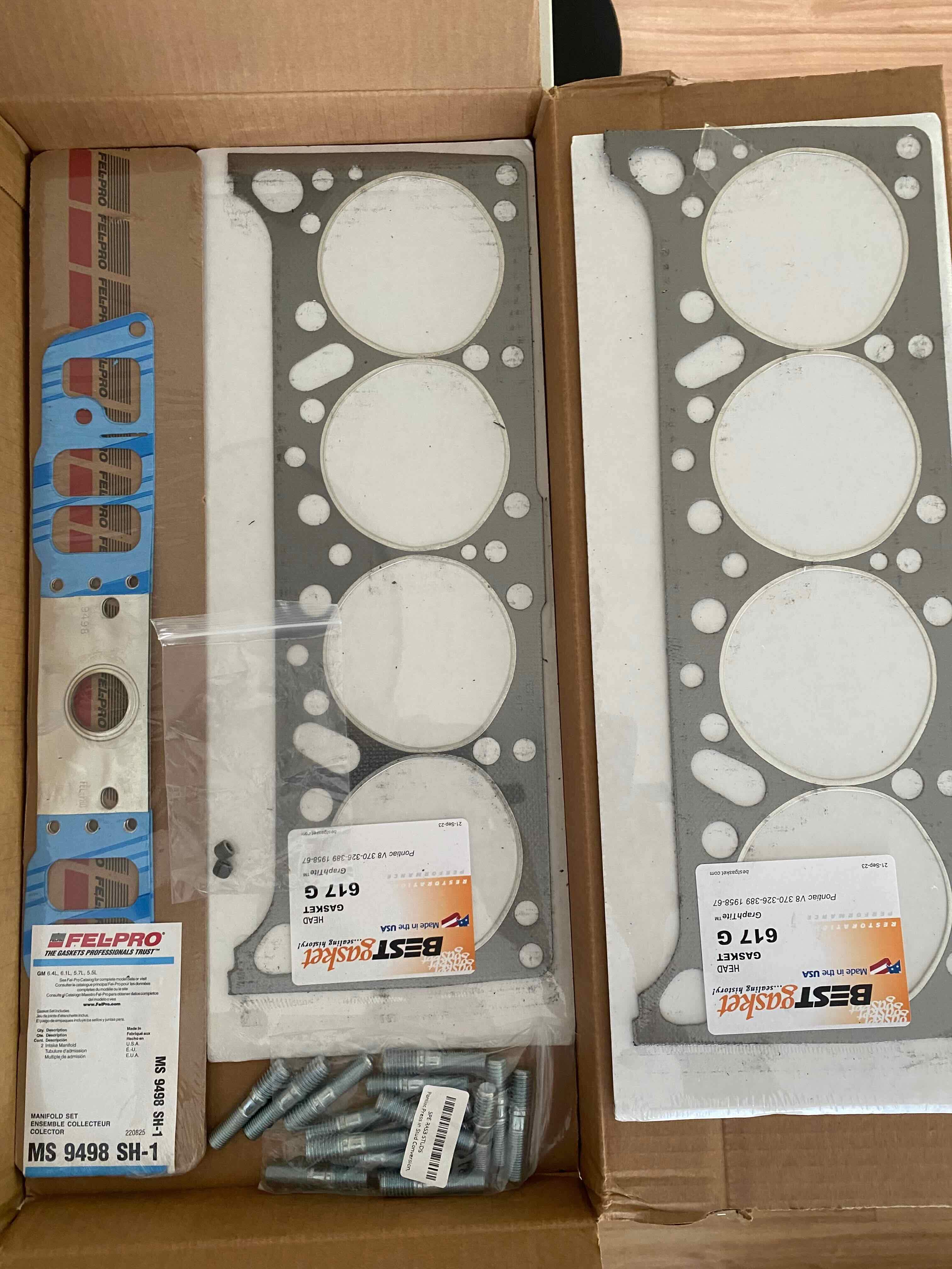

I've changed mechanic (long story), and have a Pontiac Screw in Stud Conversion Kit, gaskets and a Melling 1.5 Rocker Arm kit heading my way from Butler.
Obviously (and expensively🙄) the heads will need to come off to facilitate some machining.
Hopefully with the current wait on machinists time atm, I'll be driving again within the foreseeable future. Not sure if the car will make Cooly this year though, which will be frustrating.
At least when it comes back to me, all should be well🙏

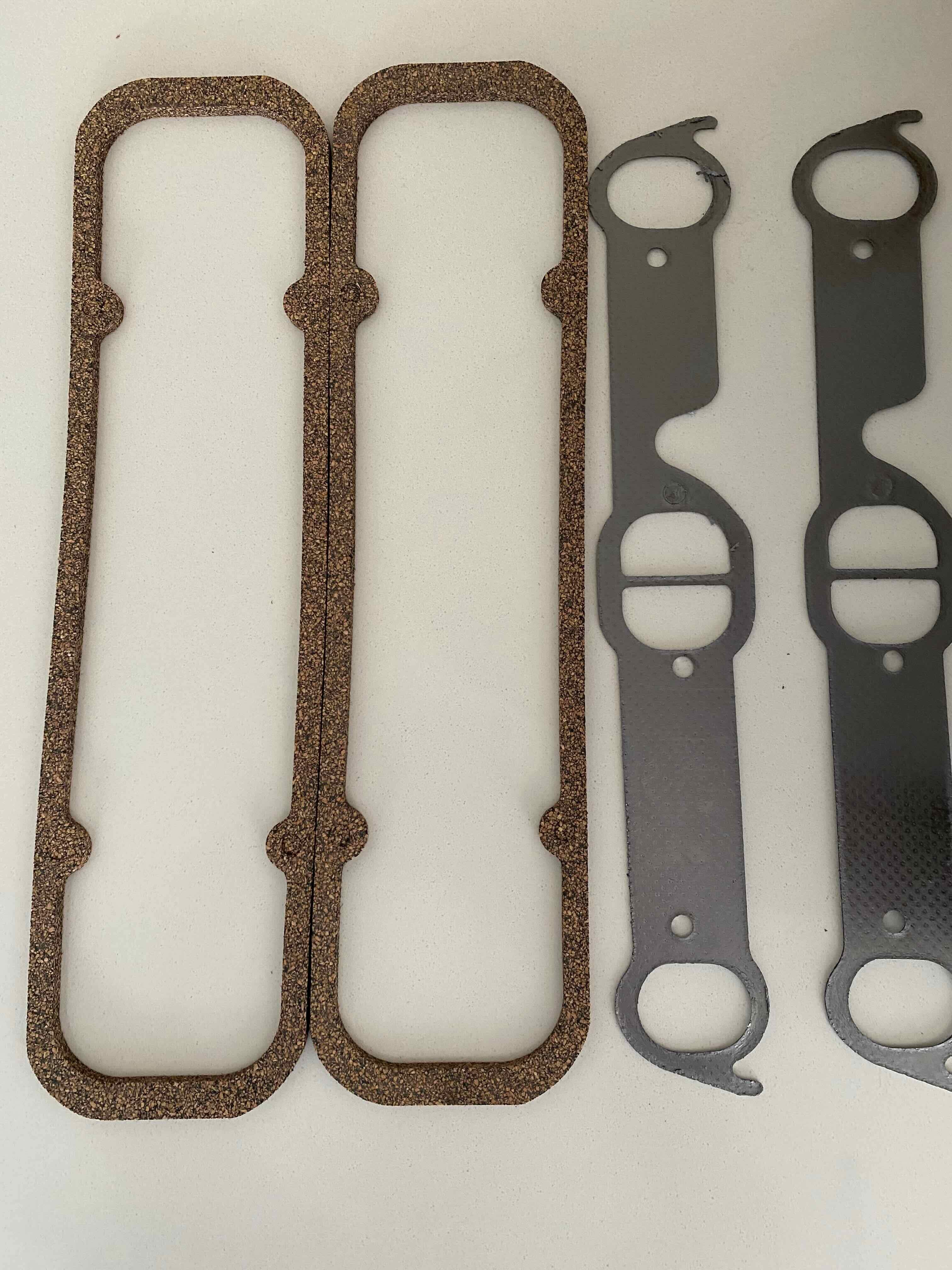

Good news - less than 8 days after order placed event, my first lot of Butler gear has arrived (screw in studs, gaskets, etc).
The mechanic already has it  (plus a copy of all the information on the new parts and original rebuild that he may need), so the only thing to slow the process now will be the machining (both the wait and the time to do the work).
All going well my rockers will arrive next week - so everything needed to get it back together again will be sorted.
Who-hoo - fingers crossed Cooly may yet still be on the cards 🤞
