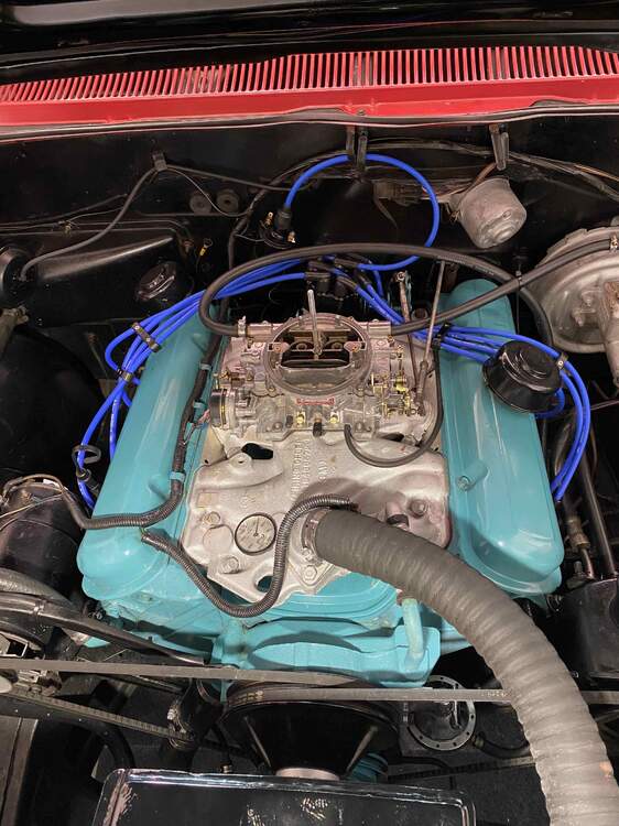

Hey all,
This is a bit long-winded, but the issue is becoming increasingly annoying so I'm putting it out there to see if anyone may have a possible solution. I'll list all relevant details below...
Car has been running really well, but lifters were a bit noisy so checked into my mechanic for an adjustment. Motor has done @ 6,500km's since rebuild. At the same time it had a new set of plugs installed, & a tune up. Mechanic drove it just prior to me picking it up, & said it was going well.
On the way home, it seemed to be missing a little but I put it down to the heat & wasn't too concerned at that stage.
Next morning, it was a bit rough at cold idle & was definitely missing on immediate throttle opening, and at slow cruise speed. Hard acceleration it seemed all good. Car ran pretty poorly, so I stopped in to fill the tank (took 80l, so wasn't empty enough to have dragged any shit into the system). Seems a little better after that, but not much.
Anyhoo...60' 389 rebuilt to 400 (all the details & specs I have but don't think will help here?).
New distributor, fuel sender, fuel pump, carb. Plugs have been checked & cleaned, lifters have been re-adjusted, carb has been stripped, checked & cleaned and retuned, so dirt in there isn't the problem. To be honest, the car ran exactly the same after this was done! Coil & leads have been been replaced since also, to no avail (although the new leads look good😃).
As stated, missing occurs just on throttle opening, & slow cruise (idle/primary circuit)? Will pull easily to 80mph & beyond with no problem, if you boot it.
Thanxx 🤷‍♂️
