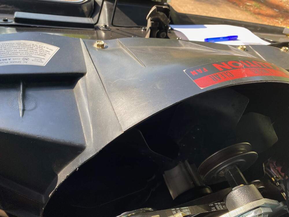

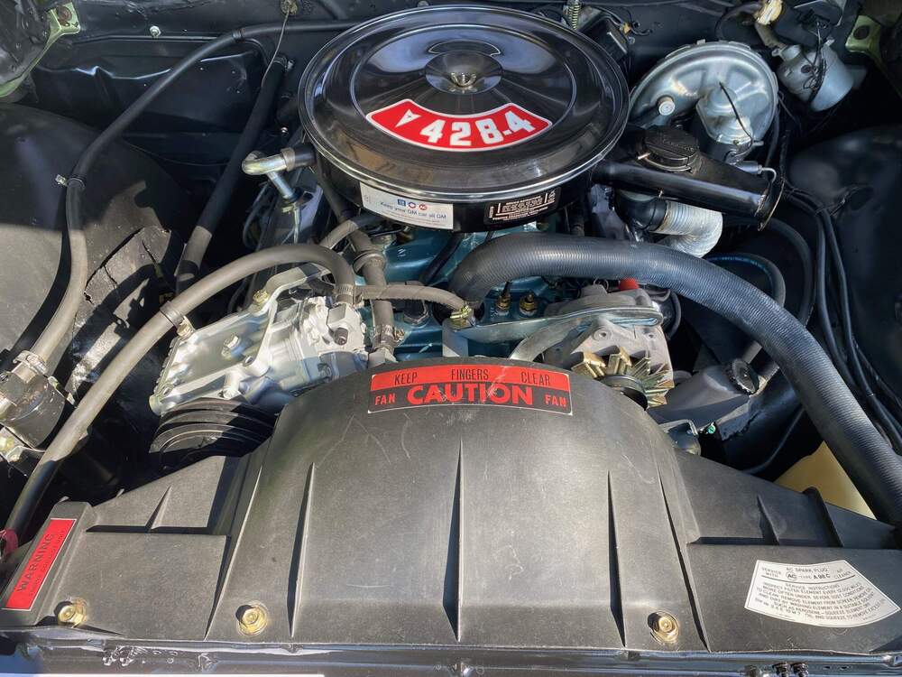

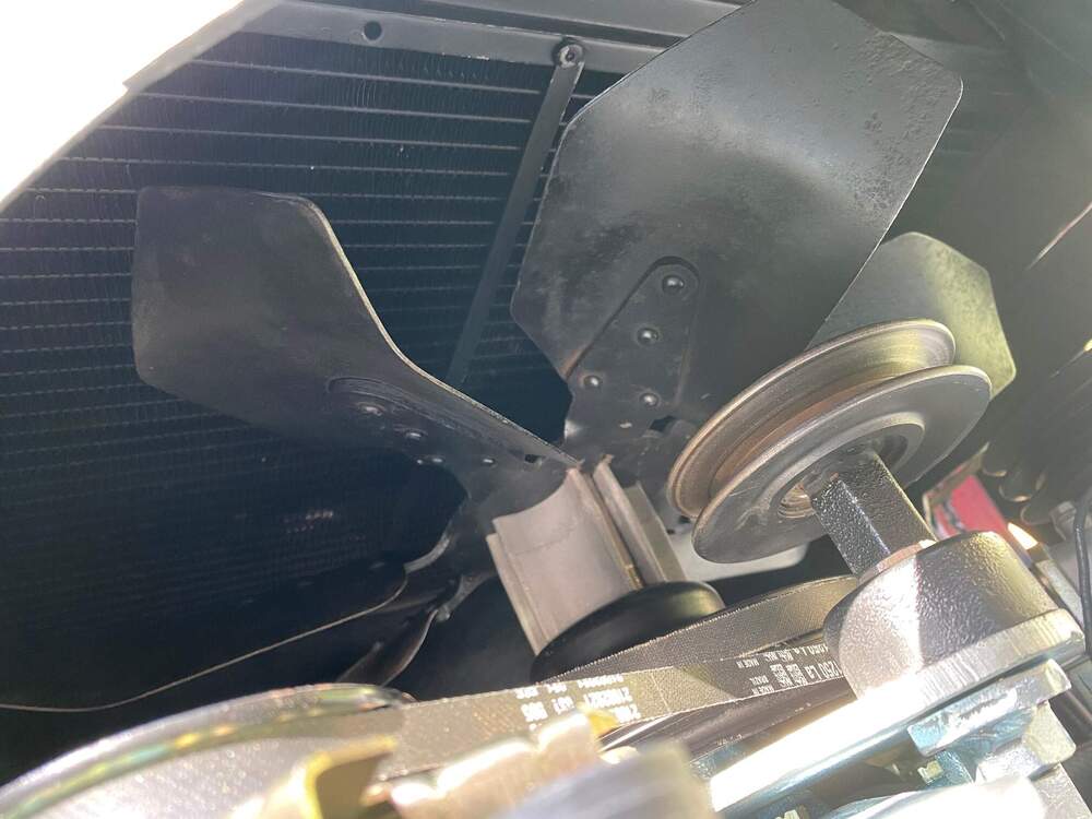

is it justA me , or does that fan look little in that shroud ?
Fabio, how much room is there from the end of the blades to the shroud ? that will cvertainly be loosing flow through the radiator at low speed.

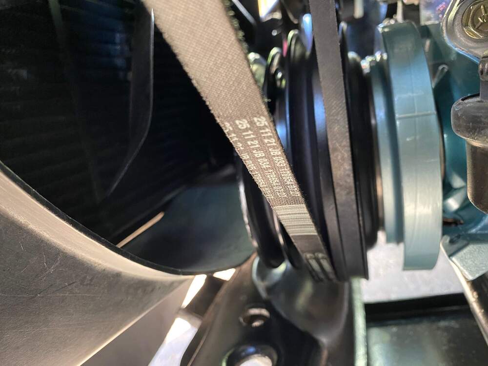

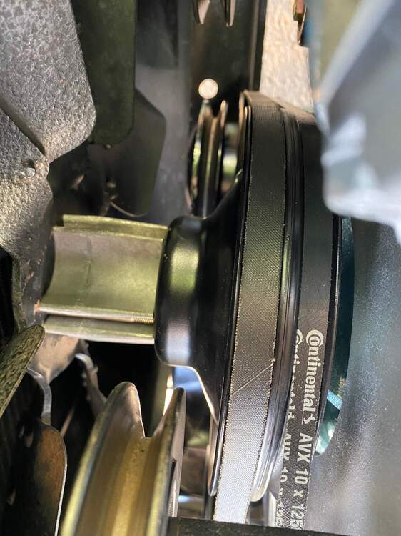

Fabio, the pulley should be the stock 6” not 8” that slower speed could easily cause a lack of cooling at lower speeds. The shroud & fan blades are wrong, as Kiwi indicated. There needs to be only about a 1/4 “ to 1/2 “ gap between the blade tips & the shroud edge. Also, the Mopar fan might work in Dodges setup, but it’s no good for yours. You need a straight blade fan to one with bent tips. See attached photo.
I don’t think you have blockage because it cools at higher speeds when you are move air through the radiator. I think, the fan issue, the shroud to fan issue & the  pulley size, are all combining to cause the problem.
No it’s not you!
and that was the clue!! fabio.... you said the engine temp runs good at highway speeds... sooo.
its air flow. not anything else .
last indian is thinking like i am, mechanical air flow through a radiator with a fan needs a shroud that is as close as you can get, blade to the tunnel relationship so to speak  , not only to the radiator but the the shroud ... air will be flying off the ends of each of those blades and loose effective flow big time !.. this is for slow speed running ,,, and if its not flowing .... the temp goes up ! super easy if you thing about air flow ...:cheers:

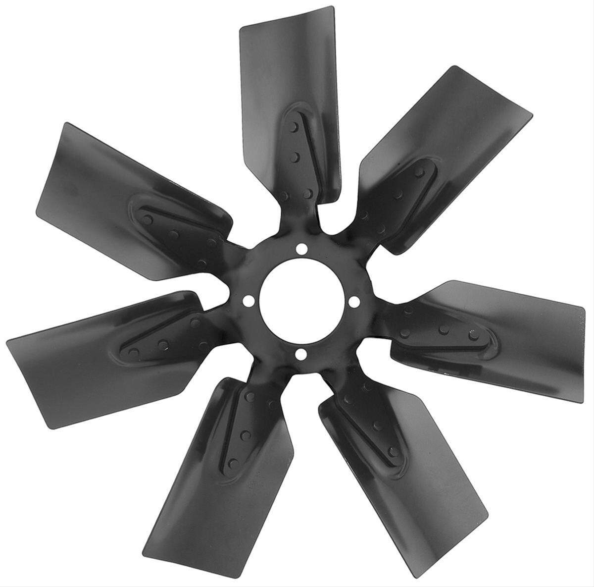

Ok, one step at a time. First change the pulley to the 6” & see what change that makes. If it is enough you could stop there, although if it were mine I would put the GM 18” fan blade with the clutch in as that type design does a better job of pulling air when needed, but decouples when not needed.
