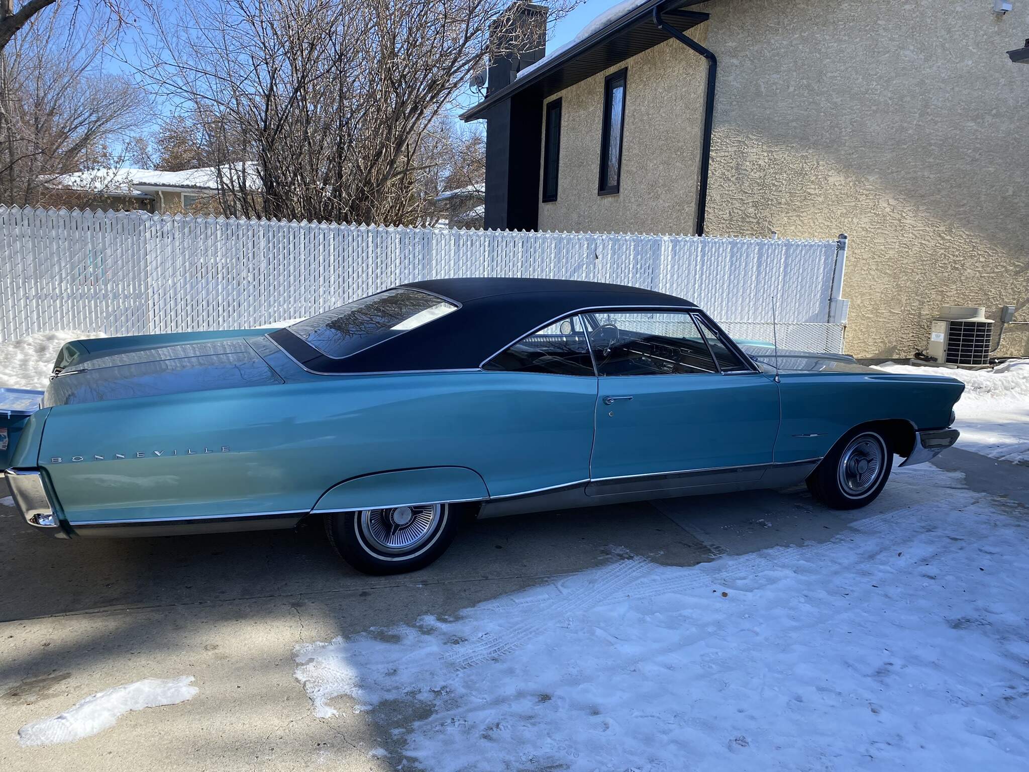

What do you have the engine in?  We like pic's.

Thanks for the input folks. I am gonna wait for Jack Frost to take a hike and then get busy. No heat in my shop right now. Pic for justa6. 65 Bonny.
Well, the pic may be for Justa, but you can't stop the rest of us from enjoying it to! :rofl: Awesome Bonneville bro. :cheers:
That's hot enough to melt the snow in your driveway!  Thankz for sharing your pic.  Keep us up on what your doing with your ride and chat it up in the forum.
Ha ok glad u like, couple more pics in my intro post as well cheers.
