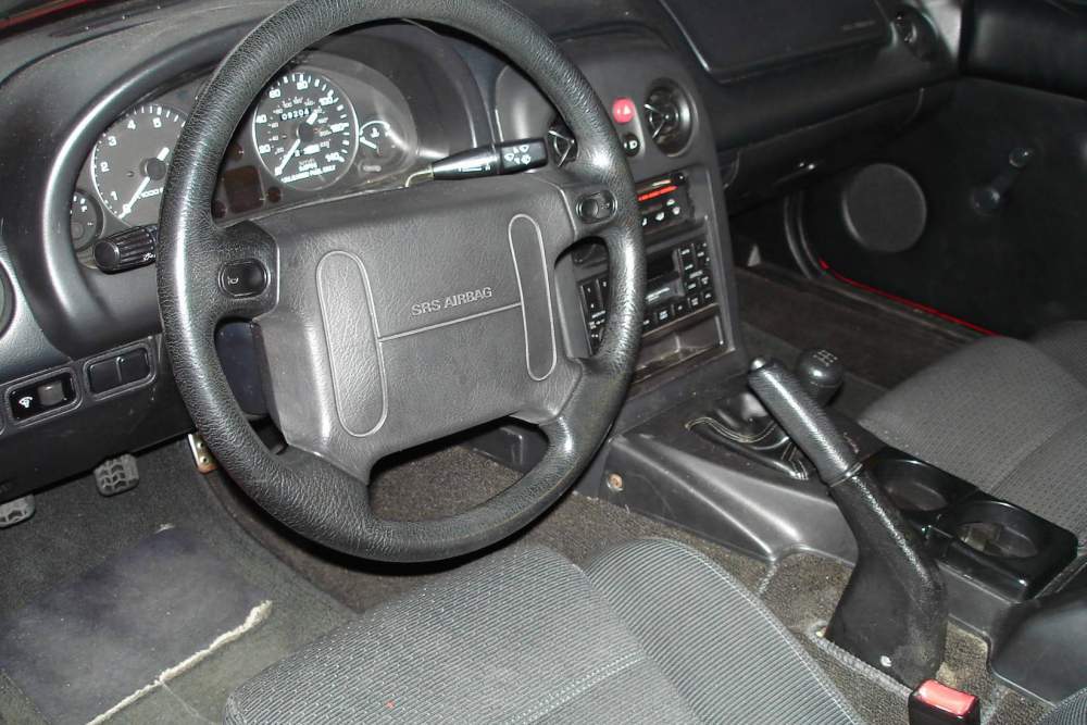

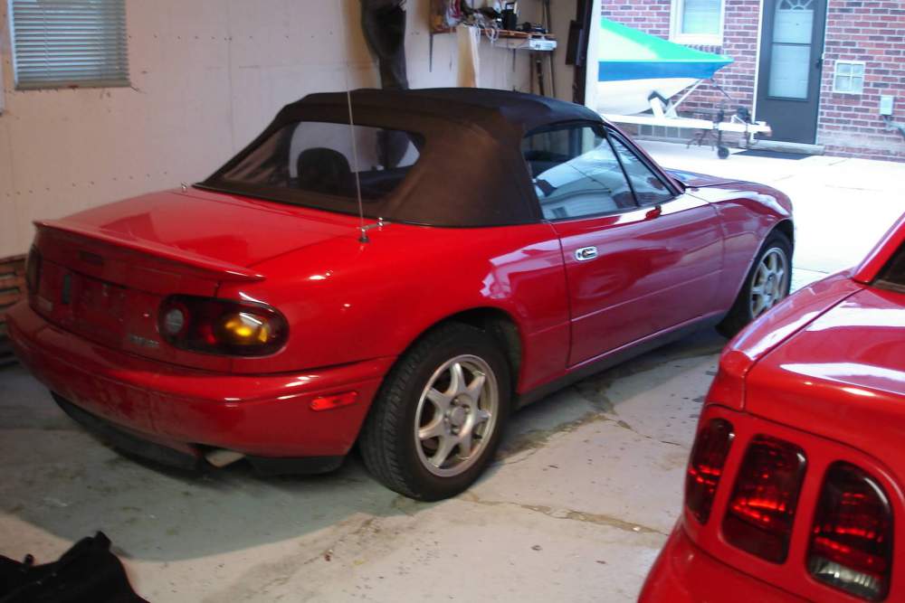

I have spent about 30 minutes total in and or around my new car.
There are some things wrong with it.
Leaking coolant, i am 90% sure from the water pump. :angry: (he told me "the guy at the shop said it was a hose or something") pfft
There was water on the inside of the trunk lid but not on the bottom. :dancingpontiac: (i'm sure it's nothing)
I thought these things had power steering? :dancingpontiac: Maybe i am just used to driving the GA where i can spin the wheel with one finger.
Haven't figured out how to get the top down. :dancingpontiac:
Front bumper is faded. :huh:
Oh, the mirrors are off and look to have no way of going back on. :lol2:
But i guess if it was perfect than it wouldn't be a project car. :lol2:

He said New timing belt, water pump, battery and wires just done a few hundred miles ago. Clutch and all that feels great. He said the car was owned by a little ol lady before him, he drove it for like 2 months.

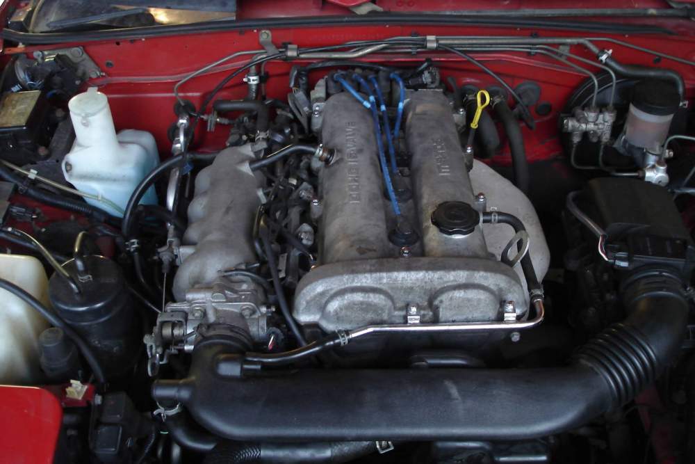

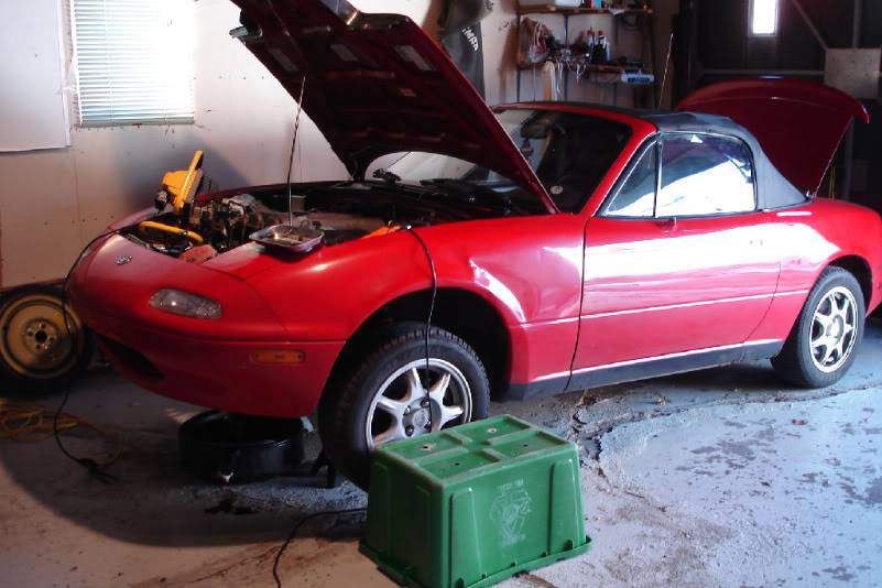

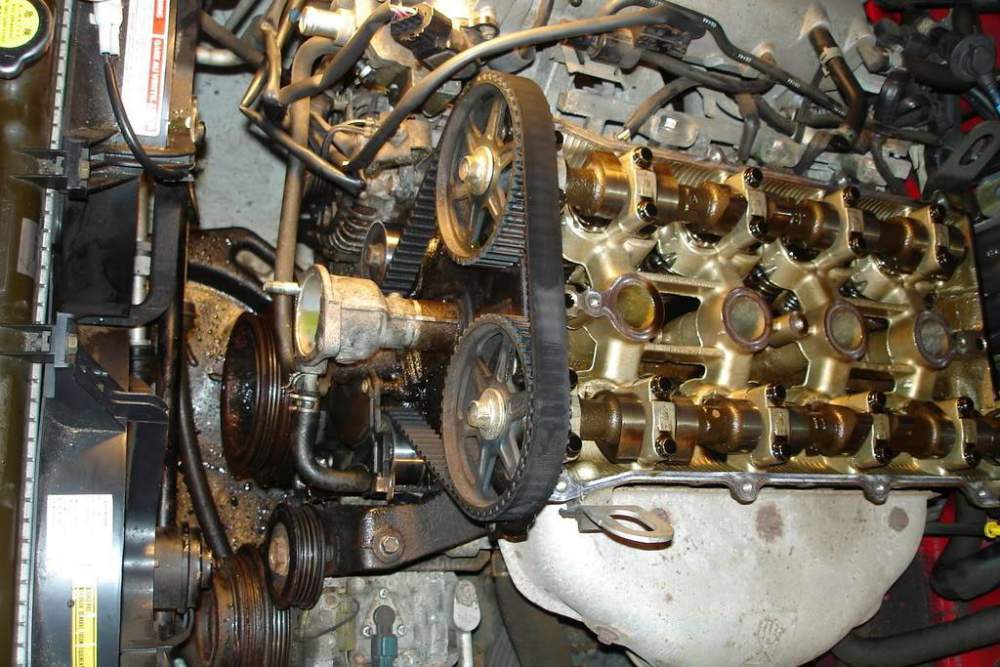

Tore the front of the motor off today.
Leak was in and or around the water pump somewhere...
Bummer is, i have to take the timing belt off to get to the water pump.
Hopefully when i take the old pump off i can see where the leak is.

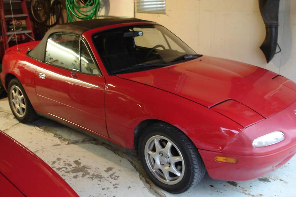

Hard top conversion.
NOW!
Needs moar low. Miatas aren't supposed to have 4x4 status like my GA. :rofl:
' date='Dec 9 2010, 08:41 AM' post='43508']
Needs moar low. Miatas aren't supposed to have 4x4 status like my GA. :lol2:
I don't know, I was thinking he should lift it so it really is a 4x4.
Mmm, lowered Miata. Makes me want to drive my Fiero.
> Implying that body roll feels awesome in turns.
NOW!
:lol2:
Boy do i ever love the hard top. But i want to be able to remove it quickly, and none do that. Plus they cost so much i don't even like talking about it.
Oh, and the top of the car is at my belly button. I'm 5'10"
It don't need a drop, it just needs rims to fill the gaps.
Now this guy on xceed i bought it from said that the water pump and timing belt was replaced which was not true. Not sure if he lied to me, or he was lied to. Either way it doesn't matter. Ended up that the water pump was leaking, actually spraying on the back of the crank pulley.
Started tearing it down.
109k on the clock.

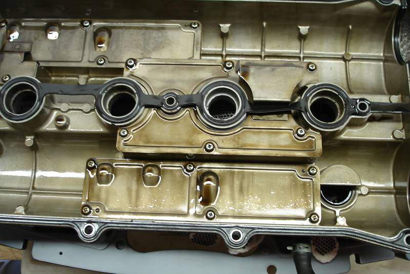

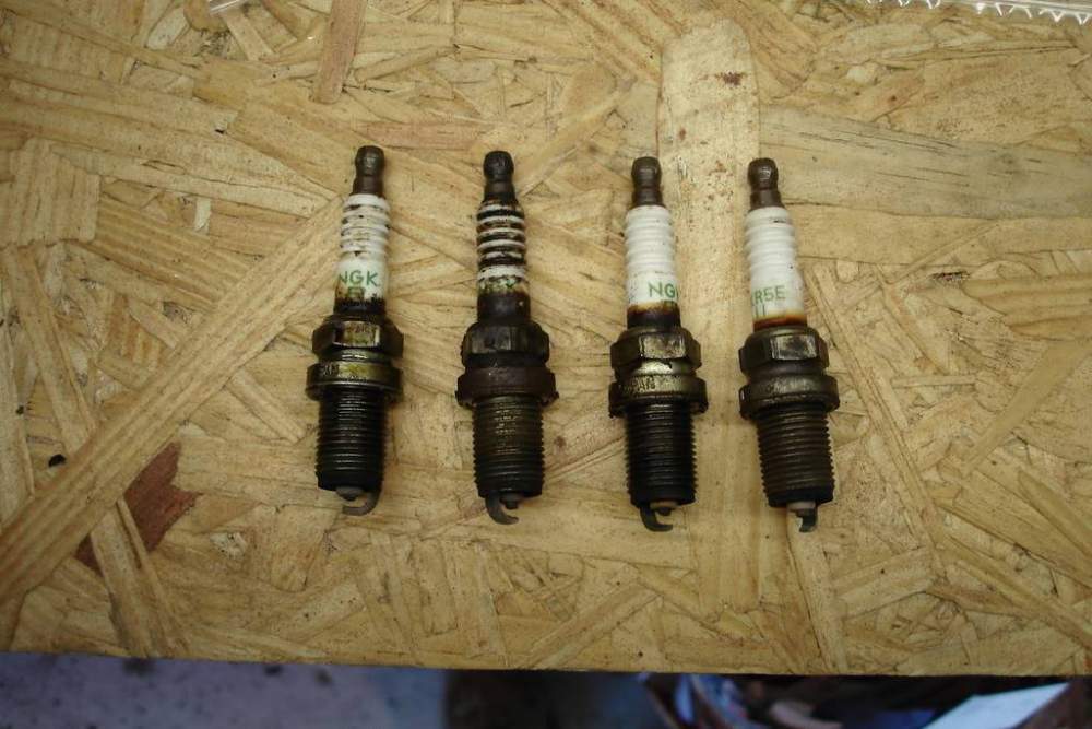

These are in order. I'm new to the whole DOHC stuff with the spark plug down inside. But the little tube that had spark plug 1 in it had some oil in it. I also almost never got #2 out it was so tight.
damn, spark plugs are never supposed to be that tight, hopefully its back up and running soon
