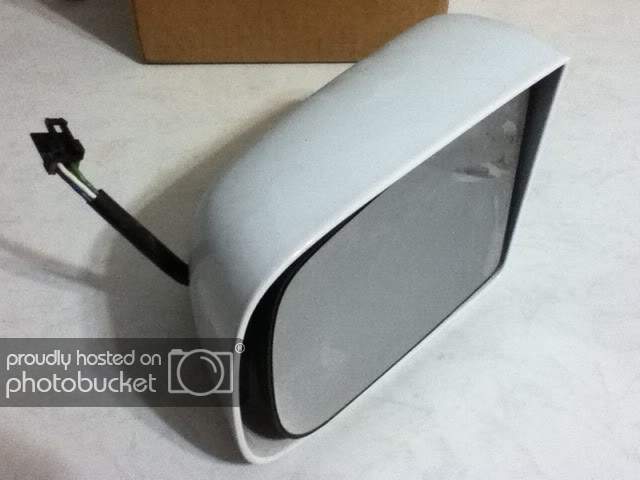

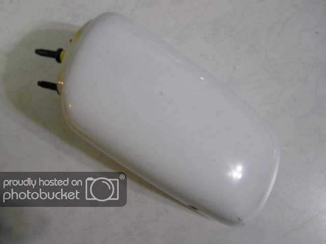

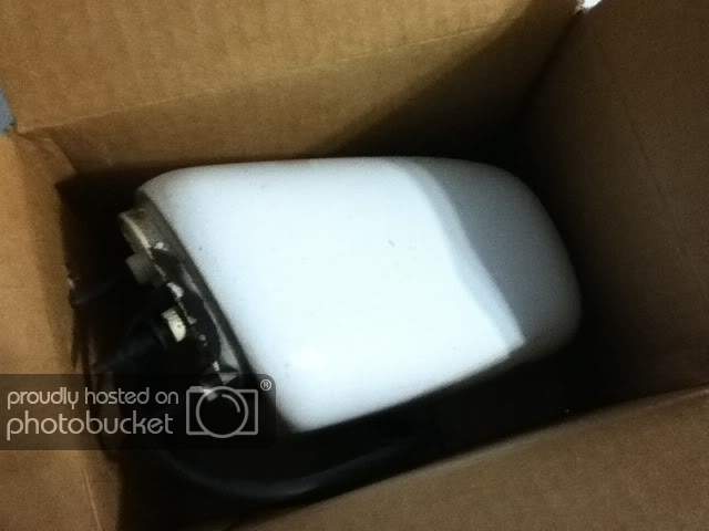

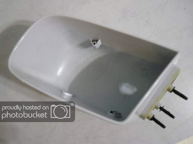

Well, thanks to a couple of members on another forum, I now have a replacement driver's mirror. Mine was smacked on our garage door frame over the summer and as a result one of the three mounting studs was snapped in half. The mirror was still firmly in place and didn't move while driving, but there was obvious play when it was pulled by hand. This replacement was found in a junkyard by a US member, handed over to a Canadian member, and then shipped to me. Forums are very useful. ;)
The pictures below were all taken with either an iPod or Blackberry, so they're not the highest quality.
Even though it's already Bright White it'll get repainted anyway, but it's at least cheaper than a brand new (Probably reproduction now, not OEM) mirror would be.

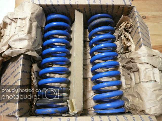

Here's the latest on the Grand Prix;
Last week the first coilover parts arrived, from a couple of sources.
In the bigger box, were 12", 425lb coilover springs for the front. These came from a member on another forum.

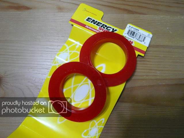

The smaller box contained my Energy Suspension rear spring isolators.
I have also ordered more parts which should be here any day now, hopefully.
Along with getting the pieces above, I also was able to finally get my replacement mirror apart. One of the screws was rusted in place and put up a very good fight. I intend to use just the shell of this mirror (Especially now that half of a screw is still rusted in the threads of the motor case) and swap it in place of the existing piece, as that's the only part that's damaged. It will get a repaint first though.

Is there going to be enough room to go as low as you like with 12" springs?
I went with 10" springs due to GP guys being limited to the 12"ers they were using as far as drop goes. Your front assembly looks like it has even less room to work with.
They were also saying the length of the 12" spring was allowing flex and strut rubbing duting turns.
