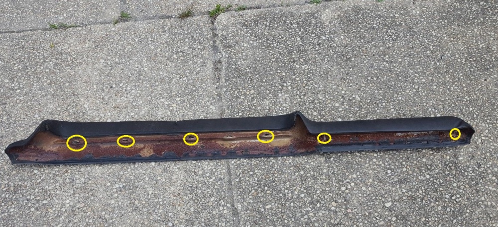

Does anyone have instructions for installing the dash pad, can I install it with the cluster on or do I have to remove the cluster and then put the dash pad on? Any help is appreciated
The only part you will need to remove to install the PAD is the Glove Box Liner. You do not need to remove the gauge bezel.
Cheers
Sprint6 thanks for the info, pretty new to working on these old classics. I took it apart about 8 months ago and the guy that had just had a bunch of screws holding it in, so are the screws that go through the bezel above the gauges for the dash pad as well or are they screwed in separate ?
Correct remove 4 screws under the forward upper edge of Pad  above the gauges. Then glove box removal will allow access to the 2 studs at the left and right side of the passenger side pad.
