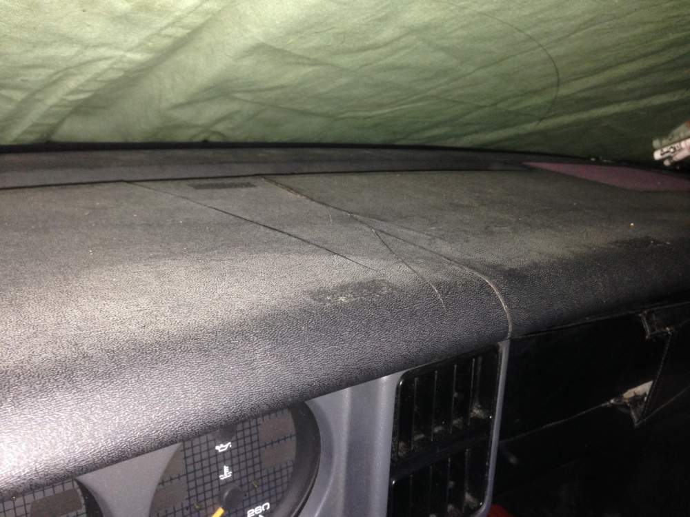

Cracked dashes are tricky. Repairing it depends on how big the crack is. Eastwood Company has a dash repair kit that I have used on my Lemans to fix small cracks. I had to completely remove the dash out of the car to repair some parts of it and then I had to re-dye (e.g. re-paint) the entire dash black to make it look consistent, but it worked for me.
However, if there are several long cracks like I've seen happen to several old Mopar dashes that have (say) a 4-8 inches long gash, then these need to be professionally repaired. A company called Just Dashes can do it, but it will mean that you send your disassembled dash to them and they will completely strip the pad and foam off and re-apply new. It won't be cheap, but it will look OEM new and original when you get it back.

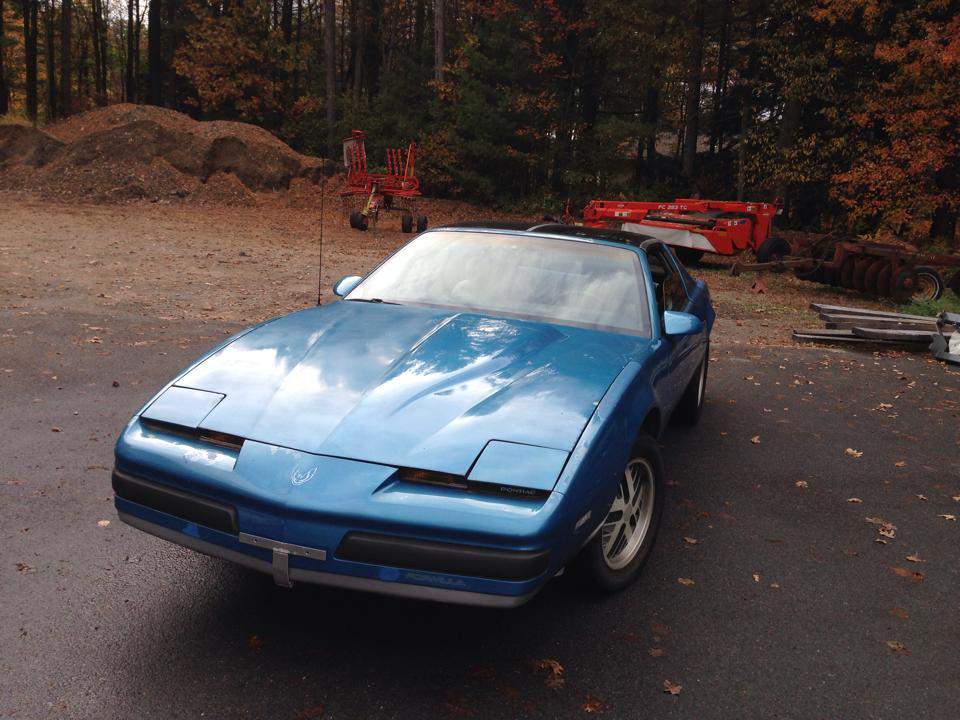

Haha good to hear on that, just got in from taking pics. If you need to see more specific areas I can always take more.15ro6t1.jpg21o8za1.jpg
Yup, those are definitely shaved door handles.
Think it goes back to what Frosty is saying and if you like the look than you can have an adapter made to access the doors easier or if you just want door handles then you'll need new doors.

OK - now that I know that you have shaved door handles, I know what you need. Street rodders and hot rodders have been shaving door handles for well over 50 years and they install either a mechanical or electric shaved door handle kit. You need to a couple of basic things, one is a mechanism that unlocks the door and pulls on the door latch mechanism. These days that is usually a wireless key fob. The second is a spring loaded door "popper" to push the door open enough for you to grab it and pull it open.
There are lots of kits out on the market but these are generally universal kits and it will be your job to make it fit and work in the Firebird doors. There is no kit made to fit the Firebird.
Another thing to consider, especially if you purchase an electric kit, is what happens if the car battery goes dead? Does the kit allow for any sort of remote manual release mechanism like a cable pull or push button (most street rodders hide something like this under the frame somewhere). So do your homework, ask questions of the companies that make these kits or who sell them. Calling hot rod shops would also be a good idea to see which kits they recommend, sell, or install themselves.

Your dash pad is beyond the help of a simple Eastwood repair kit. I would contact Just Dashes and see what the cost is to have it rebuilt.
http://www.justdashes.com/

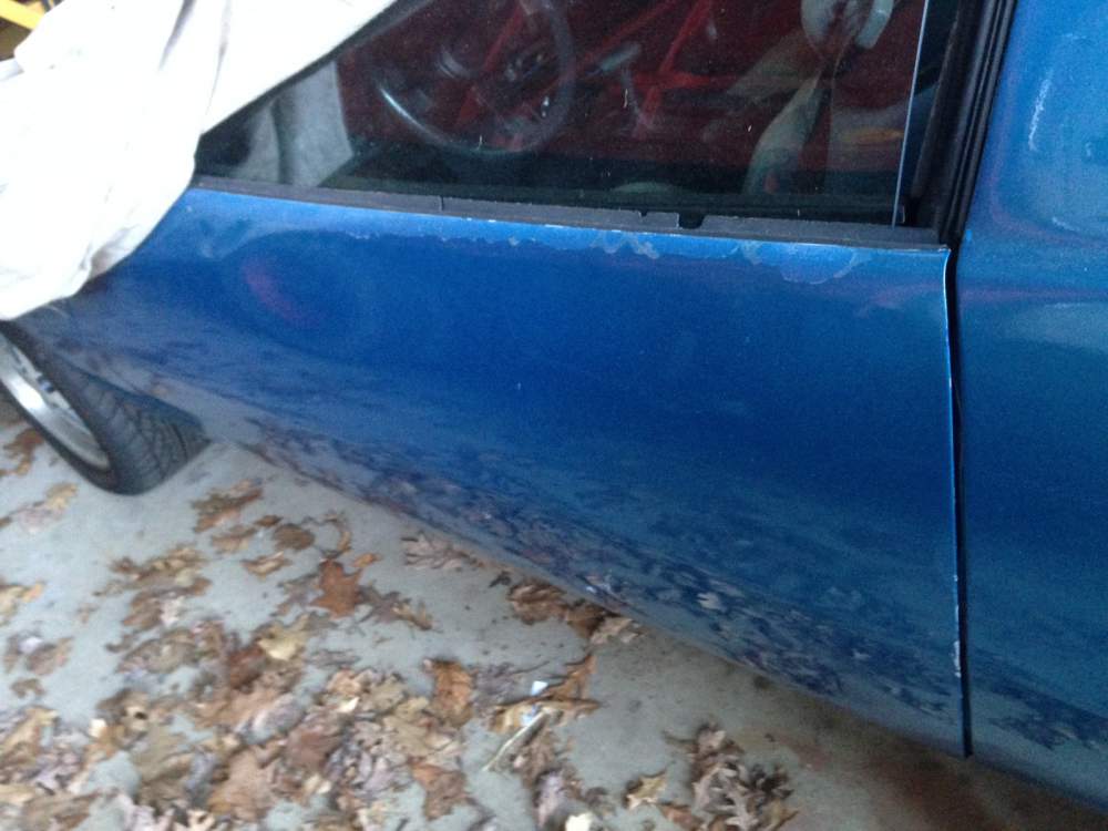

Based on your picture, it looks like your window felt weatherstripping needs to be replaced. Anymore weather stripping you need to replace? Steele Rubber Products has you covered.
http://www.steelerubber.com/beltline-weatherstrip-80-0687-57
