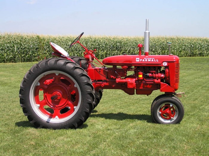

In hindsight, I think my youth had something to do with my haste, but It doesn't mean I haven't learned for future projects. The next item on my list is a Farmall C/Super C :). I plan on keeping my Phoenix forever haha
