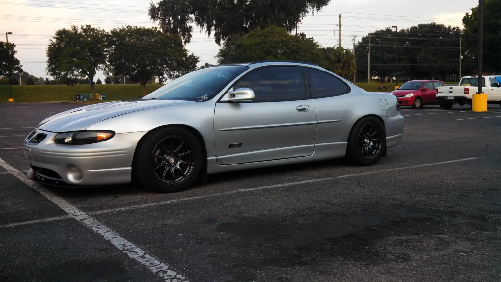

I took a few recent pics
  • 4 weeks later...
Interesting with the fender...
What's up with the smaller wheels? o.O
By far the most unique GTP I've seen. Kudos.
not a fan of that fender but to each his own. looks great otherwise

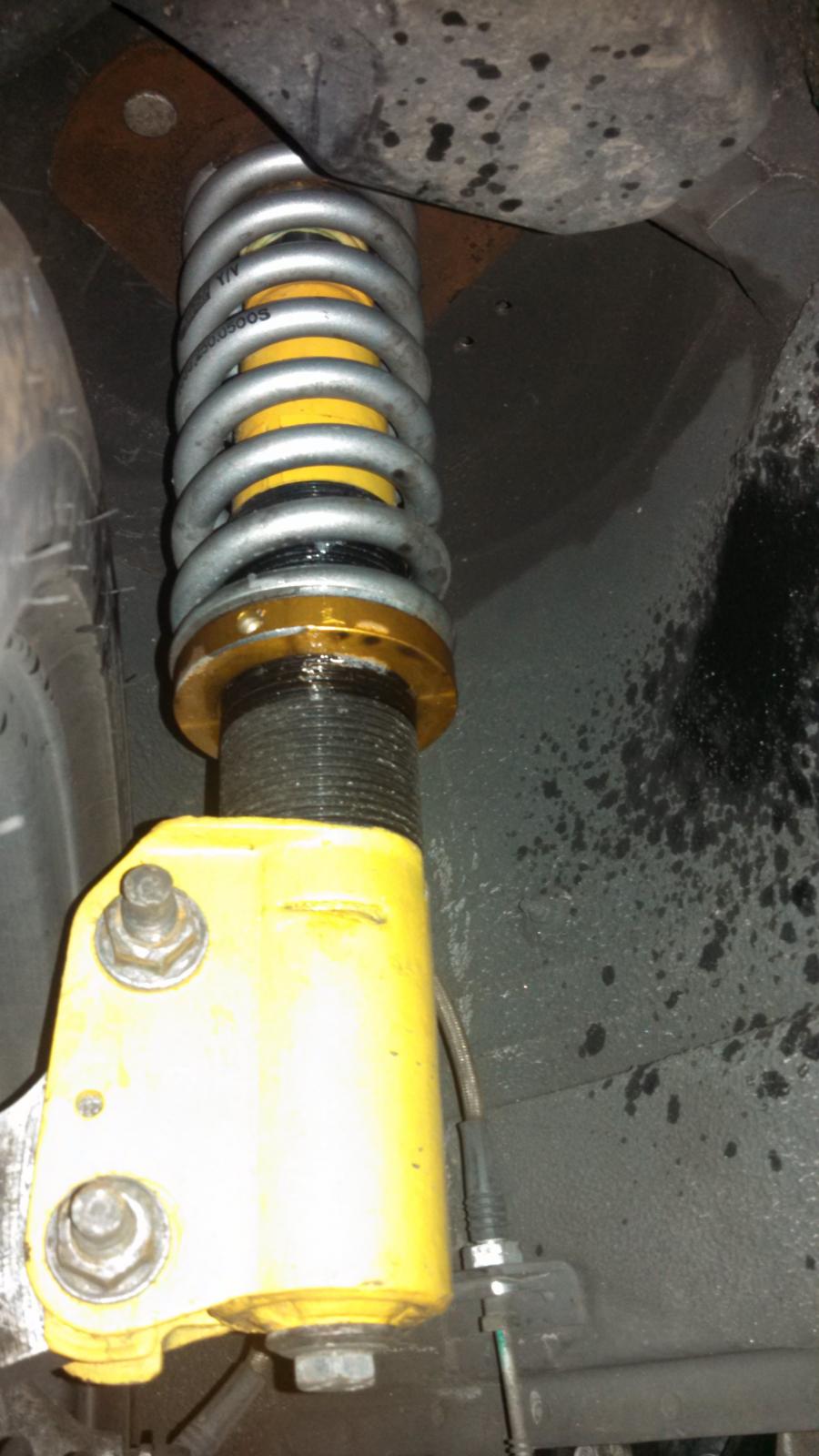

I forgot all about this thread till today. I've done some more work to the car, mainly it's that I built coilovers for the car and retrofitted a air splitter for the GTOs to my car.
You built coilovers?
That I gotta see.
Koni struts and Eibach springs all the way around. Custom front mounts, the rears are stock with a spring hat. I'm still working out getting bumpstops mounted. Everything I've done hasn't worked out to well so far.
Just curious, don't they make coilovers for the W-body already? I know Dalton (killerspeed) has a set on his Limited Edition GTP.
There are a few sets out there but they use AGX struts which aren't the best thing outside of a normal drop. The fronts were revalved to match my springs. I'll get the rears done one day in the same way. I'm running 500# front and 400# rear
My W-body AGXs, 400lb springs up front, and a heavier car work pretty well.
I'm sure they're fine. I already had the Konis in a retrofit with Eibachs so it was a no brainer. I ran 400# springs for a few weeks and felt they were to soft for my liking.
