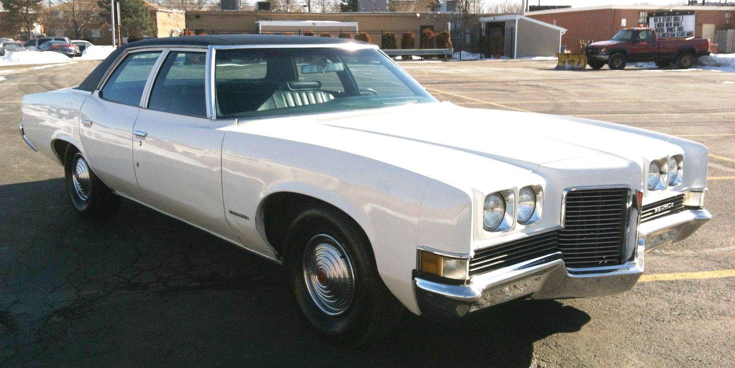

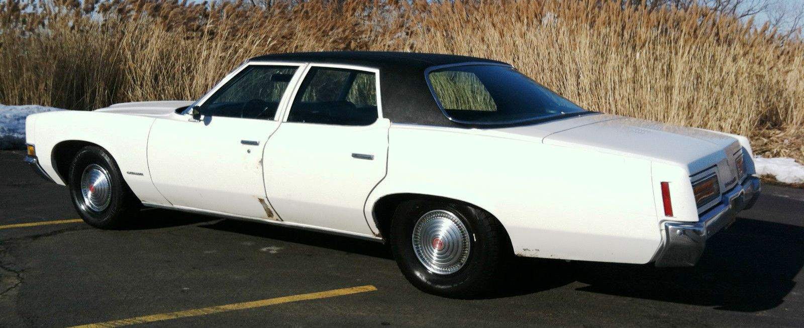

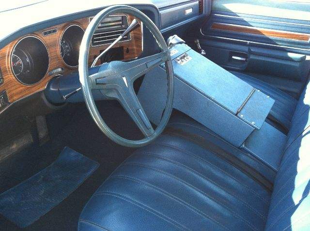

Well I have finally restarted working on my 8 year neglected 1971 Catalina Freeway Enforcer ex Police car. I bought it 10 years ago on a whim and I am attracted to odd Performance Pontiac's and a 455 powered 37,000 Mile Ex Police Chief's car qualifies IMO. I am attaching the 10 year old as bought pictures of the car, It has sat outside for the last 5 years so it does not look as good as it does in these pictures. Oddly equipped even for a Police car, 455 4bbl with 1970 D-port ram air exhaust manifolds, HD frame, Battery and Drivers Seat. Handling Package with 1 1/8" front Sway bar and 1" rear bar. Larger front Disc and rear drums sourced from the same year Cadillac. No Radio or Antenna, Manual Windows, and a Custom Cushion Steering Wheel, and full carpeting put over the standard Rubber Floor mat that Police cars and Taxi cabs used.   It even still has its original Engine, trans, and rear axle. HD TH400 and a 3,23 open rear axle.

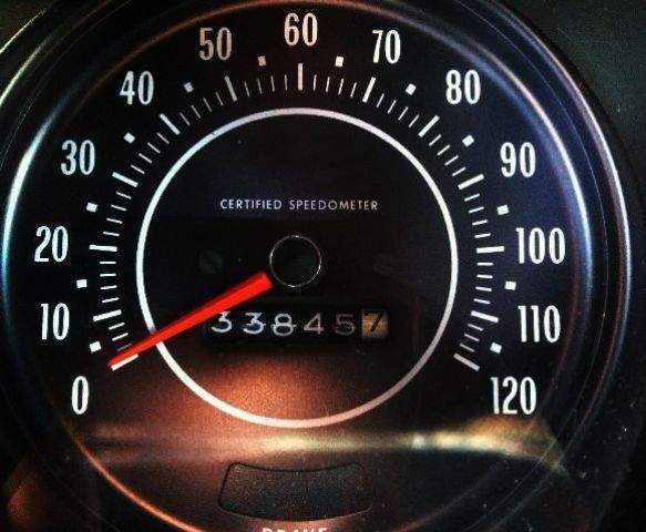

I also uploaded  a picture of the "Certified Speedo" and the one Vintage Picture I have obtained of it in service taken on 10-21-1971 curiously the very day my wife was Born.

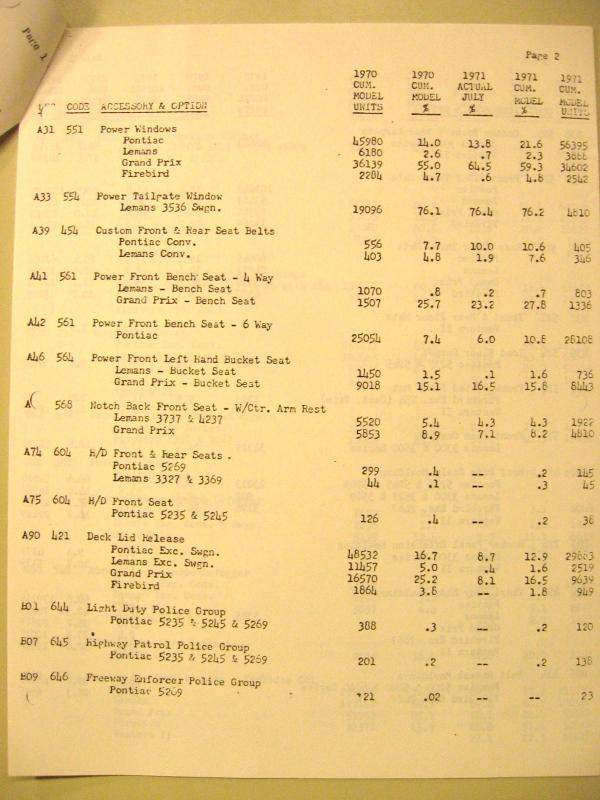

The GM Heritage center came up with this document showing the 1971 Pontiac Police car Production numbers. 120 Light Duty Enforcers, 138 Highway Enforcers, as 23 Freeway Enforcers. So it is 1 of 23 Freeway Enforcers, and 1 of 291 total Pontiac Police cars made in the 71 Model Year.

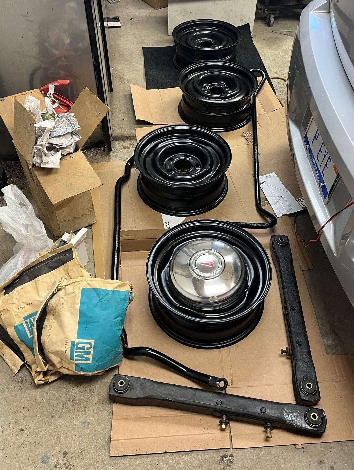

These are the cleaned and Powder coated rims and sway bars, lower control arms and a few other small parts. Before the new tires were mounted and all were dropped of at the Resto shop.

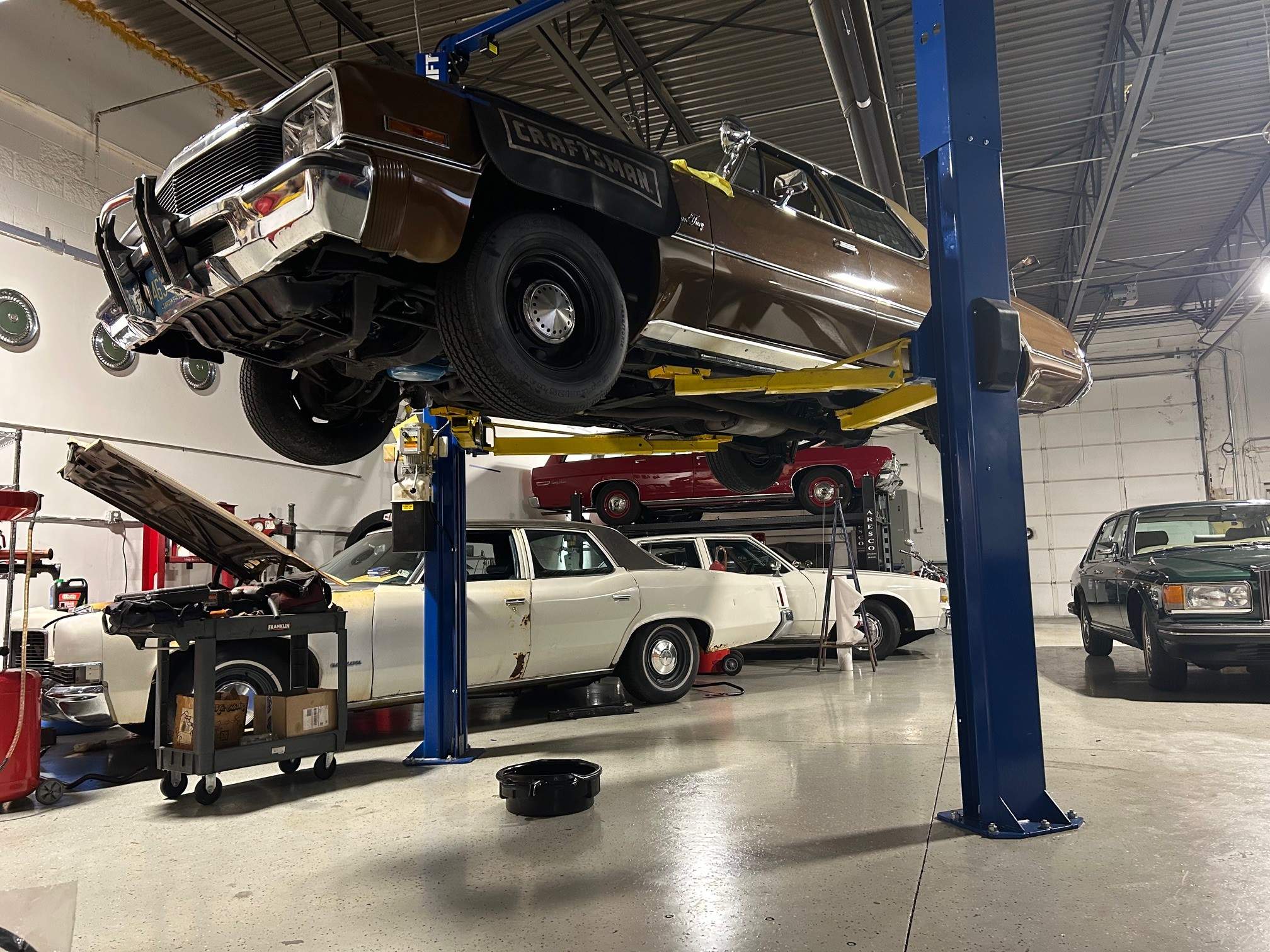

I will try to keep this tread up to date, The Shop is supposed to get it up on the lift this week and start pulling out the fuel lines to have them replicated by Inline Tube, that is only about 10 miles from the shop doing the work.  At the moment there is a 74 Ex California Highway Patrol car on the lift. I have also talked to them about having the lower part of the car Dry Ice Blasted to get the 50 years of scale and rust off the bottom, with the tank and lines removed I would think that would be a good time to have it done.
Besides the CHIP cruiser on the lift, they have a 1974ish ex Michigan State Police Fury, the Red Ford wagon on the lift is a Customers Old Fire Chiefs car from Chicago, and they also have mid 90's Caprice & the white car in the background is a late 80's Caprice, both ex Cruisers but I don't remember the history on those 2.

Nice Checker cab up on the lift!!
Rick
Checker - A fine product built by the Checker Motors Corporation in Kalamazoo Michigan until 1982. Probably an A11 or A12 model. The very last Checker built is on permanent display at the Gilmore Collection in nearby Hickory Corners (NE of KZoo).
That Checker is actually a Wagon, with a roof rack. I don't know much more about it though. I really like this shop as they own weirder cars than I do. Almost makes my taste seem main stram 🤣
The only Checker wagons I know of were all Marathons. Marathons could be had as either sedans or wagons.
