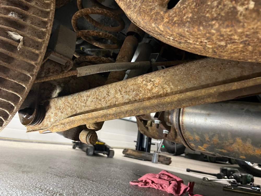

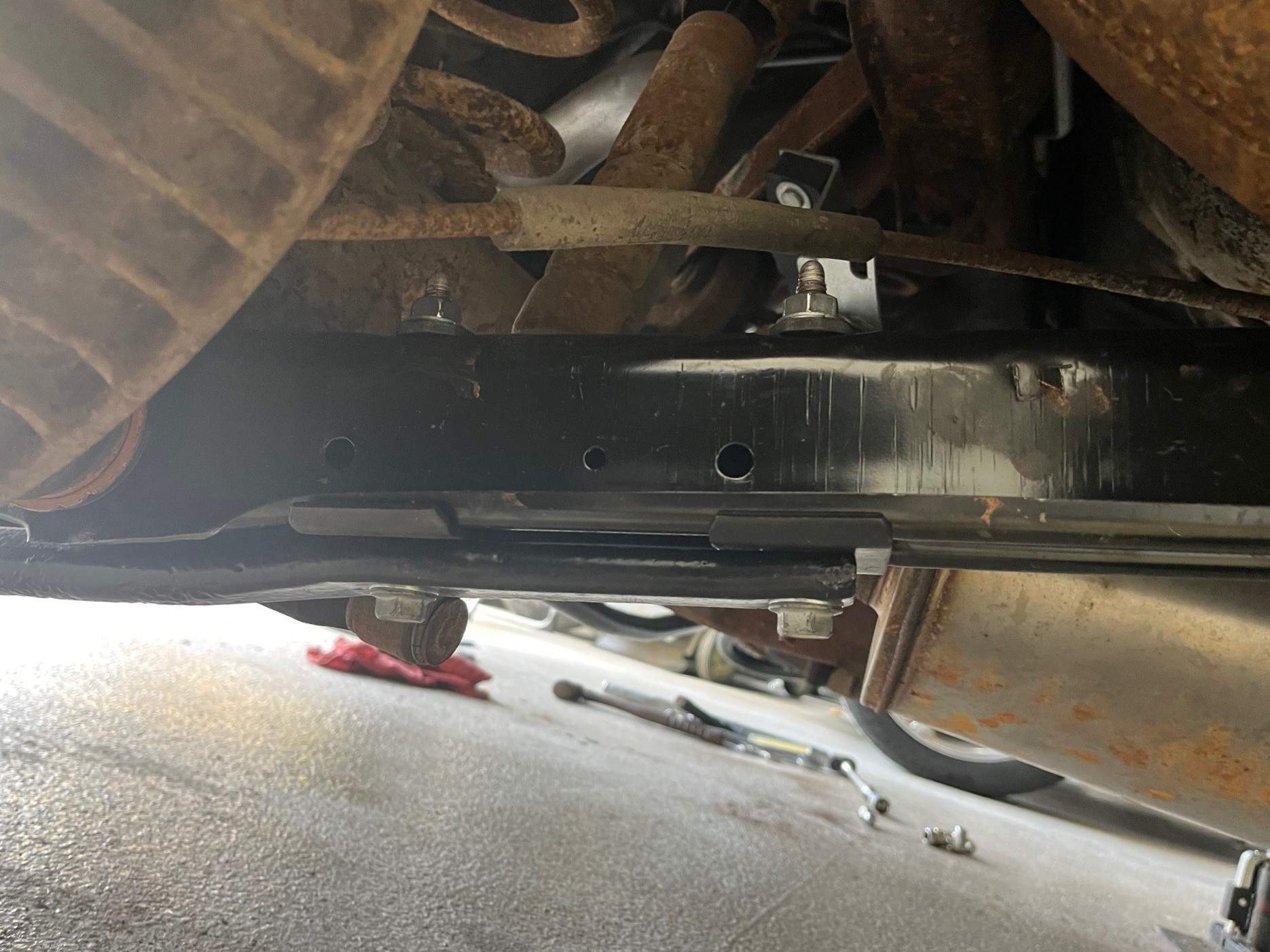

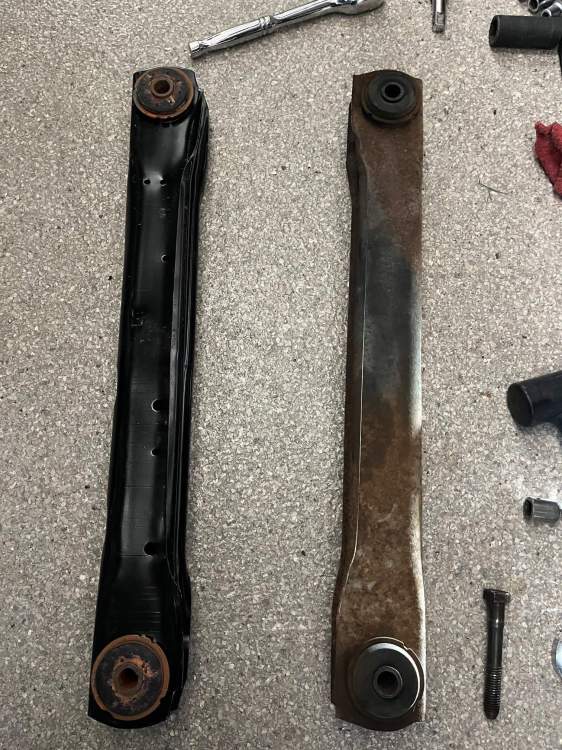

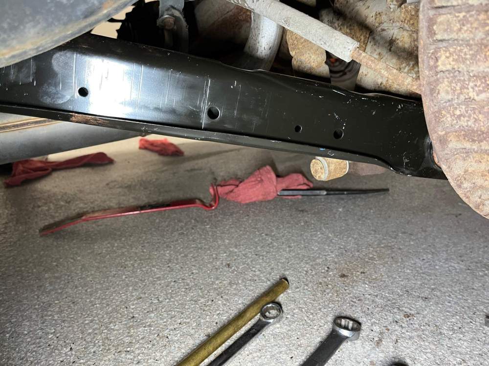

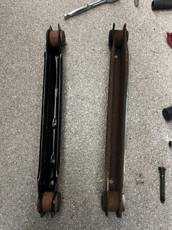

After work today I did manage to remove the drivers side rear lower control arm to compare it with the set of NOS ones I purchased 5 or 6 years ago. They are the updated design intended for the 1991 and later Chevy Impala SS, and the Police Caprice 9C1. Only used on wagons with the tow package. And surprise they are interchangeable! The hole centers are 1mm longer on the newer Buick parts. I was told they would work on the 71-76 B-Bodies, and the 78 and later B-bodies. I was skeptical, but the GM engineer was correct!. I did get the drivers side installed, and continued soaking the passenger side hardware with penetrating oil.

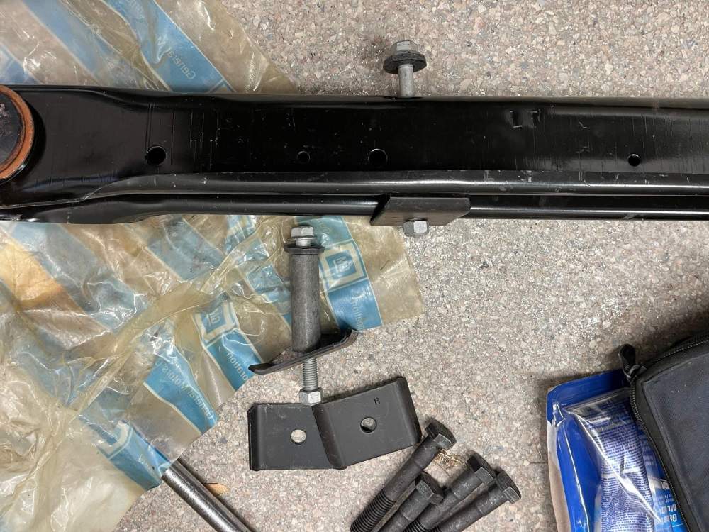

The newer arms use a different mounting system than I am used to, the older system had bolt in brackets that mounted inside of the C section of the control arms, that had captured nuts to mount the sway bar to. The newer arms use thru bolts & nuts that go thru the sway bar, and use 2 separate plates that go under the C section of the arm. and use spacers on the bolts between the upper surface of the arm, and the lower plate.
I included the GM P/N's for the kit in case it is of use for anyone. The lit Includes 2 Lower control arms with new bushings, all the hardware needed to install the rear bar, and even 4 new control arm mounting bolts and nuts. (that I did not use and my original ones are in good shape. I will post some pictures of the bar installed later this weekend. I do like working on this car, even though it is a 55+ year old rust belt car, with less than 35K original miles on it things still come apart without resorting to heat, BFH's, or saws!

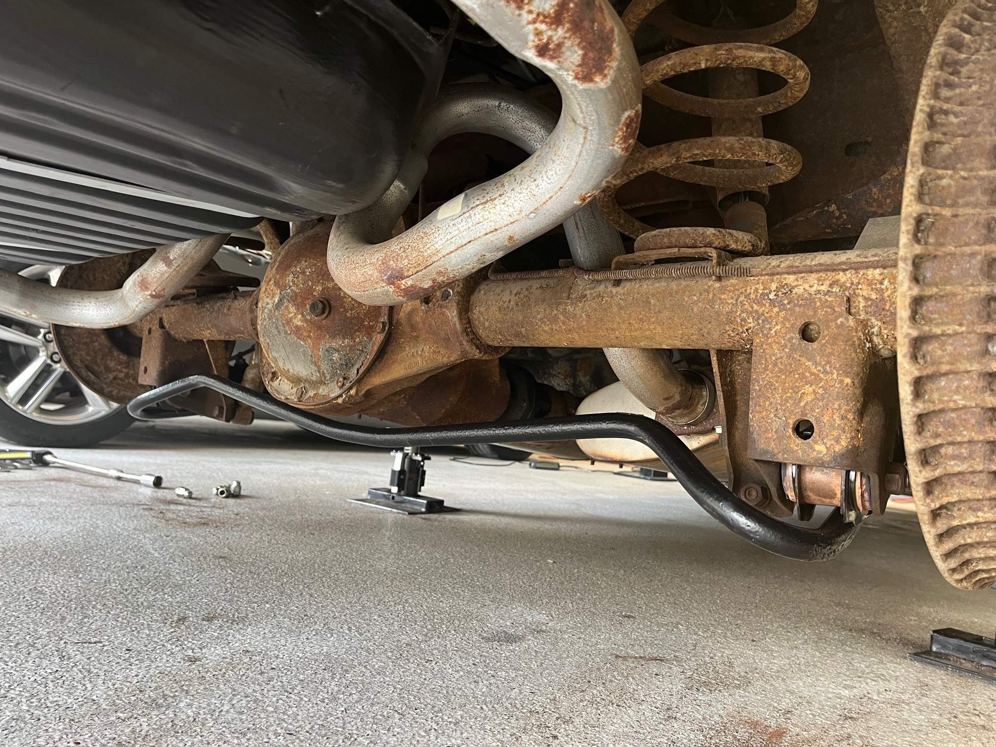

I managed to swap the passenger side lower control arm today, torque all 4 bolts on both arms, and install the 7/8" rear bar, easier than the last rear arms I swapped out. Looked up the 1996 recall on the 9C1 Police cars and Taxi cabs. it seems that the Police cars and Cabs were breaking the lower control arms at the rear bolt holes for the sway bar mounting brackets.
These arms were installed to correct the situation.
