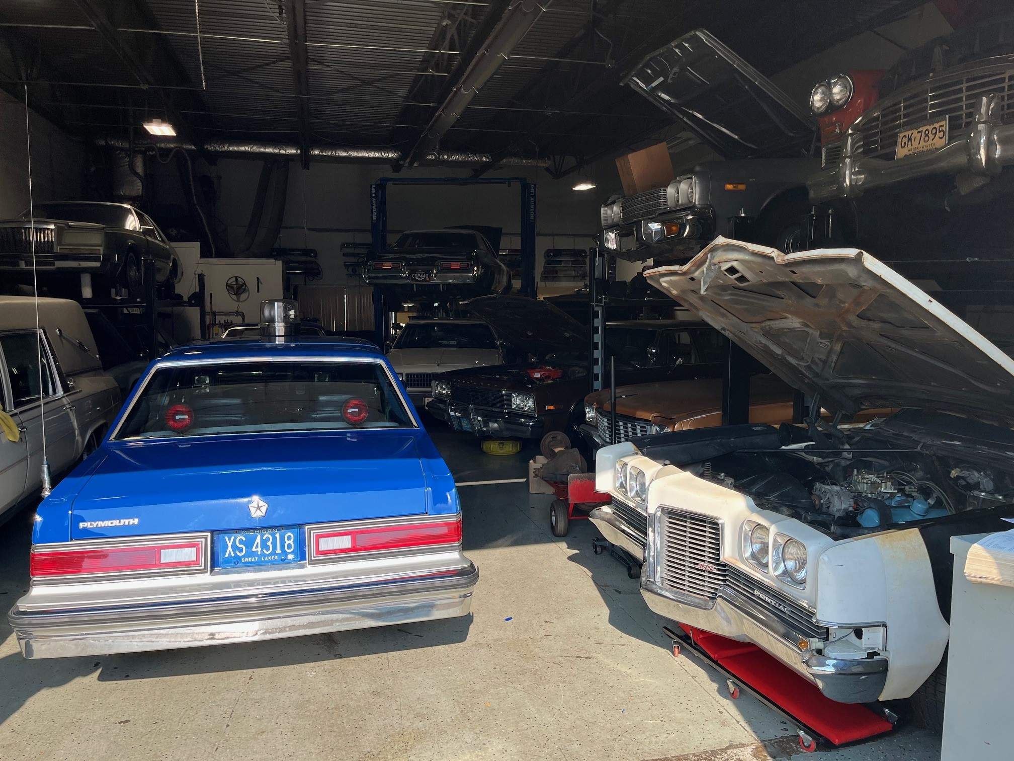

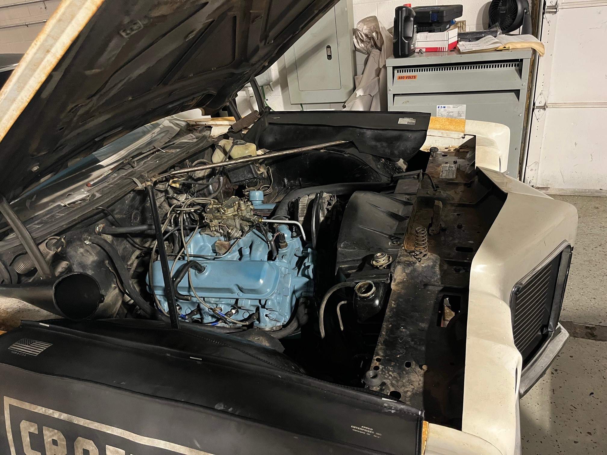

A few pictures from my cell phone, The 1st one if of the Catalina, engine back together, running, but leaking fuel back by the tank. Then the Catalina at Chase Restorations with their cruisers and some customers cars.

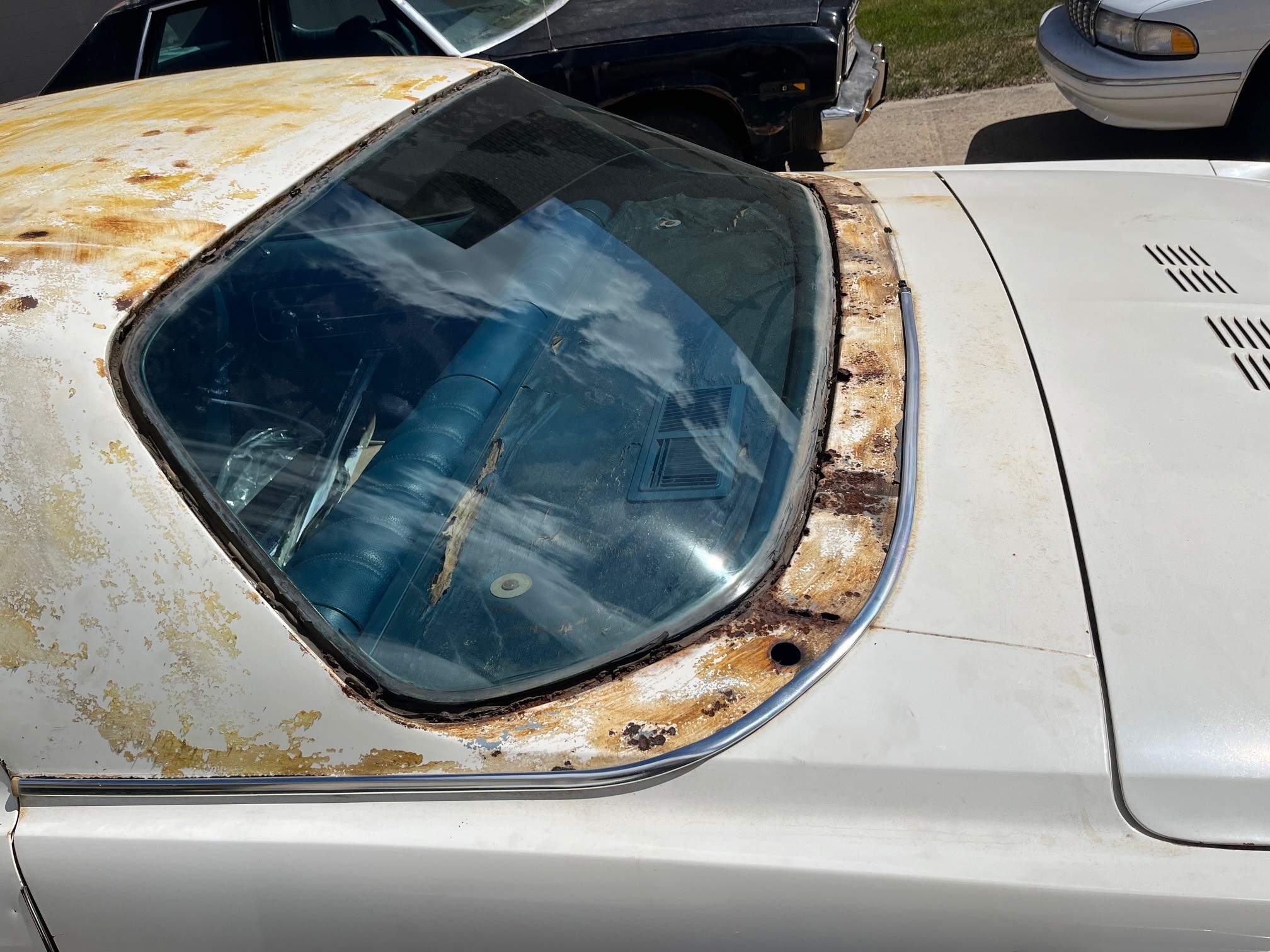

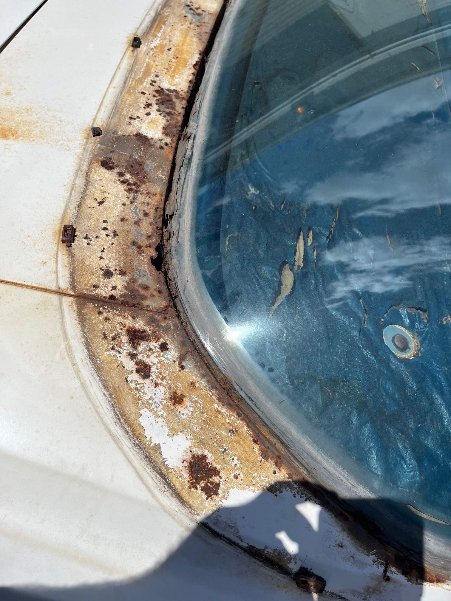

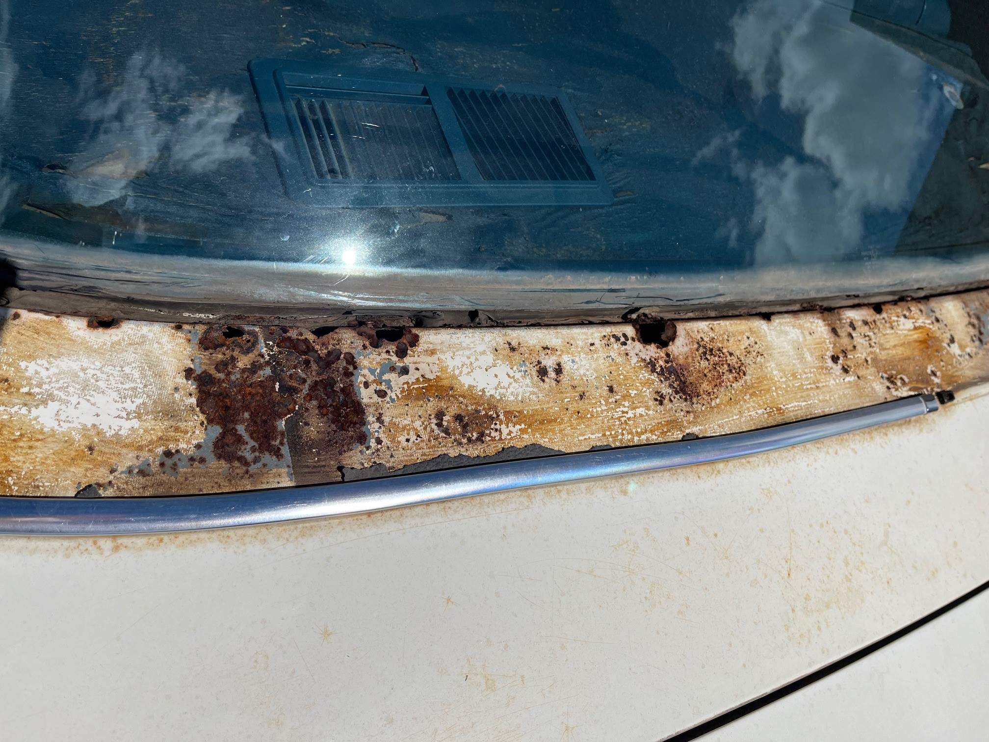

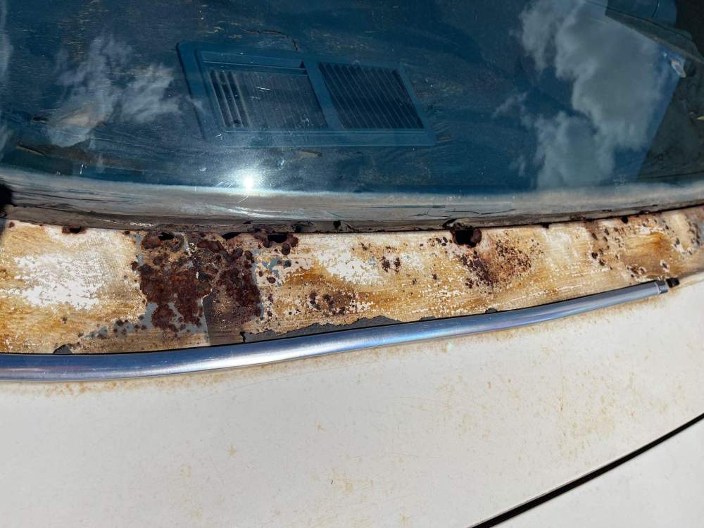

The bad news is that after the shop stripped off the vinyl top we found the rear window channel is pretty rotted out. And found the original hole for the Police Radio was on the filler panel just behind the rear window on the drivers side.
Strangely there is no sign of a hole being on the roof where the rotating beacon was mounted. We were hoping there was a bolt pattern to determine what make and model beacon was mounted. No luck there,
One of the 2 body shops that chase uses for body and paint work came by to look at the car when I was there, and the rust around the rear window concerns him, as there are no patch panels available, and he does not have the tooling to make the complex curves that would be needed to make the piece, he is not ruling it out but he is going to ask his partner if they think they can do it.
It is the same concern I experienced 8 years ago when I tried on my own to get the body and paint done, Not a GM A or F Body, no patch panels available.

show us the panel in question, jeff.
all you really need is justA good metal man , there is no such thing as a hard job when it comes to our pontiacs !
if you cant find it.... make it ! dancingpontiac
Well here they are, mostly confined to the lip around the lower rear window edge, but some heavy surface rust and pin holing along the entire area below the rear window. I circled the drilled hole (in Red) where the radio antenna was mounted. For some reason the image of the drivers side with the antenna hole will not upload?
The last pictures were taken during the test drive.
Ok I removed the circled area of the drivers side and the picture uploaded.

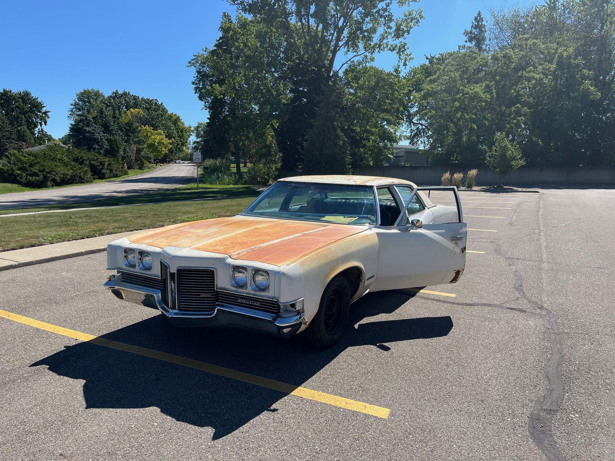

Well the body shop scheduled to do the body and paint is going to be delayed about 6 more months due to current projects running long. So I had to get the Enforcer out of the shop now that the mechanical work is complete. So the plan was for Today to drive it the 65 miles home (sold my trailer this spring due to space issues) well on Wednesday the Master cylinder went out, the shop managed to get it replaced and the brakes bled on Friday Morning. So the trip was on again! It is actually the longest I have ever driven the car sense I owned it, and we beat the Rain/Snow mix expected for Tomorrow!

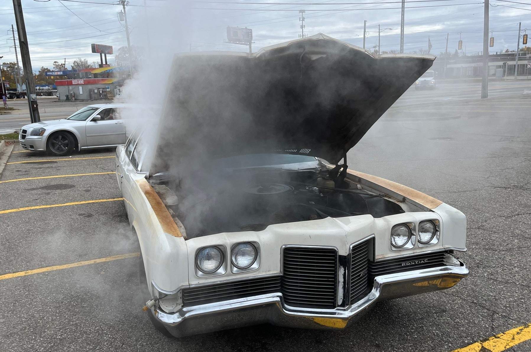

The trip started out well the car was driving well, then the blower motor quit about 10 minutes into the trip, good thing I wore thick Socks! 45F at 12:00 pm when we Started out with my wife in the Chase car. I even passed another Ex-cruiser on Grossebeck. Then just as I was approaching 8-mile road the Temp light came on about 15 seconds before the steam started coming out of the hood. Pulled into a Fast Food parking lot and assessed the issue. At first I thought the heater core had blown, but when the steam cleared I could not find a leak, all the steam seemed to have come from the overflow line so I deceided to let the car cool down and get some coolant, rags, funnel, and RTV, and remove what I hoped was a stuck thermostat (almost brand new by the way the shop put it in about a month ago) With the thermostat removed and 1 1/2 gallons of coolant later we were back on our adventure. Made it home with now other issues. Now to do some interior and suspension work while I wait for the body shop to be ready for it.
