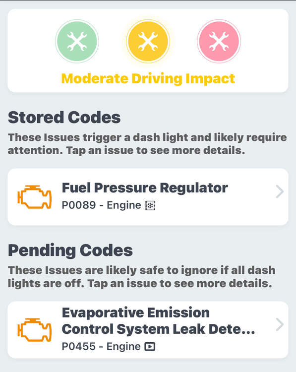

I own a 2007 Pontiac Solstice GXP. Code for fuel pressure regulator appears. Is this something I can fix on my own? I’ve managed to change out the battery and radiator fan module. IMG_1830.thumb.jpeg.b3640d3bfdd560b57de2c3a590157f66.jpegIMG_1828.thumb.jpeg.72fe86328bd2ee5c23ba60a3d5543855.jpegIMG_1822.thumb.jpeg.24d923831436af6e77bb9a090814c5d1.jpegIMG_0035.thumb.jpeg.42966ce05b1d9e817dd03ba31b975a04.jpeg

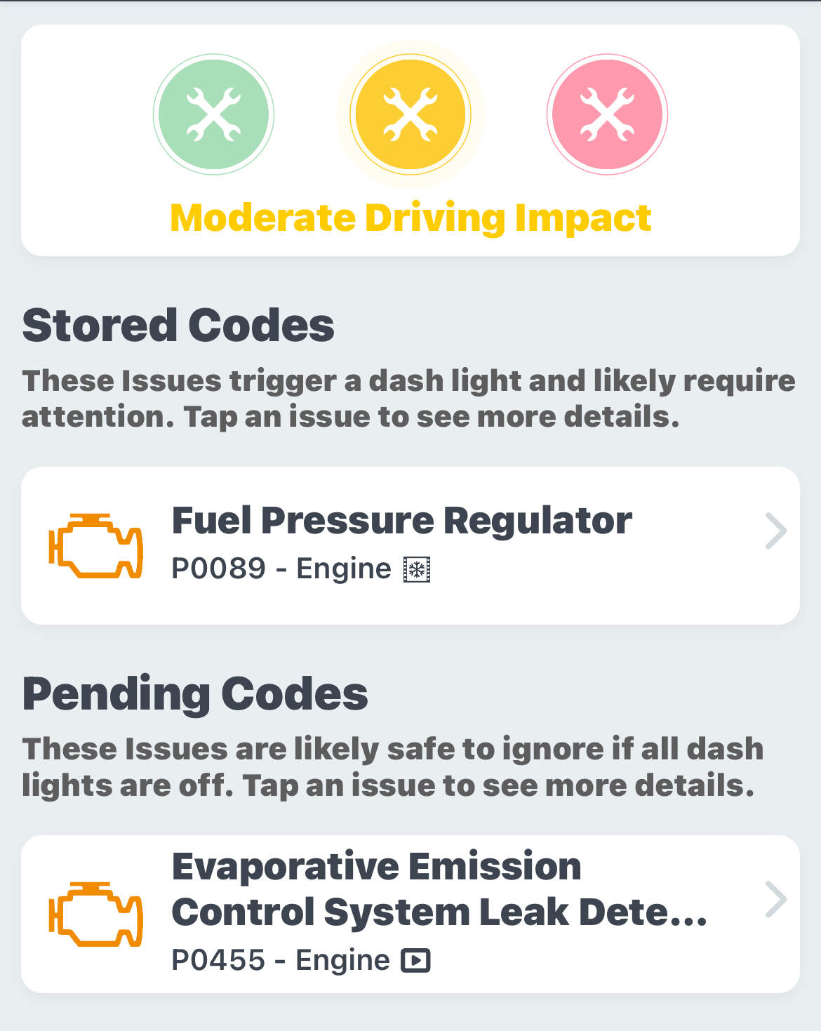

Welcome to the site Dawn. What code? There are a lot of codes for fuel pressure, P0089, P0090, P0091, P0092, P00C6, P00C8, P00C9, etc, etc.
So knowing what particular code would help to start. There may be more than one. There may also be codes set for miss fires as a result of the fuel issue. You should also check the pressure at the Schrader valve on the fuel rail.

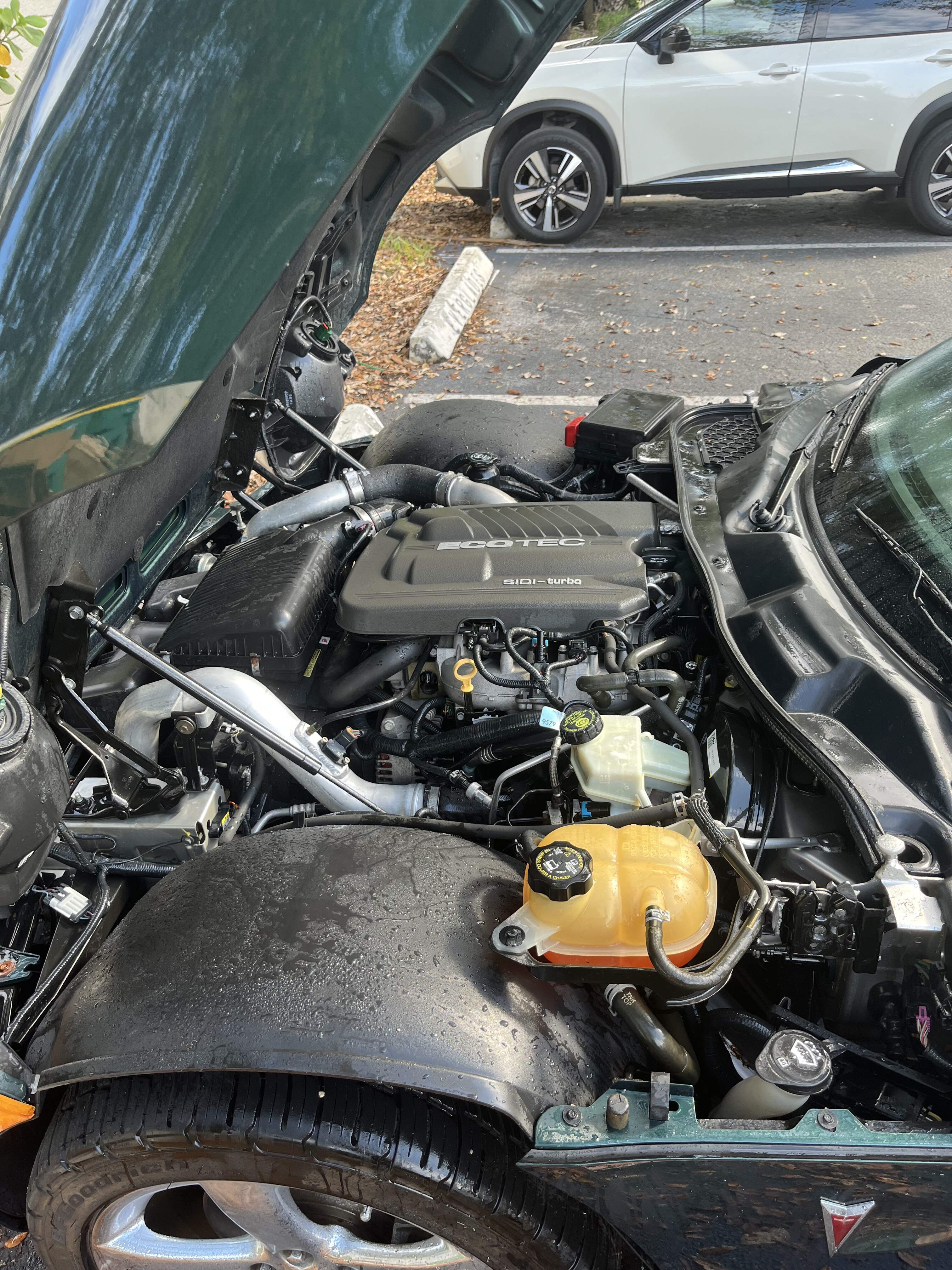

Thank you for the welcoming, insight and suggestions y’all. Good to be here!  The car has been unregistered and slightly driven in the past year. I had to replace the turbo years ago bc of an overboost situation. I’m now hearing a ticking sound coming from the top of the engine. IMG_0270.thumb.jpeg.fc6324960803fd6913d82d052e575ab1.jpeg

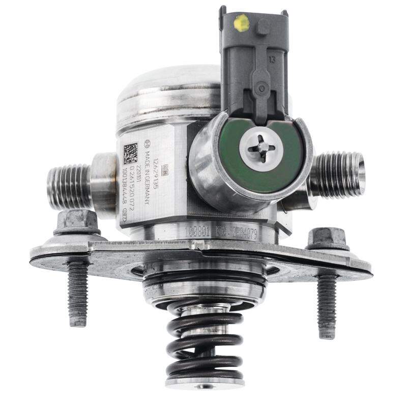

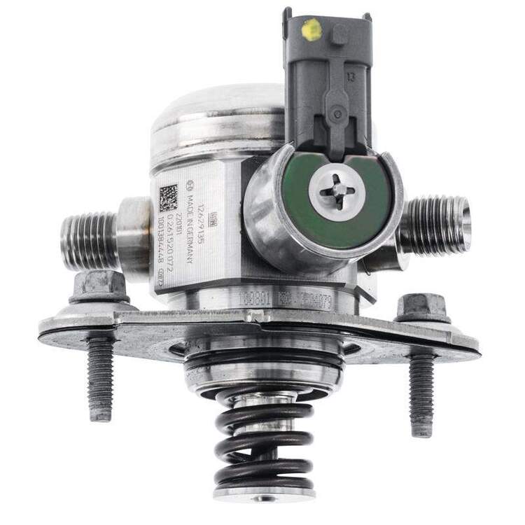

I would believe you need a knowledgeable mechanic. Why? Unless you are very adept at troubleshooting a direct injection system, you’ll end up just being a part’s replacer! Which can get expensive quick. Without being there I would believe that the pressurizing pump that mounts to the upper front of the engine is causing the trouble. This pump increases the fuel pump supplied fuel from between 35psi to 155psi depending on engine rpm.
Additionally the evac system is at the back of the car usually in the upper area behind a rear tire. This involves a vacuum canister & a pump.
this is a high pressure pump for a Solstice.

Dawn, I don’t wish to discourage you, but I have worked on a many high pressure injection system & they can get complicated as well as expensive & involved. This was one of GM’s first production direct injection attempts in a car.  5 years after your car the systems got much less involved. I just think if you don’t understand how these systems work you could spend a lot of money needlessly & still not resolve the issue.
