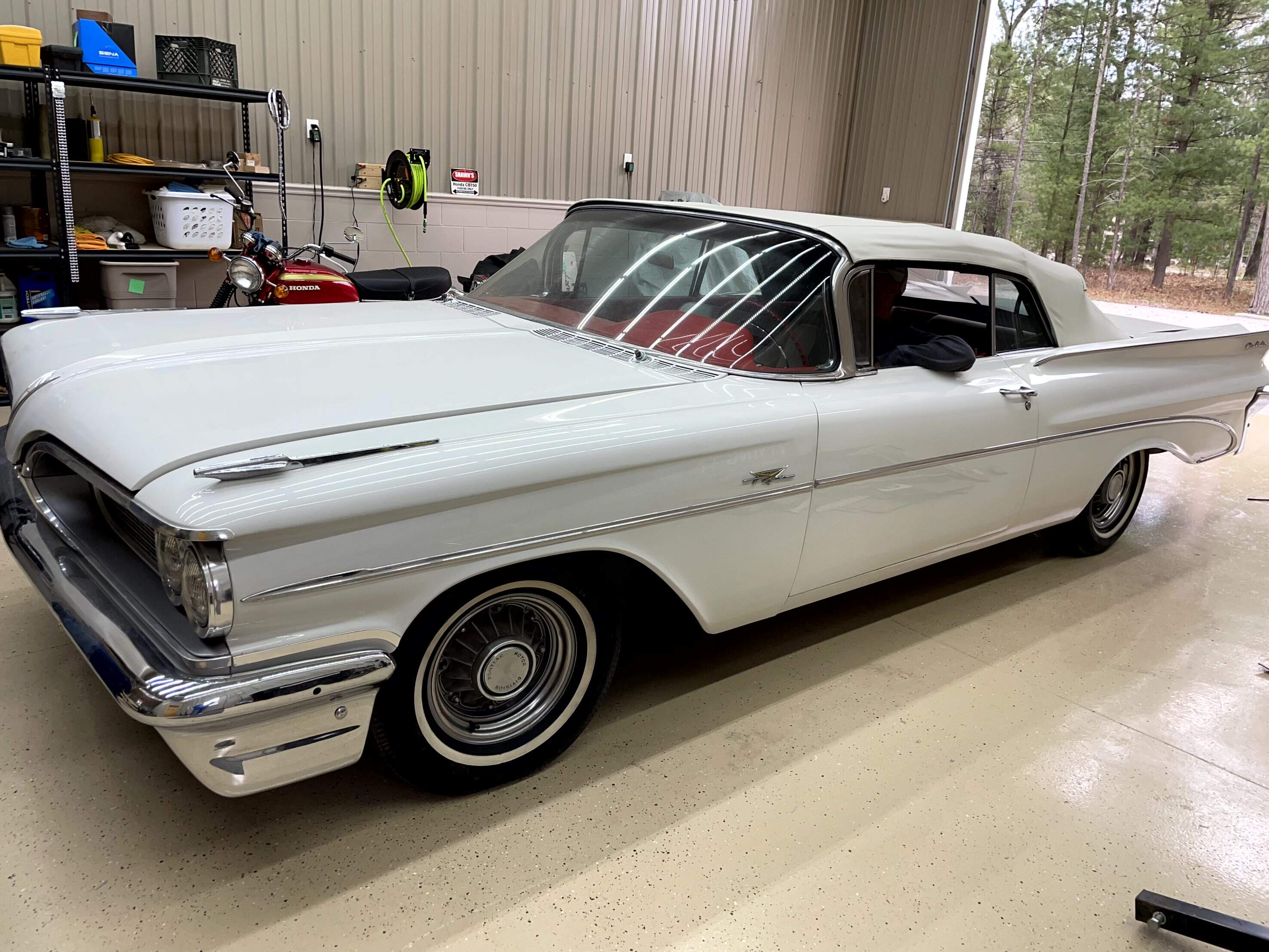

Here it is, I just got it a few months ago.
Still trying to get it on the  road. :)
Wow, yet another excellent example of Pontiac style. :indian:  Welcome to the site and thankz for the pic's!
Yeahhhh that's one fine 59' bro! Thanks for the pics.
wayyy cool 59 :dancingpontiac:
 are you taking your 8 lugger off ?

@64 Kiwi Bobby Thanks sir! and yes I'm removing the 8 wheel lugs. They look cool but weren't offered until 19 60 so i figured no harm in going to the original 5 lug pattern and at the same time upgrade the front to disc.
