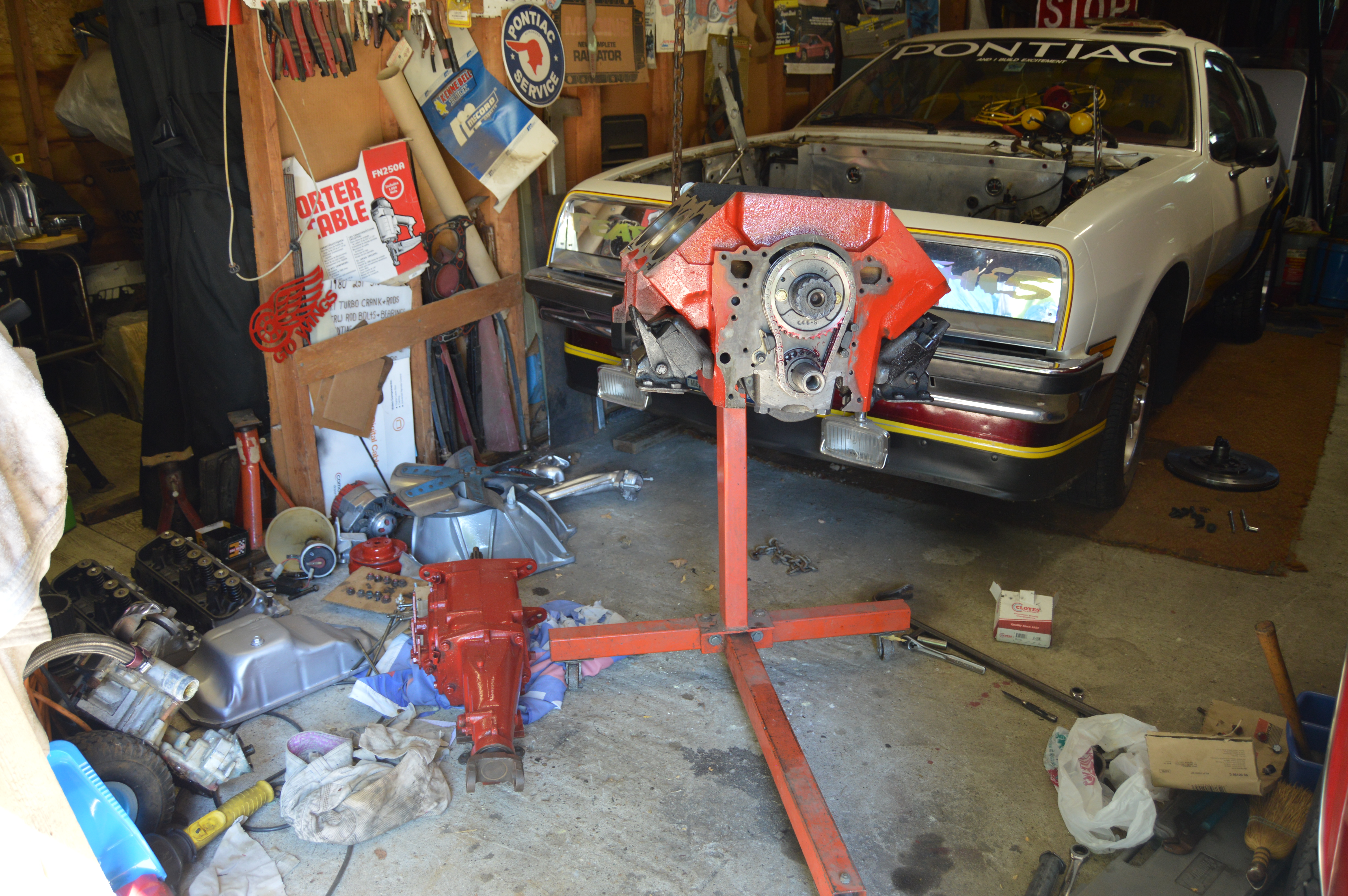

We've had so many late nights, early mornings and a couple of all nighters this year! This time it was from a spun rod bearing, worked til 1am. Up at 6am to finish it and then drove it right to a car show! Ended up getting top 35 and best pontiac. Let's hear your late nighter stories!

Great shot of you working Katie, with your forman keeping a eye on you from under your chair !!:rofl:

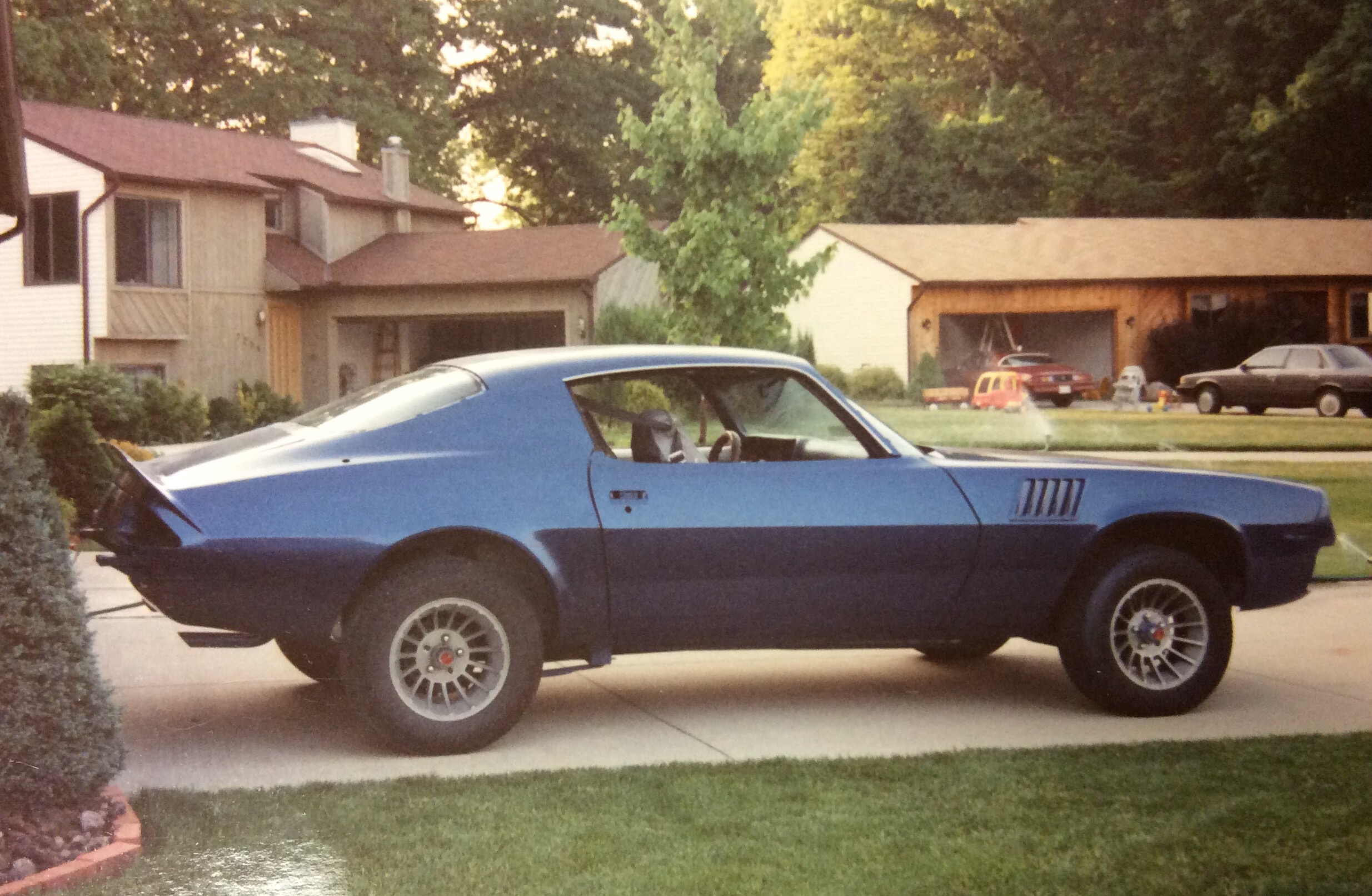

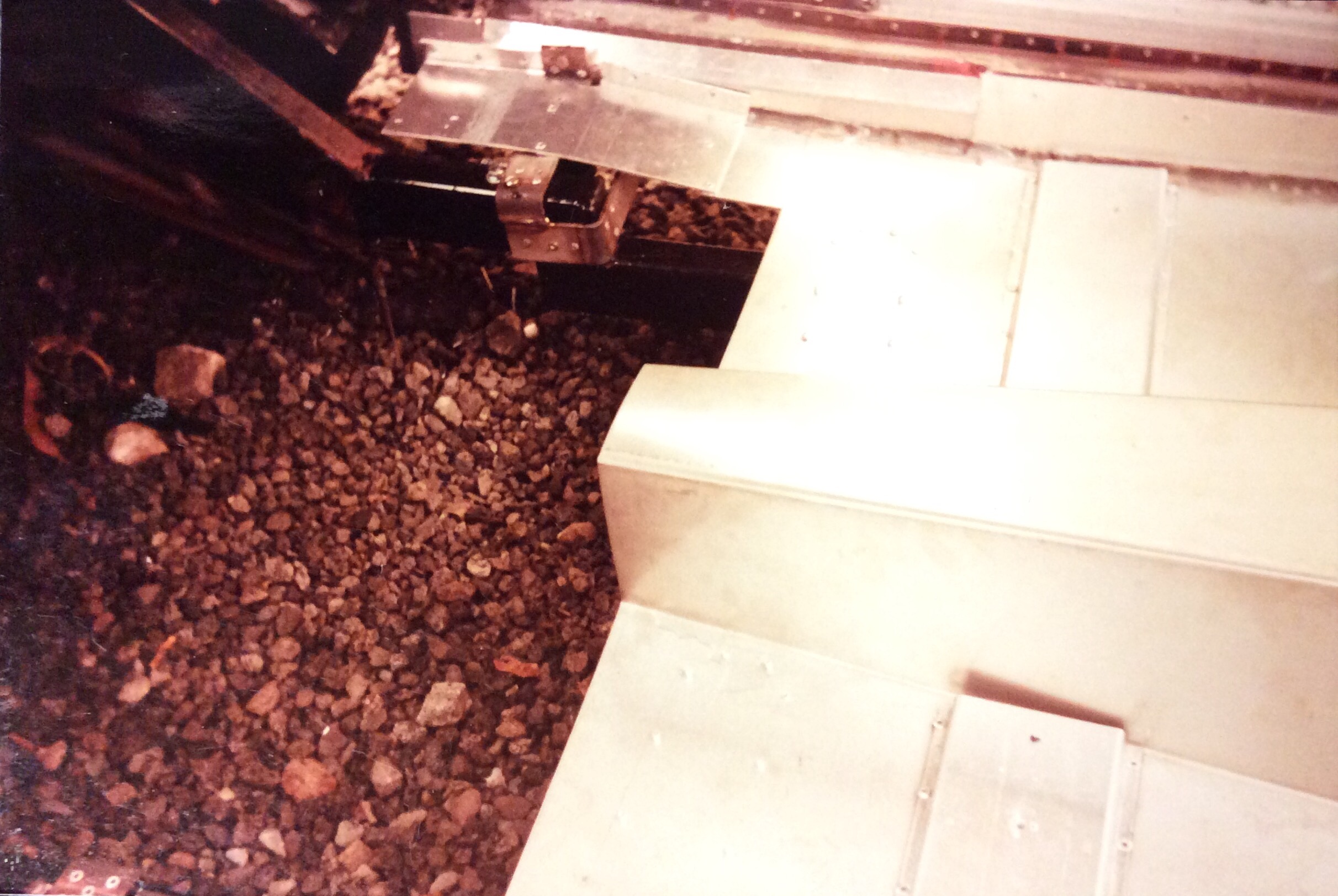

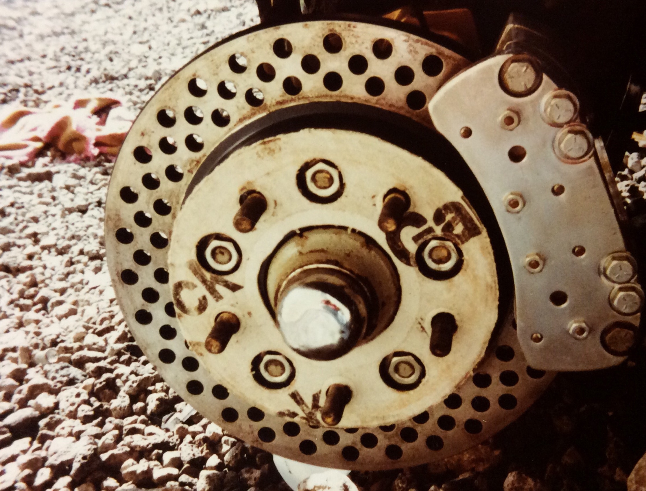

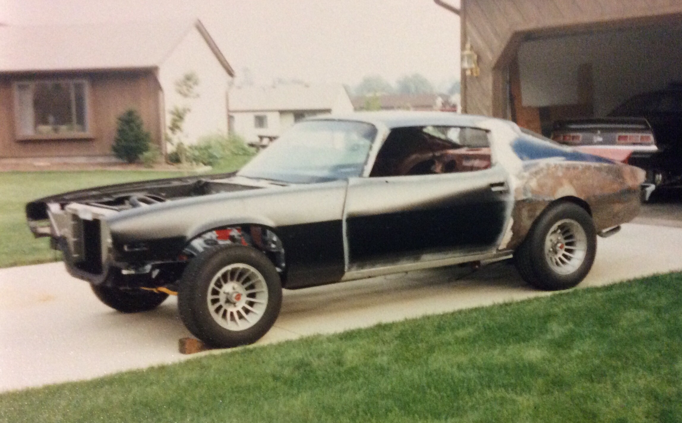

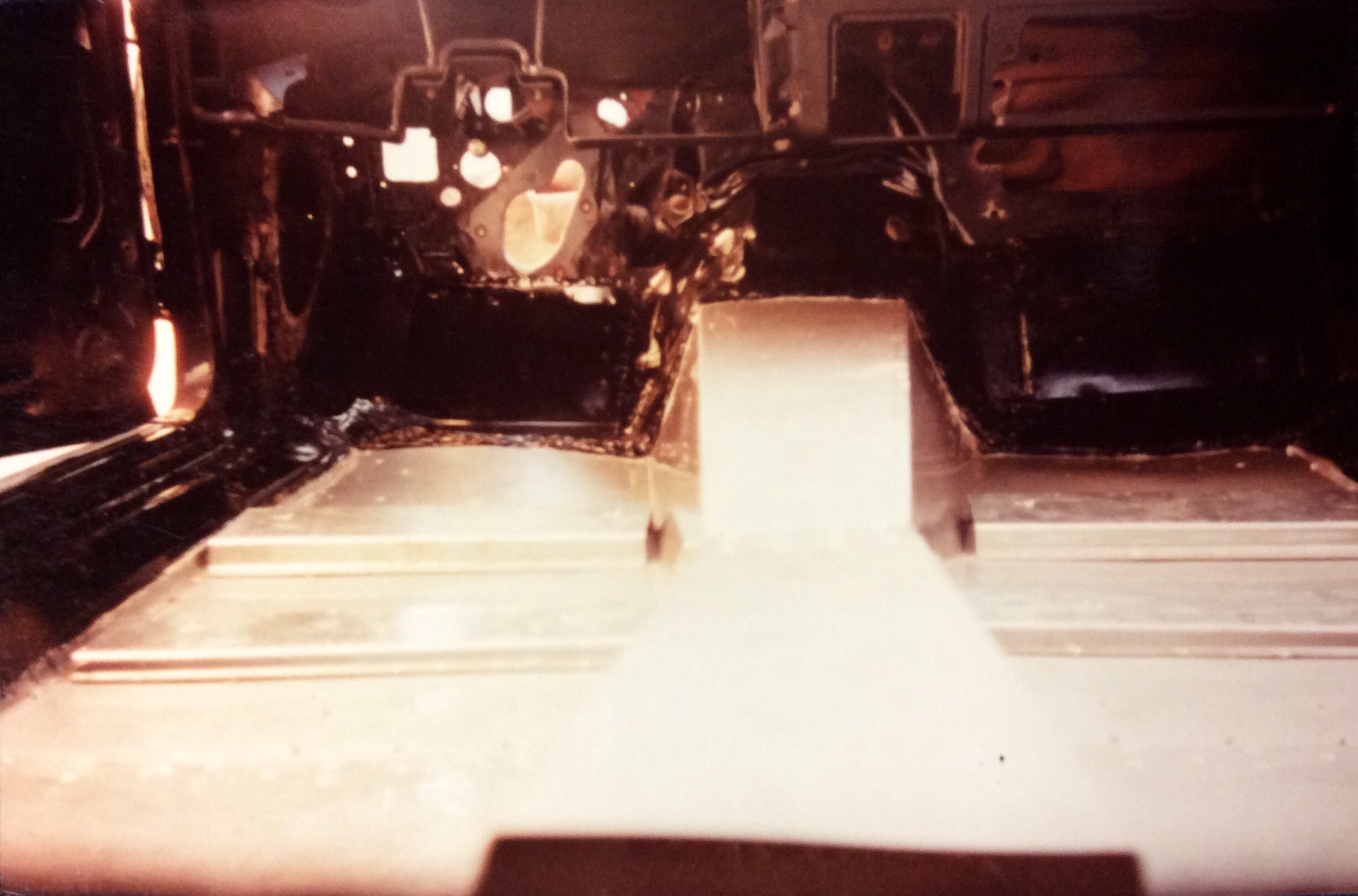

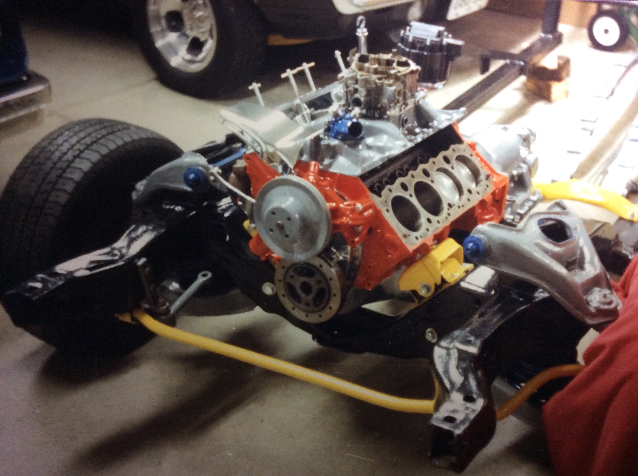

Treasure those late nites, they will help you grow in many ways. My late nights are done, or at least I hope so! But I had a life full, both professionally as well as personally. In my teens, my buddies & I would work lots of late nites, drag racing, break it, fix it go back for the next round & so on! Once I entered into amateur racing, 24 hours straight many times to be ready for race day wasn’t unusual. When I was 20 through my 30s many late nites on a rock driveway building two cars to be ground pounding muscle that just plain handled like they were slot cars & would leave most guys scratching their heads!

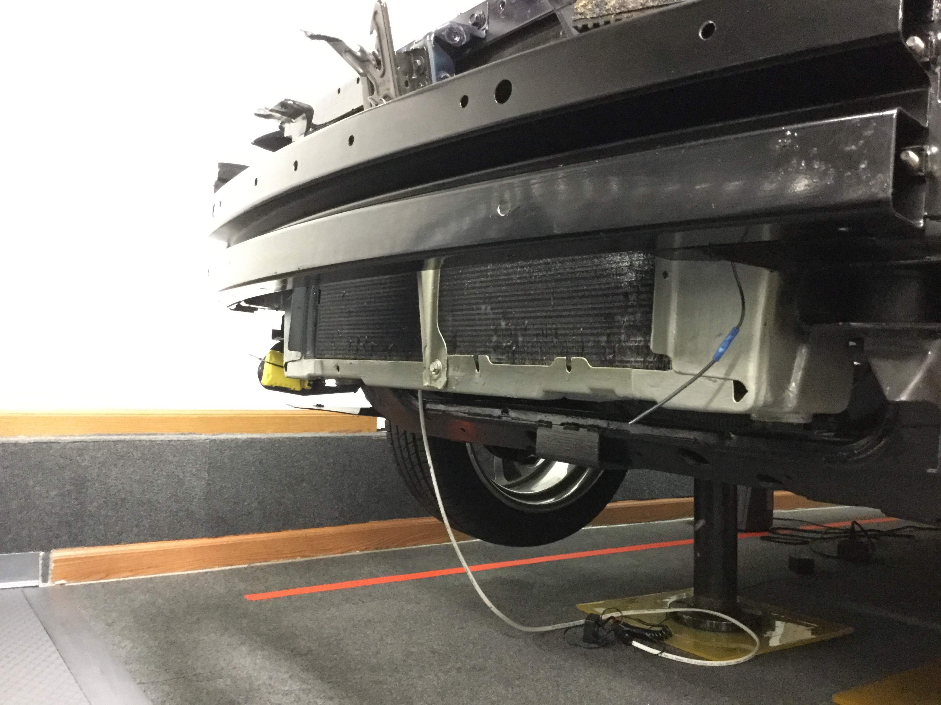

Worked many a late nites on Dash 9 locomotives in Little Rock, Council Buffs & Lincoln. Mine haulers in the Powder River Basin & Chuquicamata Chile, installing or overseeing my prototype monitoring systems being installed, which always meant problems when they finally interface with the drivetrain, diesel electric is a complicated beast.

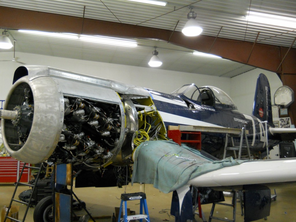

Than of course there was the Indian! Not a lot of late nites under it, but there were many at a computer that I spent in the early part of the planning of what it would eventually become.

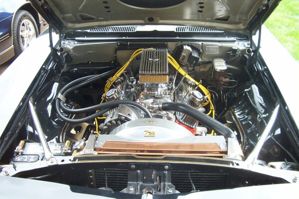

Then there was this beast & it’s friends!

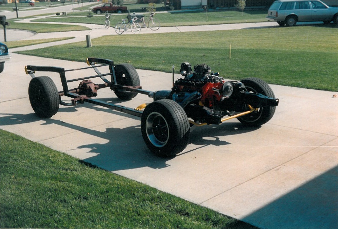

Then there was this beast!

He's a good shop dog! He never leaves my side 🤣

last Indian, i am so impressed with the full chassis build for the gen 2 !:bowdown:
The build for the “74” proved to be a good one. Made a vast improvement to handling as well as a better/quieter ride, but it paled by a huge margin to the “69” build! I have said it before! I have driven more cars of all makes & models, domestic & foreign. Sports, luxury & trucks than I can even begin to name. Not one compared to that “69”!
One of the subtle differences is the orientation of the 2x3 channel & it’s configuration. In the “74” the 3” side is sideways. This gave a flat look to the frame like a traditional frame. It also allowed the frame to be hidden by the rocker panels. But the G forces acting on the frame when loaded in cornering create a substantially different effect on that orientation than they do when inverted! The “69” had the 3” side, vertical, as well as a dogleg in the frame at a critical point, the front leaf spring eye attachment. This orientation changed everything about the physics of the design when acted on by G forces. The down side was everyone would ask why the frame hung down at the point!
Look at it this way Kiwi! You love your Hellcat, right! Imagine just for a moment that it weighted 3350 lbs. instead of 4400 lbs. & the power to weight ratio was .182 instead of .161! Plus it pulled 1.17 Gs in a 300 foot skid pad test. That was the “69”! Damn I miss that car!
