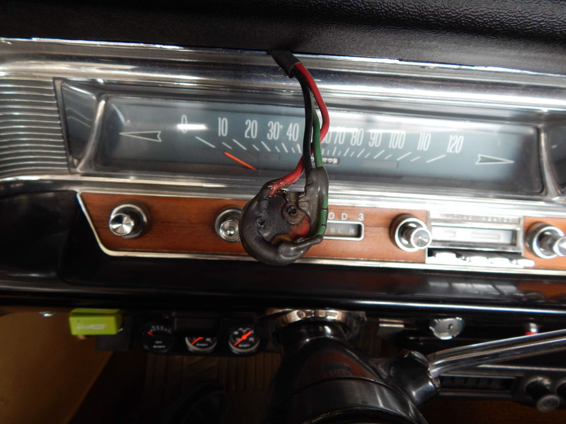

Once again I must thank you all for your help. The instructions I received were perfect. I have posted a picture of why the original switch didn't work and was able to purchase a perfect replacement from AMES (Part # PA449F).
It shouldn't be hard to replace it when I get the new one.
Michael
one thing you may want to consider is upgrading that circuit by installing a good quality relay that will take the current draw and use your new switch to control that relay
that way you don’t have all that load going through the switch 🍻
as you can see what that current draw has done to the switch over the years 👍

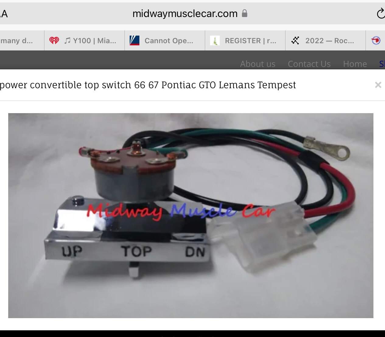

This is the replacement switch https://midwaymusclecar.com/products/power-convertible-top-switch-66-67-pontiac-gto-lemans-tempest
I had to replace mine as well. The only issue is the wire is not long enough so i needed to splice into existing switch wire which is no big deal. There is no fuse for this circuit. Power comes straight from battery. I would use the top sparingly.

I have asked Midway  if their switch will hold the 30 Amps I need.
Still waiting for a reply. I have temporarily put in an inline fuse from the battery.
Mike 30 amps is a big ask for any switch
a good quality relay is your insurance 👍👍
and will protect your switch regardless of quality
