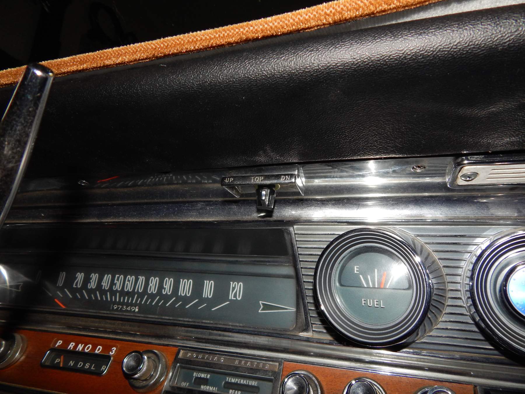

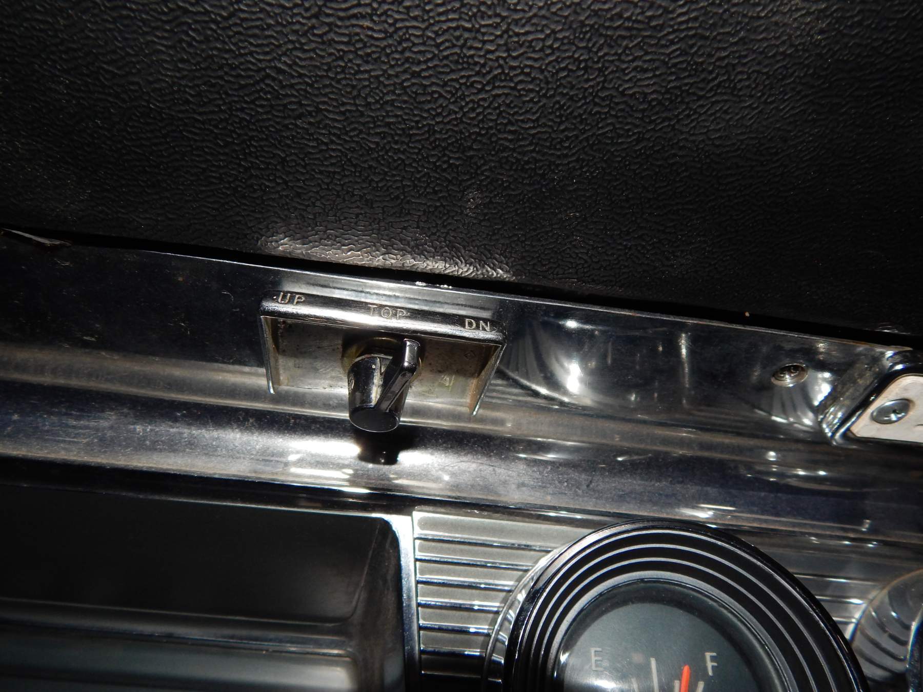

The up/down switch for the rag top is broken.
I'm not sure how to get at it to replace it and I don't know where to get a new one.
I would like to do it myself and save some cash. I've written too many checks already.
I sure could use some help.
Thanks.

Came out beautiful.  Can you post a pic of your dash and maybe a closeup of the switch area?  That's a pretty popular car around here and very knowledgeable owners that should be able to help you out. Welcome to FP family.

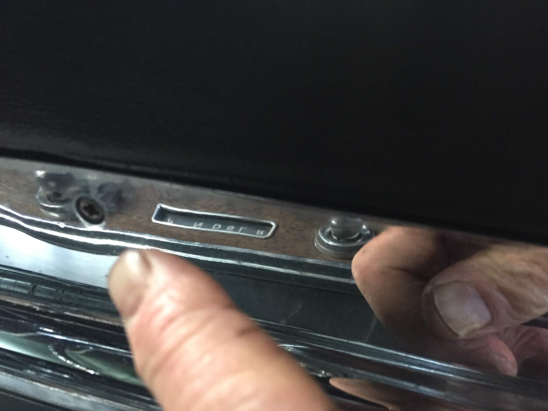

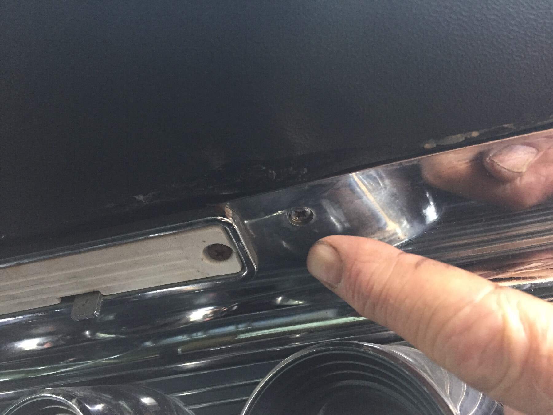

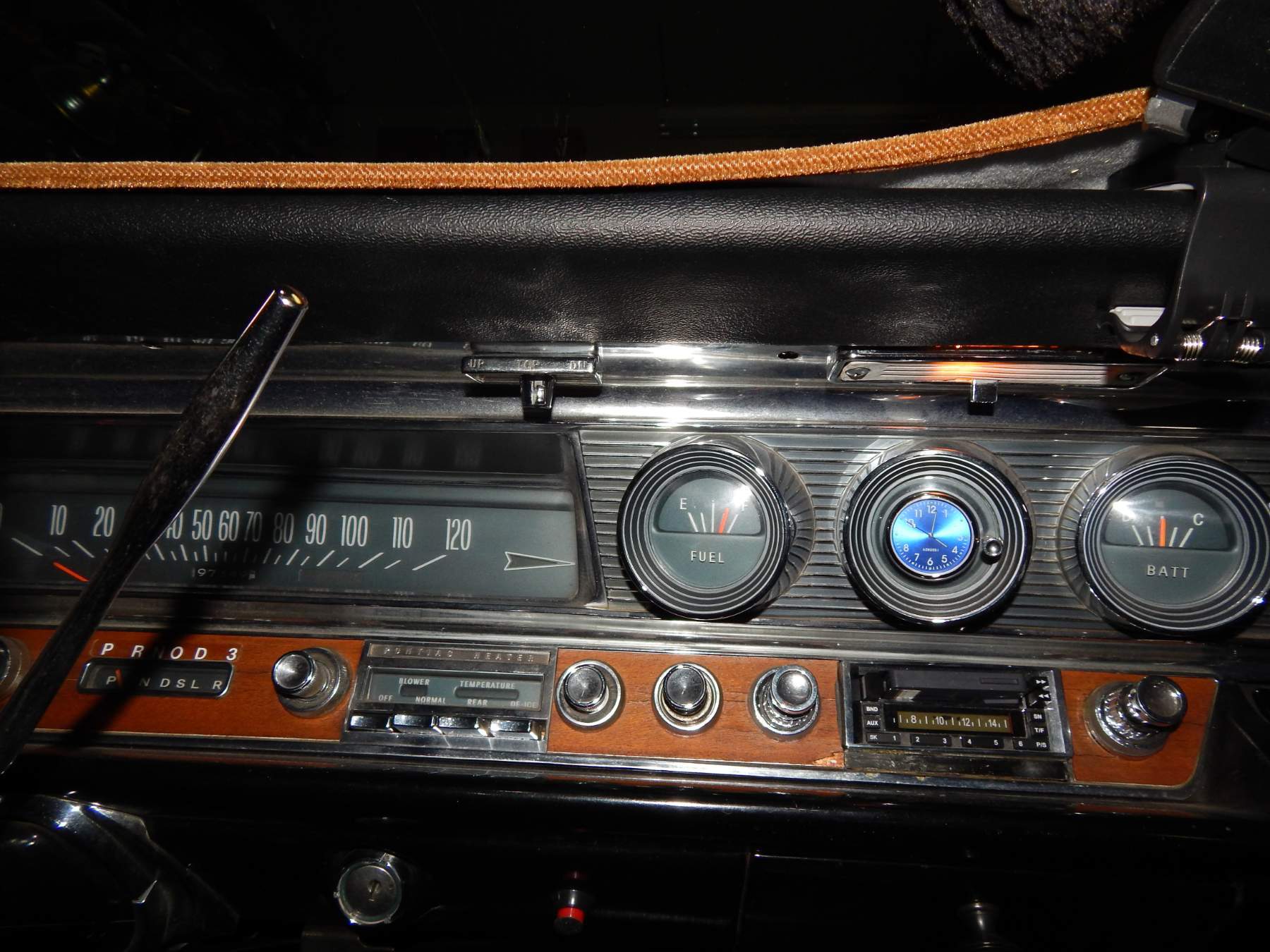

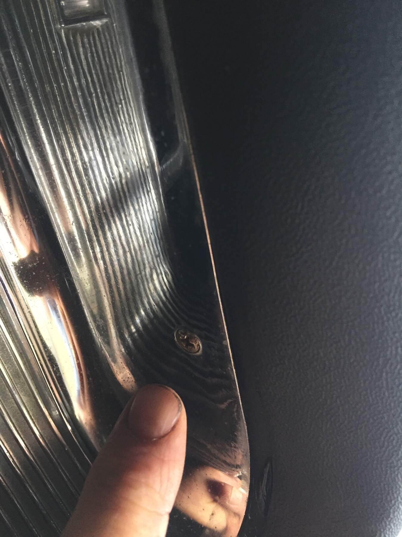

Here are the pics I took.
Will they appear in my profile photos?
Great pic's, thankz.  Looks like you will be removing the dashpad.  If you can't find a replacement or have it rebuilt,  Run a hidden switch to work the top until your able to come up with a better solution.  Good Luck.  Shou;ld be more of the 64 crew chiming in on this one.

Hopefully someone can tell me how to remove the pad and if the switch is right under it as it seems.

Anyone of the 64 guys can help with that.  Then you will test it, to make sure it's not something else and the top will go up N down.  Like I said you can always run a hidden toggle/rocker switch.  Here's some things to look at for now.

Hi Michael, super easy mate !! you justA take out the 6 screws holding down the dash pad, remove the chrome "A" pillar trim, pull that pad and you will have easy access to that switch ..
 i will post some pictures..
3 hours ago, JUSTA6 said:
and as JustA said the switch is a good place to start, BUT it may not  be the switch. pull it and check its continuity :cheers:
do a ohm test on it too will tell you how clean its old copper contacts are too :cheers:
