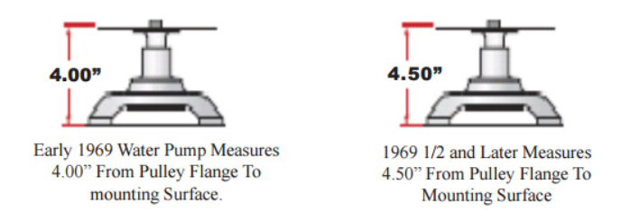

Here is another useful reference from Butler Performance regarding water pumps. Again, something else you can share with your builder.
https://butlerperformance.com/n-13390-pontiac-water-pumps.html
