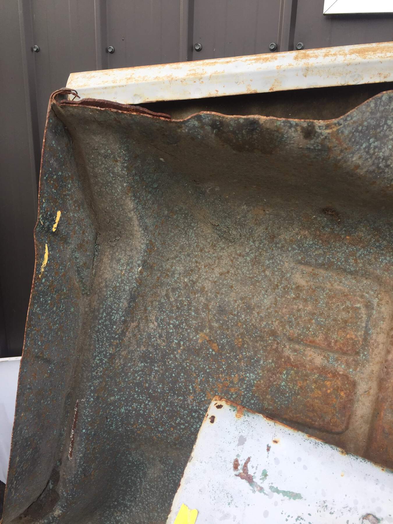

I'm not exactly sure what the "spatter paint" look is. Surely it cant be what I'm picturing lol. Could one of yall post a pic so I can better understand?
Thanks.
Here is the splatter paint on my spare trunk floor wrong way
Hmmmm, thanks Kiwi. After Fitzy telling us what his buddy said about running paint thru a paint gun with no thinner I was curious to see what it "should" look like.
